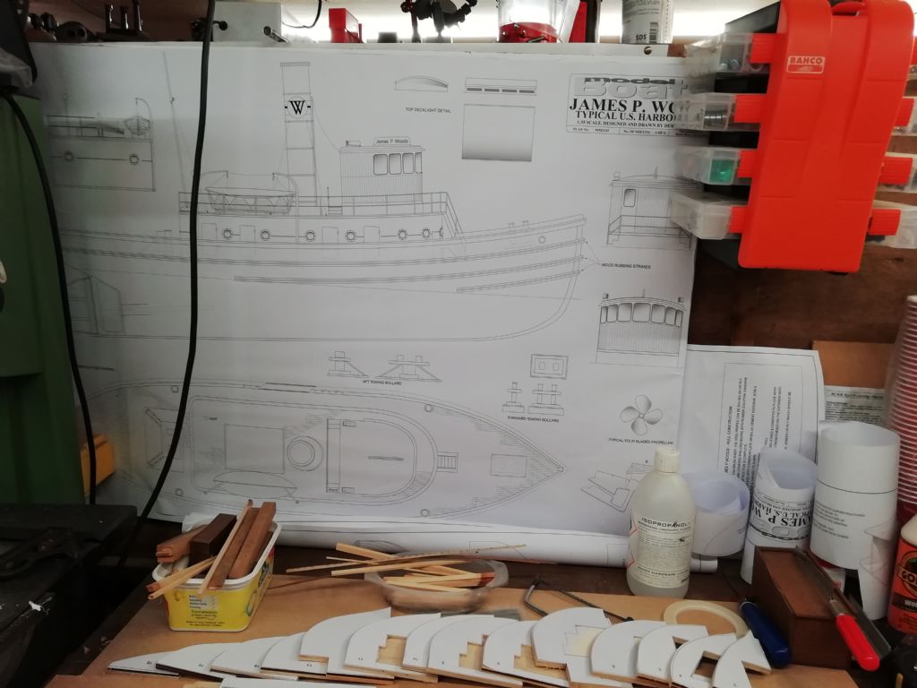

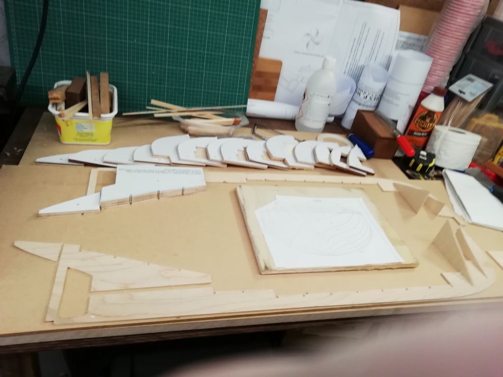

      Please be gentle with me, this is my first boat build other than a Zwarte Zee which I'm looking for the accessory pack for and a continuation build of the Löschkreuzer Weser.
      Laid the 2? keels today
      And cut the pairs of frames etc, they just need sanding to size. I used double sided tape to hold the pairs together, worked well. smiley
      What didn't work quite so well was the use of spray mount, went a bit too heavy on the keel and was a sod to get the paper off. sad
      I plan to dry build the frames first and check all is ok before gluing and also to see if there is enough room for a steam plant, if not, sparks it is then.

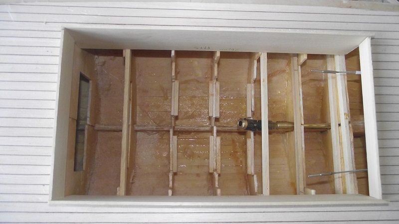

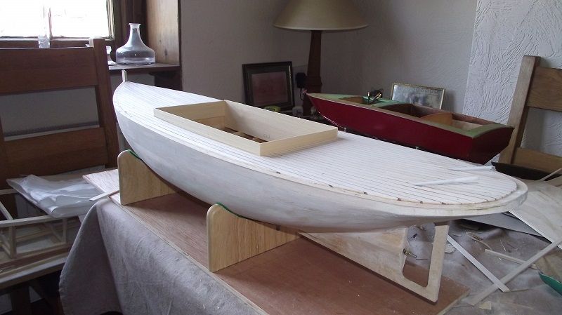

                              The hull so far.
                              looking into the engine and electronics bay. The extension to the bay is on the left, from frame 7 forward to frame 6.

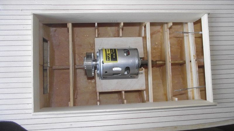

                              The prop shaft is a Raboesch waterproof 290mm M4 thread, it could be shorter. Cornwall model boats sell it.

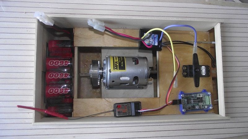

                              The MFA torpedo 800 in place, the mount for the motor is in two halves as the output shaft is below the motor.
                              Cornwall model boats sell it but are out of stock at the moment, but Component Shop have it in stock.
                              Everything roughly in place, the battery sits in the extra space made by extending the hatch area, the blue box at the lower right is a motor sound generator, set up for a single cylinder steam engine.
                              I have also added a second cable for the rudder just in case a single one cannot push the rudder against the prop wash.

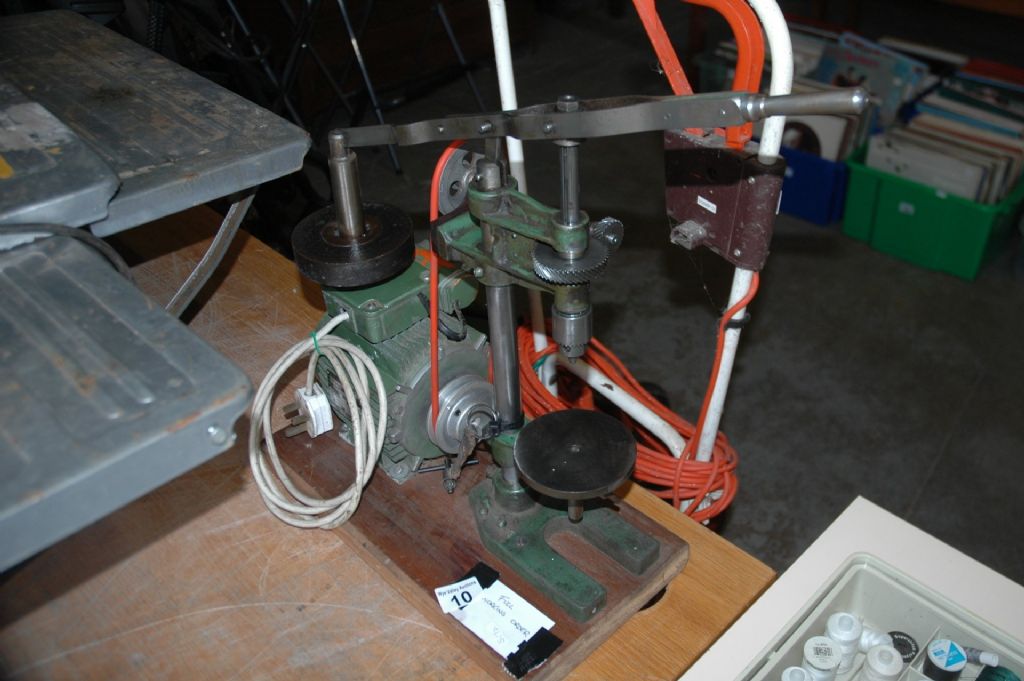

                                          I built my workshop up by buying tatty machines and restoring them, my last was a 1938 Denham Junior MkII lathe with little wear but looked like it had been repainted by a colour blind person with a whitewash brush. Just picked up a sensitive drill press at a local auction tonight for £28. It comes to those who wait. smiley
                                          Regards
                                          Roger
                                          Edited By Roger Clark 1 on 26/03/2019 20:40:10

                                              @rogerclark
