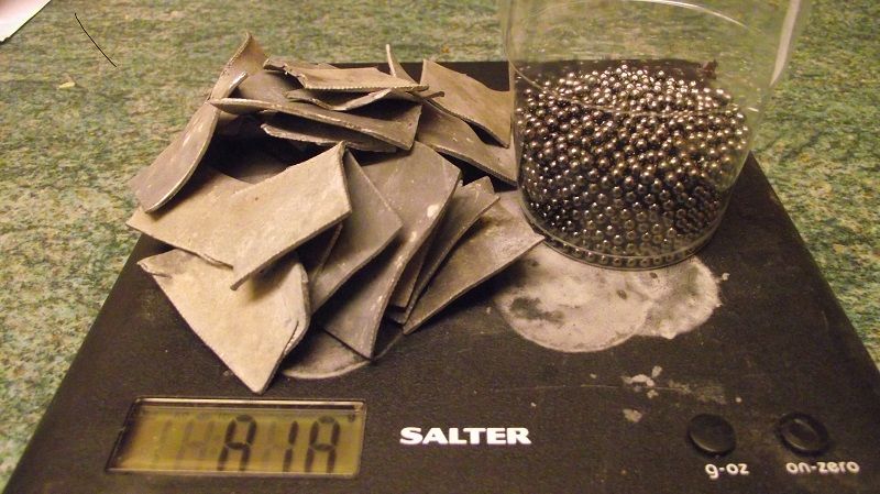

      Hi. Roger, I received 6k. of lead shot yesterday, over half of it is now firmly fixed in the bottom of the hull.
      This is what 400 grams of lead sheet looks like against 400 grams of lead shot.
      I fixed the shot in place with polyester resin, it's cheaper than epoxy and I had it in stock.

        Hi Eddie, just looks like a load of balls laugh, sorry had to say it!!! Didn't know you could still buy lead shot with all the associated risks of lead poisoning. Hmmm must check on the wife's insurance wink. My plan is to take plugs of the ballast areas and create sand moulds to cast them.

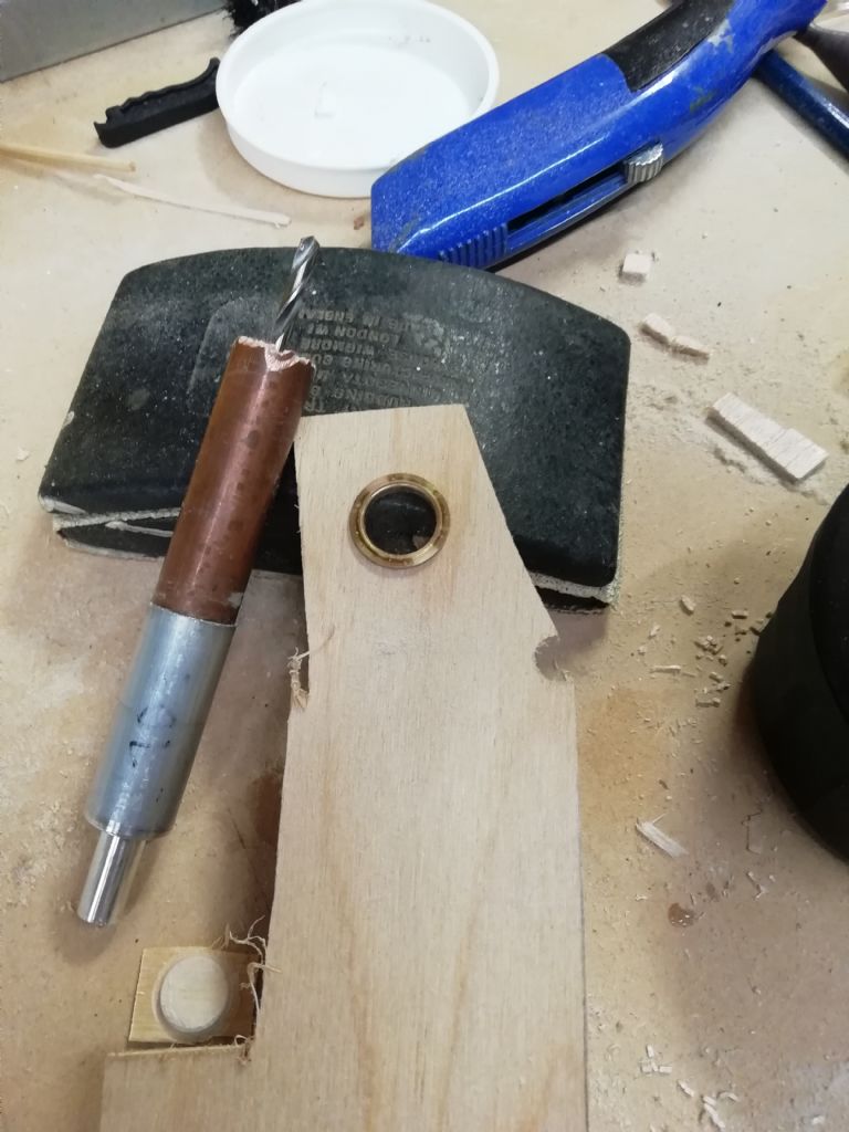

        Made my Porthole borer today:
        It's a touch too big but should be fine, done a bit more to the topsides but nothing worth uploading at the mo, just been sorting out my Speedy 5" gauge loco ready to sell.

              Hi.Roger, Ray, I never thought my balls would create so much interestblush.Lead shot is used by divers to get them to the bottom.

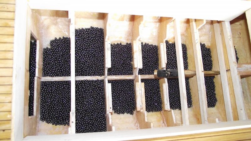

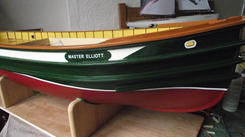

              Another photo of Master Elliott, on the water when the ballast had set,the motor is in but I forgot to put the battery in so it's a bit bows up at the moment, also I have kept back 500 grams of lead from the total required to bring down to the water line, for trimming when it is all finished.
              Yes we go boating twice a week,Thur.and Sunday morning,I am still getting to grips with my TSB before I meet up with Ray

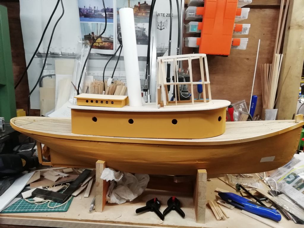

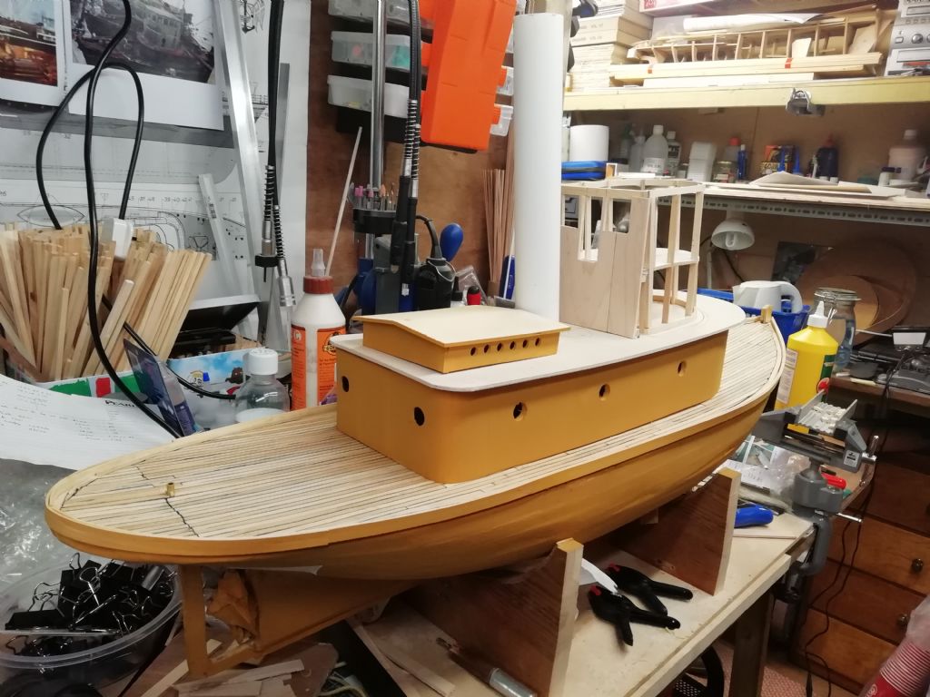

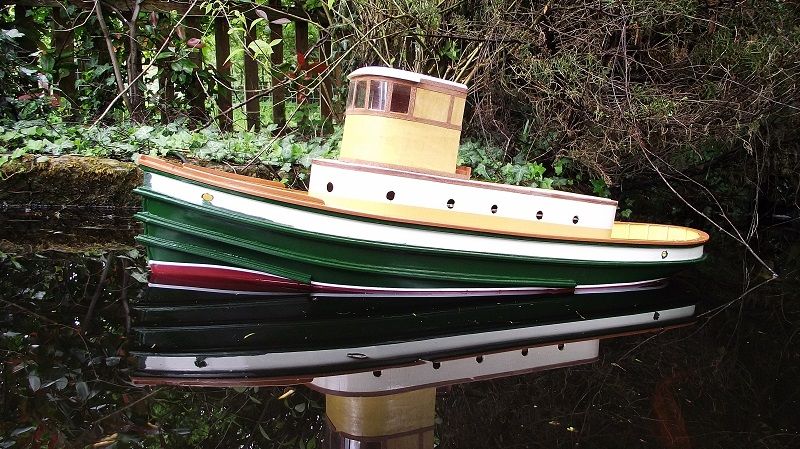

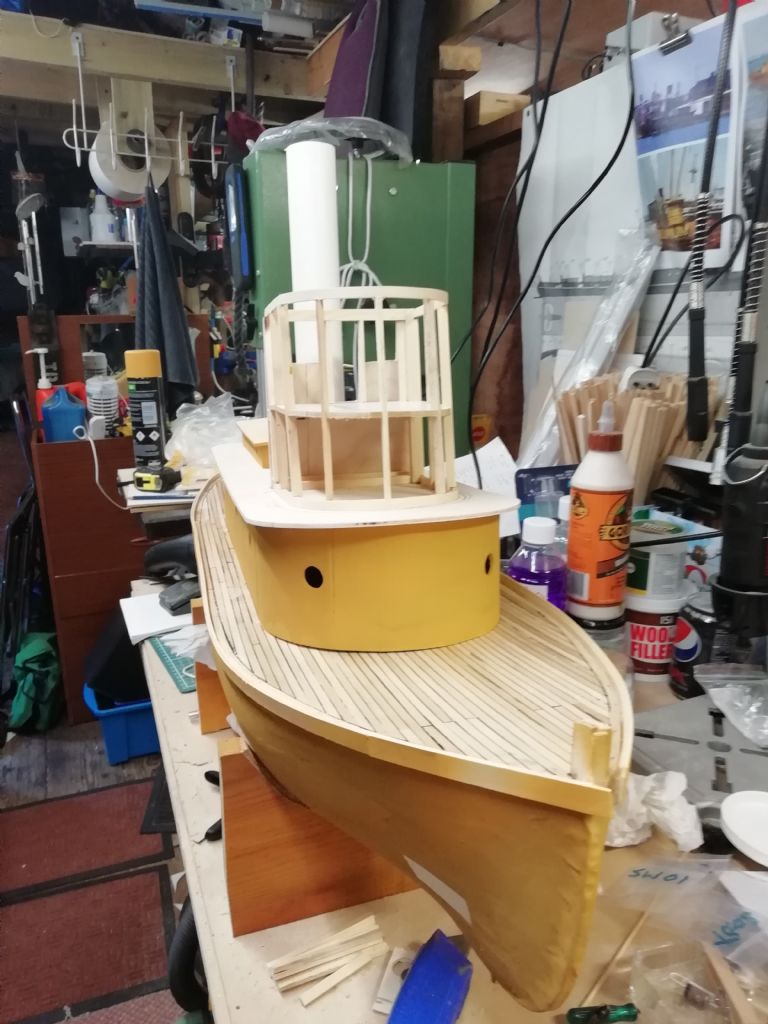

                      Hi All, a little bit more done today, firstly a coat of sanding sealer on the deck and then some port holing in the superstructure sides prior to sealer, sanding and a coat of primer.
                      I think it's coming together now, did have to do a mod to the bridge, the back had too much rake on it when 'leveling' the boat to the waterline so that's fixed….ish, well looks a bit better. smiley Had a delivery from Mobile Marine Models today of a ships wheel, binnacle and telegraph to furnish the bridge just waiting for a cap'n and crew to turn up now.wink see what kind of wasters I end up with!!
                      Isn't there anybody with some experience of sound modules that can advise me?
                      Constructive comments would be very welcome by the way. laugh

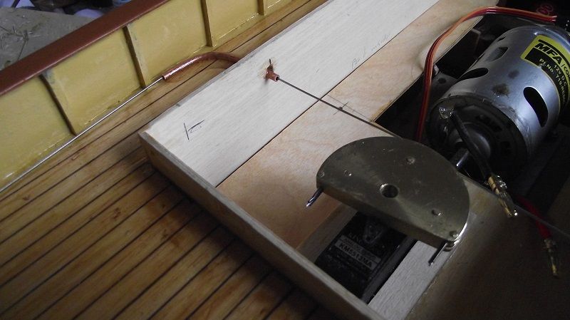

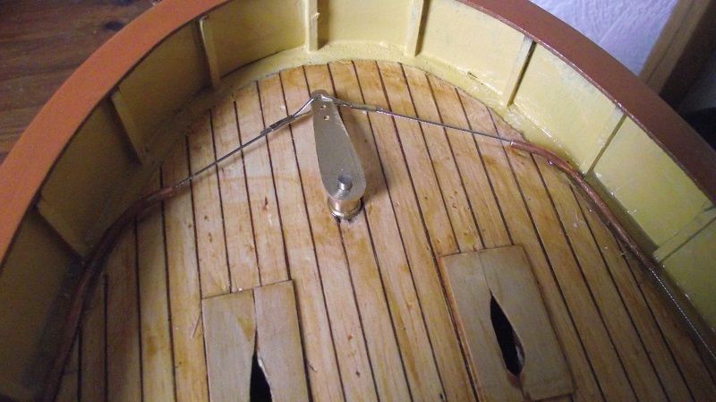

                                  Hi Eddie, does that steering layout work ? The theory should be the arm on the servo and the round quadrant on the rudder, as the cable at the stern stays the same length when moving. If it works as is happy days 😀
                                  #82184
                                  Eddie Lancaster
                                    @eddielancaster
                                    Hi. Ray, Yes it seems fine,at the moment I have put 120 percent travel on the servo to make sure there is enough movement at the rudder, I can then adjust it later if needed.
                                    I can also go to the layout that you suggest as I have made a quadrant for the rudder.

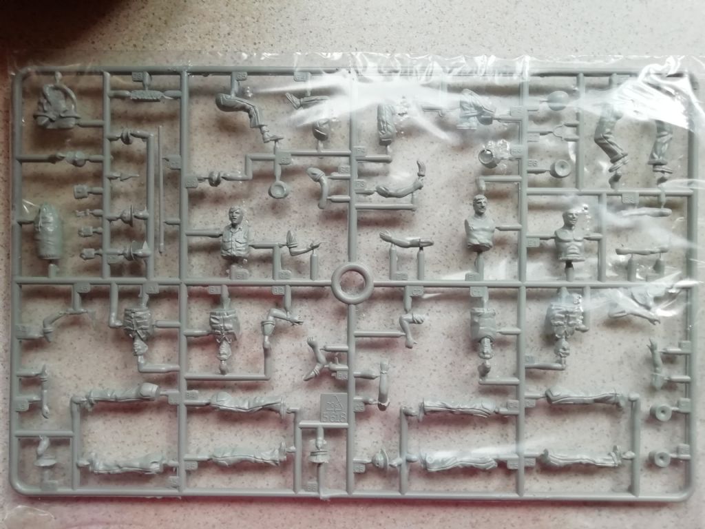

                                                      Ahoy shipmates laughMy new crew arrived today:
                                                      They were in bits when they saw their new boat:
                                                      I shall have a think about their new persona and roles on the tug. Could be interesting…. Could be a Roger made disaster laugh
