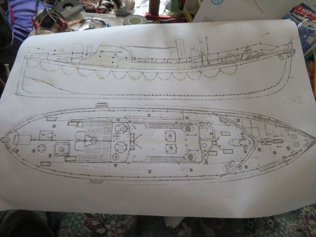

      I am buzzing with excitement, and it doesn't take much to excite an old fart like me these days.
      I have never ever seen a model of the class I am going to build next anywhere at a show,on a lake or in a show case.
      The model I am going to build is of one of 4 built, and is of the 60/61' Barnett class lifeboat, and is to be built at 1;12 scale, giving a model of 61" LBP X 15" beam and 4" draught.
      The plans up on the drawing board are for the 60' RNLB William and Kate Johnstone, but with slight mods I will extend the main keel and backbone by 1 inch to build the longest of the 4 boats built, the RNLB Princess Mary, which I think is the nicest looking of the 4 boats which were in build order:
      William and Kate Johnston, 1923, New Brighton,
      Emma Constance, 1926, Aberdeen,
      Robert and Marcella Beck, 1926, Plymouth,
      Princess Mary, 1929, Padstow.

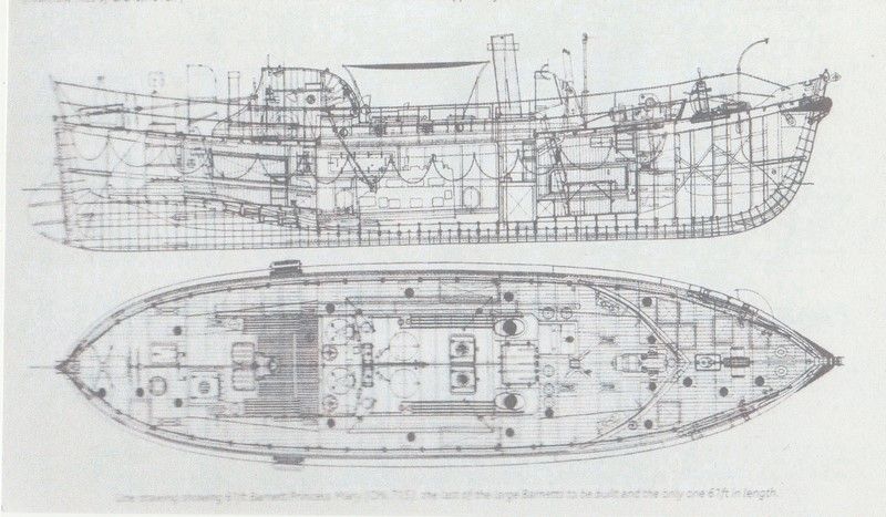

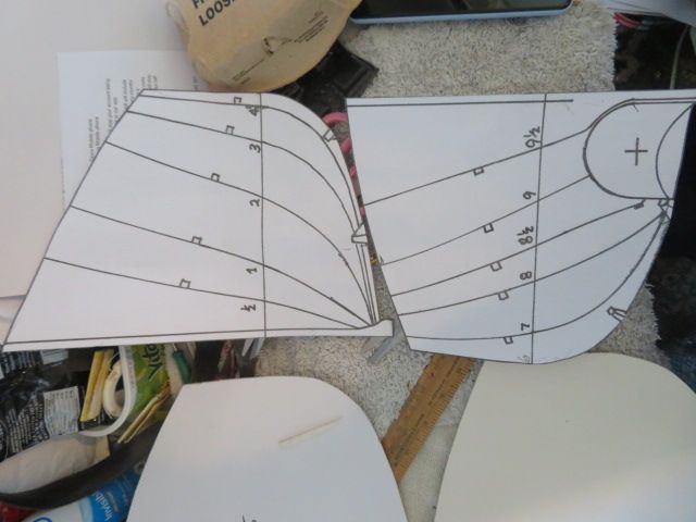

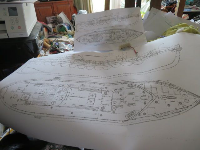

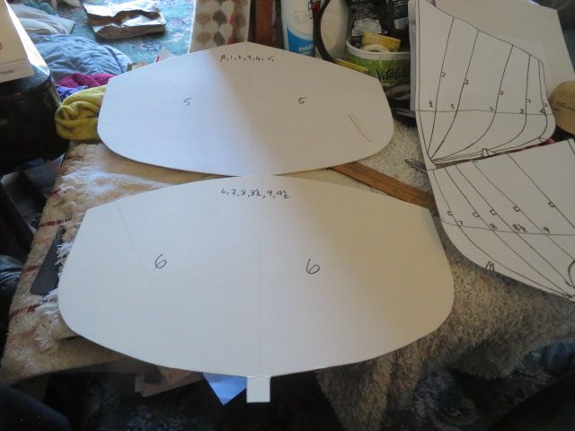

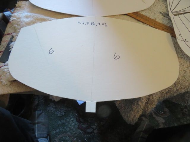

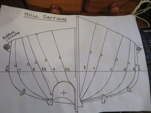

                                rather than sit around doing nothing, this afternoon have transfered the first two cross frames, numbers 5 and 6, the centre two widest frames on to art framing card.
                                Normally i would have just photocopied the frame drawings on to A3 paper, the number of frames needed and folded down the virtical centre line and then cut out the respective frame number, around that fold line.
                                However these frames are so wide and deep, that they wouldn't fit on to A3 paper.
                                And so i cut the two sets down the virtival centre line which in itself gives the posotion of the backbone keel frame, and cut down to the outer frames 5 and 6 first, repeating the second half of each frame by reversing the frme on to the other side of the virtical centre line of the card that i had pencilled on.
                                the first two frames are now ready to draw around on ply, when i buy it on tuesdy after having my car fixed.
                                but looking at the frames, she is going to be a big impressive beast indeed.
                                the process will be repeated by cutting down the next frame lines in to repeat the process once frames have been transfered to timber.

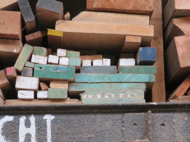

                                      been dong a wee bit of behind the scenes work today.
                                      first of all i finally managed to purchase some planks of obeche timber from a company that had promised to dug them out from under another pile of timber in May………..that was May 2019, all it took was a telephone call to the manager and a 45 minute drive from my home in Poulton le Fylde.
                                      and through all sorts of problems, including covid i was finally able to track down the sawmill's manager and explain to him just how many times i had asked for this timber.
                                      it took the manager just 5 minutes to actually dig out the 3 planks that i wanted for just over 3 years…….and then said………i can't understand what the problem has been…..just 5 minutes work!!!
                                      and the best bit was, i got it at 2018 prices………..absolute magic.

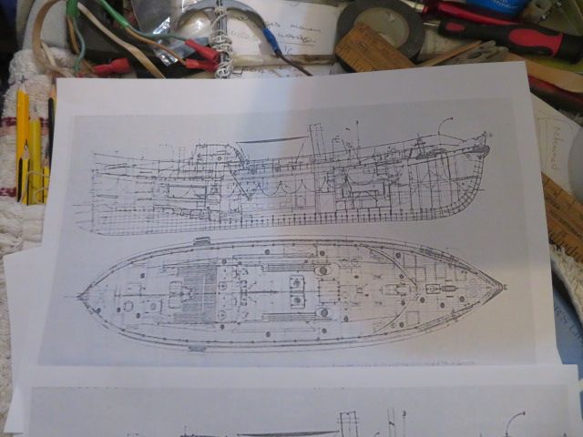

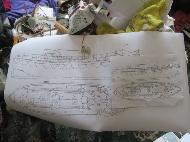

                                      so tonight i started doctoring with Tipp-ex all the un-needed lines on the small plans from a book so that i can get the GA's for the Princess Mary, as oposed to the William and Kate Johnston that the main set of lines are already for the build!
                                      The "MARY" was 1 foot longer but same beam as the "Johnston" purely because the "Mary" had a more pronounsed stem post and as such lengthened the boat by that one foot….
                                      the plans can now be photo enlarged at Granthams printers, Blackpool digitally next week.pictures are of the plans, and my 3 planks of obeche, 10" x 1" x 16 foot with the green end grain colouring'
                                      The work will start later next week.

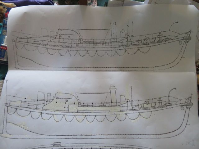

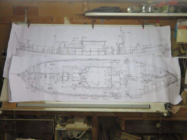

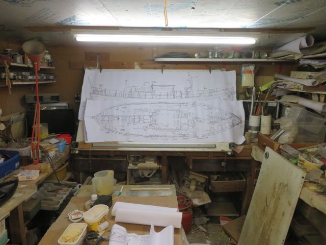

                                            the plans have now been enlarged again, and as such are now 6 times the size that they were in the book that i originally took them from.
                                            some more cleaning up with tippex and lining with a drawing pen of the main deck details and it will be then ready for the final enlargement by 275% of the new photocopy.
                                            #101253

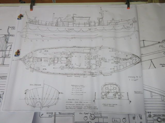

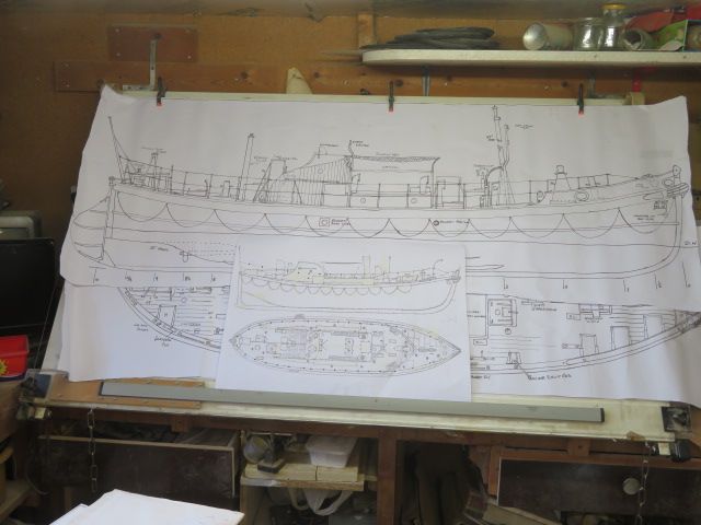

                                              now cleaned up the enlargment with tipp-ex and calculated that I now need to enlarge this set by 275% to give it a hull measurement between perpendiculars of the 61" required.
                                              It actually comes out from that enlargement at 61.05", which i can deal with lol.
                                              It is now a lot clearer of the deck lyout, the size and shape of the cabin and engine casement and all of the deck lights, hatches, fuel filler and bilge pump deck caps, with just a few slall details such as the bow anchor windlass and another small fitting on the engine room casing next to the front of the raised cabin cockpit that i am not sure of, but most of the fittings and such are items i have in stock from my other lifeboats that i have built……..
                                              Quite happy about that…….
                                              roll on geting my obeche on thursday of next week.

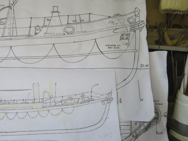

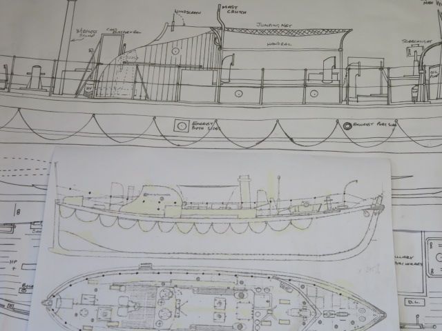

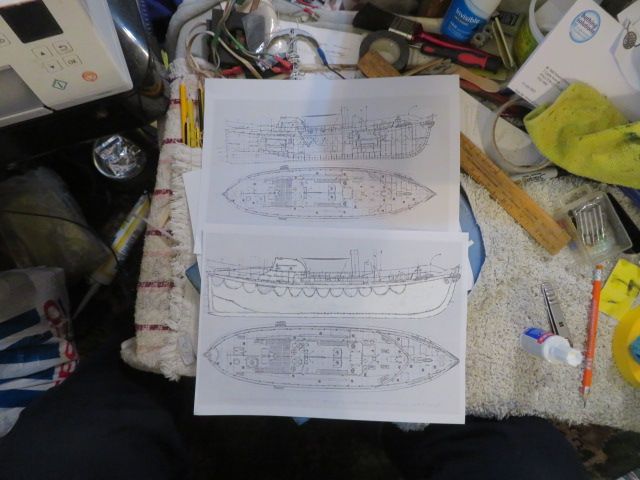

                                                    This morning before I go to Fleetwoods RNLI Lifeboat open day in a few minutes I put the cleaned up plans next to those of the first built Barnett 51' boat, and could quite easily see where the extra foot in the hull came from. The rake on the bow is much greater on the Princess Mary.
                                                    In all, I find looking at the two boats together, the RNLB William and RNLB Kate Johnston was, although advanced for its age when built in 1923, she was by 1929, six years later a very primative looking boat compared with the Princess Mary of Padstow.
                                                    And to be honest, the overall looks of the latter boat are so much more pleasing and less cluttered than the elder, and I am so pleased that I have taken the extra preperation time to be enabled to find the plans for the Padstows' boat RNLB Princess Mary!
                                                    I think i'll enjoy both building, showing and sailing this beast.

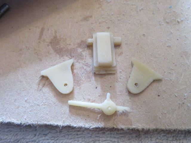

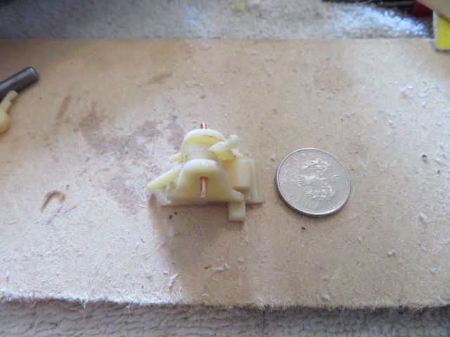

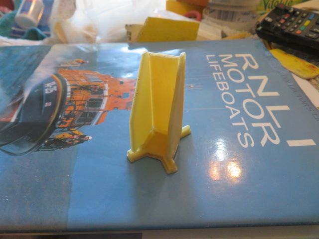

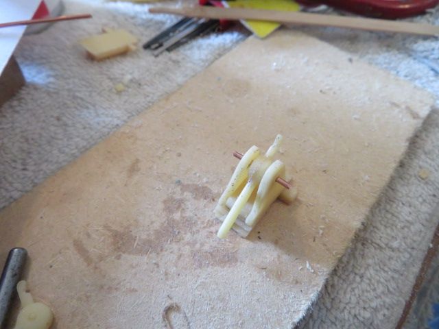

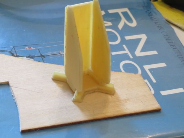

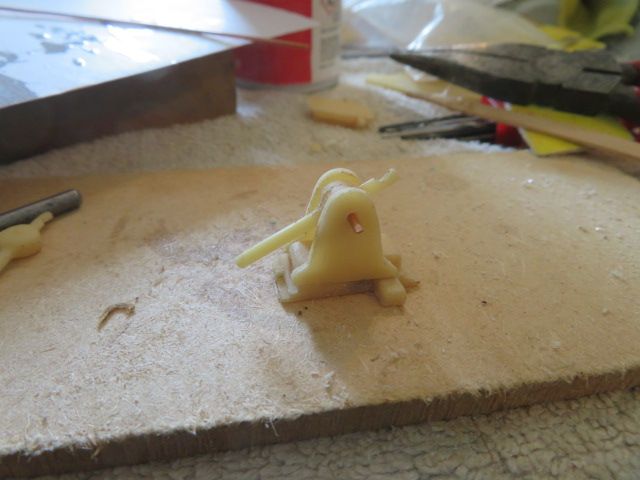

                                                      When I built the 51' Stromness type Barnett RNLB Mary Stanford 11 years ago, I didn't realise that so many of its fittings were a copy of those fitted to the earlier 61' Barnett.
                                                      And so I looked through my collection of fittings from 10 years ago to find quite a number that are synonimous with both boats, which will save a great deal of time developing new ones.
                                                      Two I dug out and decided to put together first were the mast tabernacle, and the bow manual rope cutter to sever either an anchor rope or a tow rope that was fastened to the main bow bollard.
                                                      Here are the bits, cast in resin, years ago.
                                                      I'm not sure but I have only ever seen the rope cutter fitted on to the two Barnetts mentioned.
