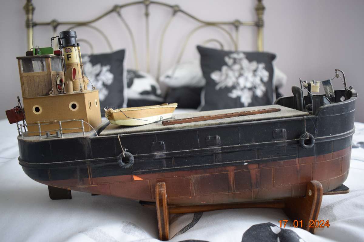

        Hi One & All

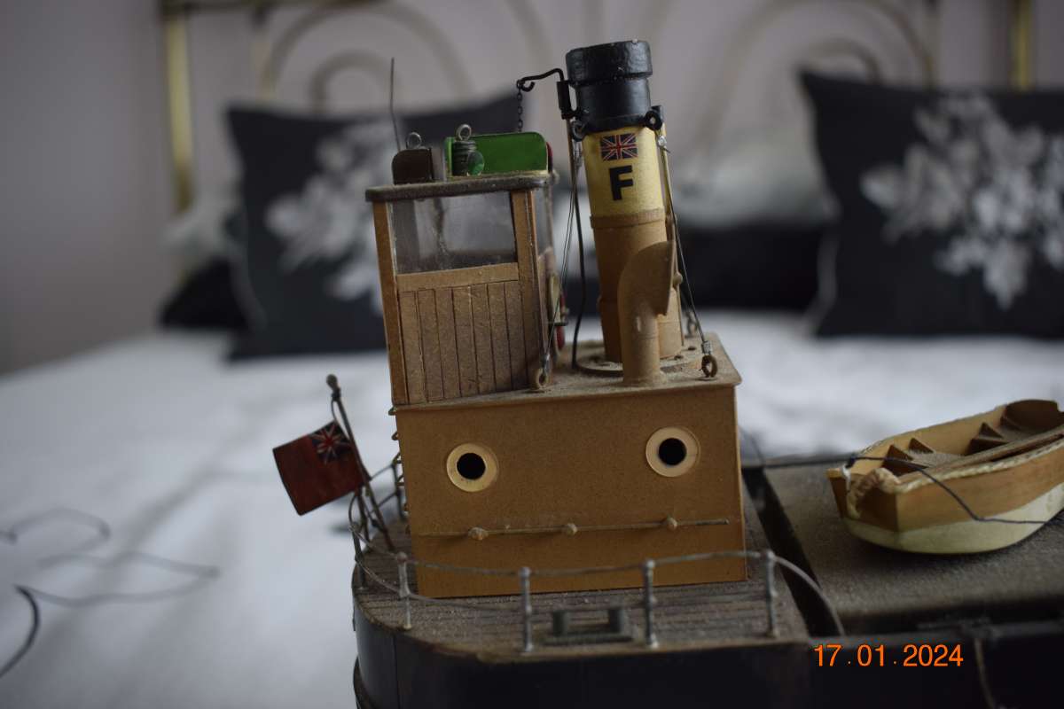

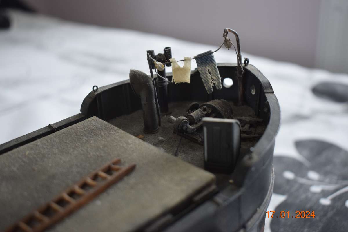

        O.K this is not one of my builds, the builder was the late Harry Fox, this is the puffer that started me off on my Love of puffers,.
        Harry was one of the founders of the AMS he was in fact the first editor of the InDepth the inhouse mag of the AMS, it was at the first Greenwich Model Boat show that he gave me this model.
        Fred

          That’s a great little model. I love the washing line. It’s quirky little things like that that you can add to a model that makes it that bit different to others. How old is the model? Looks like it has an age to it.

          Fred Ellis 1
            @fredellis1
            Thank you Jim, yes she is old I think it must have been some time in the early 90’s that the show took place, as I meet my wife in 1997 and I had her for some time before then.
            Harry did like to have some point out of the ordinary, he did a Fireman Sam fireboat and many others, would love to know were they are now.

              That’s a nice model Fred.  Enough detail to make it interesting and looking weathered just like a Puffer should.  It looks large as well.  Can we have a look inside?

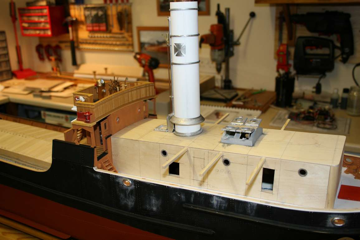

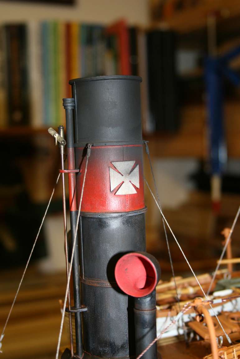

                      Lovely model Fred, at 15″ that would make it around 1/50th scale, certainly an unusual scale.
                      Just a thought on the subject of funnel material, it is frequently worth looking at plastic plumbing pipe offcuts.  That’s what I used for one of mine.  Having said that I know of another modeller who did the same in a steam powered model but he didn’t lag the flue so it melted the funnel!

                        Nice detail on the funnel Richard.
                        Looking at all the cable supports is a task on it’s own. Not something I’m looking forward to later on.

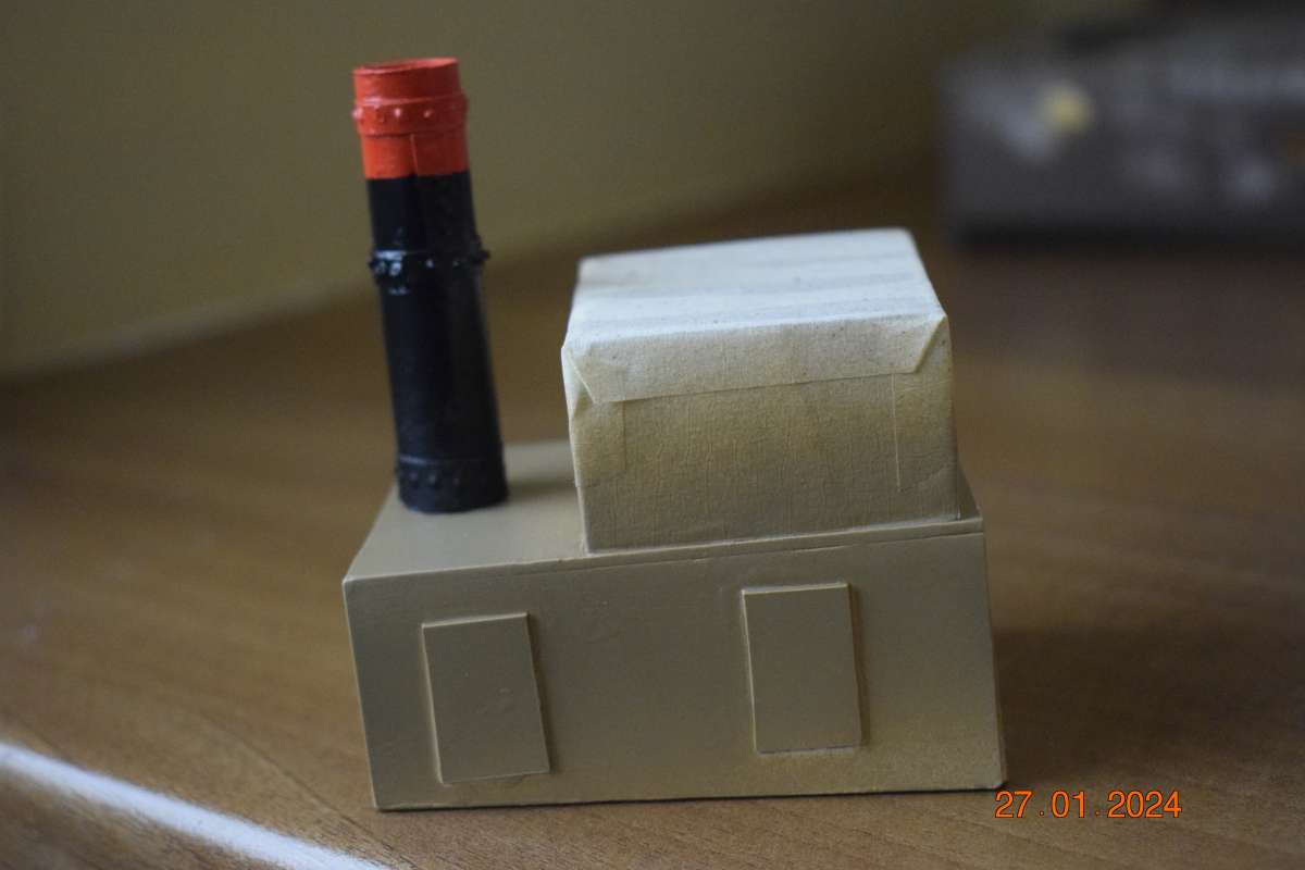

                                    Hi One & All

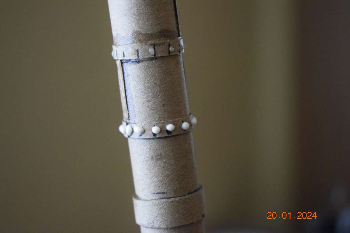

                                    This morning I tried out for the first time, making rivets with PVA glue. I think that they may be to big in the end, just have to wait to see how it look when they are dry. if they are wrong then I will try the small needle
                                    Fred

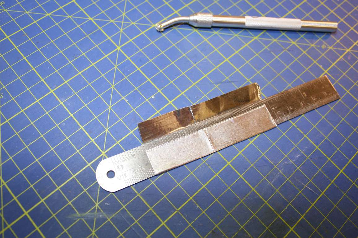

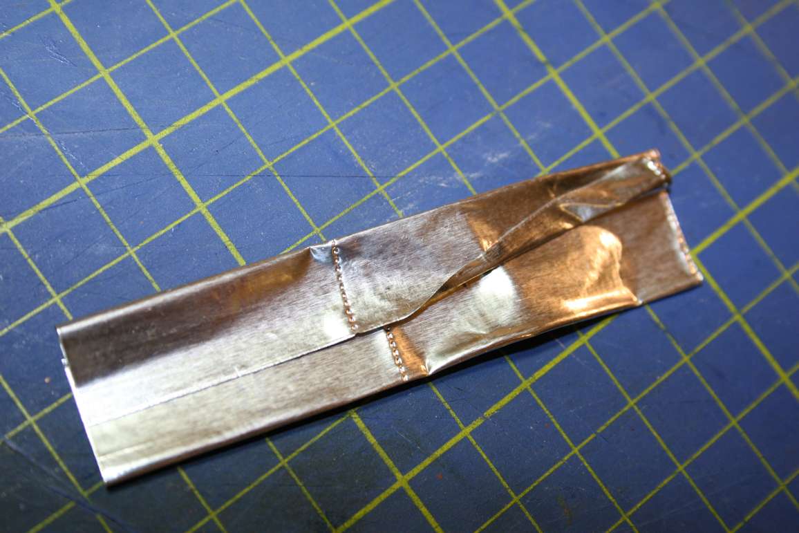

                                      I have been thinking this over and was wondering just what you think?
                                      What if I was to use some tin foil, if I was to make a jig by drilling some holes into a strip of sheet, glue a backing on to the strip, tape the tin foil over the strip then rub the foil so that it fills the holes, I just need to work out how to make the rivet head oval.
                                      Fred

                                        Hi Fred,
                                        When doing the rivets that I’ve applied so far, I used a pounce wheel, suggested by Richard on the reverse side of the card I was using. If you look back in the posts you’ll see I used a material that I applied using a cocktail stick. That way you could make the rivet heads whatever size you wanted. Don’t forget , once on the water any rivetting would be difficult to see.  I’m sure you’ll sort it out.
                                        Jim.

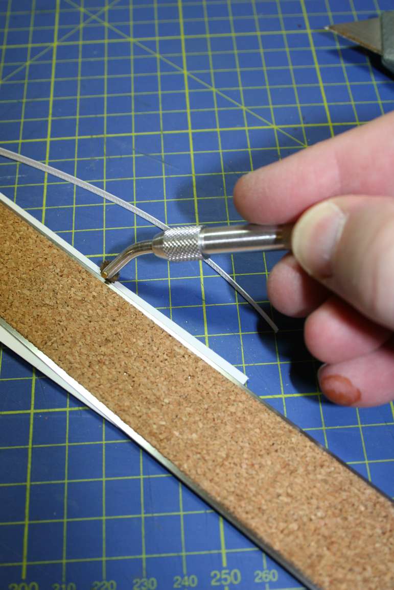

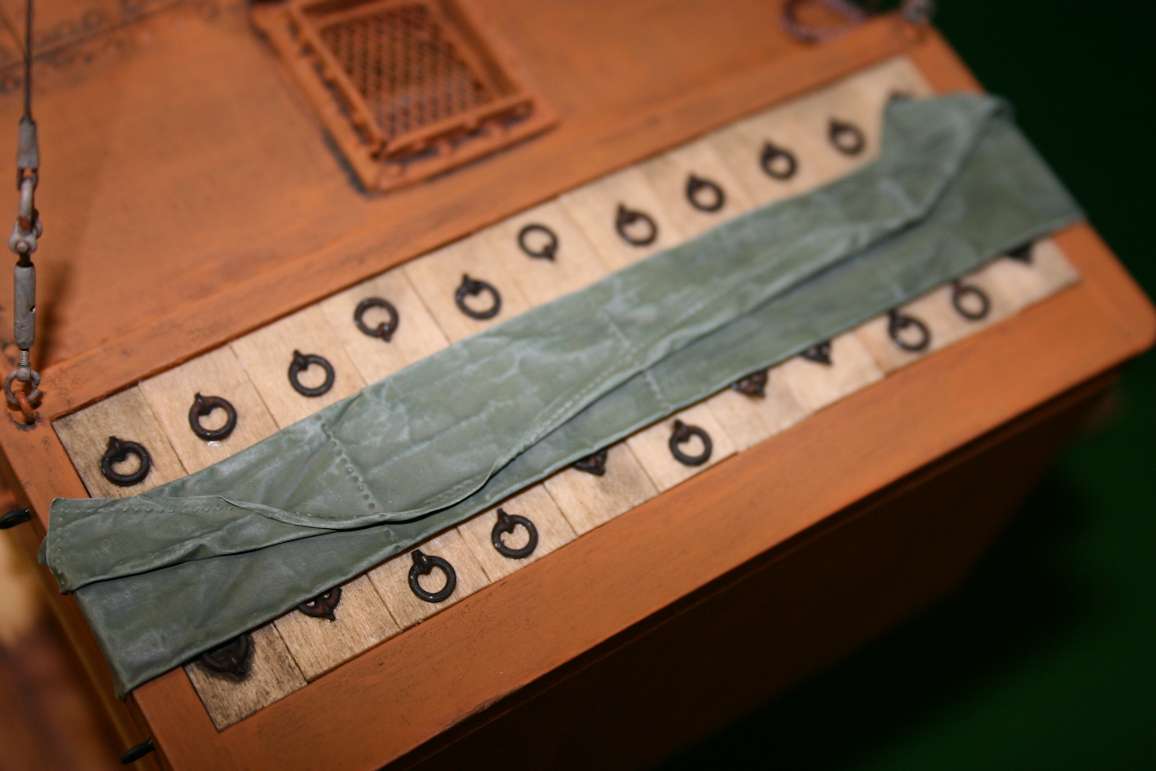

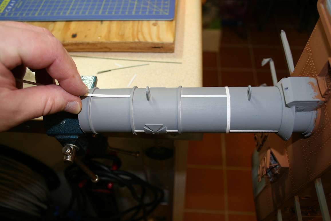

                                          Fred, As Jim mentioned the pounce wheel is an effective method of adding rivet heads.  On the funnel above I ran a pounce wheel down the edge of some heavy paper then cut the strip off and glued it to the funnel to make butt straps type joints.  If you don’t have pounce wheels or cannot get them you can use either a clock gear wheel or something similar and make one.  There are plenty on Ebay though:
                                          Pounce Wheel
                                          This is the funnel straps:
                                          12-10-08-03BenAinConstruction415
                                          12-10-08-04BenAinConstruction416

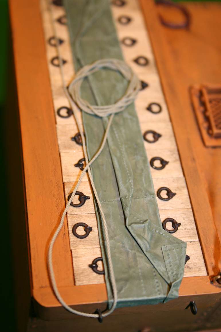

                                          They are also a very useful tool to create canvas covers from heavy tin foil, the type used to seal AC ducting
                                          06-12-09-04BenAinConstruction523
                                          06-12-09-05BenAinConstruction524
                                          03-01-10-03BenAinConstruction546
                                          06-12-09-06BenAinConstruction525

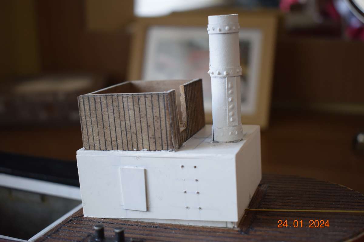

                                              Hi One & All

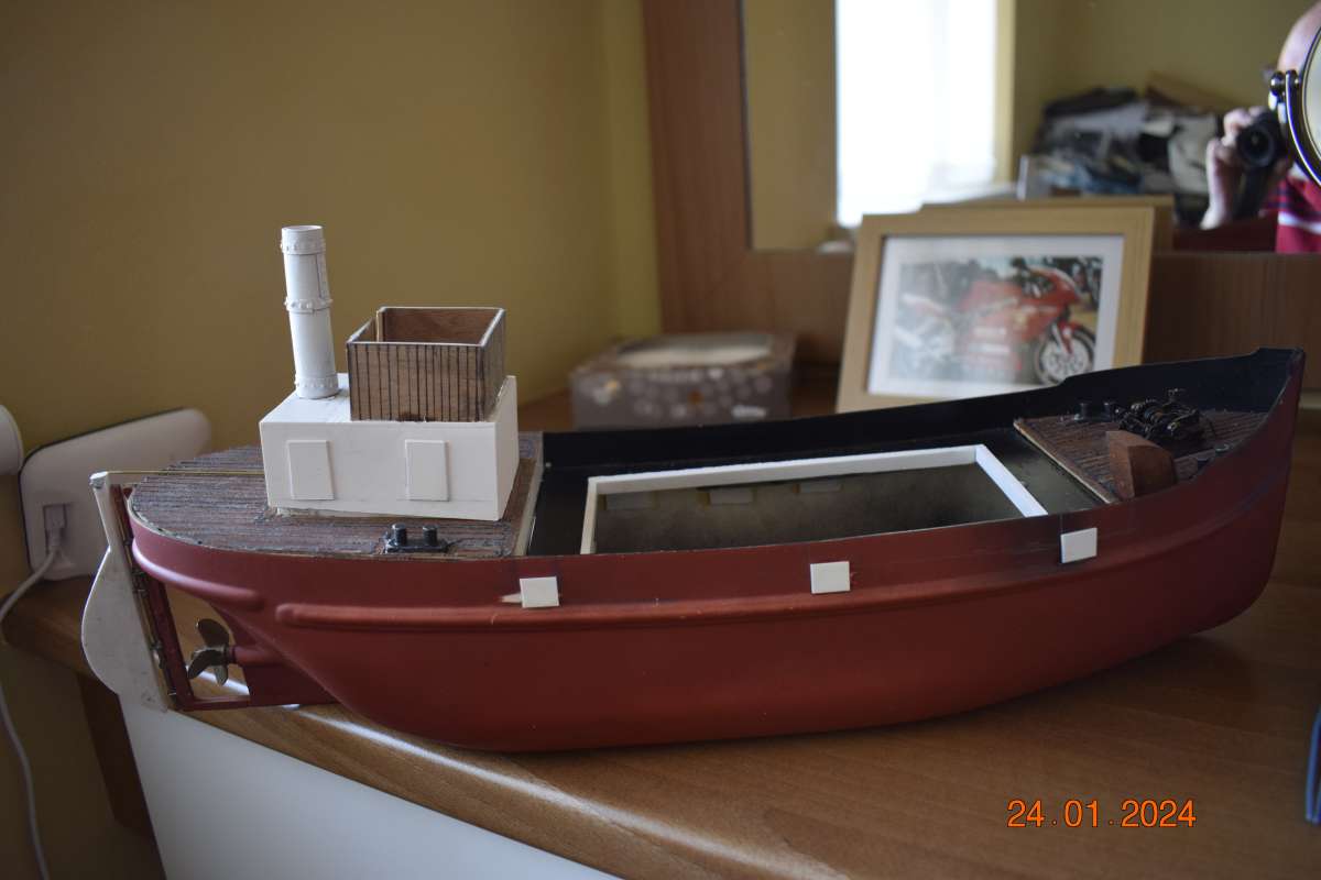

                                              I have now fixed the rear deck, and primed the wheelhouse, also fixed the freeing ports along with the rudder servo, I have gone with a mini servo and the control rod has been run along the rear deck to the rudder. in time the funnel will be Black with a Red topping, as for the wheelhouse I think I will use a light cream, ( I have a tin of light cream)
                                              Fred

                                                  Hi
                                                  Jim that it good news that you now have a working rudder, still have to finish fitting the servo, I must say that you seem to have got all the electrics sorted, all I know about mine is that the motor is an old one from Hunters systems so it could be a 380 as it’s that small, as for the ESC I think that I have a quickstart 10/60 in one of the box’s that I can use.
                                                  As for the wheel house I am just making it as I go along.
                                                  Looking forward to seeing how yours progresses
