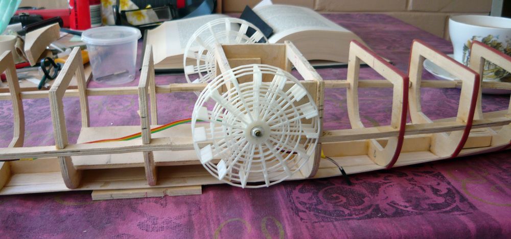

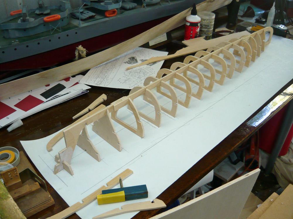

I based my model on a previous build of a paddler…….Jeanie Deans by Sandy Thomson
The plan is still available
By increasing the hull length by about 5 or 6 inches, the hull will be 7'-0" long and will transform itself into the correct scale length of the Great Eastern at a scale of 1 to 100
The hull section will need increasing accordingly by searching the net for the correct full size dimensions and then modifying the model formers
You will need to study the photographs for the rest of the build
