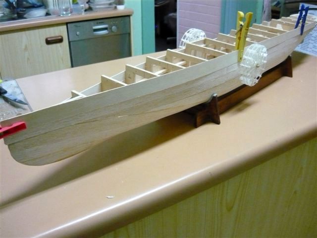

              #48128
                Hutch in Oz has started the planking process
                Are you going to use the card kit printouts for hull cladding, Hutch?
                You will need a drop keel for ballast, as Paddleboats are unusually unstable!

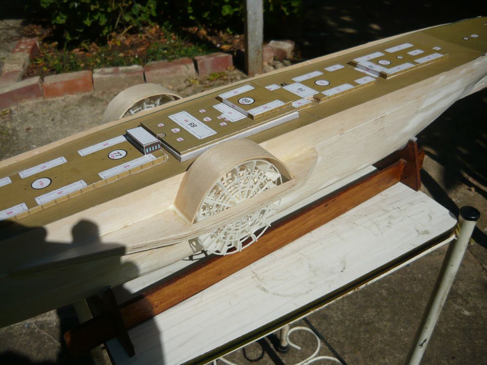

                            #48307
                              More pictures from Hutch in Australia
                              The 3D produced paddlewheels look excellent
                              The mixture of scratch built hull and commercial card kit pieces make an attractive build
                              Very neat and tidy work, Hutch………Will be a nice model for any exhibition

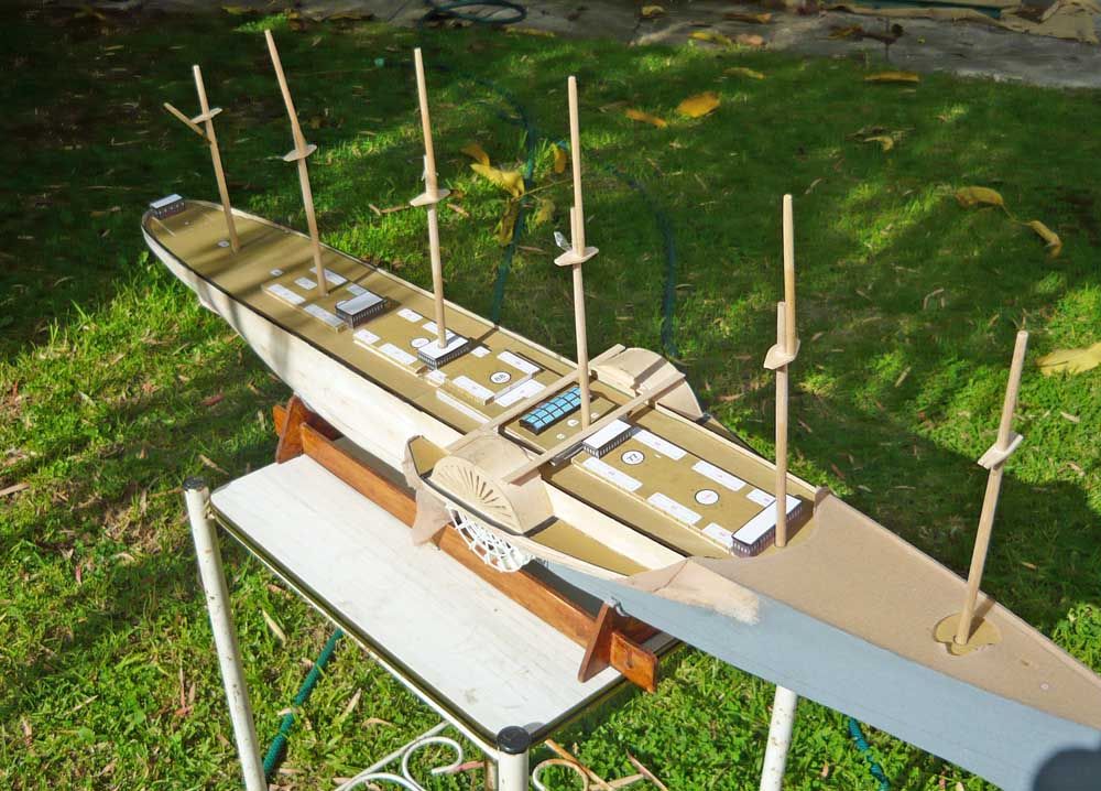

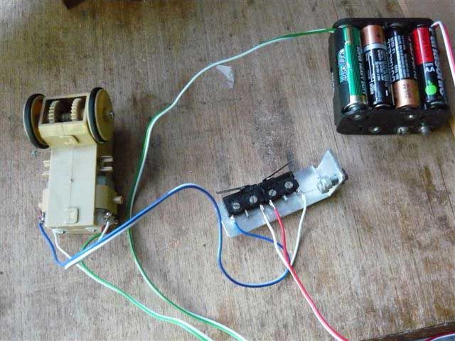

                                              Two more pictures from Hutch in Oz, before he departs on his mammoth cruise
                                              Work in progress
                                              Looking good Hutch…….It brings back nostalgic memories of a very exciting build
                                              Here`s a dinky little tank drive, just right for his Marcle card model…..Salvaged from a toy, no doubt
                                              Have a nice holiday, Hutch
                                              #48965
                                              hutch
                                                @hutch73959
                                                HI Bob
                                                Thanks for the photos and yes the tank drive did come from a broken toy but I do not know what make.as it was found on a kerb side when the dust bins are put out.
                                                .Tamyia make a very good one.
                                                Well the hull is all most ready for its top coat but will have to wait till i get back from the holiday.
