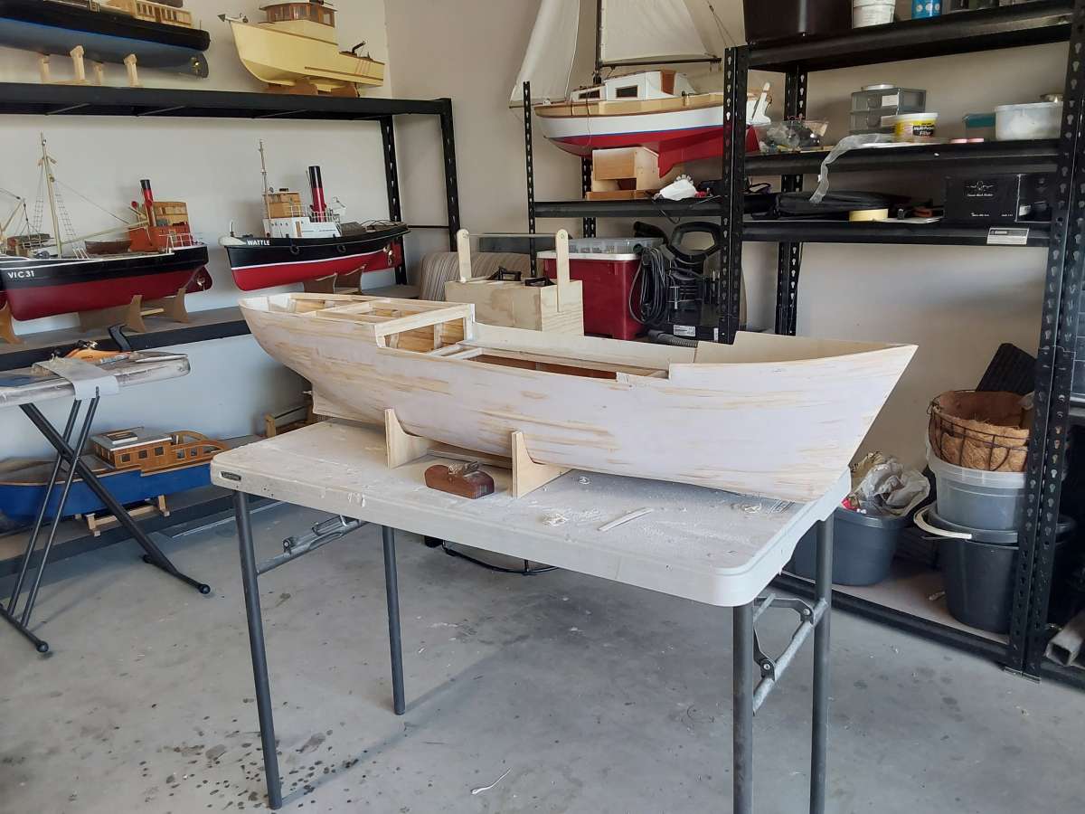

      The model of the Miner is complete and the new project is a totally scratch build of a Danish coastal trader the Caroline S. Unfortunately I haven’t been able to find any ships lines – plans so I’ve modified a set of ships lines I’ve already got on file by altering the length to beam ratio and also the stern shape. I think this will give a fairly good representation of true line of the full size ship. As you can see it’s going to be a big bugger,125 cm or 1/24th scale so lots of opportunities to incorporate lots of detail such as inside bridge furnishings and cargo details inside a partially open hold. Im really excited about this build20251215_06230520251208_12051720251215_062355

        G’Day Mick,
        That’s brilliant 🙂 bigger is better ! until you try picking it up !! but plenty of scope for detailing 🙂
        All the best from the UK Crew Happy Christmas
        Kind Regards  Ray
        #126980
          @timrowe83142
          Hello Mick
          The ocean level is going to rise when you launch that thing.  Easty’s Beasty!
          Serious question from Ray about how you are going to ballast it.
          You have a fabulous collection there.
          Tim R
          #126981
          mick east
            @mickeast46851
            Yes it’s going to be a heavy beast I’ve allready have a much modified hand trolly for launching so hopefully not too much strain on the ageing back.
            A happy Christmas to you all back in UK hope your not too cold ( it’s a oven temp of 36deg C here
            Mick
            #126982
              You might want to consider such techniques as ballasting after the model has been put in the water. I’ve seen this done with very large models where the hull was put in the water then ballast in the form of lead acid batteries were dropped in before finally putting the top on. It can be a bit of a faffing around though and I think it ends up putting people off.
              A much more elegant engineering solution is to fit ballast tanks and water pumps. Then you can drop a relatively light model on the water and start up the ballast pumps to draw in water to the ballast tanks ready for the morning’s sail. When its time to go simply bring the model into the side and pump the tanks out again.
              Its not uncommon for people of our age group to make a relatively large model and then find, due to advancing years or ever encroaching medical issues, that we simply cannot lift the model in and out of the water.
              All the best for Christmas Mick, all we have here at the moment is cold wet and windy weather. It almost makes you look forward to the next drought.
              #126983
              John W E
                @johnwe
                hi there, your model looks roughly the same size to HMS Lindisfarne, which I built a while ago.  I built this model at 1:48 scale, and, to ballast it, I originally had in 2 mobility scooter batteries which were 12 volts and they weighed roughly about 3 kg each.  The model was pretty heavy with the batteries loaded up.  Eventually, I put 2 smaller 6 volt batteries in and a lot of lead to make up the 6 kg.  I found this was easier to manipulate at the pond side to load up.  So have a good think about your ballast.
                As suggested by Richard, maybe ballast tanks filled with water may be a better option.   I am thinking about this for my HMS Lindisfarne model.

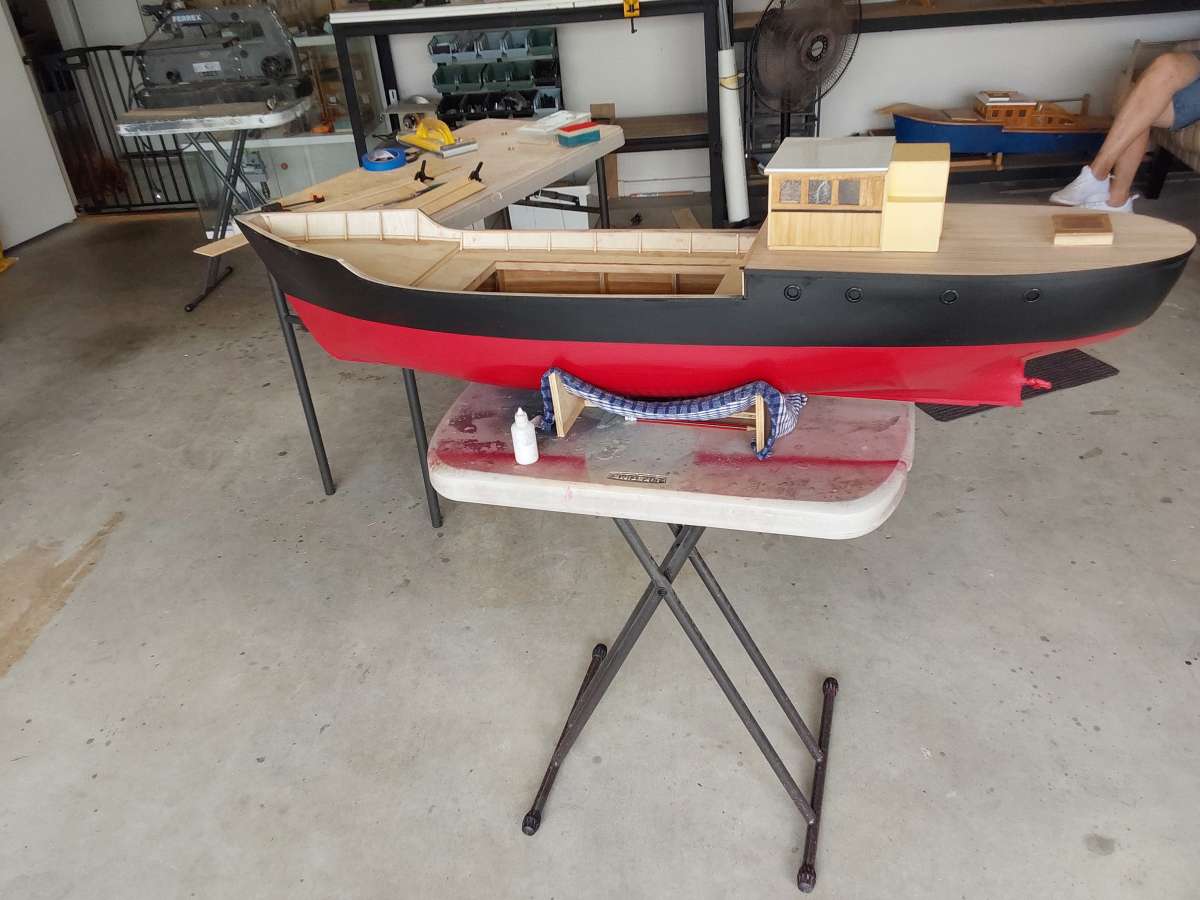

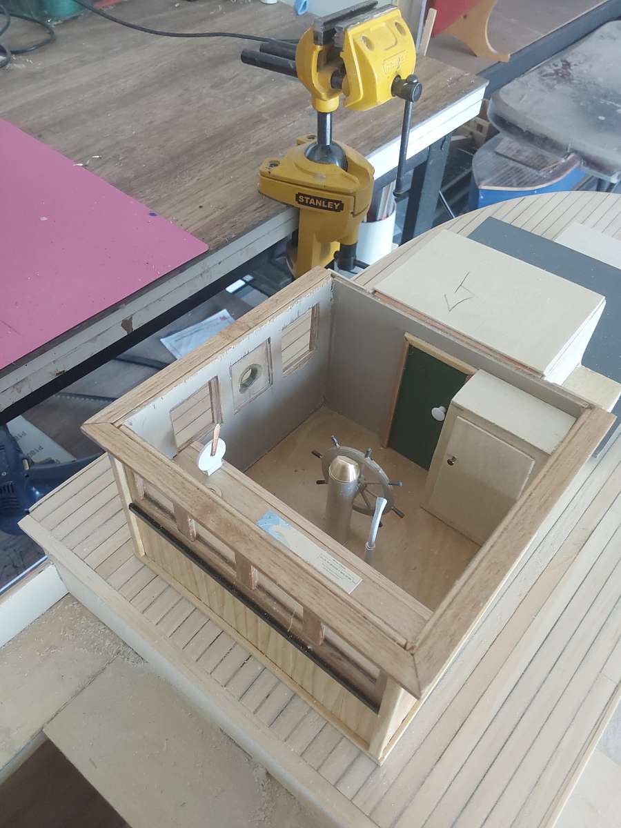

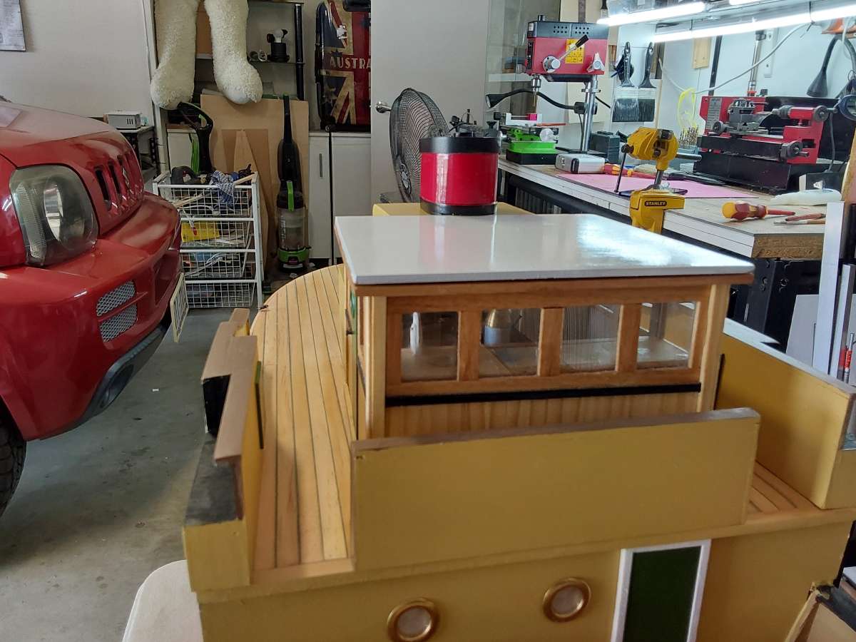

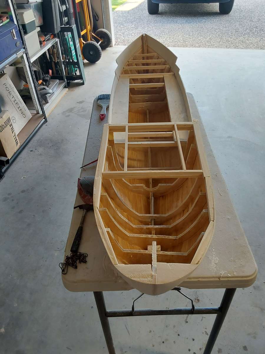

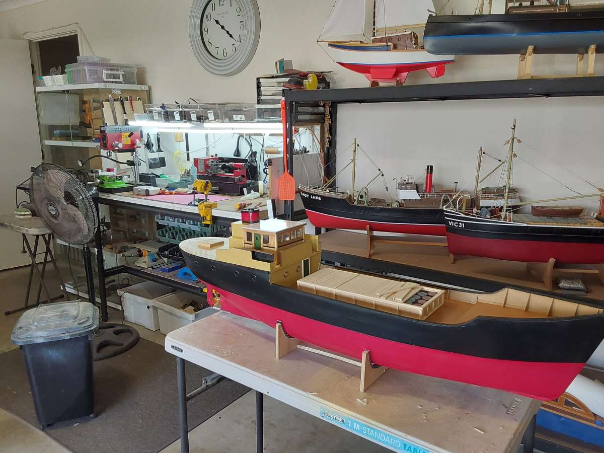

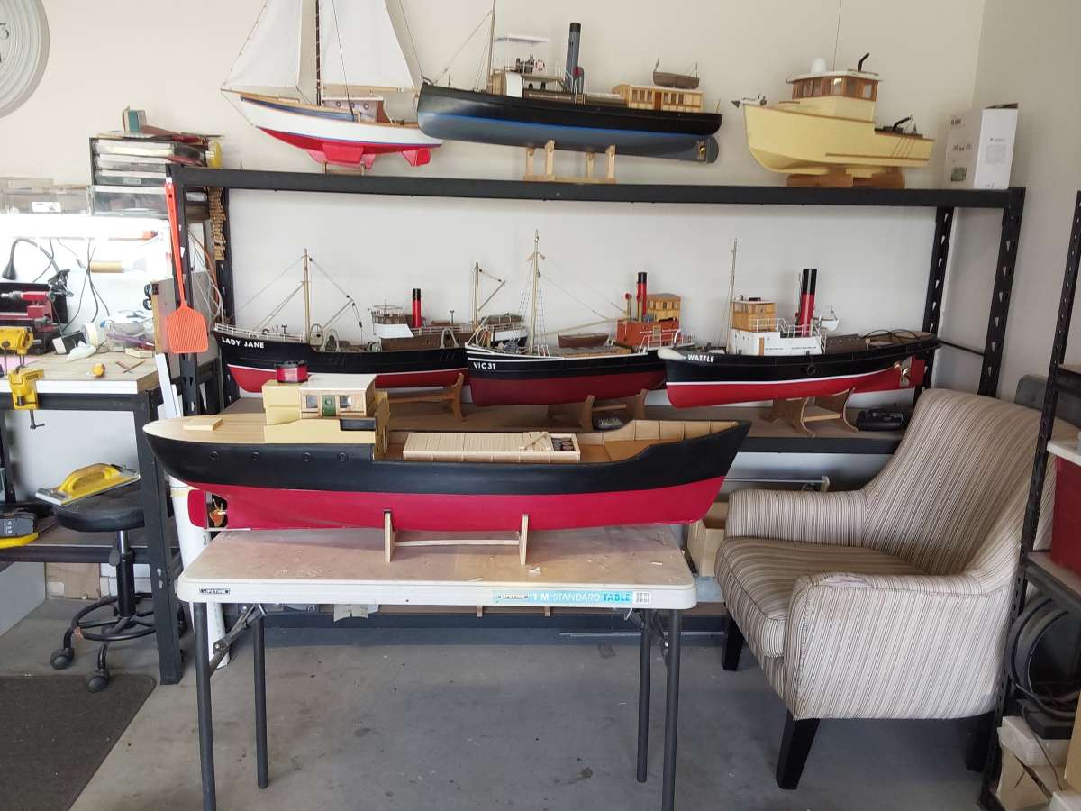

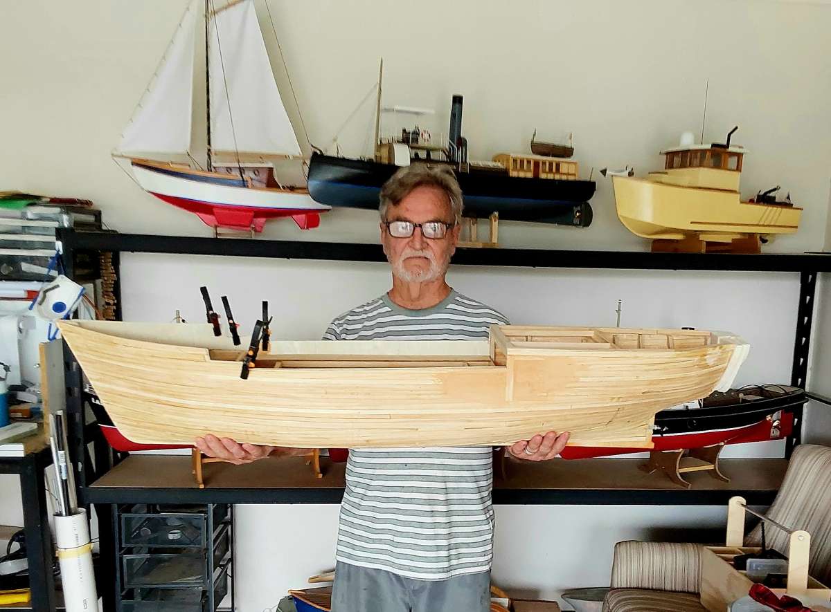

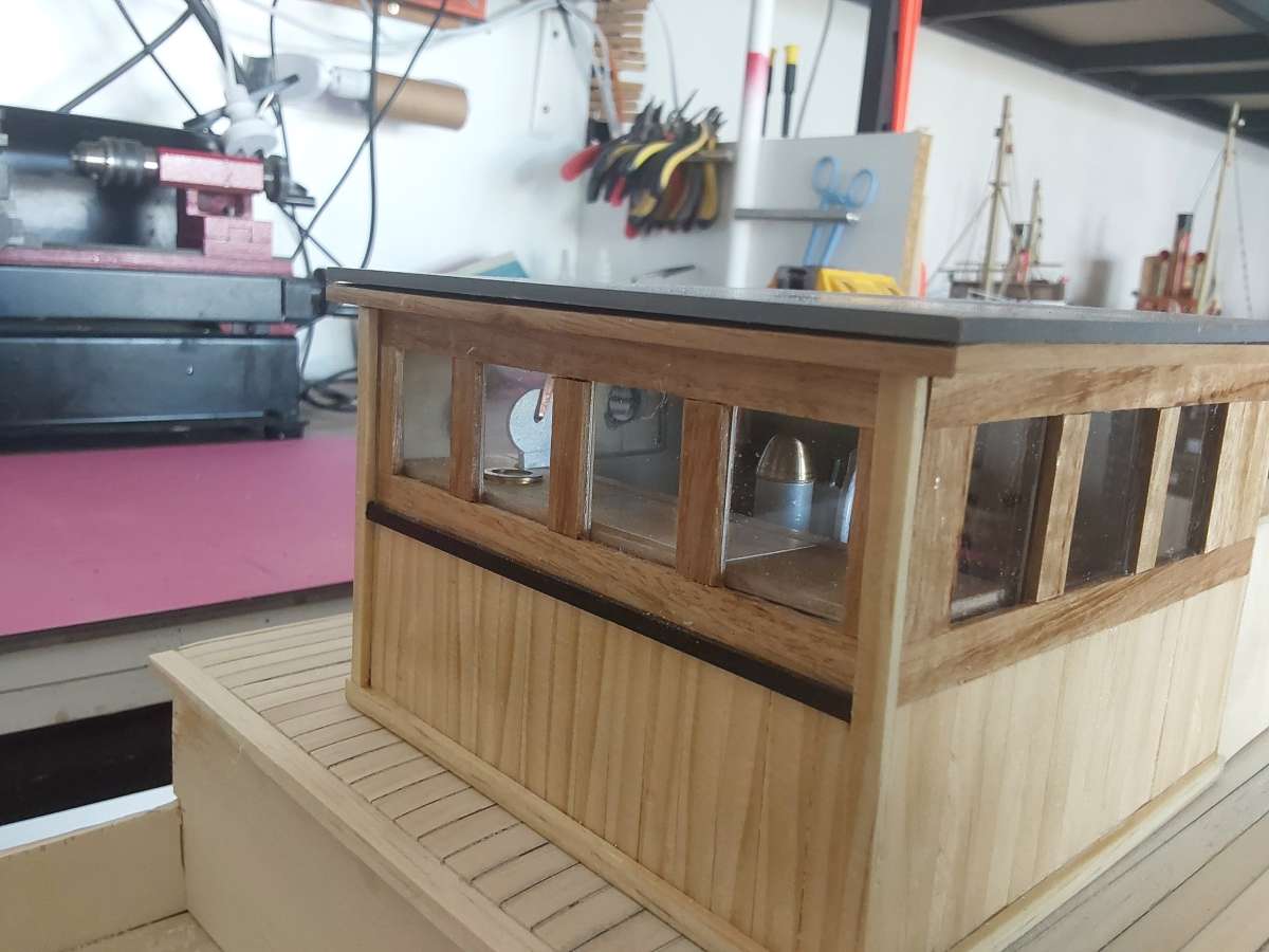

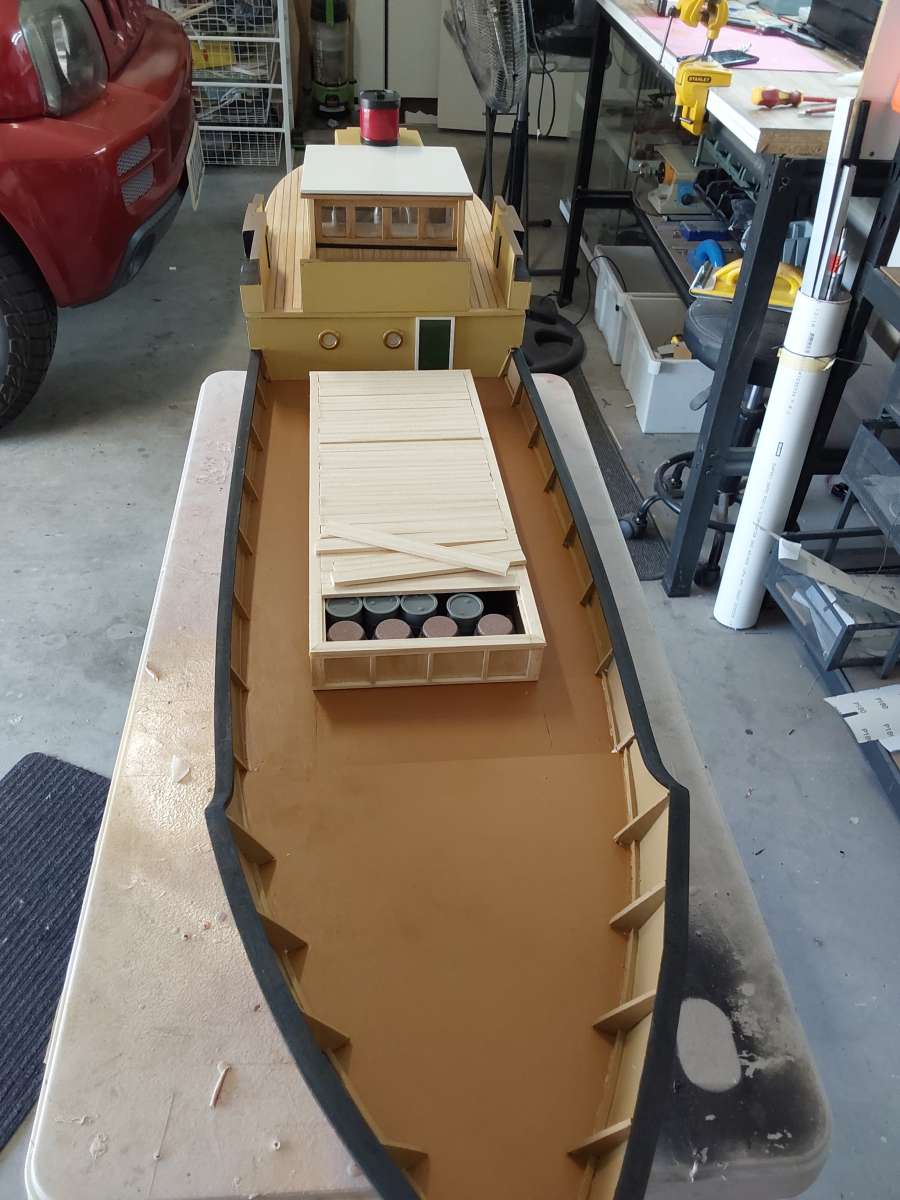

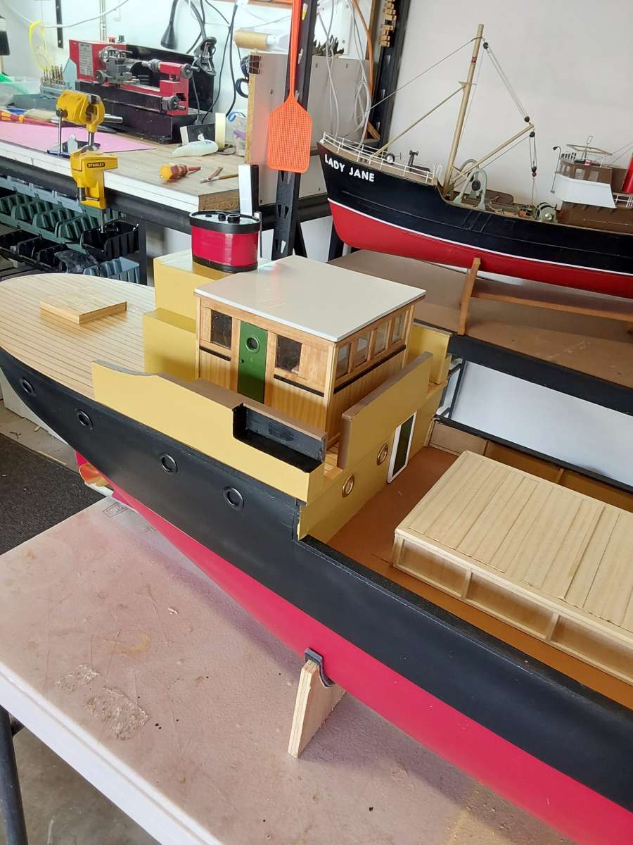

                    Been a while since I’ve posted so here’s a update of progress
                    20251231_11141520251231_11130720260113_10510820260120_10215820260120_10212320260120_10211520260120_10205720260120_102051
                    #127157
                    mick east
                      @mickeast46851
                      Just had a few days of painting a job I’m not fond of because I’m rubbish at it . The technique that seems to work reasonably well for me  is using acrylic model paints (mainly because it sands back nicely when you make a cock up as I frequently do)and then giving it a couple of coats of clear finish either satin or flat finish , I’ve tried gloss but in the scale I generally use 1/24 to  1/35 and it doesn’t seem to look good. Im going to start manufacturing some deck hardware next on the lathe and milling machine , now there’s job I really enjoy doing just as a break from the superstructure and hull.
                      As normal constructive criticism always welcome.
                      #127158
                        I also find that acrylics with a protective clear coat works well. The matt and satin finishes are best for medium and small scales and give a more realistic effect. Gloss can give a ‘toy boatosh’ appearance and also shows up imperfections more.
                        #127161
                        Philip Oxley
                          @inonowt
                          I’ve been using white primer undercoat acrylic and Dulux acrylic for colour.  The Dulux decorator centre will mix one of their 4800 colours or scan and mix to your sample.  Watered down a bit to reduce brush marks and several coats to cover. A 250ml sample tin costs about £7.00.  Then Rustins satin finish exterior gloss. £10.00 for 500ml from Toolstation.
                          For white finish, just primer undercoat and Rustins.
                          The Rustins looks well just as a varnish on wood.

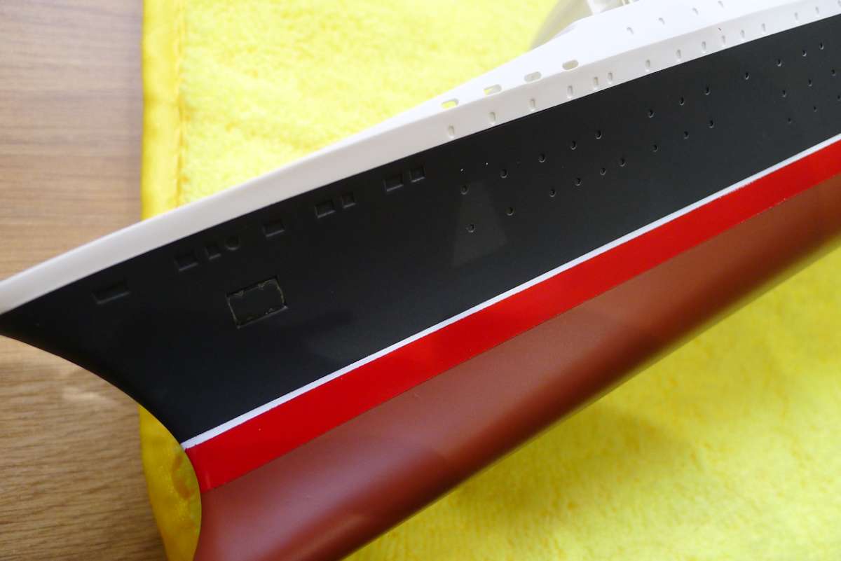

                                    This is the box art Colin:
                                    IMG_0001
                                    And this is the hull paint job:
                                    13-01-26-03GunzeSangyoQE2Model36
