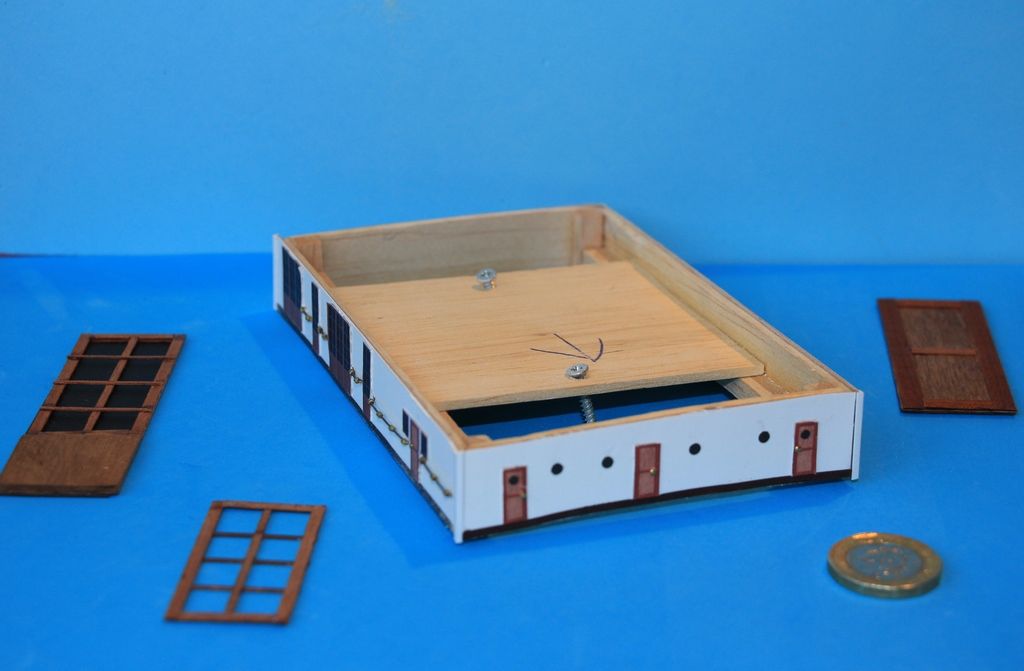

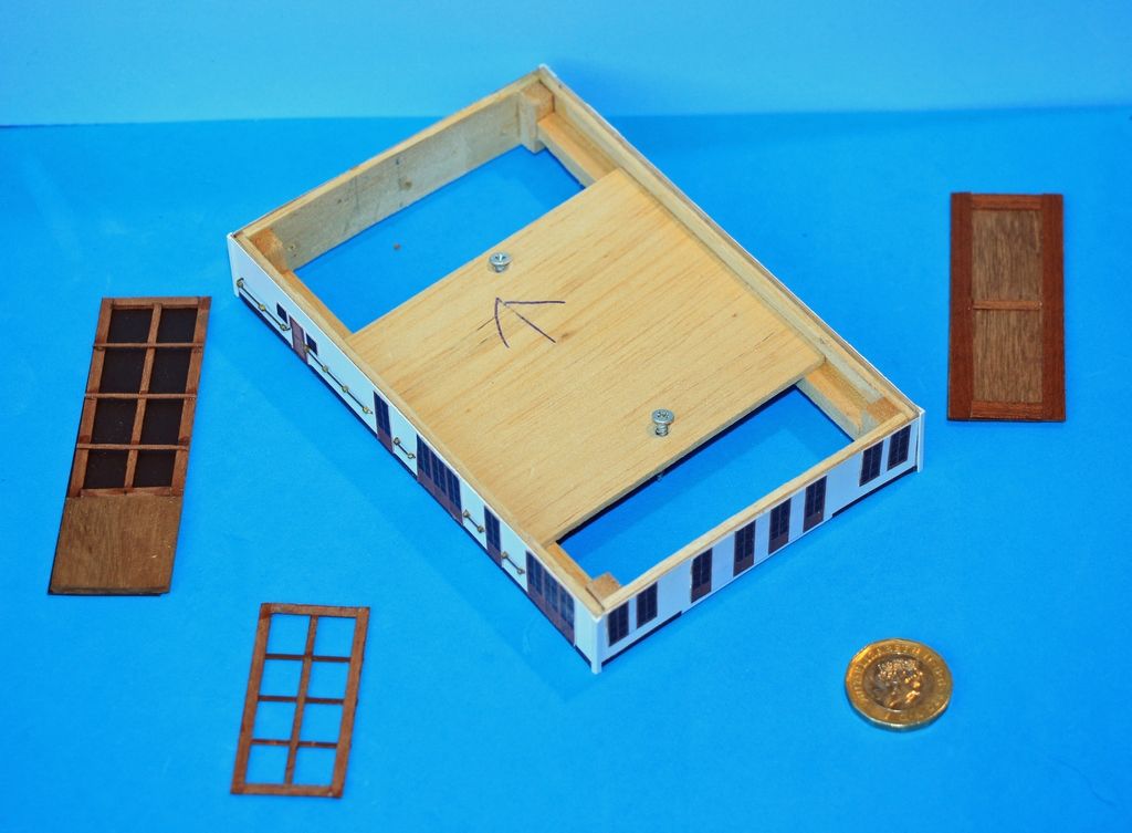

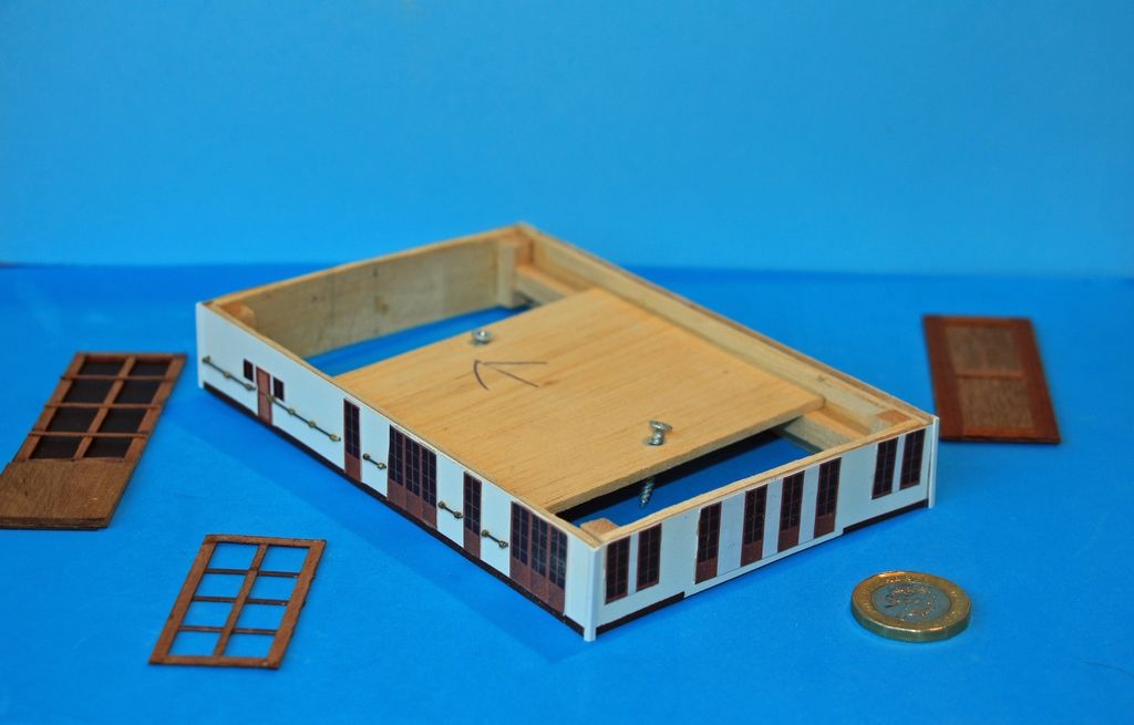

                  I have been intermittently busy on my liner experimenting with techniques for making the houses under the shade decks. They are only 2cm high so adding decent detail is tricky. The photos below show progress to date.
                  The walls are 0.5mm ply, sealed and then sprayed with white primer followed by Halford's Appliance White gloss. I prefer this to styrene sheet.
                  To make the windows and doors I constructed them in a larger size to no particular scale and then scanned them into my PC. I cleaned up the images in Photoshop Elements then transferred them to a MS Word document which enabled me to tinker with the size and proportions until I got what I wanted. The images were then duplicated in Word and printed out onto photo paper. I used double sided tape to stick them to the deckhouse walls and then sprayed over with Halfords matt spray to seal them. Next time I will seal the photo paper back first before sticking them on to get a better attachment although the ones shown turned out OK.
                  The handrails needed 1mm outside diameter knobs on them but my smallest eyebolts are 2mm and looked too big. I therefore stripped the insulation from some computer wiring and cut it into small slices which were slid over the brass wire handrail. The rail was painted brown and then the knobs in Tamiya gold leaf. This method had the advantage that the wire ends of each handrail could be bent to insert into small holes in the deckhouse and the assembly pressed flush so no need to drill lots of intermediate holes.
                  Brass doorknobs were very small round headed Amati brass pins and look fine. The portholes are punched out of anthracite colour pinstripe tape with a revolving leather punch to get the different sizes and simply stuck on which is adequate at 1:150 scale.

                  #81934

                      #81936
                        @bobwilson59101
                        Colin,
                        Great job on the deckhouse – similar method to my own –
                        #81937
                          Thanks Eddie and Bob.
                          Bob, yes my techniques were influenced by yours having read the book! At this scale it is as much about artistic effect as faithful replication in modelling materials. Some extra complications in that it needs to be splashproof on a working model and the need to accommodate deck camber on the forward and aft faces.
                          This deckhouse is largely concealed on the lower promenade deck. I hope to improve standards on the others a bit now I have got a bit of practice under my belt.
