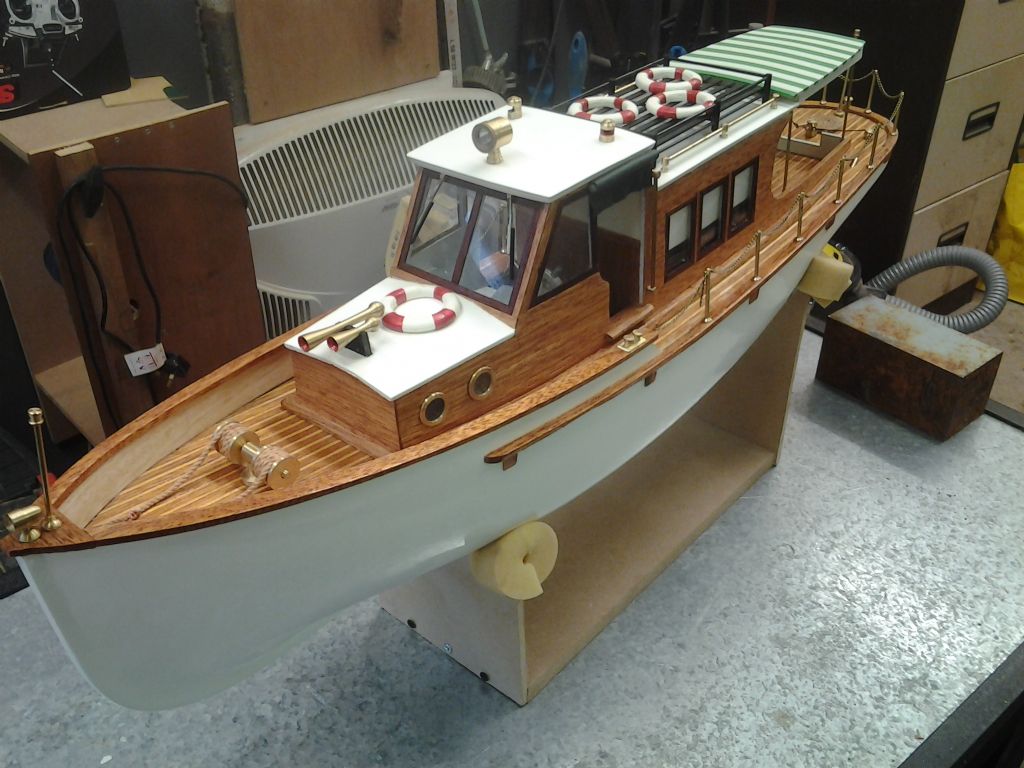

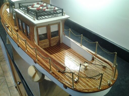

        Hi everyone, new to the forum, is it scratch if you buy the hull then build the rest youself? thoughts please.20150321_173602.jpg
        #56615
          Ralph,
          Welcome to the Forum and thanks for the impressive photo, there are people on here who love this type of model boat!
          In answer to your question, it would not normally be considered scratch as the hull is a major part of a model boat and scratch is usually taken to mean that you have pretty much built the whole thing from modelmaking materials with perhaps the exception of things like the running gear such as the propshaft and propeller and some fittings such as the anchor chains etc.
          Buying the hull and building the rest tends to fall between 'semi kit' and 'scratch' by common definition but it doesn't matter how you choose to build your model as long as you enjoy yourself. The only time that the balance between 'built' and 'bought' items matters is if you are entering it into a static judging competition when you would be expected to identify all the bought in items as marks would be deducted for these.

              That's a very nice model, you've built there, Ralph
              I like the outboard mounted handrail stantions……Not seen that style before

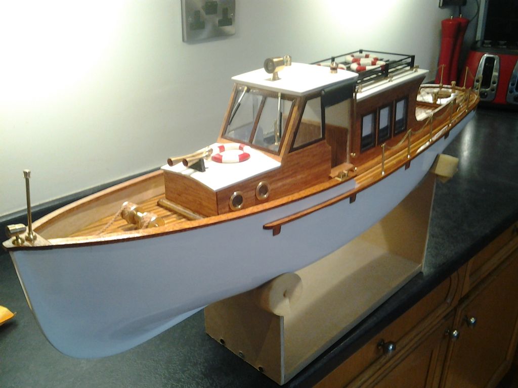

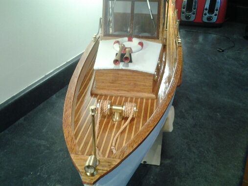

                20150321_173434r.jpg20150321_173509.jpgthank you all for you welcome and kind words, I am new to model boat building "Sprite" being my first build since making airfix models as a kid, a long time ago. the terms used are new to me hence the question about scratch builds, now I get it, MSC Sprite was the Manchester ship canal MD's launch in the 50's / 60's 33' long and a lovely sight to see, I can remember seeing her in Old Quay yard in Runcorn, looking for some insperation on the internet I came across a picture of her being scrapped and also an old plan drawing, unfortunately she had been converted into a dive boat, sorry end for a beautiful craft like her. that was it, it had to be her for my first build.
                #56628
                Ralph Pinch
                  @ralphpinch41762
                  Bob, made the handrail stantions from brass rod and bar, spent a lot of time turning them then nearly didn't use them, I thought that they looked to much like pop rivets lol.

                    Whether you call it scratch or not, that is a very impressive and attractive model. Have you had her afloat or is she a static craft?

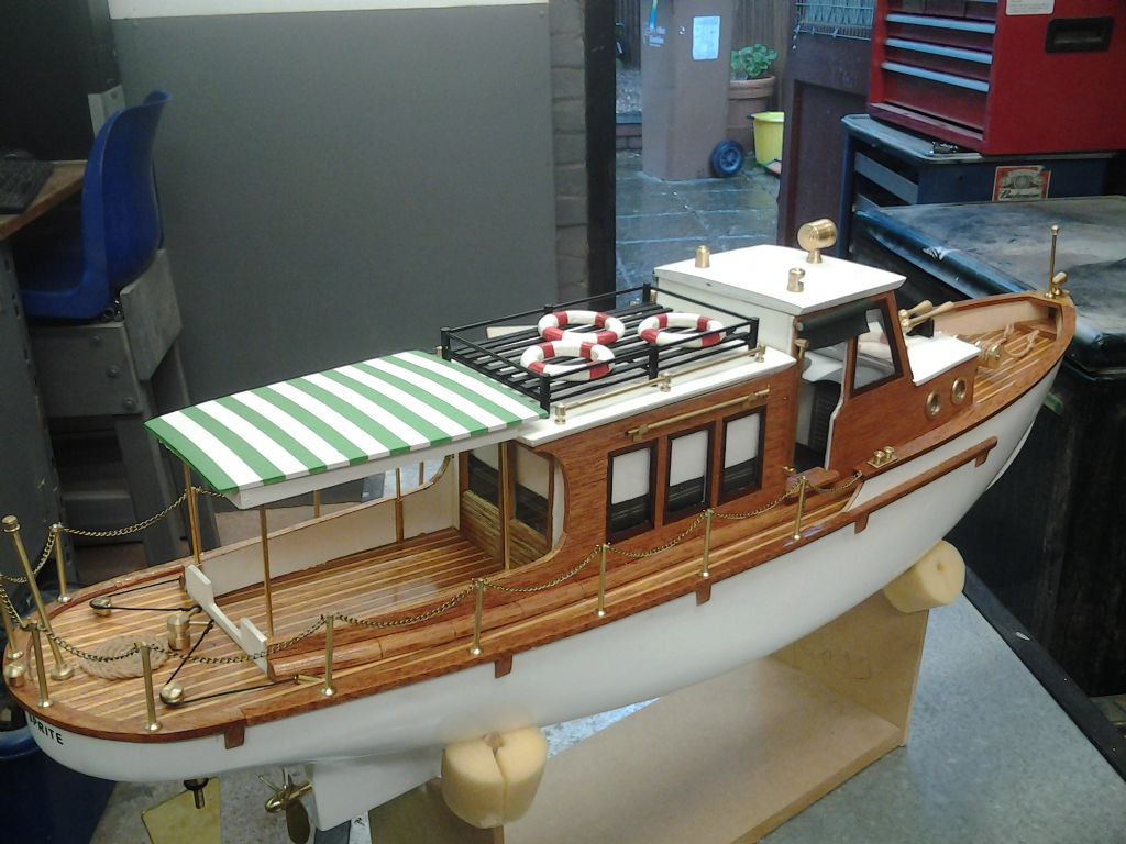

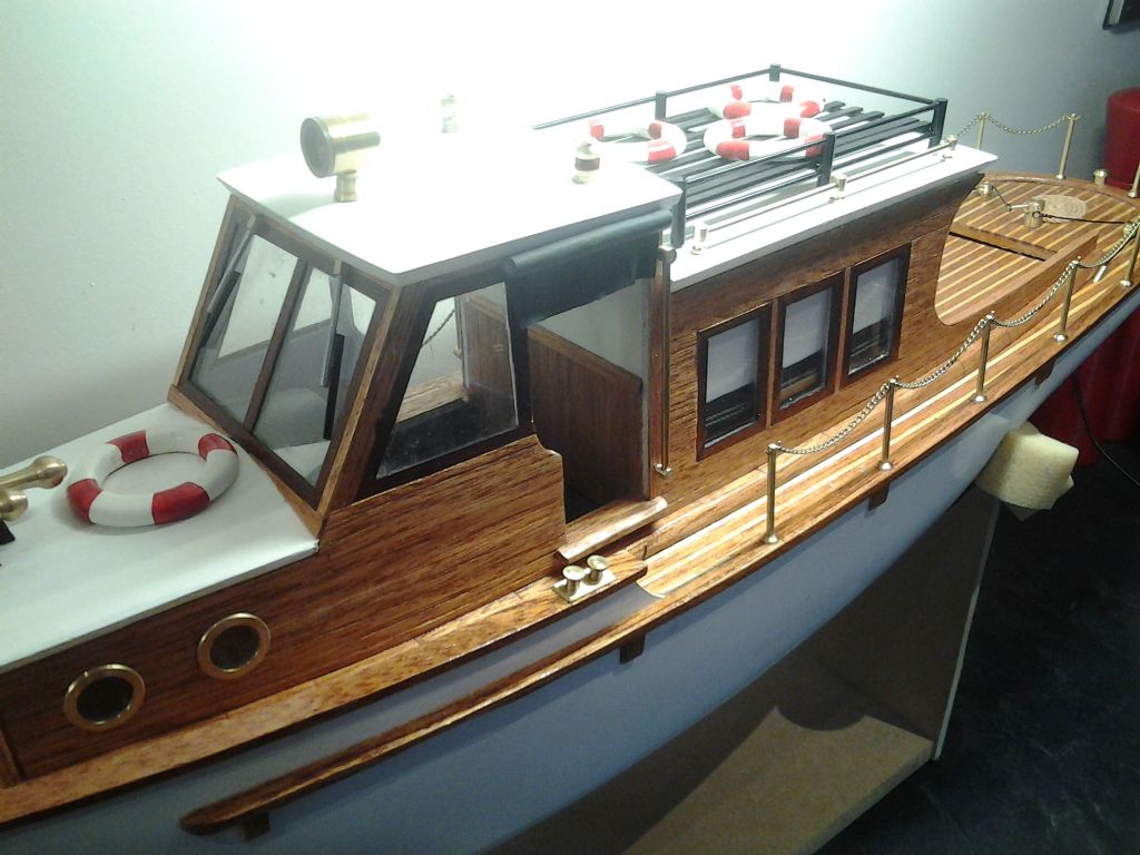

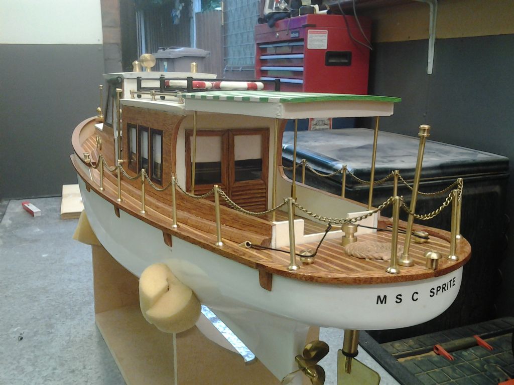

                                    20150330_152230.jpg20150330_152350.jpgHi all, finished the build today, enjoyed every min, can't wait to start Paul's VGC.20150330_152250.jpg
                                    #56895
                                      Very nice Ralph
                                      I like the green and white canopy………I might do the same for Lady Joyce, as plain white is a little bland?
