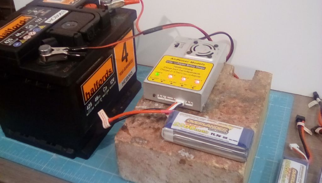

                Yes as Chris says the balance plug is essential to monitor each cell as it charges and detect if a cell has failed, I have a couple of Lipo chargers which display each indicates the state of each cell.
                A chap on Mayhem connected a 12volt lead acid charger to the power terminals on a Lipo and it blew up !! I think ignorance of the different type of battery causes most of the issues that hit the head lines, Lipos have the better power to weight ratio which is great for flying but not any better for boats in my opinion.
                #104696
                  Hi Richard,
                  Just as an addendum to my last night post the 3 lights on the right come on as each cell is fully charged, so they are charged one after the other, this is my field charger set up I have known folk using their car batteries all day and not getting home in the evening hence the Halfords battery.
