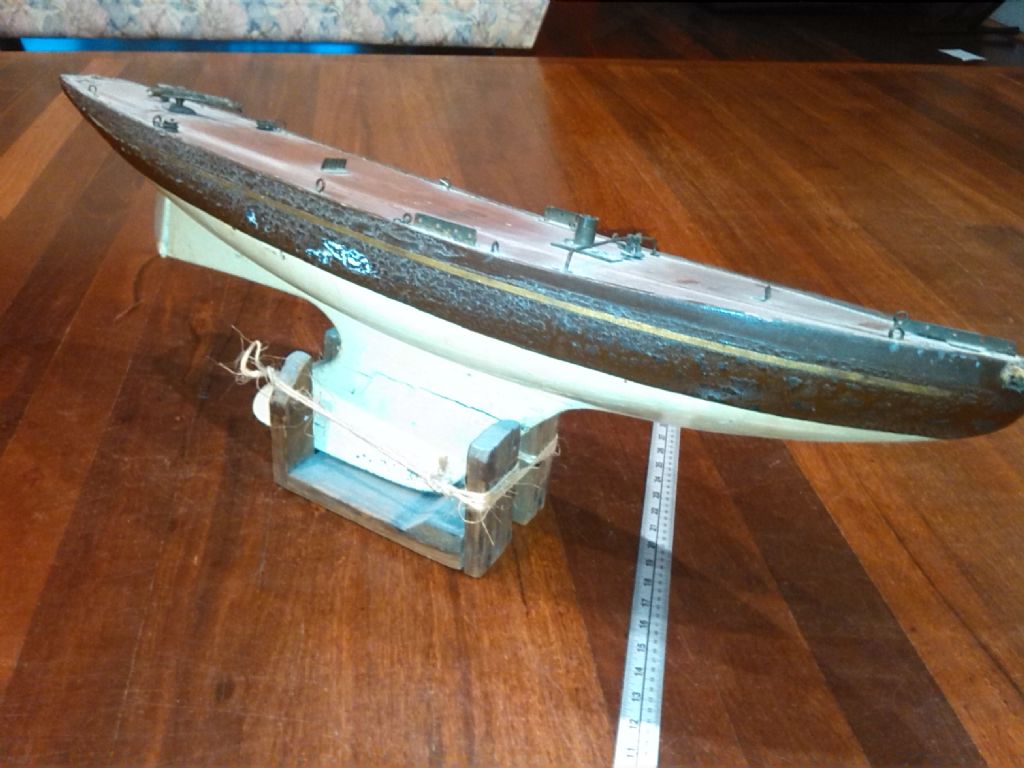

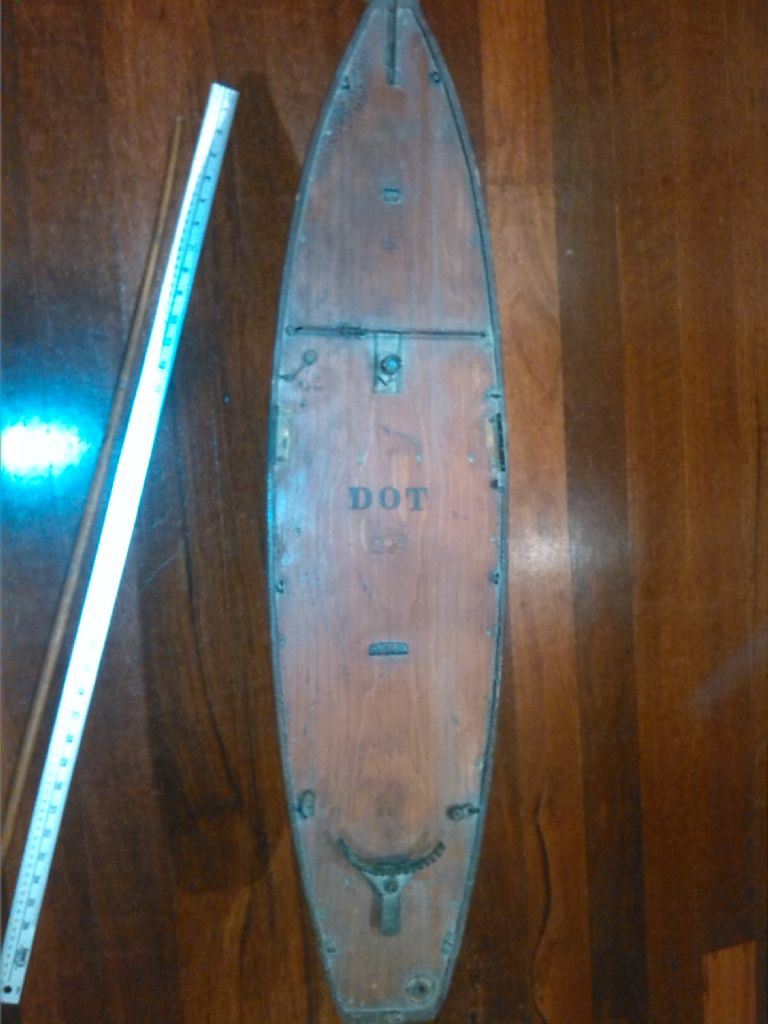

      Hi Folks >>
      New here and new to model yachts. I am sure I will ask a stack of dumb questions as I don't even know what questions to ask so searching it a but difficult.>>
      Anyway – I have this old pond yacht I think it is a 36R and from the 1930"s (been in the family for years). 36" Long, 8.5" beam, 10" from bottom of keel to top of deck
      I don't have a rig for it and would like to build / buy one so that I can put it on display rather that have it hidden in a cupboard.
      Any help with id and how/ what to rig it with would be great.>>
      Thanks>>

              Looking further into the Nylet site (which Mattias) mentions above, they make sails in cotton for vintage yachts and also offer a restoration service. The material most model yacht sails from the past were made from was Union Silk, this hasn't been available for many years. An excellent item on painting and finishing is in the Members Contributions section of this site, written by Paul –
              The rules for the 36R class state the model should fit in a box 37" x 9" wide x 11" deep –
              The Vintage Model Yacht Group may provide further help –
              Your model is fitted with a Braine Quadrant which was an early type of steering mechanism
