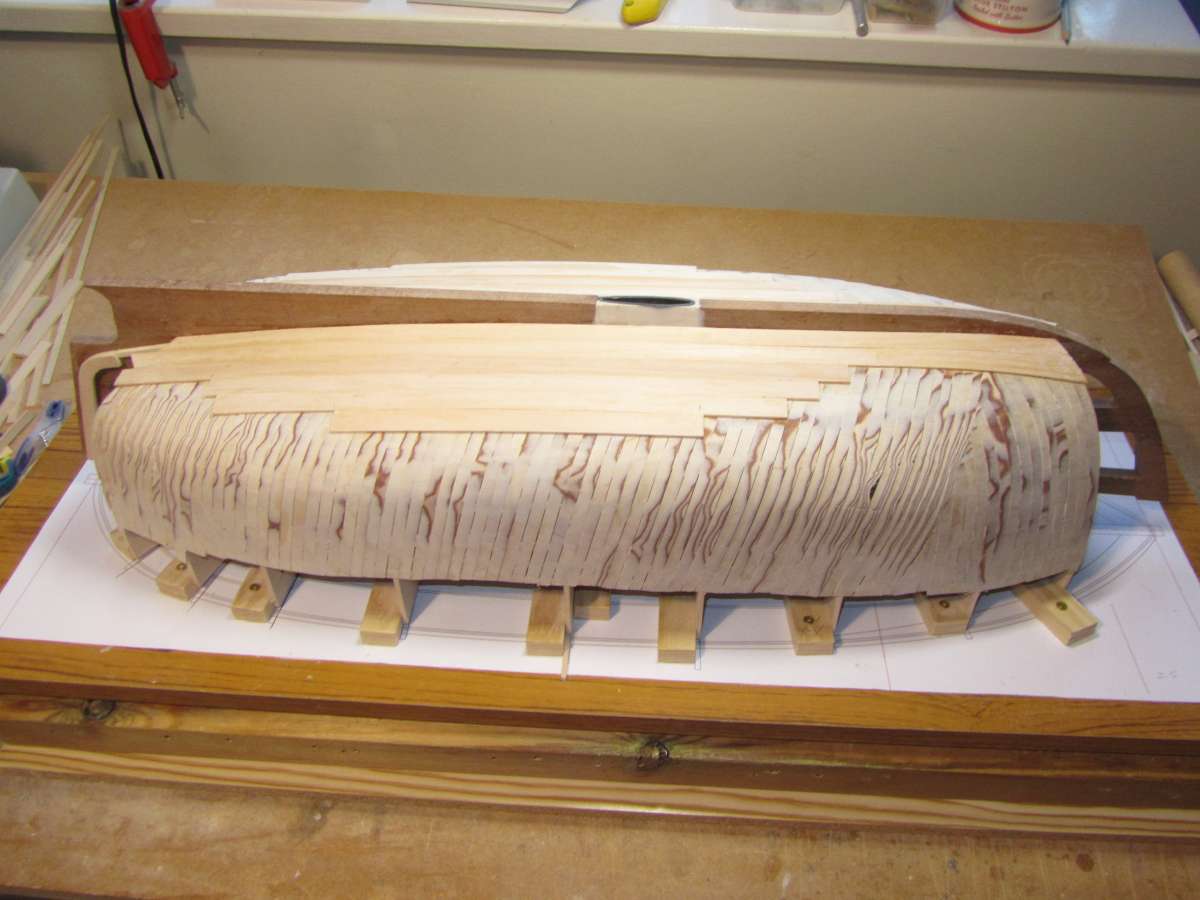

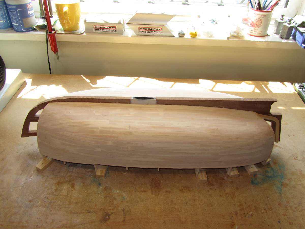

                      Second layer is progressing – certainly quicker than the first! Using different widths of planks to deal with the curves.
                      Hull 15
                      #125555

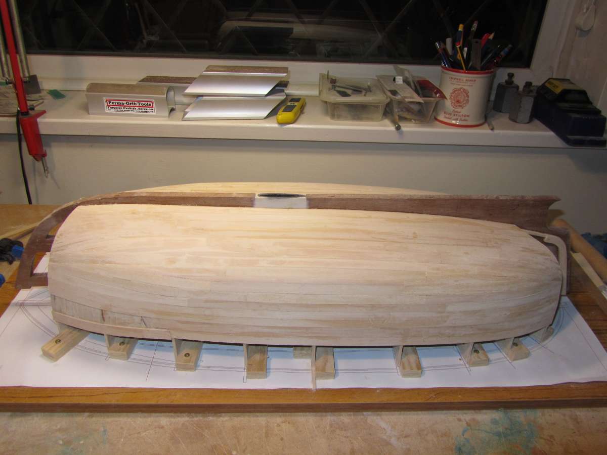

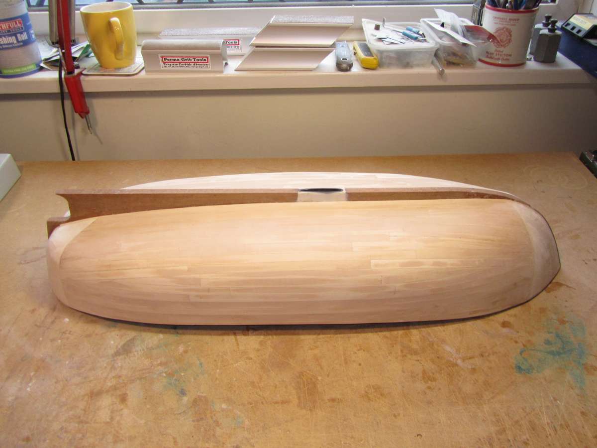

                        Couple more planks to fit and that’s the planking completed. Not planned but one of the advantages of longitudinal planking is that if any is visible under the paint it would look like a planked hull whereas diagonal planking would look a bit odd.
                        Not correct for a Fairey though as the hull is made up of a number of laminations.
                        Then to tackle the bow and stern in balsa.
                        Hull 17

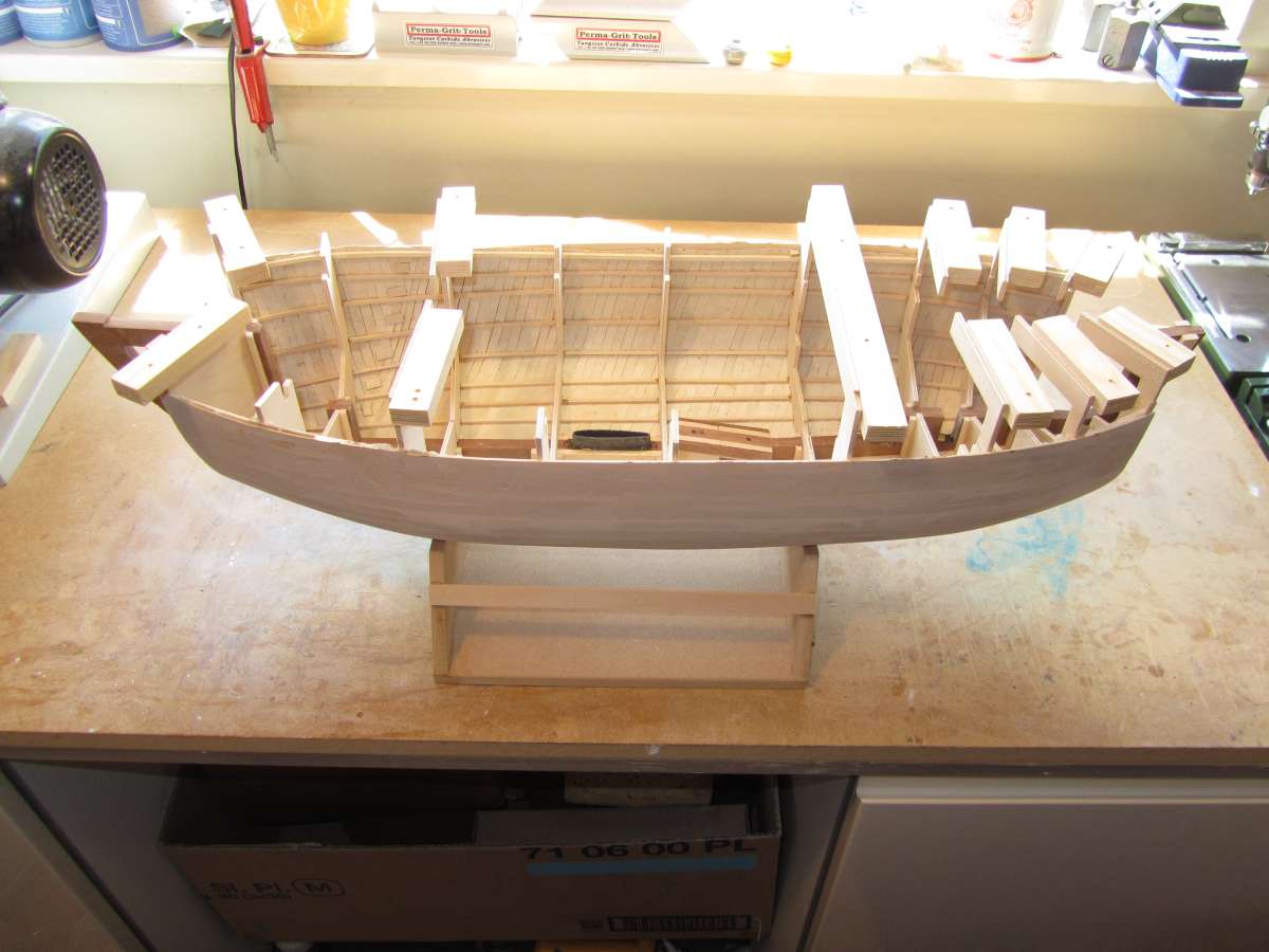

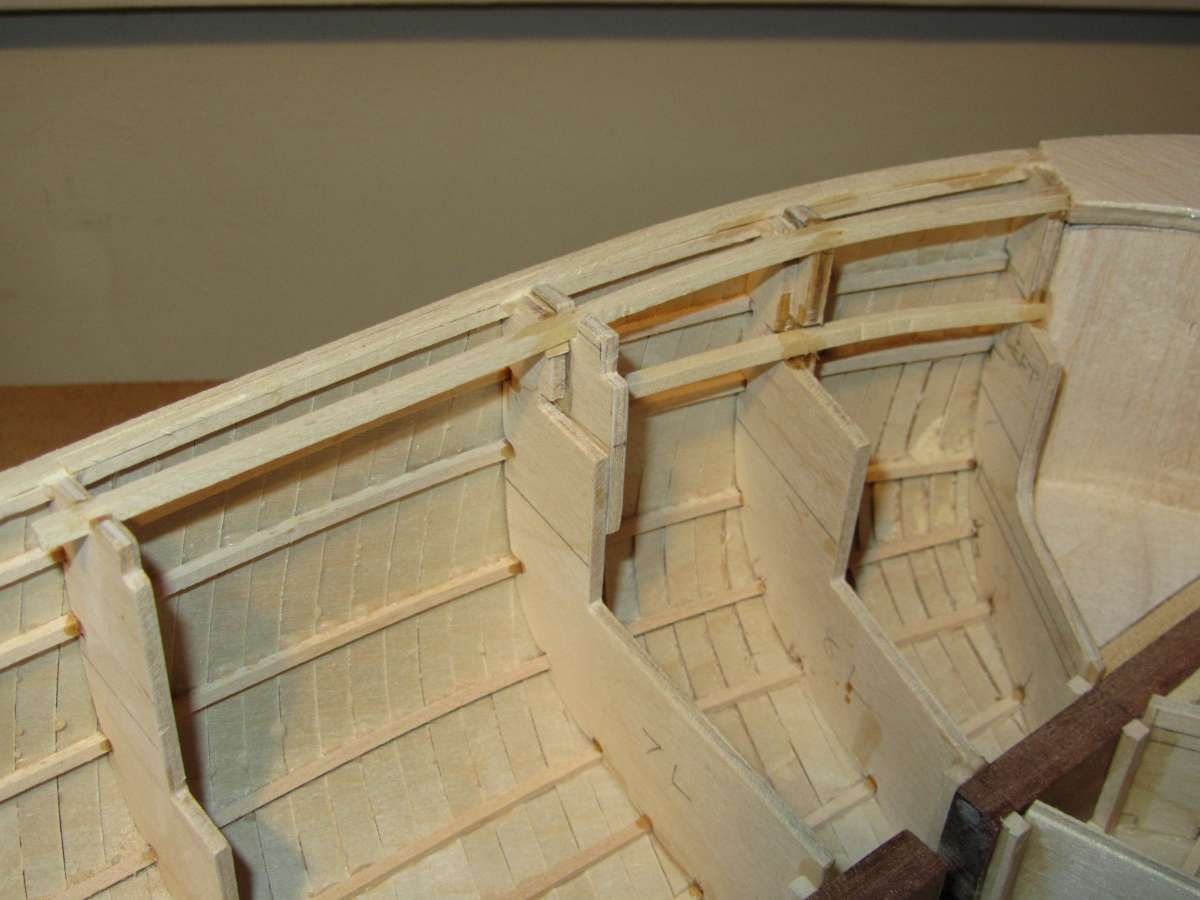

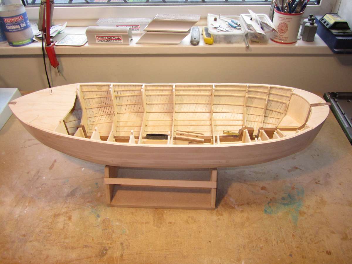

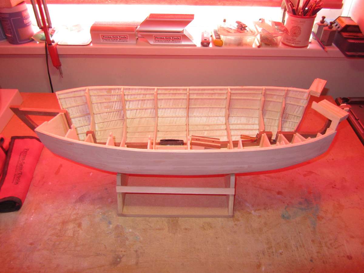

                                Whilst waiting for some bits and pieces for the Faun I’ve taken the Fisherman off the building board. Even though it’s quite a big hull it’s surprisingly light. Weight will soon increase as the build progresses though.
                                Just making a breast hook – usually I incorporate this at the start of a build but the frame extenders etc. were in the way and building upside-down – which will support the balsa blocks. Once the bow is done I’ll start on the stern.
                                Hull 18
                                Hull 19
                                Hull 20
                                Hull 21

                                  It’ll need some weight to get that buoyancy under control!  Beautiful looking hull.
                                  #125712
                                    Thanks Richard. The drop keel will help, but as you say it will probably need more!

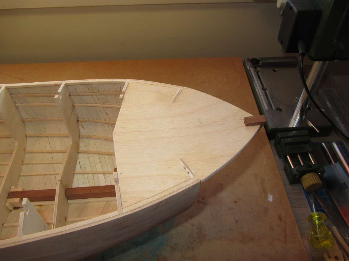

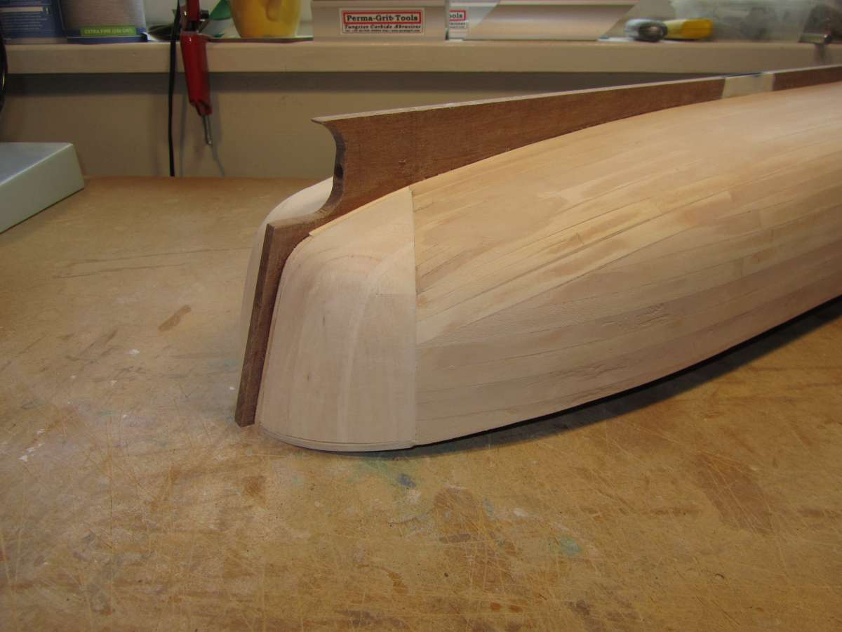

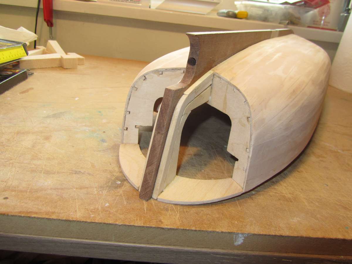

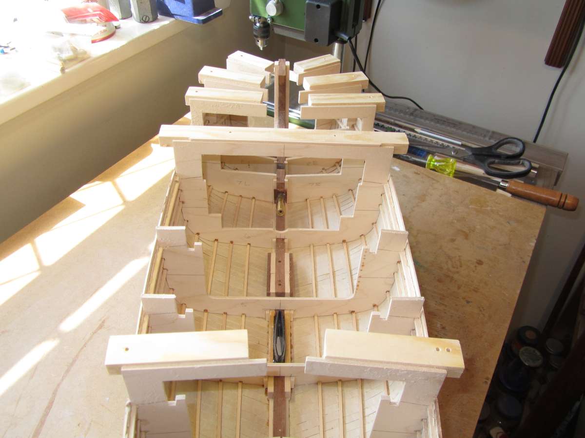

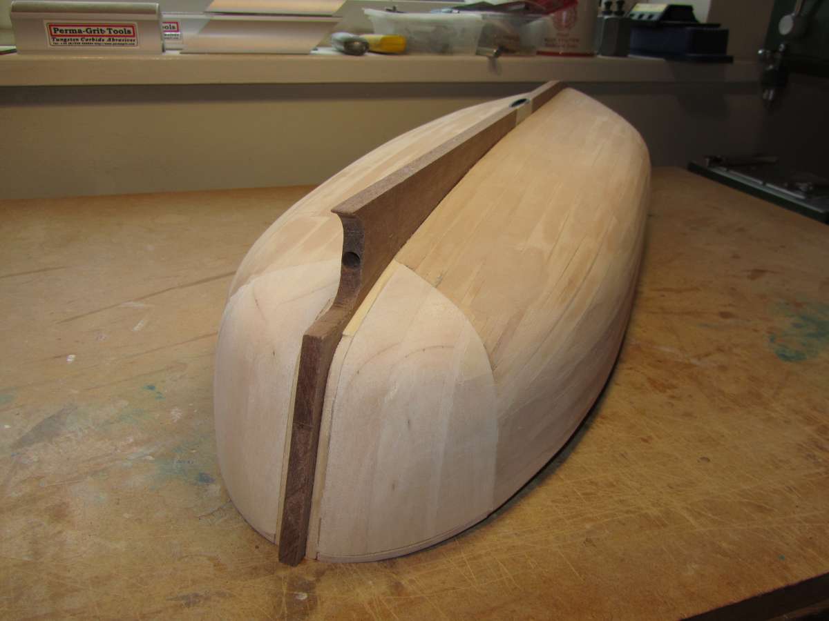

                                      The shape of the breast hook was determined by making a cardboard template, cut out of 3mm ply and then glued in place. The bow was then laminated with 3mm balsa sheets, originally bought for possible planking. Ran out half-way through so had to place an order for more from SLEC and got some 19mm as well to do the stern and stocked up on ply and mahogany to make the postage viable. Once the glue had dried I sanded it to shape. Some minor filling required and that’s done.
                                      Cut out and fitted the stern piece, again after making a cardboard template and have started the balsa blocking. The internal part will be cut out before gluing in place to allow access for the rudder installation and the rear seating.
                                      The hull is beamy because of its ship’s lifeboat roots but I’m liking the look of it – it’s not built for speed!

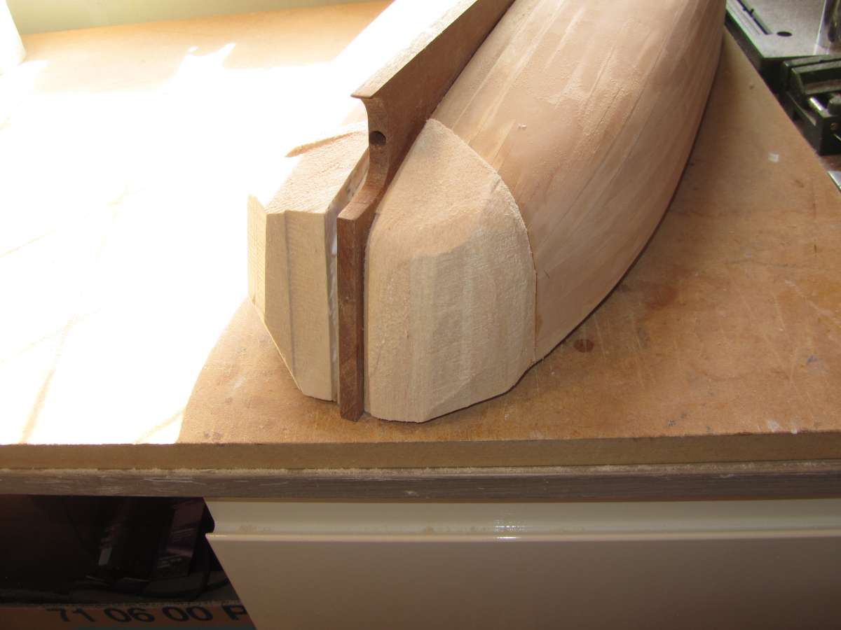

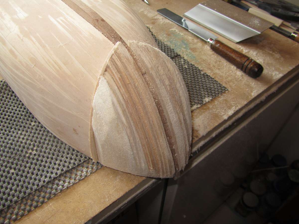

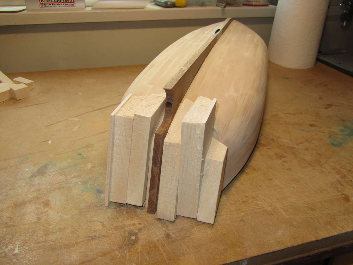

                                        Finished laminating balsa blocks for stern, cut out internally and then glued in place followed by a rough cutting and sanding. Tomorrow I’ll sand to shape.
                                        Hull 30
                                        Hull 31

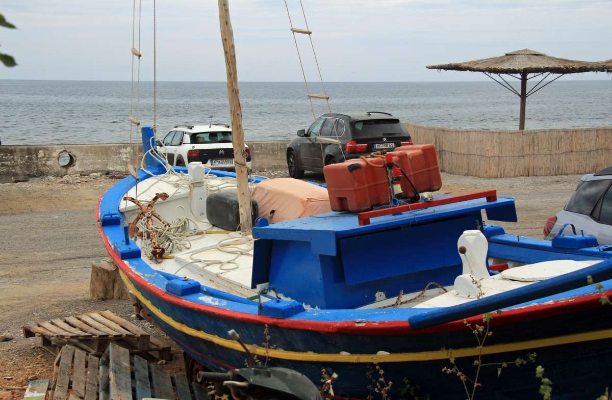

                                          Having just returned from Greece I am temped to make another plank on frame fishing boat to a different configuration to my last one.
                                          GFB

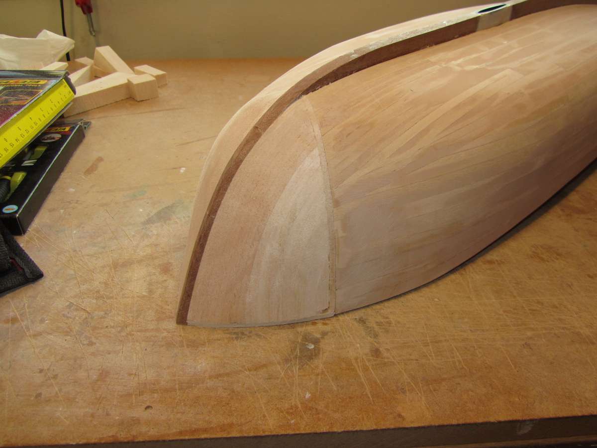

                                              Blocks at stern now sanded to shape, glad that’s done as I was a bit apprehensive! Again, bit of minor filling required. Will tackle the whole hull now and get it ready for lightweight cloth and Eze-Kote.
                                              You can clearly see now that the hull was originally designed as a ship’s lifeboat.
                                              Never say never, but having built two plank on frame hulls that will probably be it. Pity really, as I’ve learned so much including things that I’d do differently.

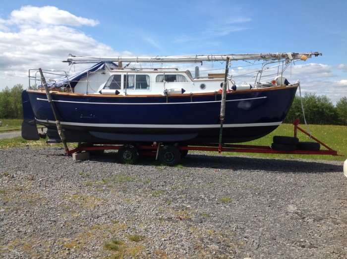

                                                #125792
                                                  Yes, even with the full-sized boat the waterline is pretty low down, so as you say giving plenty for wind to act upon. I shall only sail it in light breezes and have the motor to fall back on. At least I’m using a drop keel, unlike the real one, which will offer some additional lateral resistance.
                                                  As with a tug I might have to add some ballast.

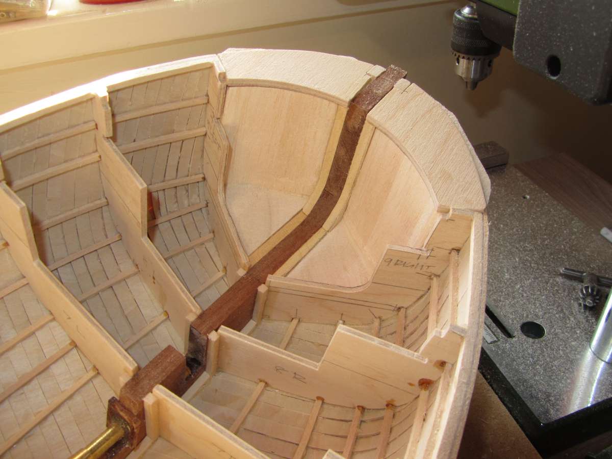

                                                    #126893
                                                      Back on the Fisherman now. When I took the hull off the building board I sanded the excess planking along the deck stringers – but was a bit enthusiastic along one side with my Proxxon narrow belt sander and with the bass stringers being quite soft took too much off in places and there was some unevenness – I mentioned earlier about using power tools on model boats!
                                                      So first job was to remedy this by gluing two small section, square bass strips alongside each other. I then sanded them down by hand!
                                                      I then started on the stringers for the coamings but noticed I’d got one of my dimensions wrong for their positions – this was on one of the angled frames so unsurprising I guess. I also needed to extend the deck stringers back to the first of the angled frames to provide support for the deck around the coamings – each rectified with a couple of small pieces of ply.
                                                      I’ve decided to coat the inside of the hull with West System Epoxy Resin, so have ordered some today. Need to do it whilst I still have good access, so will do it as soon as it arrives.
                                                      Frames were drawn up with a view to having the cabin removable but because of the problem of the mast position and my experience with Faun, the cabin sides are now going to be fixed with one or both roofs being removable. To facilitate this the frames are going to have to be modified insitu and additional stringers installed.
                                                      I’m now back on the “drawing board” drawing up the cabin sides so that I can see what needs to be done with the frames.
                                                      So, as with Faun, this is another design that will evolve as I go along, a lot I think! I definitely won’t be doing this build as a plan!
