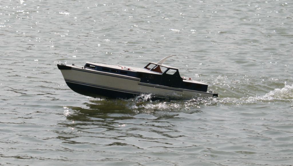

                          The remotored Tintagel has just had her first taste of the wet stuff. OOOPS ! I think I may have overdone it a tad. Take your pick from
                          1/ rat up a drainpipe
                          2/ bat out of hell
                          3/ Sh*t off a shuvell.
                          She really does move a bit smartish on the old 12v sla battery but with the 14.4 nimh pack, wow ! I need to get her onto a bigger piece of water so I can speed check her.I couldn't open her right up on my pond but still clocked her at 18.6 mph. If she tops 25 mph, I will be well happy.
                          Mike

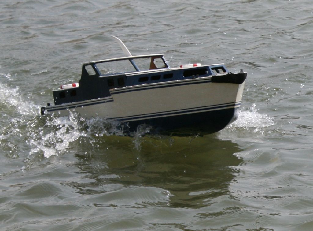

                                        Today I took "Tintagel" to the club water for a proper trial. I am very pleased with the results and clocked her at a top speed of 23.7 mph. Probably get a bit more when the lipos arrive as they give me an extra 2.8 volts over the sla batteries I had in her today.
                                        I must say that I could get to like this brushless mullarky. smiley
                                        Mike

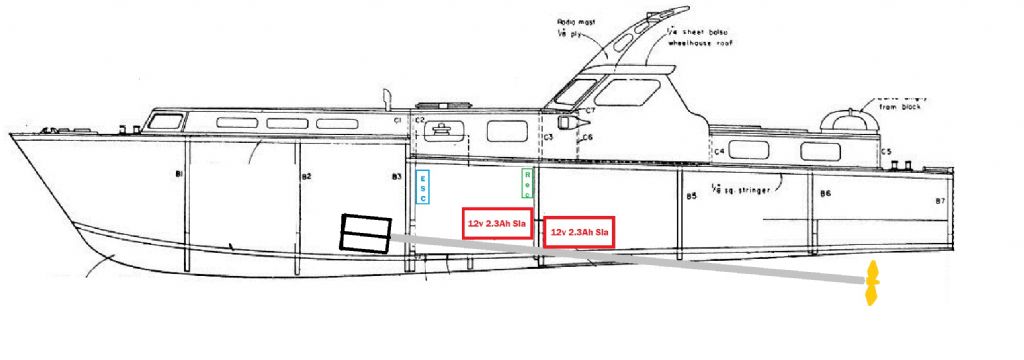

                                            I'd take a guess that the present battery is somewhere towards the stern……………..
                                            #50854
                                            lnvisibleman
                                              @lnvisibleman
                                              This will give you some idea of internal layout. Please do not scale ! lol
                                              Mike

                                                -Move (one of your) batteries to the front of the boat to get the boat more level on the water, that probably gets your top speed a bit higher and if not then at least it looks better.
