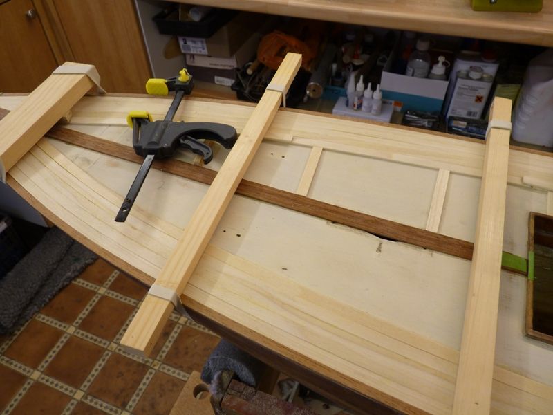

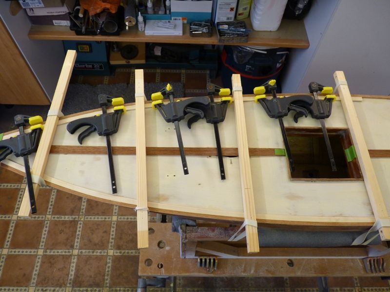

                      Coincidentally we are attempting something similar to your decking request this very afternoon. Elizabeth is restoring a Marblehead yacht with a rather scruffy deck and decided she wanted to have a go at curved deck planks notched into a kingplank. She has done straight deck planks in the past and we have jointly done inked curved planks on a couple of painted decks.
                      We started with a mahogany edge plank 5 mm wide and 2 mm thick. This was stuck on with superglue. We were able to fit a few clamps across the deck from the mast hole and centre hatch which gave us an edge to work to. Using 2 pairs of hands we were able to get the edge plank glued down flush with the edge of the deck.
                      The main deck planks are 8 mm x 2 mm lime. We have managed to get the first one on each side at the front of the hull using battens held down on the deck with large rubber bands to stop the planks lifting and twisting. The lime planks have been lightly clamped up against the mahogany edge using some clamps as shown below. We are using aliphatic resin to glue the lime down.

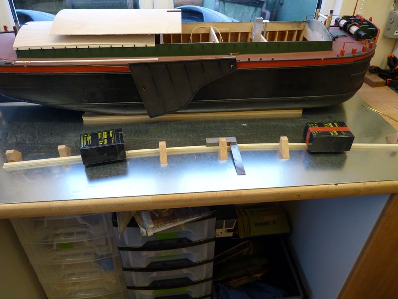

                      For subsequent planks we are attempting to pre-bend them by clamping them up overnight on the bench using some magnetic blocks and a piece of steel sheet we bought at the Blackpool show. How effective in creating a permanent bend this will be remains to be seen but the magnetic blocks work well on what is their first outing in the workshop. I will let you know more as it progresses.
                      The kingplank is 15 mm mahogany and has been temporarily stuck down with small sections of double sided tape. We hope to do the notching by adapting Banjoman's method as used on his Moonbeam, where he had straight planks notched into the curved edge plank. I suspect that will be a real b****r of a job to do neatly without breaking or splitting the planks but time will tell.
                      Gareth

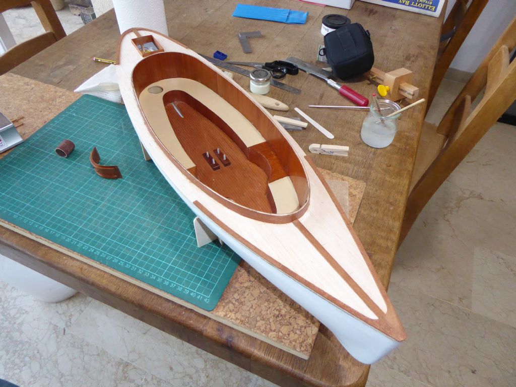

                                ​Deck planks are rarely if ever steamed but normally follow the line of the deck edge until the curve becomes too great at which point they are either joggled or tapered.
                                ​I am building a Midwest kit Elliott Bat Steamer and decided to throw away the vacuum formed deck and make my own. The sub-deck is medium hard balsa that creates a nice fair surface and something to glue onto. The covering boards and the king plank are mahogany.
                                As it happens the planks are 3 x 1.5 mm Lime bought as standard from a model shop. Most of them were slightly bent so I used that in my favour. I cut the planks to length and shaped the ends having decided at which point there had to be a taper. (I discounted joggling at this scale as being to fussy and would horrid unless perfect)

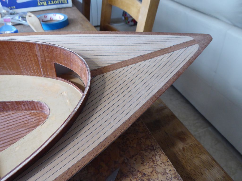

                                ​Starting from the deck edge, each plank was sprung into place and secured with a dab of thin / rapid cyano. The balsa was very effective at wicking the glue under the plank. There was no problem at all springing the planks over most of the length but the stern has a fairly tight radius so the planks were run out in a taper.
                                The seams are painted and you can see the planks run right up to the bow.
                                At the stern I got most of the way but you can see how the taper works. This section was not quite finished with a couple of very short sections to fit. You can see the traces of the cyano forward of the hatch coaming and the cyano also made the acrylic black paint run slightly but a light sanding sorted that out.
                                ​I wouldn't steam deck planks as any curve that tight would look unnatural.

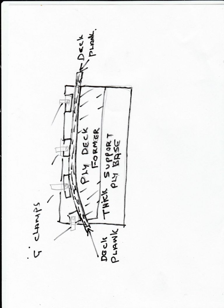

                                    Take a template of the decks outside curve and transfer it to a chunk of 4 x 2 or bigger softwood a bit longer than the deck. Cut this down the line so you have two chunky pieces for the clamp. It also helps if it is a couple of inches longer than your decks.
                                    Cover the softwood clamp with strips of polythene bag, use a staple gun but not on the clamp faces. This stops it all sticking to the clamp.
                                    Get every 'G' cramp you've got ready, cover your flat work area with polythene and then steam all the hardwood in a steamer (Wickes Wallpaper stripper and a bit of pipe) or block off a bit of down pipe and fill with boiling water and stand up with the wood strips in for an hour.
                                    Wear latex gloves. Start to layer one piece of hardwood and one piece of coloured card into the clamp using either Polyurethane wood glue (Gorilla) or Aliphatic Resin Glue, Layer these up (a cut down radiator roller works well here) till you have enough to cover the width of the deck. You need to work quickly!. The Gorilla glue will start to foam in contact with moisture in about 10 minutes!!!
                                    Place the second half of the clamp on top and lay it on its side. Start clamping the strips into a curve, pushing them down level as you go. You can't have too many clamps here, so no gaps hopefully. Clamp both sides really tight to stop it sliding and slipping.(Use a spanner if you have to)

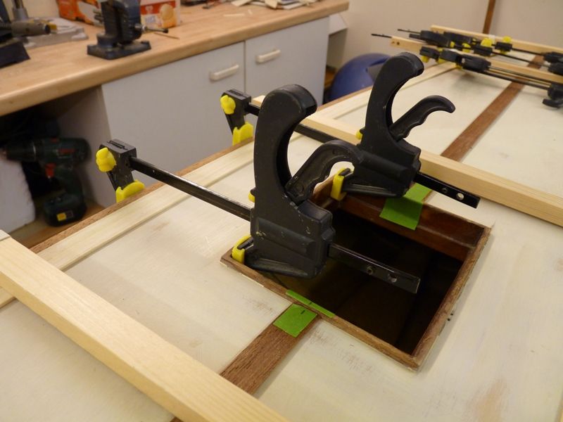

                                        Just to add to my earlier post here is a photo showing how we used a couple of clamps at the centre hatch (and another at the mast aperture) to create an edge against which we could hold the outermost mahogany plank.
                                        Whether this would be possible on your model remains to be seen.

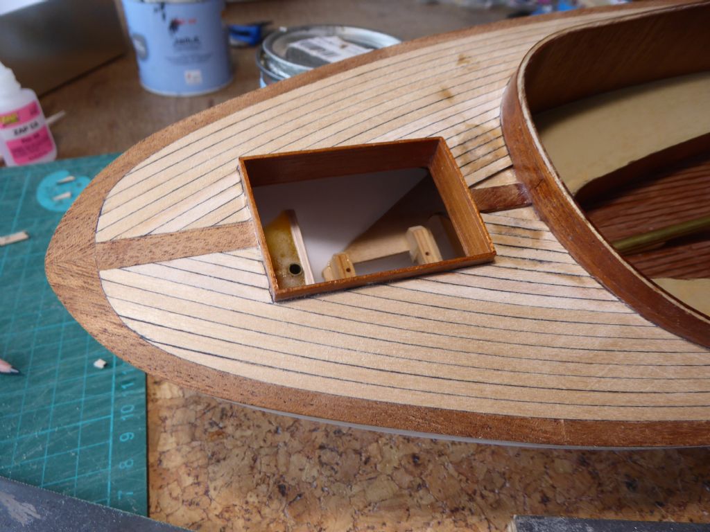

                                        Planking has progressed on Daredevil and Elizabeth has 5 planks on each side now, plus the edge one. Having seen the earlier post by Tim Rowe, Elizabeth decided discretion was the better part of valour and decided not to joggle all the curved planks into the centre king plank. The king plank has therefore been glued in place and it is now easier to bend the planks into position using wedges rather than clamps as shown below.
                                        I don't think we would attempt planking a deck this way with anything wider than 8 mm or it would be too stiff, or anything thinner than 2 mm or there would be no edge to pull or push the plank sideways with.

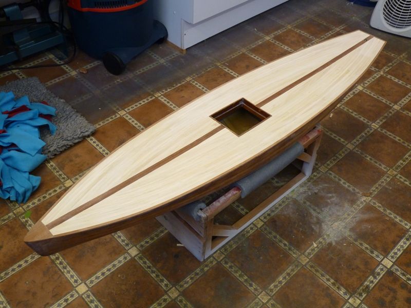

                                            Gareth Jones
                                              @garethjones79649
                                              The planking of Daredevil is now complete, the next job for Elizabeth is sanding it down.
