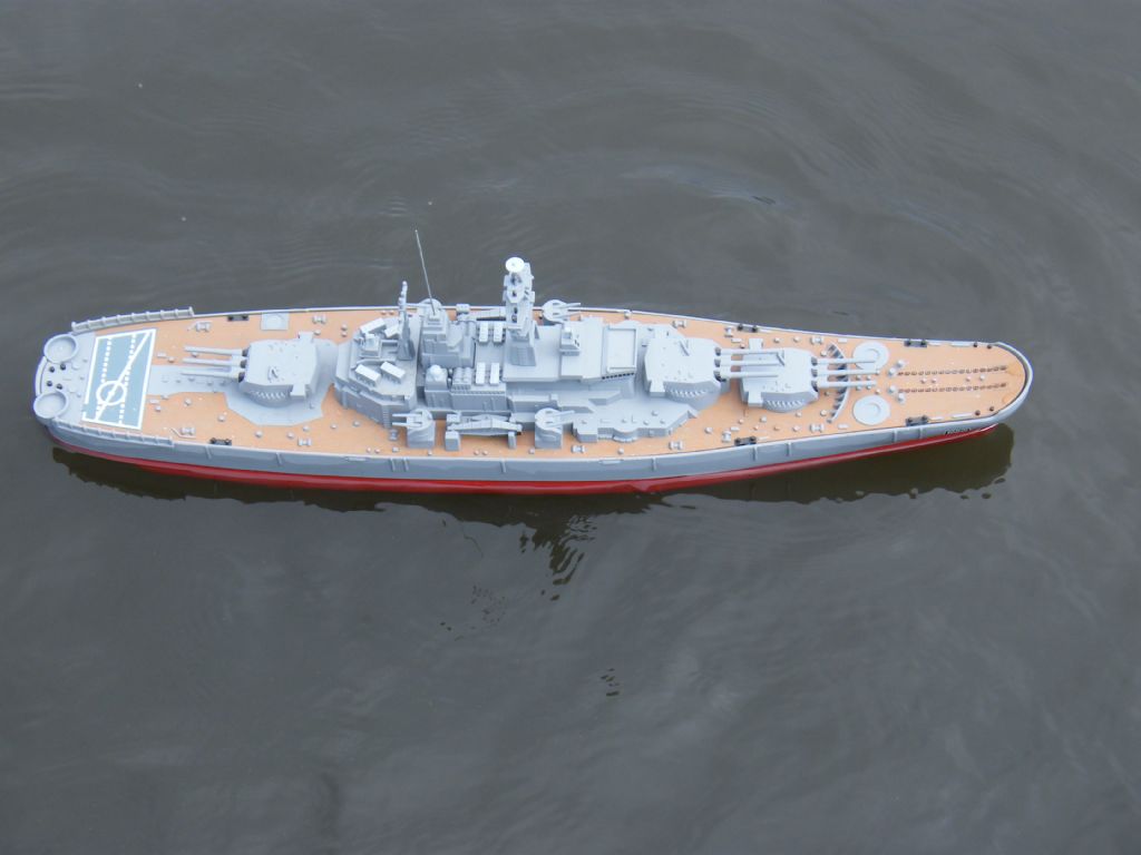

              I always thought that plastic magic conversions were a bit tricky, and fiddly. I can see the attraction of course. Would it be better to start a bit bigger first???   (this is a discussion point) They are also very tender on the water limiting them to clam conditions.
              I have converted one plastic toy, but this is a bit chunkier than your normal styrene job.  Ashley.   Usual disclaimer applies.
              new jersey plastic boat
