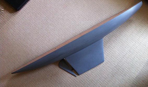

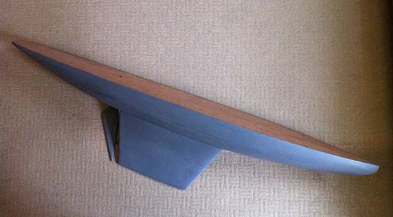

        Can anyone tell me if this yacht is of a particular Class of Pond Yacht, Here are a few measurements
        Hull Length 49.2" 125cm, Width 8" 20cm, Mast 60" 152.5cm, Boom 26" 66cm The waterline is about 2.5" 6.5cm from the deck.
        The Main Sail 51 x 56.5 x 23" Jib Sail 49 x 13 x 51"
        If this is pond yacht does not fit any Class measurement rule does it represent any class?
        Thank you

          Hi Mike,
          The length of the yacht suggests it may be a Marblehead. The key class rules are that the hull length is 50 inches +/- 1/4 and the sail area is no more than 800 sq inches. From a rough calculation your sail area seems much more than this, more like 900 sq inches. The acknowledged expert in these matters is Russell Potts of the Vintage Model Yacht Group. I suggest that you write to him and send the the photos and details to their website. The web site address is www.vmyg.org.uk/
          Best of luck,
          Gareth
          #40181
          Malcolm Frary
            @malcolmfrary95515
            If it was intended for free sailing, it could have been one of the variants of the M class from yesteryear. There were those around who felt that a bit more sail would be a good thing. It would probably rate OK as a Marblehead with a "legal" rig, but would not be competitive against more modern boats.
