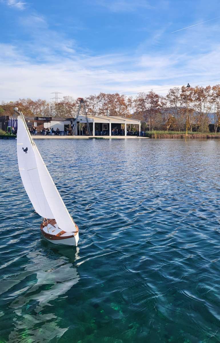

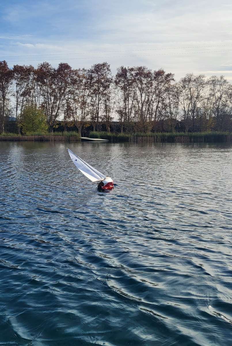

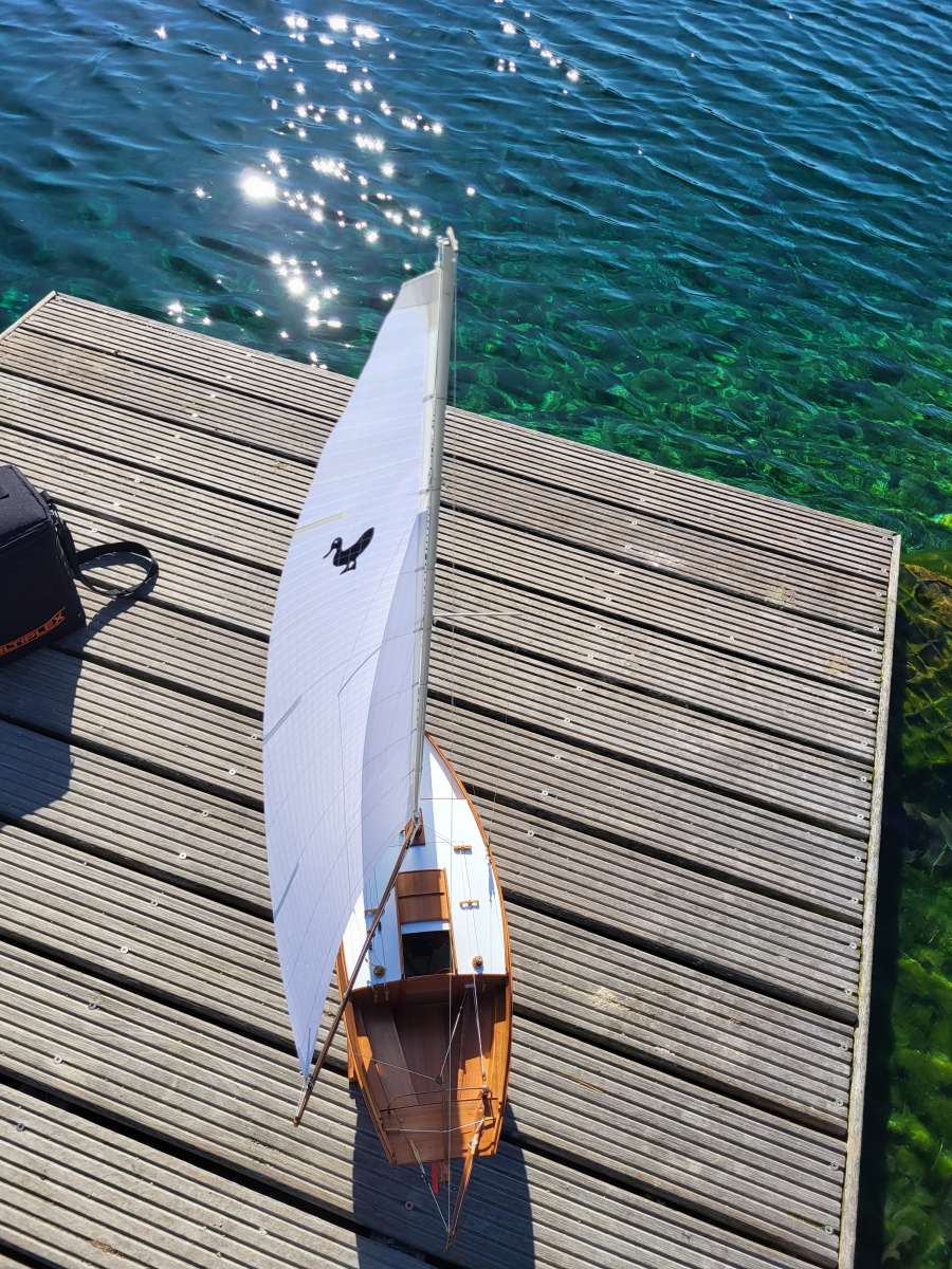

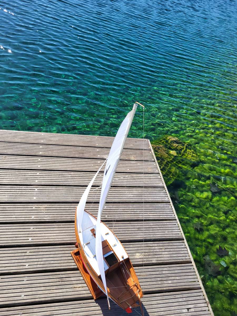

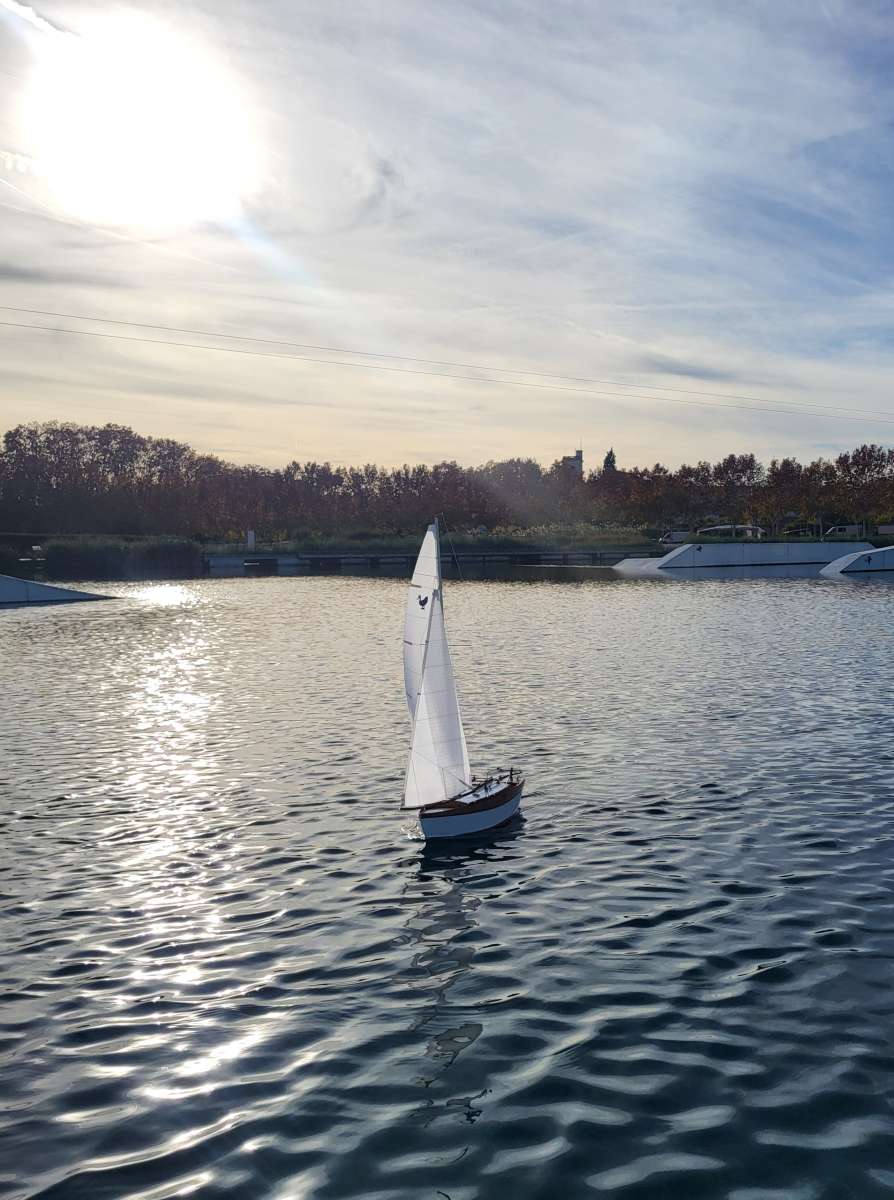

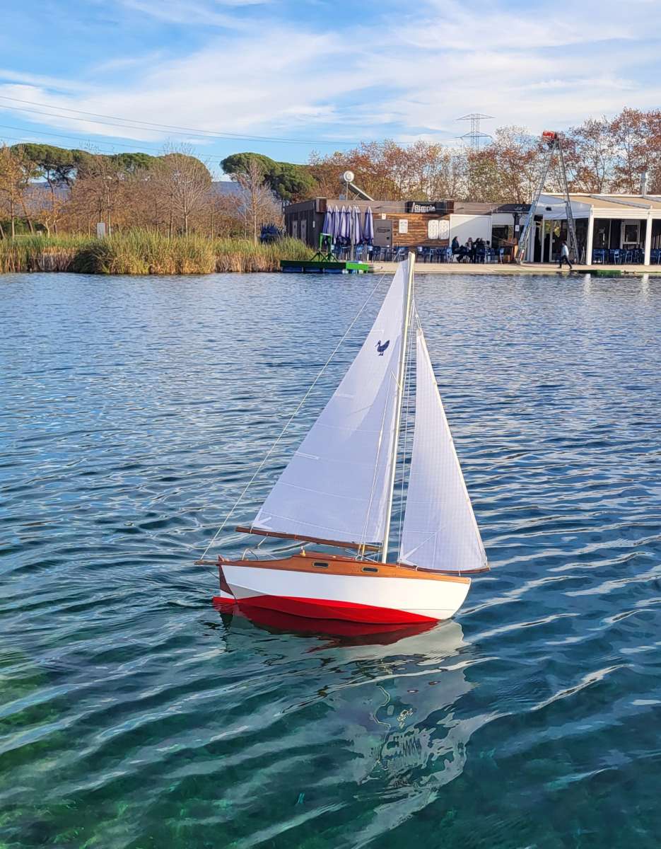

        Beautiful pictures of a beautiful boat.  Thanks for sharing them.
        #118970
          Hi Joan,
          That’s one of the best models built from my plans I’ve seen well done 🙂
          She will always be tender with out the detachable keel , will you be building Eventide next ??
          My friend Tim Rowe in Majorca is building an Eventide and Wild Duck currently
          Kind Regards from the UK  Ray
          #118972
          Joan Conesa
            @joanconesa16737
            Thank you Ray.
            And thank you so much to inspire all of us, to discover this small boat. Some years ago, during a trip to Scotland I had the opportunity to acquire “Building Chine Boats” by Michael Verney. This has been a great source for the construction too.
            In my Wild Duck version i decided don’t use the detachable fin… sorry. Instead I modified the keel design (deeper) and  I enlarged a little bit the rudder surface too.
            With this modifications, the boat sails very well in moderate winds with a + 10% sail area and -8% main area.
            Recently I have installed a third small servo to control the jib sheet. It works well in gusty winds.
            Nowadays I’m working in two projects a 26′ Gaff Sloop by Wilbur Harris and a Bullseye from an Aeronaut Kit. My next project will by an enlarged version of the Morning Tide 14 by Selway Fisher.
            I have the plans of Eventide and I will start to collect information to build it in the next future.
            Thanks and sorry for my english.
