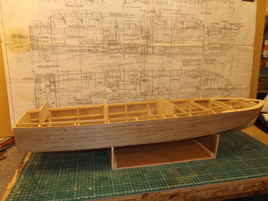

      wmdet8.jpgHi All,
      The next boat off the production line will be this Thornycroft 50 ft yacht, which was built just prior to WW2 and became a Dunkirk Little Ship, fortunately given the original makers drawings, will keep you posted, she is 3/4" to 1' scale 37 1/2 long diagonal – carvel planking

          Hi. Ray, A nice boat in full size and should look just as good in miniature, you have already made a good start and I look forward to seeing the finished boat.

            Very nice, Ray. Good to see a cruiser modelled properly. Nice size too.

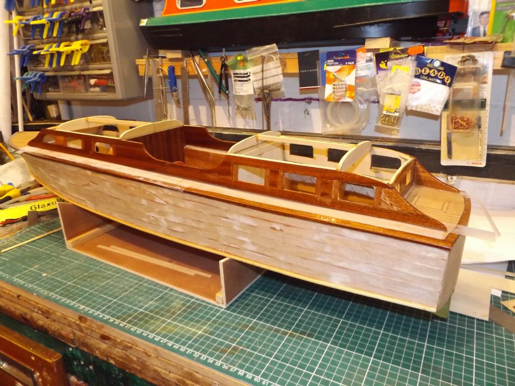

                      Some progress with the superstructure/cabin a basic 1/16th ply bulkheads & sides to be
                      overlaid with mahogany varnished

                        Hi. Ray, A nice model of a nice full sizesmiley. you'r not hanging about with the build are you? That deck looks good and I look forward to seeing it when finished.

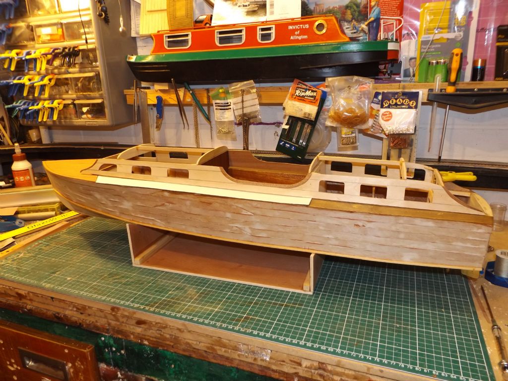

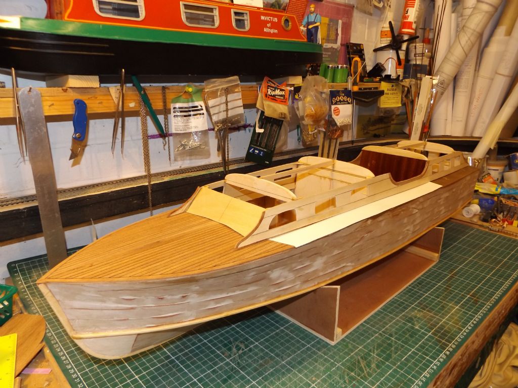

                                wm31.jpgHi All,
                                I think I'm seeing the light at the end of the tunnel on this one, the 1/16"ply cabin sides are overlaid with 1.00mm Mahogany sheet which has been a marquetry operation but looks ok when varnished, this is the way the fullsize is built, so happy days balsa for the cabin roofs next

                                  Hi. Ray, that first picture shows it's sleek lines, should be good on the water, I like the deck, it really sets off the cabin sides.

                                    The deck is the same mahogany but should be teak the water based varnish leaves it so much lighter in colour, the oil based Ronseal changes the superstructure totally darker.

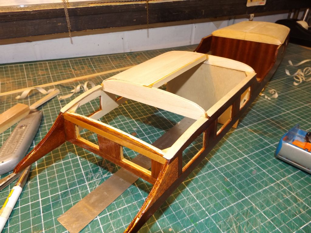

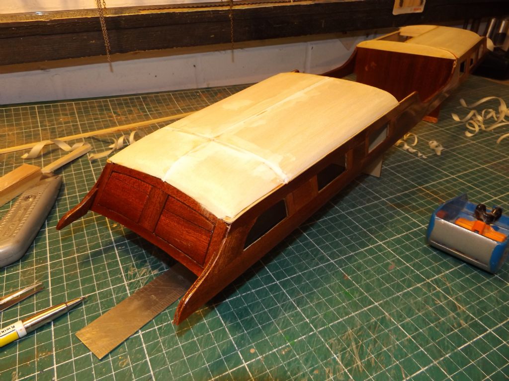

                                      wm32.jpgHi All,
                                      The wm33.jpgcabin roofs have a 1/32" ply base strip to form a lip and sharp edge and the curved sections from 3/8" balsa sheet, the faithful David plane for shaping and the fine Permagrit block for smoothing to contour. Must be time to West epoxy the outside of the hull soon
                                      Photos & text always weird positions on my posts !!
                                      PS. David razor planes are great but have taken off many fingertips if not used with care when holding the work!!
                                      Edited By Ray Wood 2 on 30/10/2018 14:19:38

                                        Hi. Ray, that's an interesting compound curve on the roof, and your ply strips is a very good idea, that will be stored away for later use if I need it.
                                        I know what you mean about cut finger tips, I now look twice when cutting with a knife along a straight edge, to make sure all my fingers are out of the way!

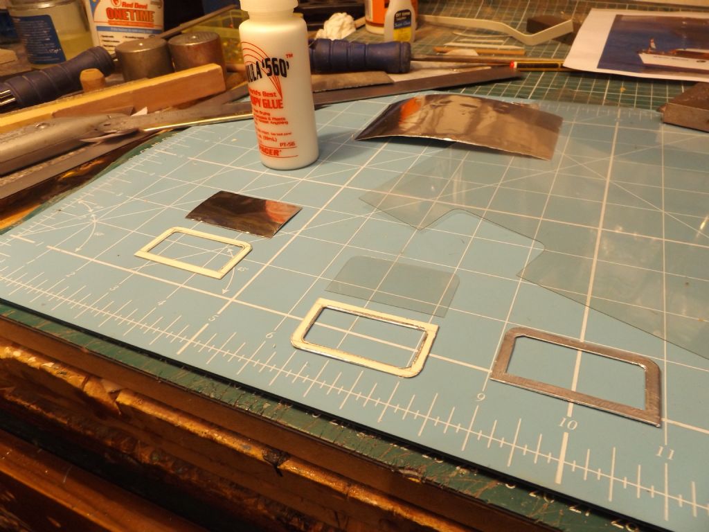

                                              Hi All
                                              Small steps forward this week, WM has chromed window frames and fittings, the solution at the moment is cut out the frames from card and wrap with self adhesive chromed tape and burnish down, this may be to bright for the overall effect so make need varnishing to dull it down abit, with acetate glazing glued on the back with my faithful canopy glue Formula 560 which dries clear.

                                                Ray, I know it's more expensive, but I made all the metal bits for my several Rivas in brass and had them bright nickel plated. That way it looked like chrome in scale. There were just over 150 separate parts in brass per model to be chromed! All the rubbing strips round the edge and floor covering edging was done too and a lot of bits on the Big Block Chevies that Riva claim to be their own, plus the tool kit! It does set the boats off though. I'd put a picture up, but can't make this lark out on here. You'd think a forum owned by a magazine would make life easy, wouldn't you?
