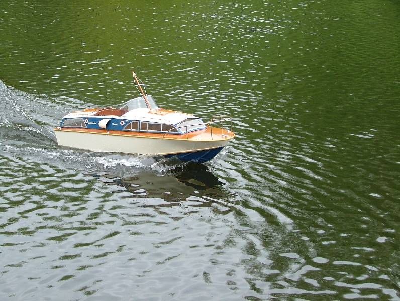

                                        Photo attached of my big Huntsman. Not going too bad considering that's its fitted with a single MFA850 brushed motor and a brick of a lead acid battery. Battery and ESC have already gone down the tip and will be followed by the motor in due course!
                                        Given the performance with that rubbish in it shows that it's not going to take much more to give it the spritely performance that it deserves and Dave demands!

                                              Thanks all for the info and advice and thanks Chris for the picture, I hope mine will look like this when done. I've joined MBM but need to wait to look at UKMike's build, thanks for the pointer though. As regards the motor question, following all the input, I've scaled down my ideas (forgot I wasn't building an Apollo rocket!) and have seen this set up:
