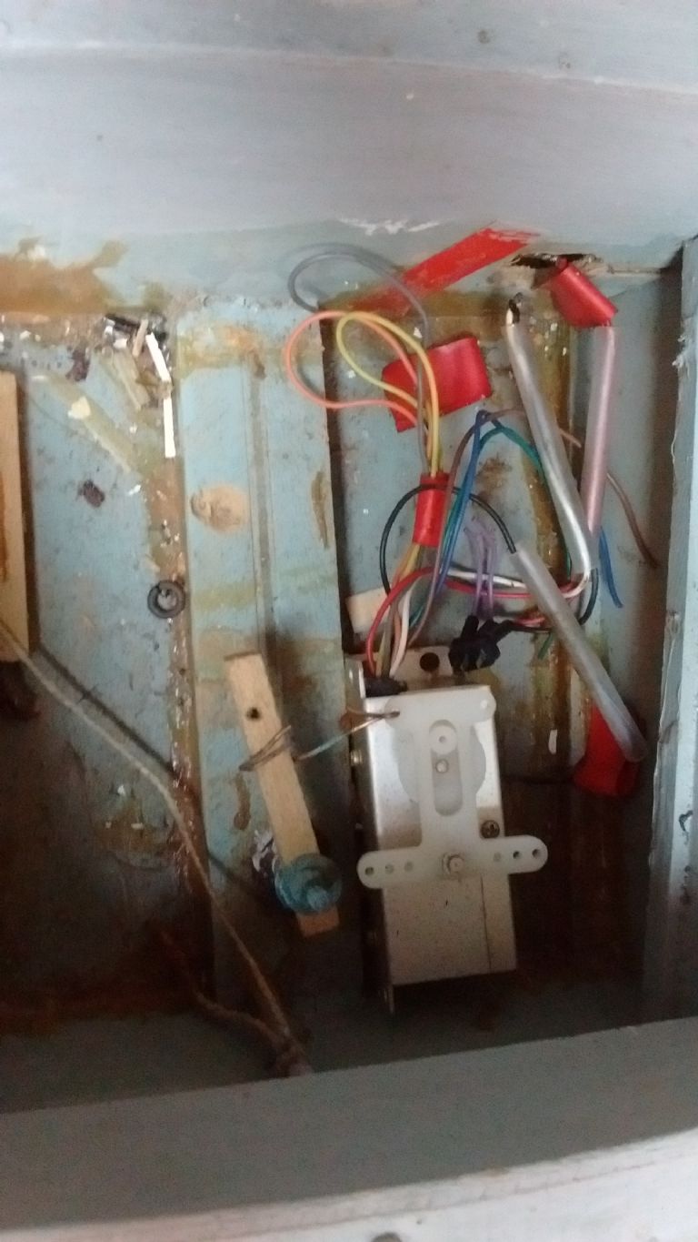

                  Peter Brown 15
                    @peterbrown15
                    #72289
                    Peter Brown 15
                      @peterbrown15
                      Excellent information provided, many thanks. I've also ordered a book on the subject. I've posted a picture of what I've got to work with.
                      #72290
                      Peter Brown 15
                        @peterbrown15
                        #72293
                        Dodgy Geezer 1
                          @dodgygeezer1
                          What you have there looks like an old single channel 'actuator'. There may be some markings on it to tell us more.
                          If it is what I think it is it will be of no use to you with modern Radio Control equipment, as it comes from a bygone age. It may be worth quite a bit on Ebay to collectors.

                            #72300
                            Peter Brown 15
                              @peterbrown15
                              Assuming the motor is OK is it feasible to fit a esc, receiver, battery and servo to it or is the motor not compatible.
                              #72303
                              Dodgy Geezer 1
                                @dodgygeezer1
                                It will be a brushed motor, – these have not changed since Faraday's time, so it will work happily with a modern brushed ESC.
                                However, it may well be worn, and of comparatively low spec compared to modern motors, and so produce a disappointing performance compared to modern motors.  It's hard to tell without examining it closely.
                                Probably the most valuable item in the boat is the old actuator. I suspect that you could sell that and buy a really nice modern motor with the proceeds… or a radio control set !
