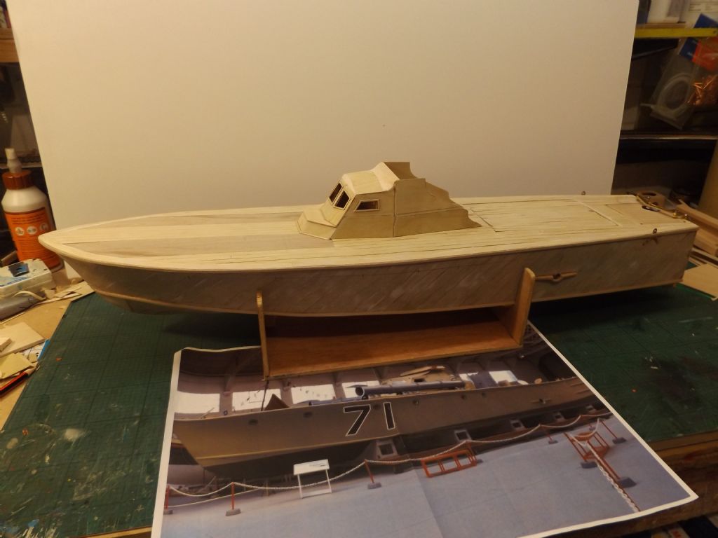

            Hi Jim
            I think 400's would be fine, you want it to get up on the plane but not fly, I'm currently building MTB 71 which is 30" long, I do build light as I've done my share of Aeromodelling.mtb 71 030416 003.jpg I'm, using 2 X MFA 400 size motors with 25mm 3 blade brass props.
