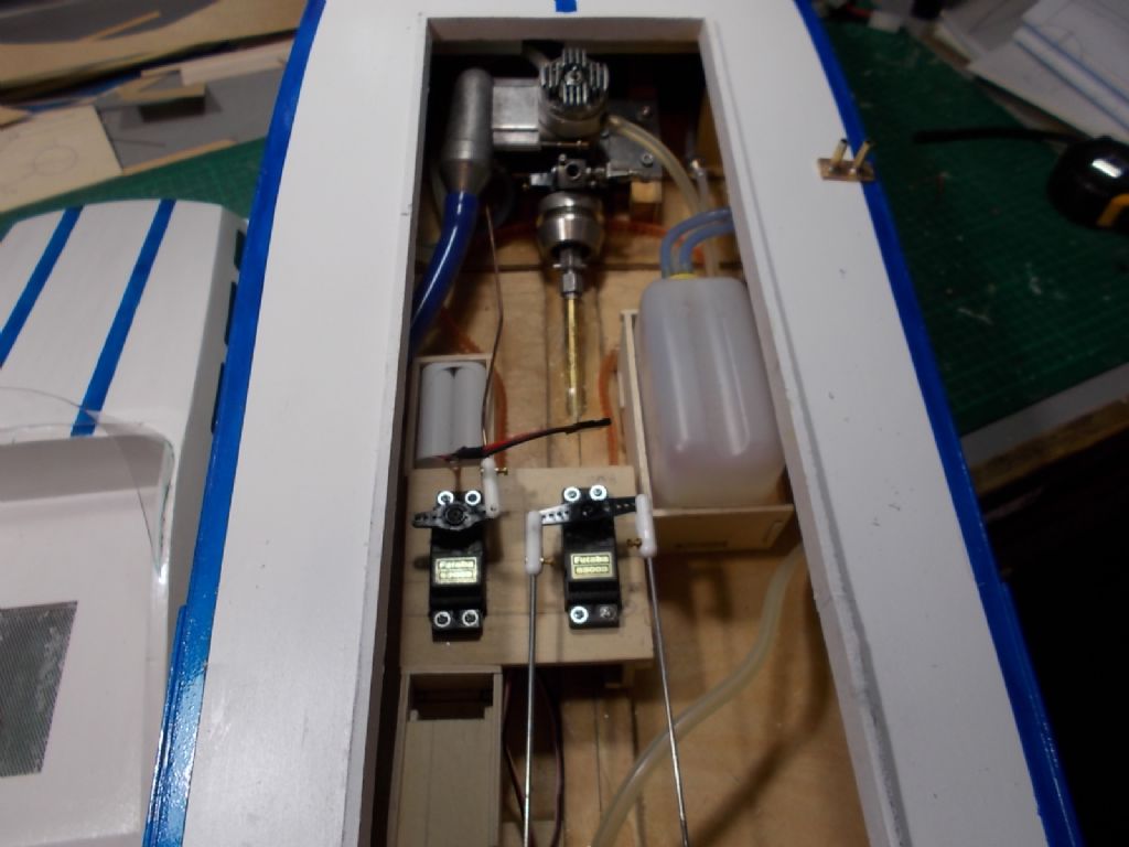

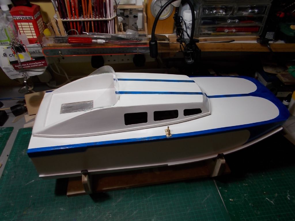

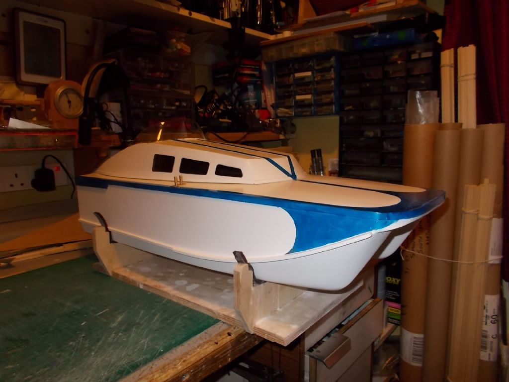

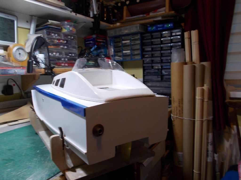

      Hi there, here are a couple of photographs of my latest project called BUOY CAT which was designed by F Body in the 1960s. Basically, its a CAT hull with an IC engine in it . I have tried to keep as close as possible to the original design, couple of variations in the build is I increased the length of the spray rails either side of the hull, originally they were only half way along. I added an upper rubbing strip around the deck area and also on the back deck I opened up an area with a grille in it to allow ventilation. The only thing now to do is to give it a trial run in the paddling pool – to make sure nothing falls off. I have glazed the cabin windows but I do have a funny feeling they will either melt – or – I will knock them out to create ventilation. For those wondering why I didn't go brushless with this design is that I wanted to keep it as authentic as possible as this is one part of our hobby I enjoy – i.e. tinkering with IC engines – come to think of it I have many a battle scar on me fingers from the old boot lace starting. But, now softy here has a starter motor and electric one that is.
