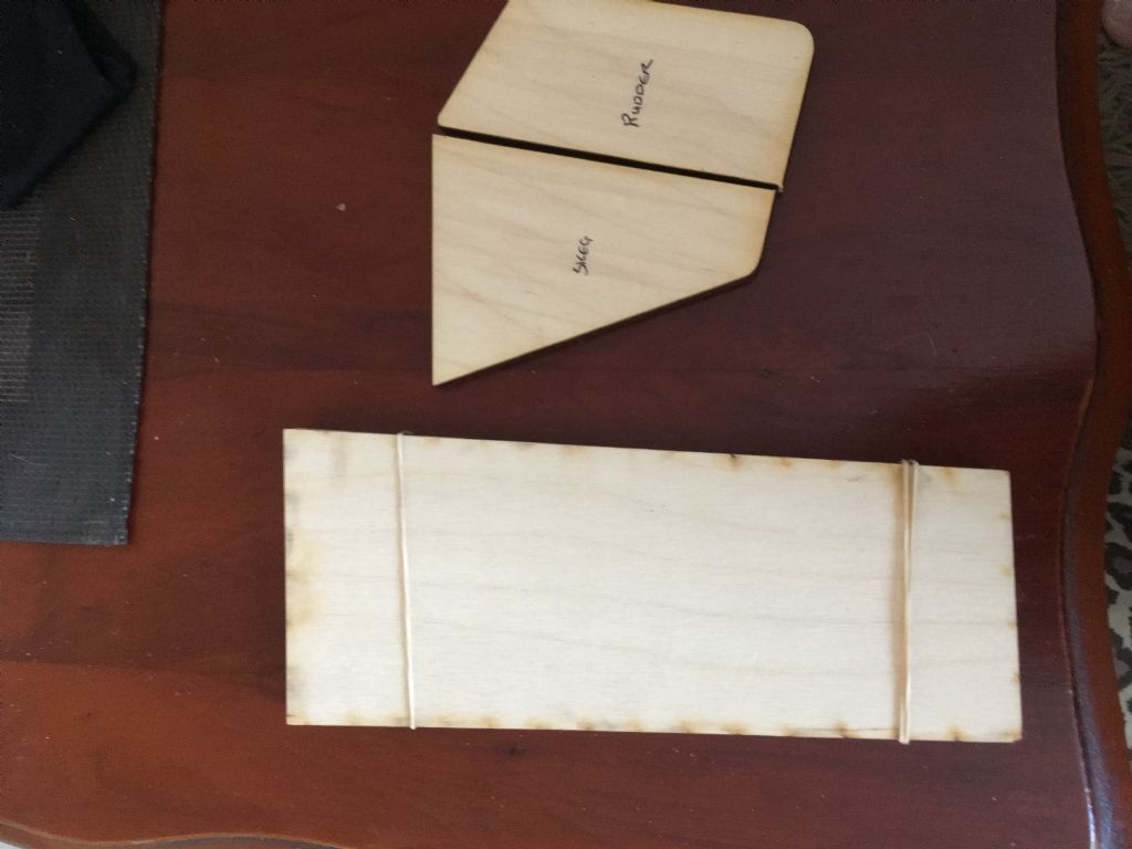

                          Just a quickie,
                          I received my wood from Belair and in the kit is another rudder and it’s absolutely mahoosive! Easily 3 times the size of the original. You obviously use it instead of the original rudder and Skeg which are supplied as well. Anyone used it? I was kindly sent a copy of a magazine article in which it was advised to widen the keel fin by 3 or 4 inches and increase the rudder by 50% to help with side drift. Will this huge rudder save doing the other alterations?
                          I’ve just ordered the wood to finish the rest of the hull. Any help would be greatly received.

                                Sorry about the pants photo’s but that’s the rudder. Obviously needs shaping and it’s laminated from 3 pieces of ply. Hopefully it is a rudder, can’t see what else it could be and I can’t see another rudder shaped thing in the kit.

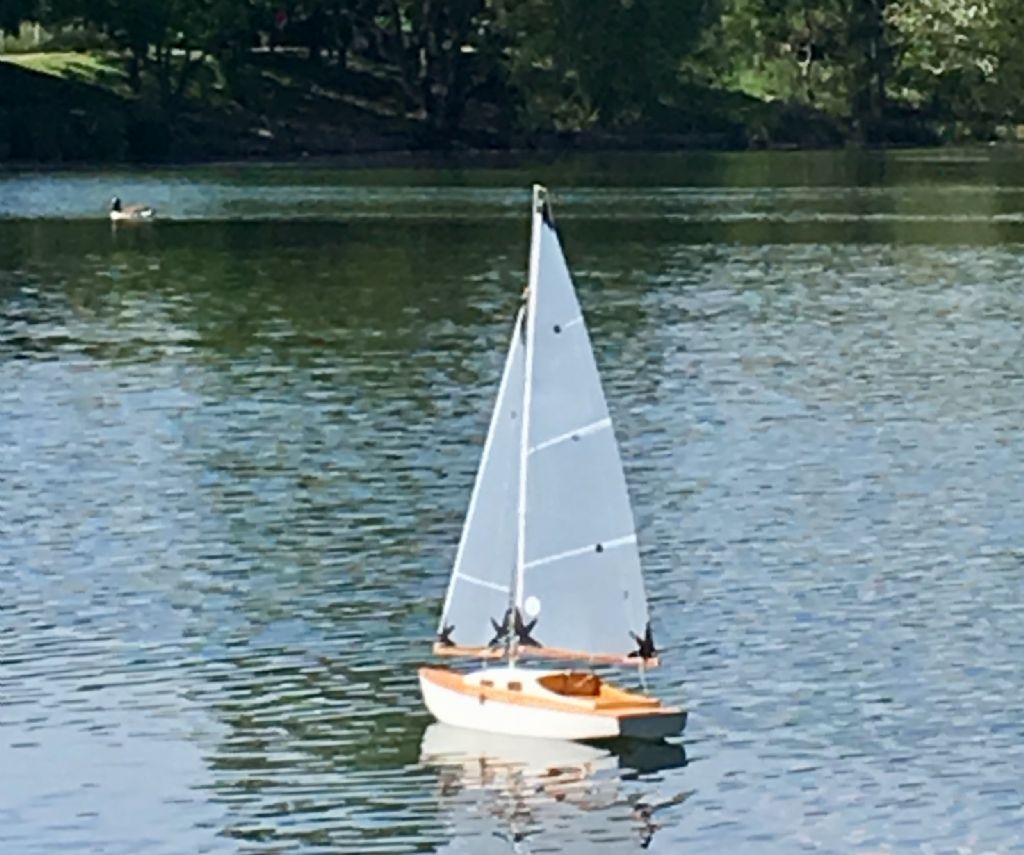

                                          Starlet 1st sail

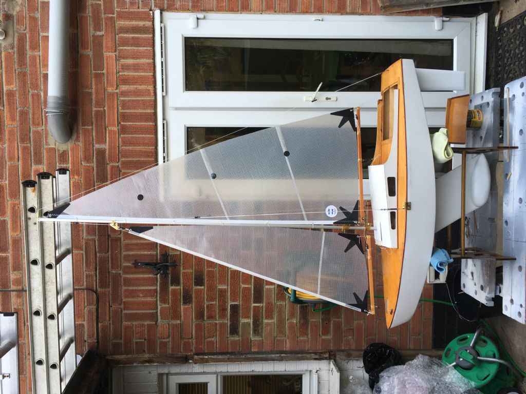

                                          #82479
                                          Dave Gidman
                                            @davegidman45520
                                            Starlet dry
                                            #82480

                                                @davegidman45520
                                                Starlet sails great. Racing rudder works a treat. Although where I sail is surrounded by trees so the wind blows a bit strange and it has loads of weed coming and the water is really low so not ideal.
                                                I positioned the rudder servo slightly aft of where it supposed to be and I cut a flush fitting hatch to give me access. Will have to weigh the boat because it looks a little high in the water but it’s not a problem. I coated the hull in light weight glass fibre sheet and epoxy sanded smooth then gave it 4 or 5 coats of Halfords gloss white enamel, wet and dried between each coat then gave it a couple of coats of clear lacquer. Sails from Frank at Nylet as i’m not confident enough to have a go at sails and Jobs a good ‘un.

                                                  Sitting a little high in the water is not a problem with a yacht. It means that you have a better power to weight ratio. Provided it tacks OK, just think "Hurray" and go with it.
