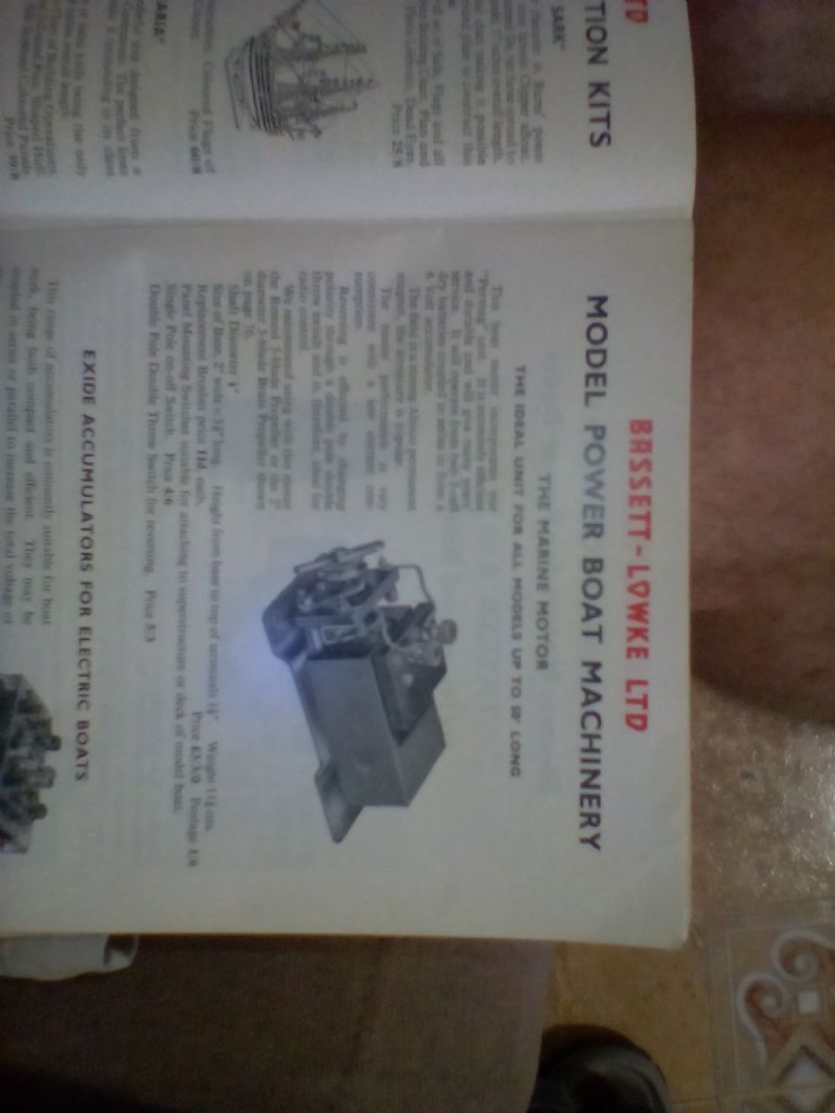

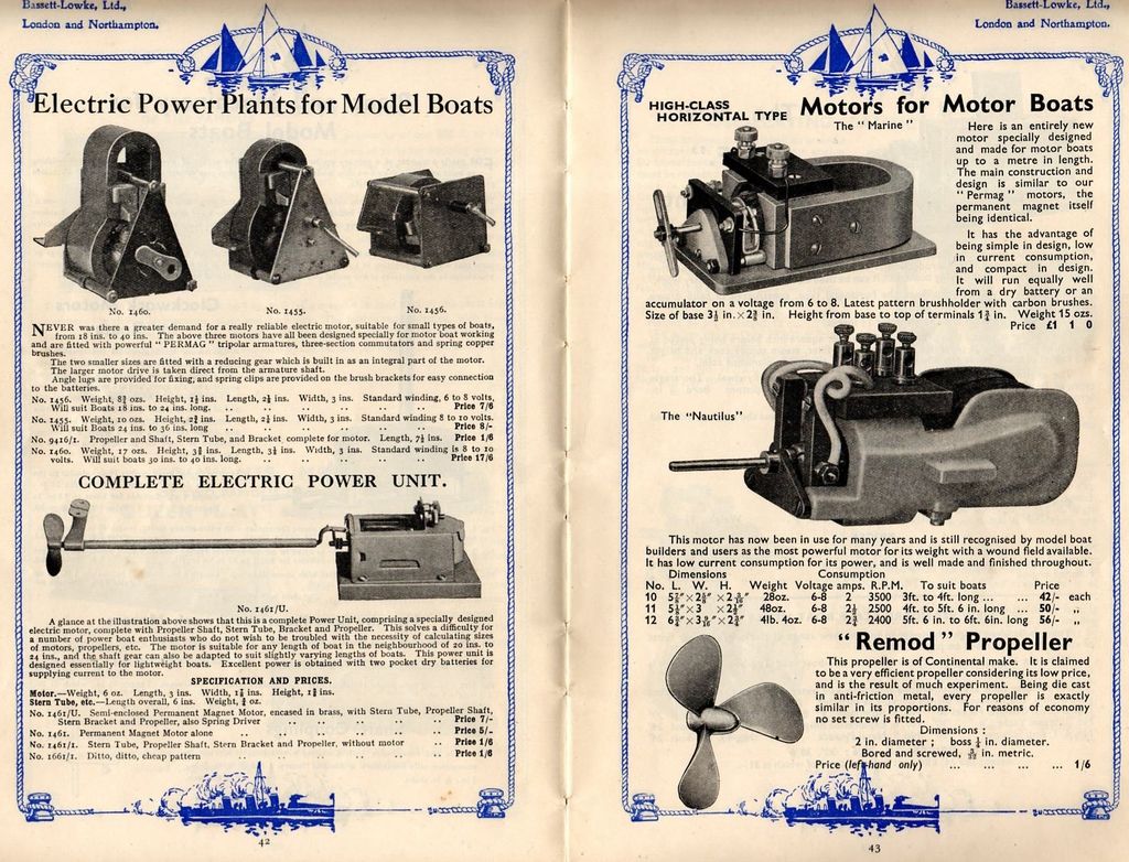

                img_20180911_175631.jpgHi again, if yo ever want to add a photo, have a look on the forum front page. Check FAQs on the lower right. Nothing to it.
                Have a look at these two motors, from old Bassett Lowke catalogues, one of mine, one courtesy of Dodgy Geezer.
                Perhaps your motor is one of those. Both can be described as sloggers rather than performance units, and are unlikely to get you planning. But as I said before, it's often fun to try.
                #78869
                Martin Field 1
                  @martinfield1
                  Mine is the one on the right of the top catalogue if it were oriented correctly. I do also have one like the top right of the other one, but more for interest than use.
                  I find the fitting of all the innards in models nothing but a pain, so no I wouldn't have any fun just playing around. I have far too much making of hulls to do to fiddle with installations…hence my question. Looks like a damned brushless or a drill/buggy motor (I took one apart not long ago) will have to be pressed into use. I only want a scale 30mph.
