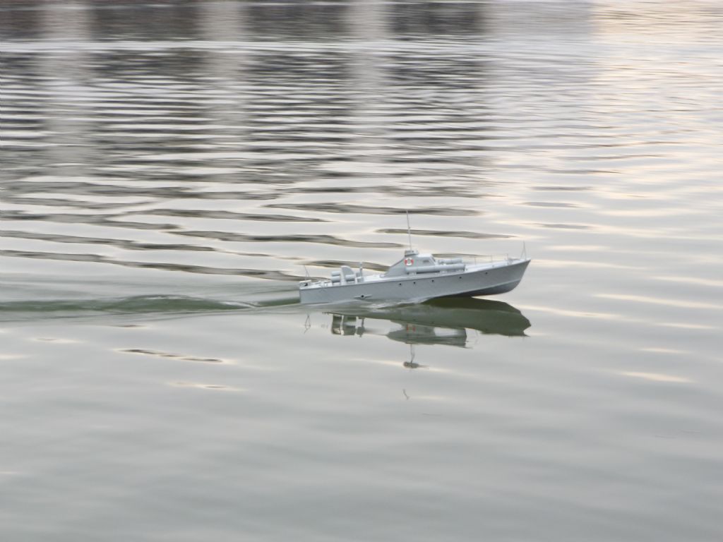

          380's in parallel with 3 cell 2200 lipos will be fine should give you approx 10 mins planing.
          Here's mine,sedate not ballistic suits me 😀
