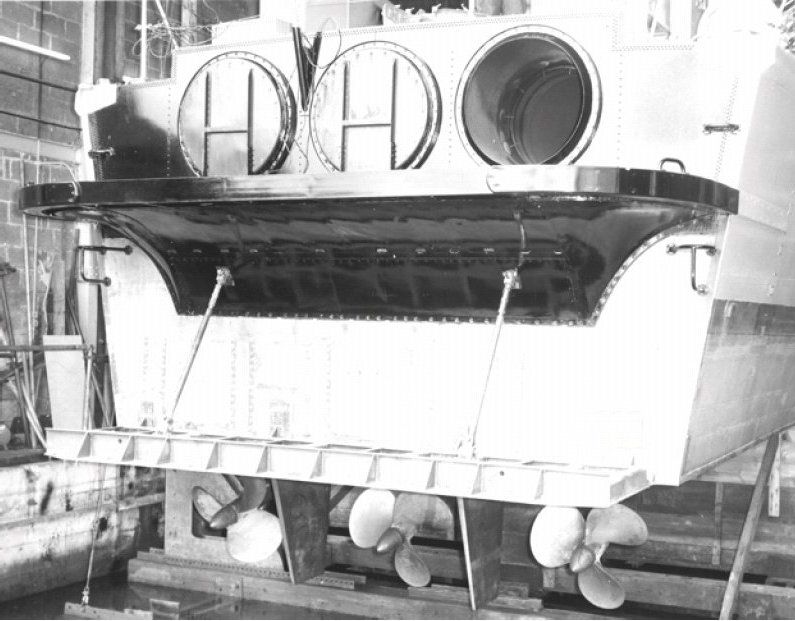

                          Mark Beard 1
                            @markbeard1
                            I have a ‘parked’ Perkassa build which has 3 props. There is a photo on the interweb of a sister-ship during build, from which it is possible to ascertain the handedness of props. Unfortunately, from other features on the boat, the photo appears to be a mirror image. Doh!
                            So I’m coming to the conclusion that 3-prop boats are the Devil’s work, and all boats with more than 1 prop should have an even number of them!
