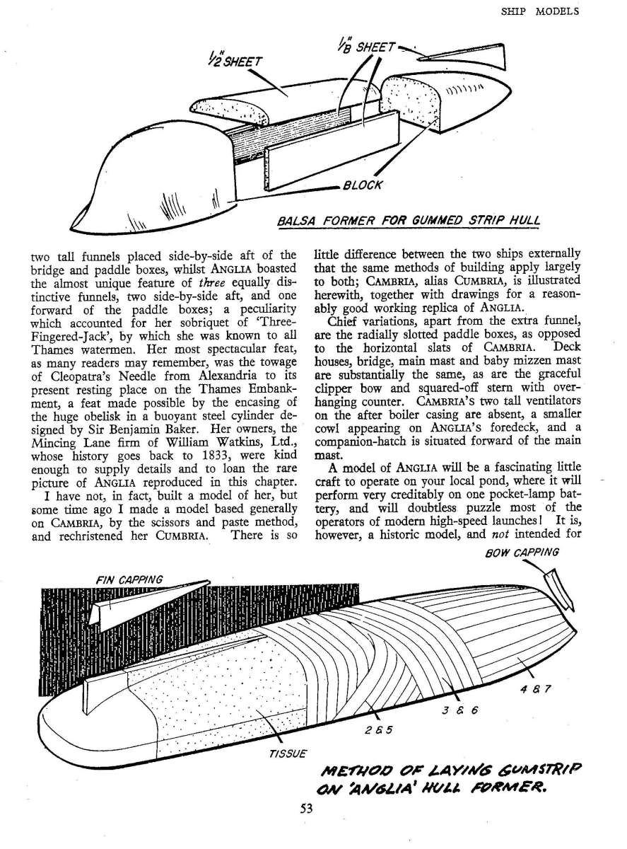

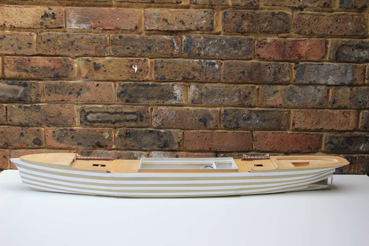

                  #123194
                    No need to lick it, just pass it across a saucer of water. Very useful for simulating plating strakes too as on my Miltiades model.
                    Gumstrip plating

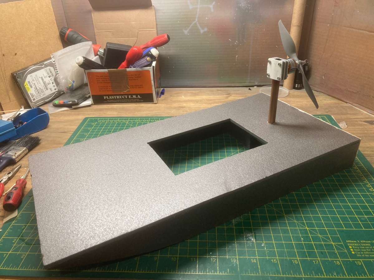

                        Foam MKII
                        Current project…
                        I was planning to use some fibreglass cloth/Eze-Kote on the bottom of the hull and a little ply reinforcement this time though. Adds some weight and strength.

                          Dave. Yes depron is that stuff.
                          Is that 10mm styrofoam? Likely won’t need much to strengthen. As its light there is no momentum to collect dings and dents, but glass tissue and ezekote helps, however an epoxy resin is really required for a hard surface.
                          All our airboats have a small water rudder (extension of the main air rudder) and a sharks fin about 1/3 the way back from the bow. The sharks fin makes a massive difference in stopping drift, while even a small water rudder makes the boats much more usable when there’s any sort of breeze about…something that will affect yours as it will be very light.
                          Richard tried an airboat once here using foamboard and it was megga light…however it was probably twice as heavy as a depron craft!
                          The next project is reverting to a brushed 500 motor for several reasons. It’s supposed to be fast, and I have a selection of marked and unmarked cans, however there is a really wide choice to be had in the buggy fraternity (rock crawlers and so.on in 1/10 scale. They are quantified by the amount of ‘turns’ presumably the windings. And some hot ones do 30,000 rpm on a ‘buggy’ pack…7.2V.
                            It’s 6mm depron with a ply reinforcement for rudder mounting.
                            Going to use motor/prop etc from the foamboard one that fell apart after a few weeks of dunkings and modifications. I’ll start without the fin then add one later to see the difference.

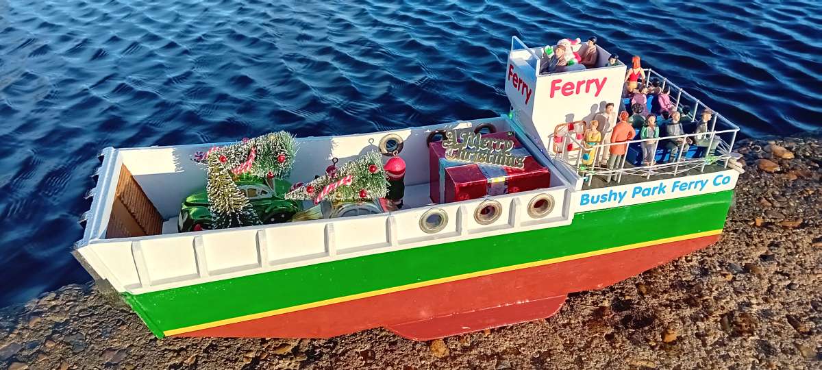

                                                  Today’s boating good. Full crew, mild, relatively windless.
                                                  Ferry now ok after rudder servo change.
                                                  HMS Midge also now ok after reseating and squeezing up the bullet connectors for the motor! Easy fix. Servo still noisy…might see how it goes.
                                                  Full bore Christmas boating next week…santa hats, mince pies and festive music (the Christmas ferry deck has a large ‘present’ on it that is space for a noisy thing sound unit) BESIDES having christmassified boats.

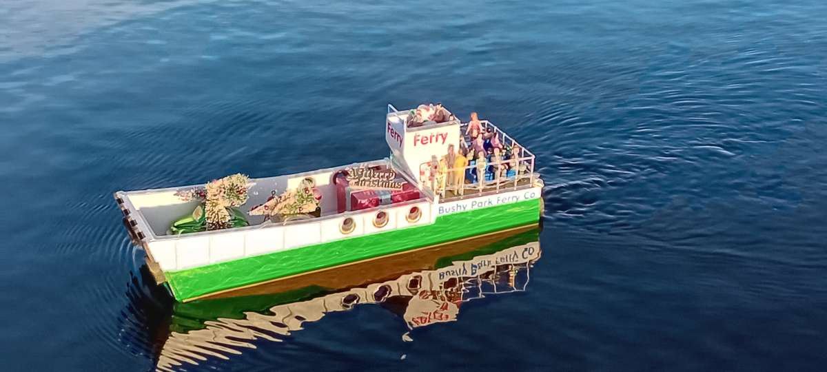

                                                    Bit nippy at thr pond today! Wi d got up and it was jolly brisk. Car park only half full.
                                                    Last outing for Xmas ferry deck for another year.
