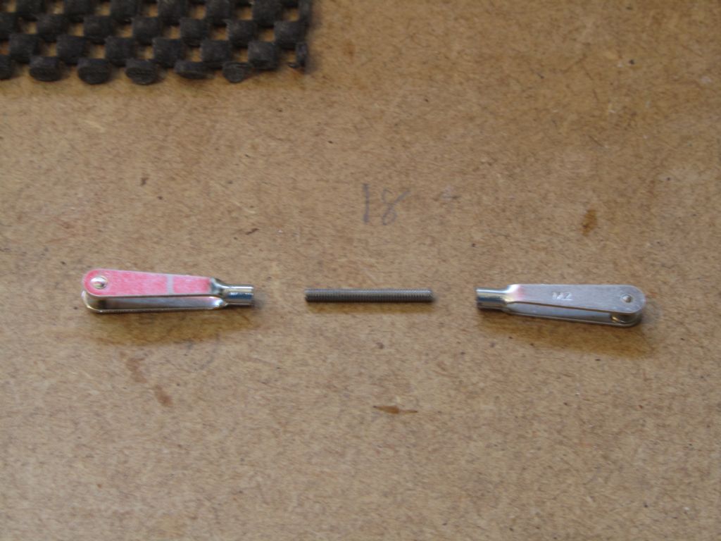

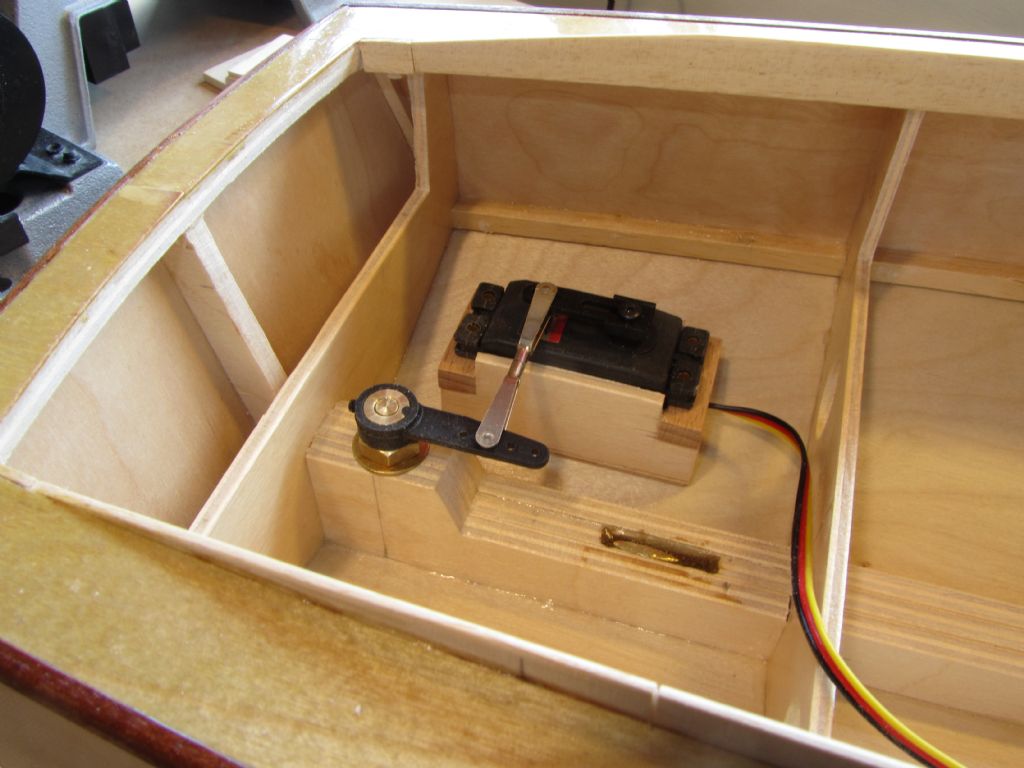

      I knew it was going to be tight fitting the servo under the floor and to the side of the rudder, even using a low-profile servo, but not this tight! Obviously the further from the rudder it is positioned the higher it becomes.
      With 1mm clearance between the top of the servo arm fixing screw and the underside of the cockpit floor the distance between the servo and rudder is less than I would have liked. After trying various fittings I used this approach which enabled the arms to be kept at the same height.
      I cut about 1.5mm off two spring connectors to shorten their length and cut the threaded part of a connecting rod off and connected them together. I had thought about just bending the end of the rod but this way is better "engineered"!

          I shall look for some. I did try a clevis on the rudder arm but it had to go upside down due to the lack of height above the arm. Then it would have needed a double bend in the rod because of the difference in arm heights (the servo can't go much lower) and with such a short rod was getting messy. In other builds I should have more space.
          I connected the servo up to try it and all moves freely so happy days.
