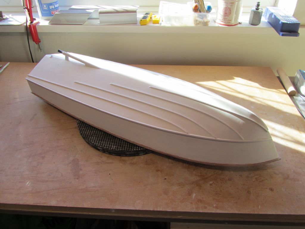

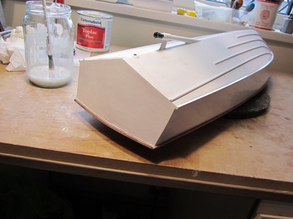

                                        As mentioned on another blog I'm painting this hull as well. The whole hull was coated in white primer undercoat to highlight any areas that needed filling. As expected, there wasn't much and minor imperfections were duly filled and once dried and sanded the areas were spot primed and then sanded.
                                        With this hull the sides and transom are going to be white and the bottom blue and this morning I applied the first coat of white gloss. I shall continue applying coats of white until that is finished and then start on the blue.
