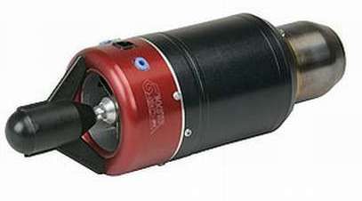

                              I am drawing it to take one of these jet turbines that the model aircraft chaps play with.
                              Its a Graupner G Booster 160 which produces 160N of thrust (36lbs in old money) so the hull has to be very strong and produce some downforce as there is a real chance of the thing becoming airborne.

                                Ashley.
                                Here is a picture of the turbine in question……they have come along way since those early jetex motors.

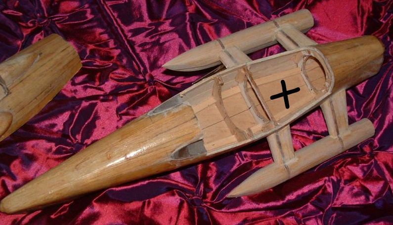

                                              I am trying to build a model of Crusader at present, as an electric RC straight running boat
                                              My problem is that I have purchased a few electric drive line parts from HK. Being an aeromodeller rather than a boater, I do not know how flexible drives are assembled.
                                              I have also deliberated a bit about the CG. I have concluded it should be over the rear sponsons., but do not really know.

                                                Carl
                                                To enable a better understanding of your CG problem can you tell us what motor and battery combination (including size and weight) that you intend to use and the overall dimensions of your model.

                                                  My boat is 600mm long.

                                                    Hello Carl
                                                    Given the available information the natural centre of gravity is at a point 15 > 25mm below the point shown.
                                                    Without knowing the size and weight of the equipment being fitted I can't be more specific but I can confirm that The Crusader is very 'twitchy' when running at speed and it is important to keep the weight low in the hull.
                                                    I would suggest putting the batteries in the sponsons to widen the weight footprint.
                                                    I hope this helps
