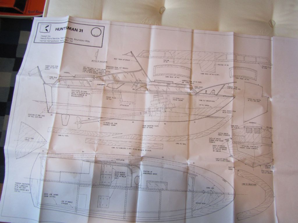

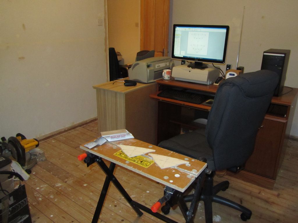

      Building my other Faireys has come to a halt for the time being due to holidays, doing stuff in the garden and other things.
      So wanting to do something model orientated (especially as the weather has been so poor of late and continuing to be so) I thought I'd pick up my Huntsman 31 project again. This is going to be built at 1:12 like my other Fairey builds.
      I bought a drawing a couple of years ago when I first started getting interested in model boats. I've not long started but I'm redrawing parts of it so that I can print off at will for transferring to the ply etc. Also modifying parts of it to make building easier and more accurate e.g. adding a temporary spine to align the frames and fingers to the keel to fix to the building board as I've done with a couple of my other builds.

          #82619
            Thanks Tim
            Actually having a set of drawings at the right scale of 1:12 the intention was to virtually build it straight off the drawings along with the modifications mentioned earlier but now that I've being doing a bit more I've decided to make a few more alterations to the frames and templates to echo what I've done on my other builds. This includes changes to the bow area and moving the frames to the front and rear of the cockpit slightly to accommodate the cabin walls from floor to roof rather than sitting them on the frames in the same plane.
            One thing I had noticed with Huntsman 31 models, all I think, is that the rudder is much further forward from the stern than on other Fairey models and the original Fairey drawing. Is this because the stern is quite rounded and access to fit the rudder is restricted or for some other reason, handling perhaps? This position does reduce the amount of space available between the rudder and front wall of the aft cabin for the servo etc.
            #82620
              I've built both of the 'old' versions of the Huntsman kit, with the rudder in the forward position, and four of the 1/16 scale version with the rudder back in line with the transom. From the handling aspect I didn't notice any difference, but I think the 'real' postion (i.e. the aft one) looks better, even if it is a bit trickier to arrange the tiller connection.
              #82625
                Thanks Dave.
                Whilst the rudder isn't really seen that much I agree that it looks better nearer the transom and will move it as close as I can.
                The Nexus Plans/Vic Sneed version does have the rudder further forward than any of the other versions other than your 1/16 models.

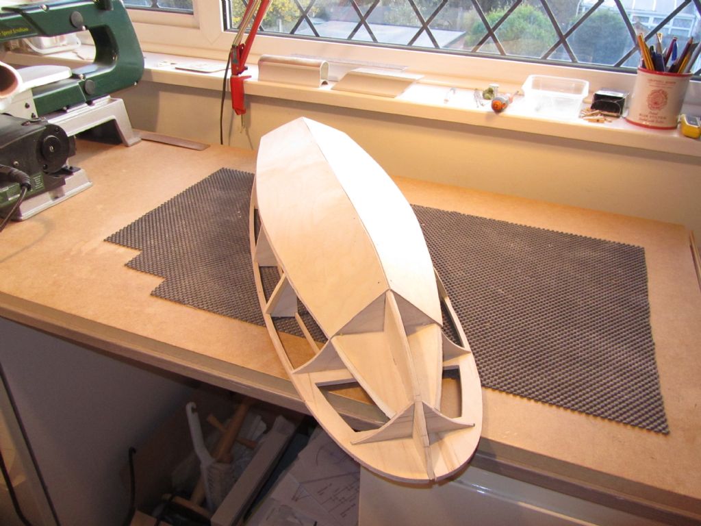

                    #84277
                      The hull design of the Huntsman 31 is the sleekest and most modern looking of the moulded timber hull designs and the length enabled a quite roomy aft cabin to be incorporated which was obviously what owners wanted as the majority, i.e. 27, of boats were manufactured in this guise.
                      But another 6 boats had a full length cockpit and were called Huntsman 31 Sport with most being used for racing for obvious reasons. With the sleeker bow and full length coamings I reckon this version looks great.
                      Drawings were almost ready to build the aft cabin version from (which I shall at some point) but I've now decided to build the Sport version. Just got to modify some of the bulkheads to suit the cockpit and I can make a start. Space in the house is becoming a bit of a problem though!
                      #84364
                        Build is coming along now. Bit of a luxury for a while because as well as using the smallest bedroom as a work room I'm currently replacing the skirting boards and architrave in the second bedroom ready for decorating and once the day's work is over I'm doing a bit on the model. Loads of space!
                        #84628
                          Doing a little bit each day following decorating.
                          Reached the stage where I'm fitting the stringers.

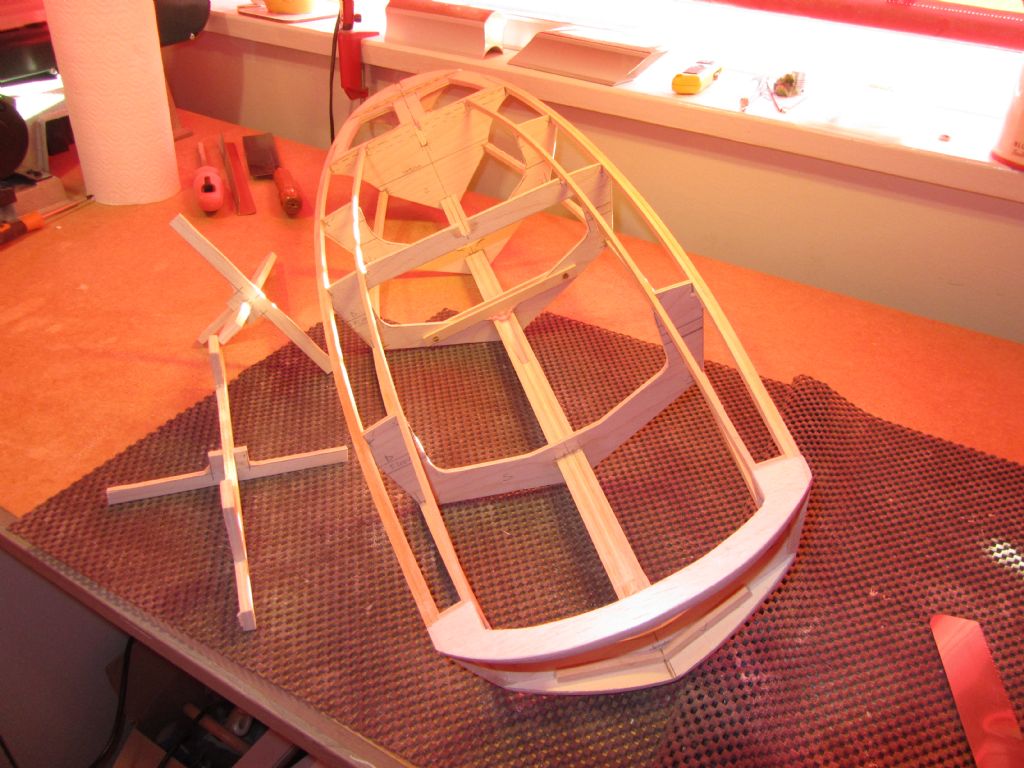

                              Thanks Tim. This is the quickest build so far (relatively speaking!) which it should be given that it is the fourth.

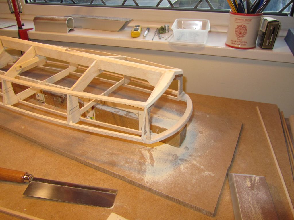

                              #85704
                                Ha, ha, just read my last post. Quickest build so far! Well it may have been, but not having done anything for over 2 months that probably isn't the case anymore!
                                Finished the work in the bedroom and have managed to create some space in the work room so that I can start modelling again. Time is still limited though as I've started on our room now.
                                I've profiled the keel and stringers with the razor plane and PermaGrit blocks. Have also cut out the temporary supporting timber to the transom bulkhead and am just about to draw up the pieces to form the curved transom.

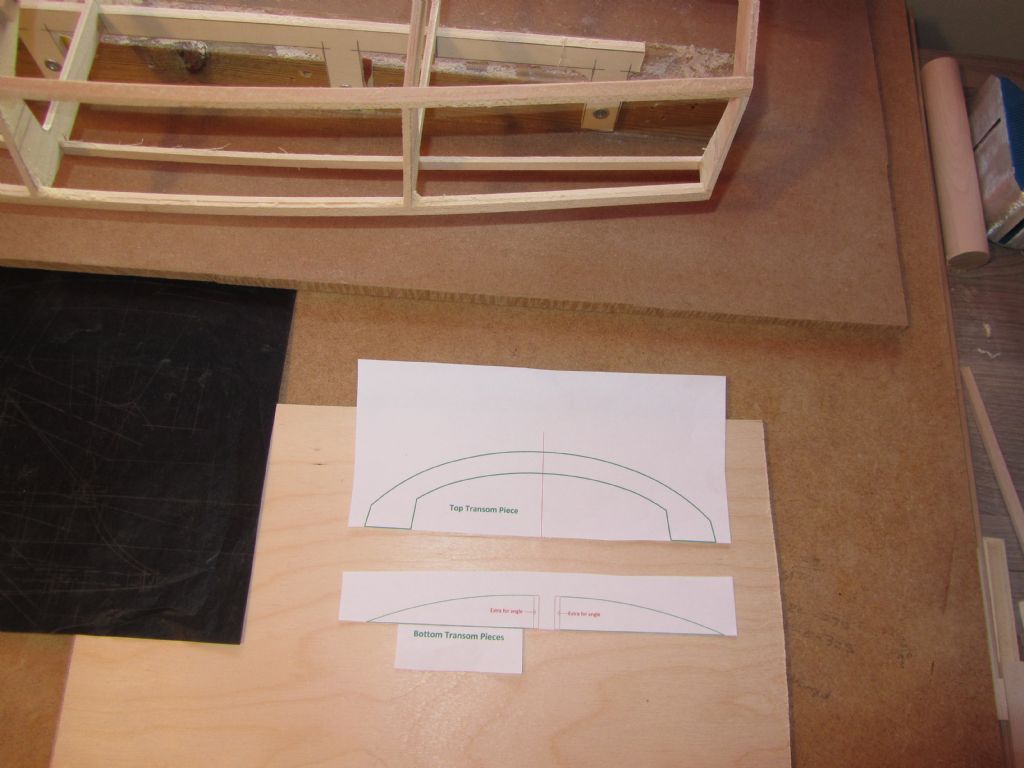

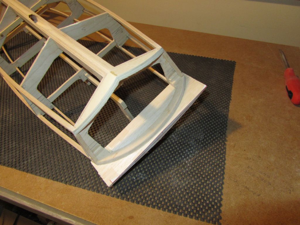

                                #86106
                                  DIY/decorating is still the main focus of my time at the moment but good, albeit steady progress has been made and I've managed to move stuff out of the work room and do a bit now and then on the build.

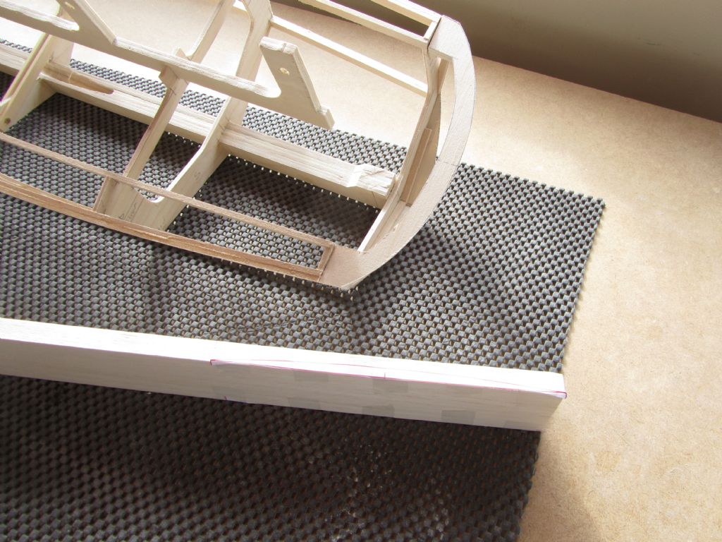

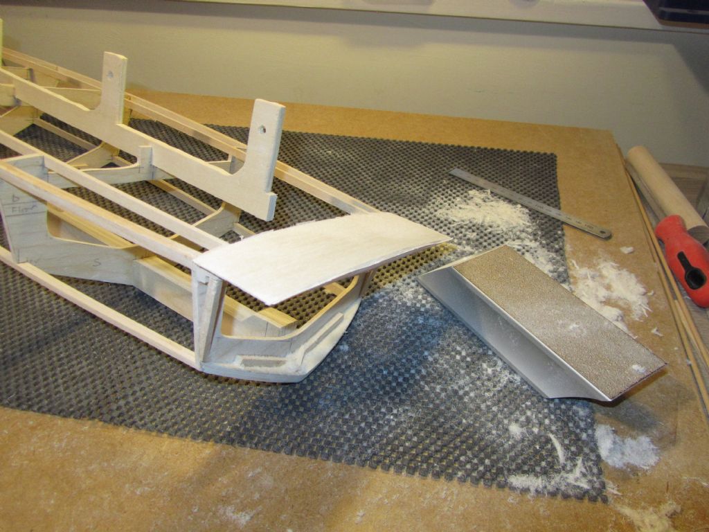

                                  Pieces were drawn, printed and cut out for forming the curved transom which were then cut out with the scroll saw and sanded to shape and glued in place. I don't like just relying on butting the side and transom skins together so I've added timbers to provide some additional meat for gluing as well.
                                  The deck is cambered, so to facilitate this at the transom I've glued on a piece of balsa and printed out and stuck the necessary curve to the front and back faces to sand to. Once sanded to profile I cut some of the balsa away with my flush saw and finished off with the trusty PermaGrit tools.
                                  As said, still decorating etc. but I'm going to spend more time on the boats as well now.
                                  #86107
                                    Edited By Chris Fellows on 19/03/2020 20:55:31
                                    #86108

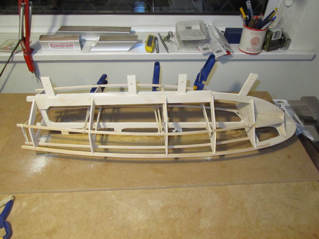

                                      #86125

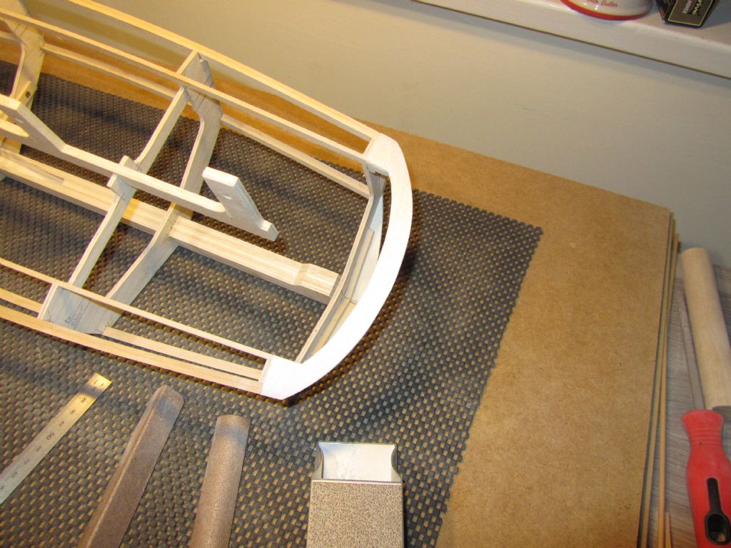

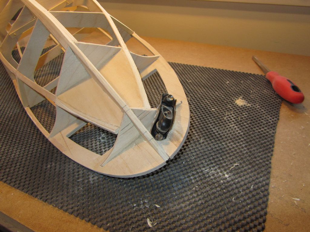

                                        Started planing the chine formers to profile with my lovely little Veritas miniature block plane – just the job for this task.
                                        #86126

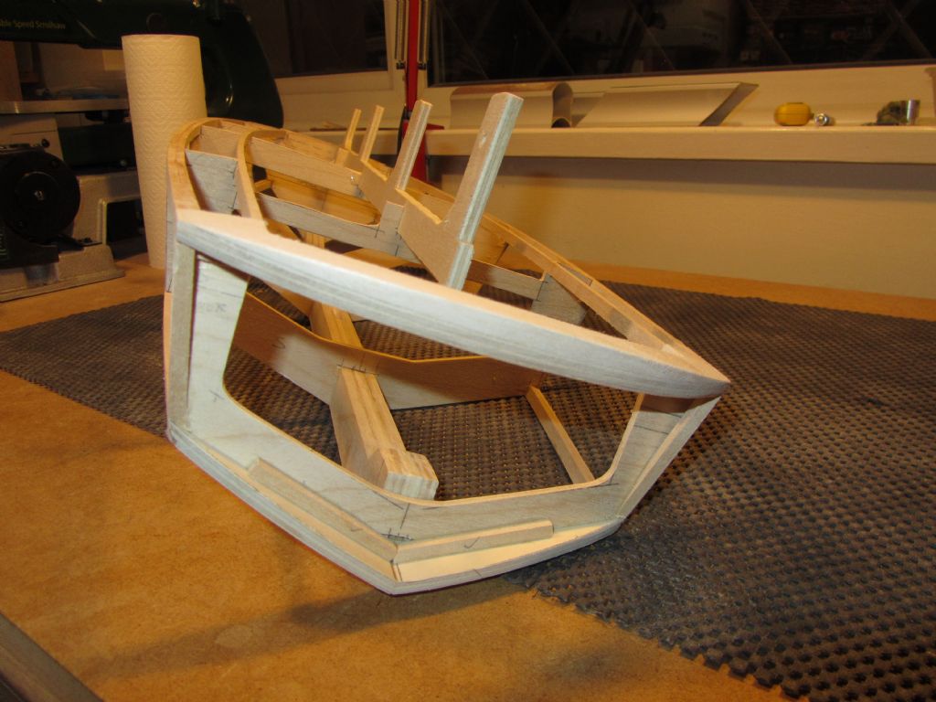

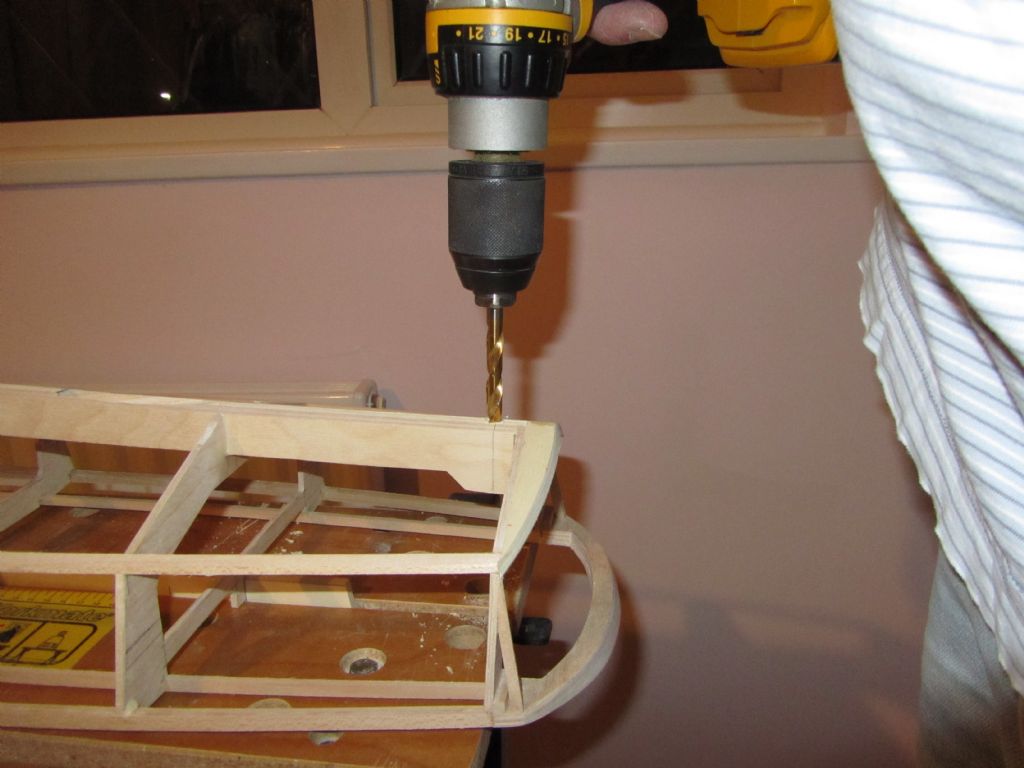

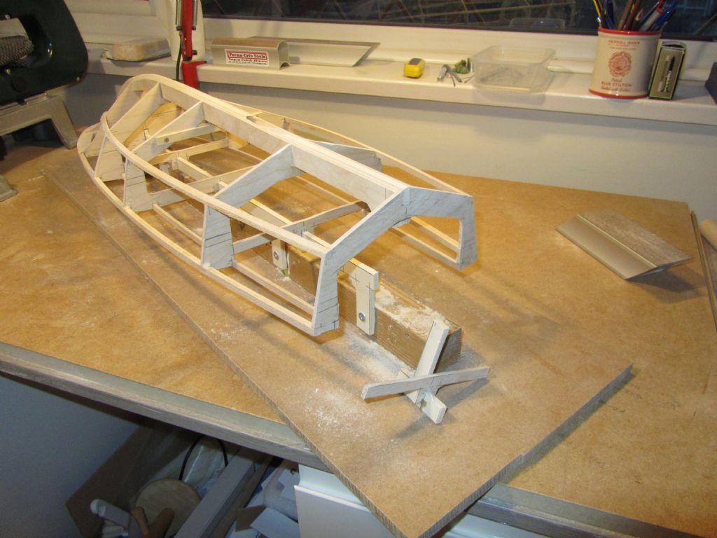

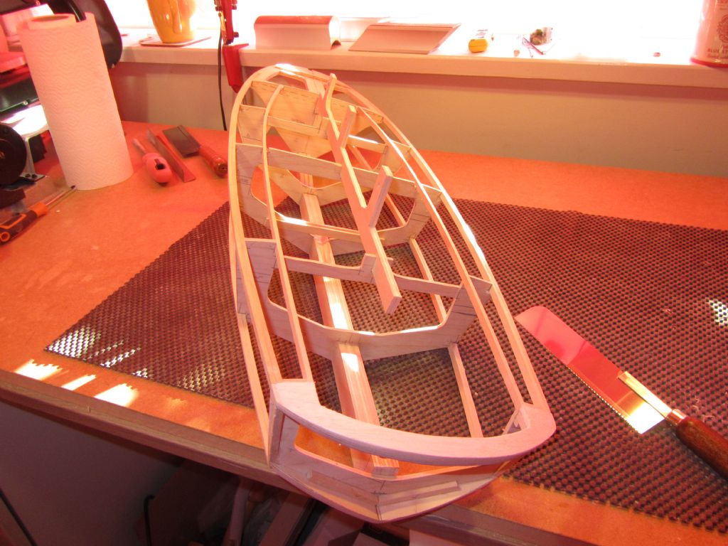

                                          Last job for the temporary spine and fingers was for holding the hull framework in the Workmate whilst I drilled the hole for the rudder.
                                          Once this was done I removed the spine/fingers and the temporary pieces to the top of two of the bulkheads with my flush saw which opens up access to the interior of the hull.

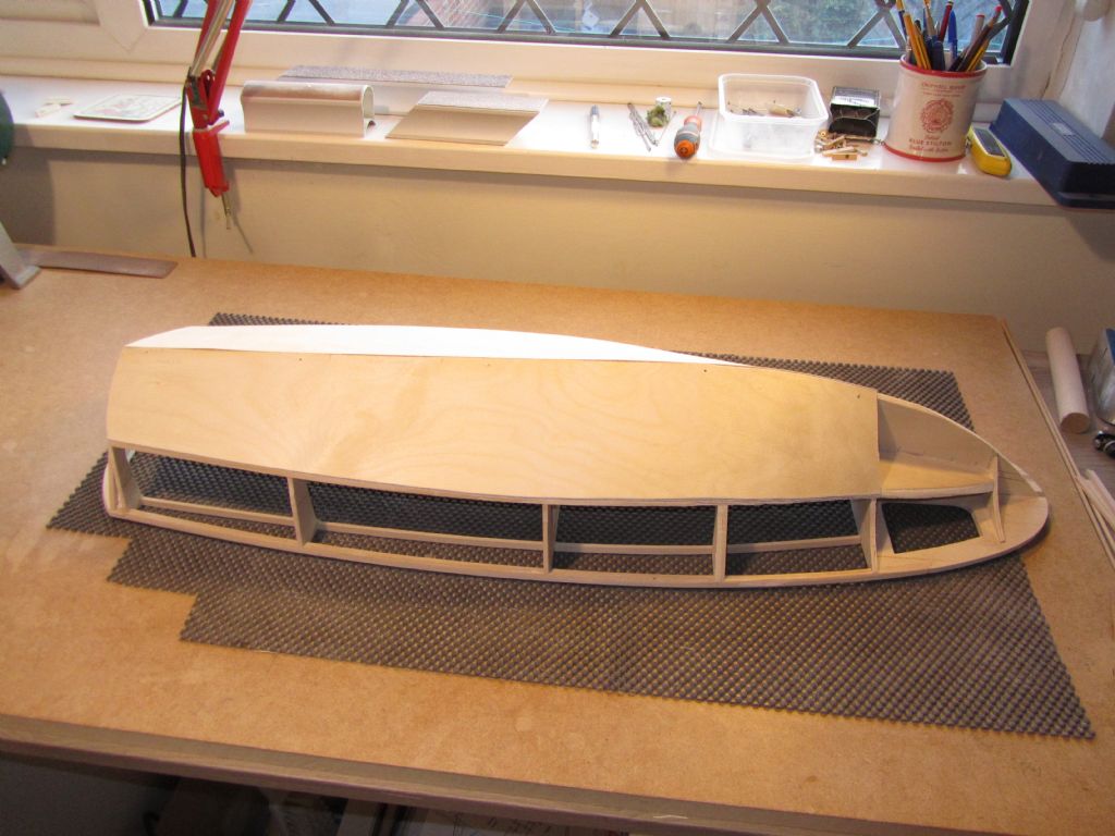

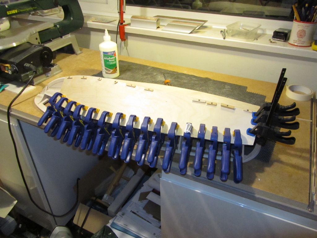

                                                      First time I fitted skins to a hull I was nervous about doing it but enjoy it now as it starts to really bring the hull to life and show its lines with those for the H31 being particularly attractive.
                                                      My stocks of 1.5mm birch ply are rather depleted at the moment and not wanting to order anymore until I can put a good order in to make the postage worthwhile I've used some which is nearer to 2mm. Bit thick for this hull and takes a lot of sanding at the chine and transom but it did the job.
                                                      I usually steam the skins and fit them soon after but with the first one I steamed it and left it overnight, as it was getting late, with the curved part overhanging the worktop. In the morning I'm sure the curve had increased and it was as stiff as a board and I had to re-steam it to flatten it out so that it would fit.
                                                      Using thicker ply meant that I resorted to screws for holding along the keel, rather than tape, and plenty of clamps along the chine!
                                                      Edited By Chris Fellows on 29/03/2020 11:24:39
