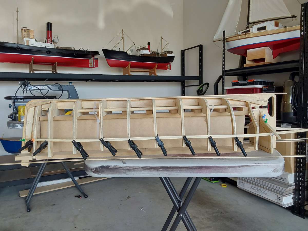

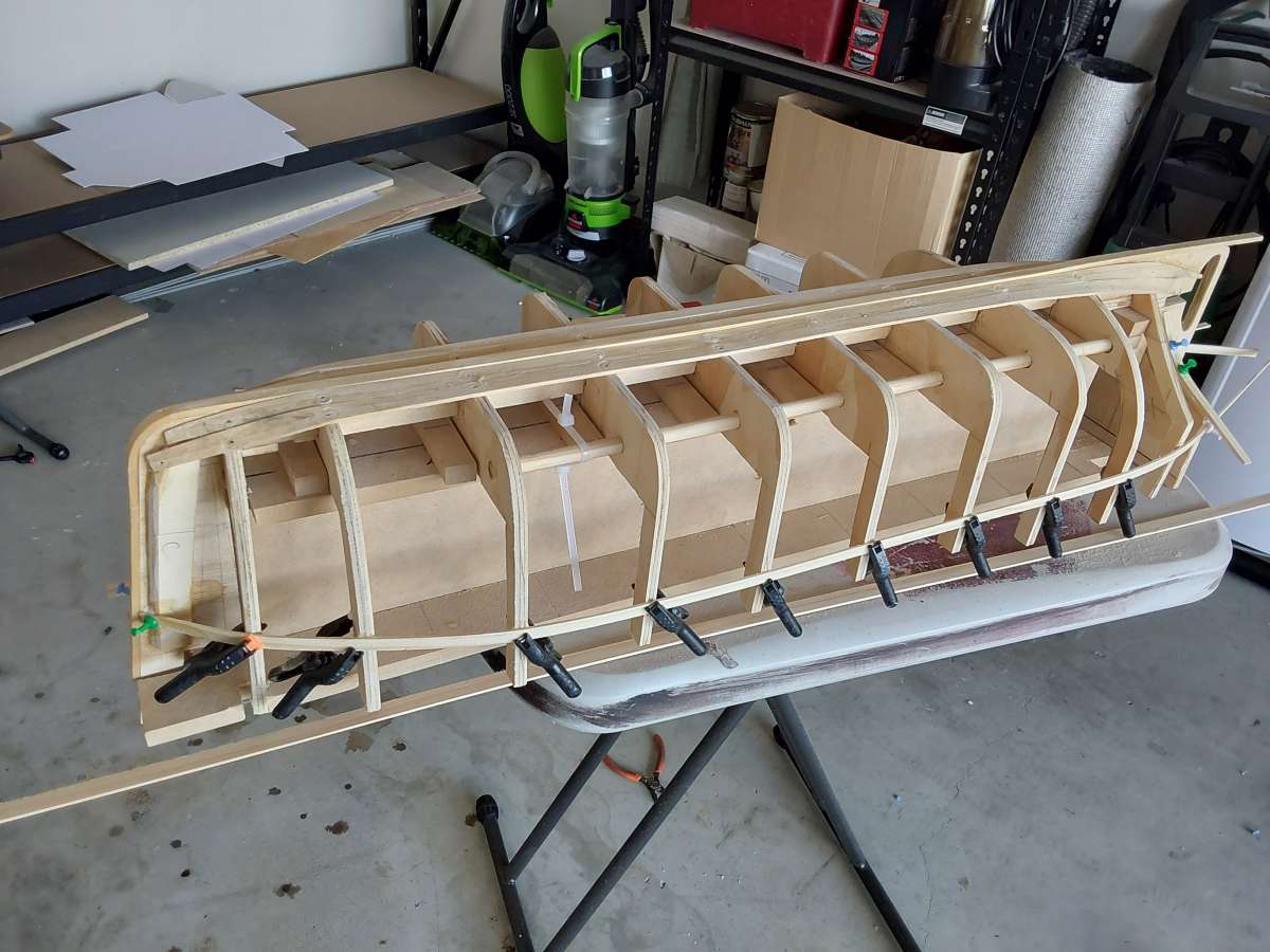

      The latest build .I’m finding this a bit more challenging as I’ve only got ships lines to work from so getting the frames worked out was a tad frustrating. I think  I’ve got it sorted ,it looks alright though. 20250128_09414020250128_094146

        Hello Mick,
        Blimey !! where did that come from ?? fine work as usual I’d block and carve the stern  ??

            I planked the hull on my Puffer, It gets a bit tight around the stern, but worth it in the end, I can understand blocking it though. That would probably be less hassle.

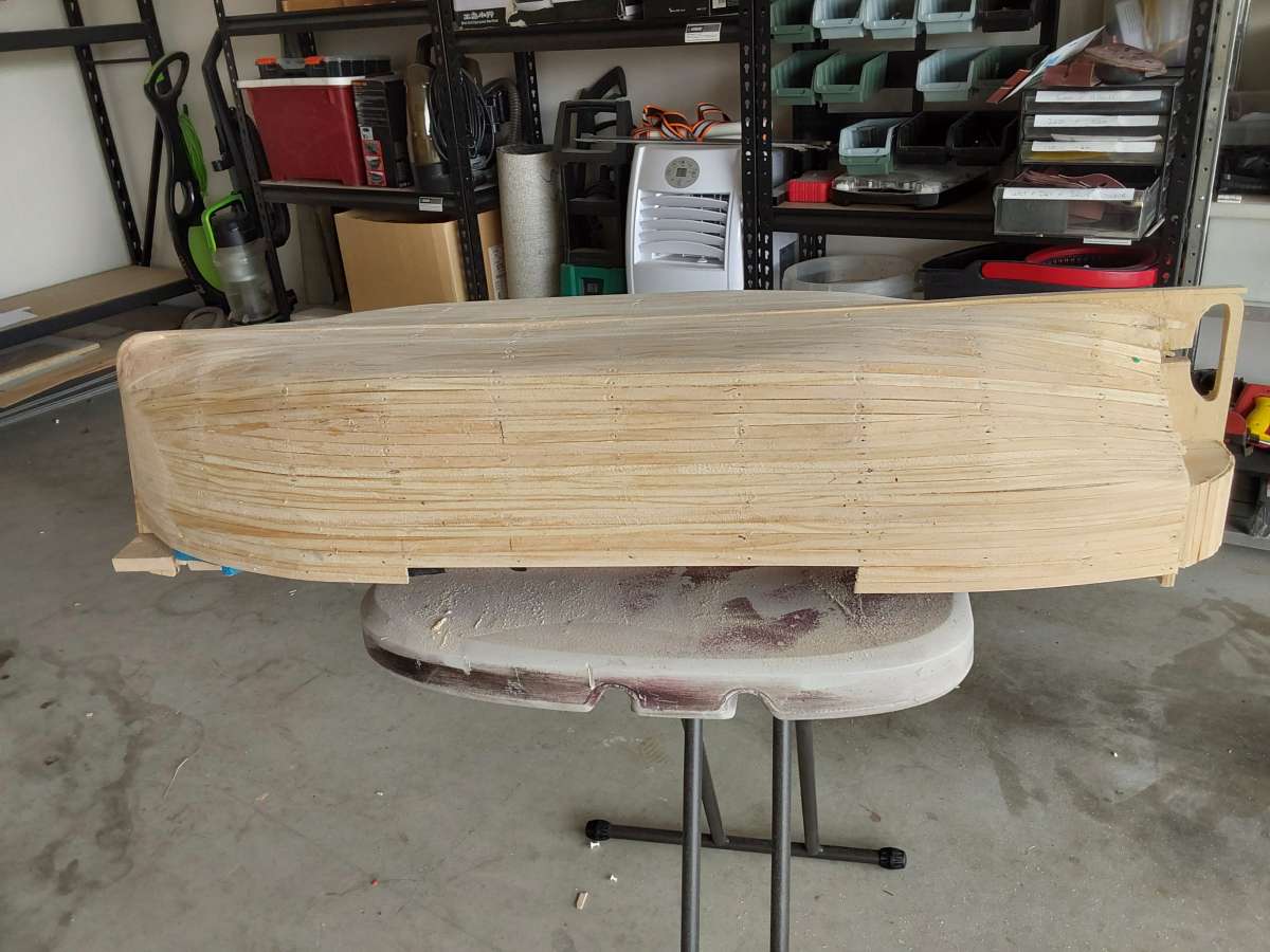

                Planking is now complete so the next couple of weeks I will be sanding,  filling, sanding and fibreglassing . It’s a dusty job and I admit is not my favourite part of the build but time and care taken now will pay benefits later on .
                20250205_092124

                  Hi Mick
                  Nice, very nice!!!
                  I will keep my eye this build.

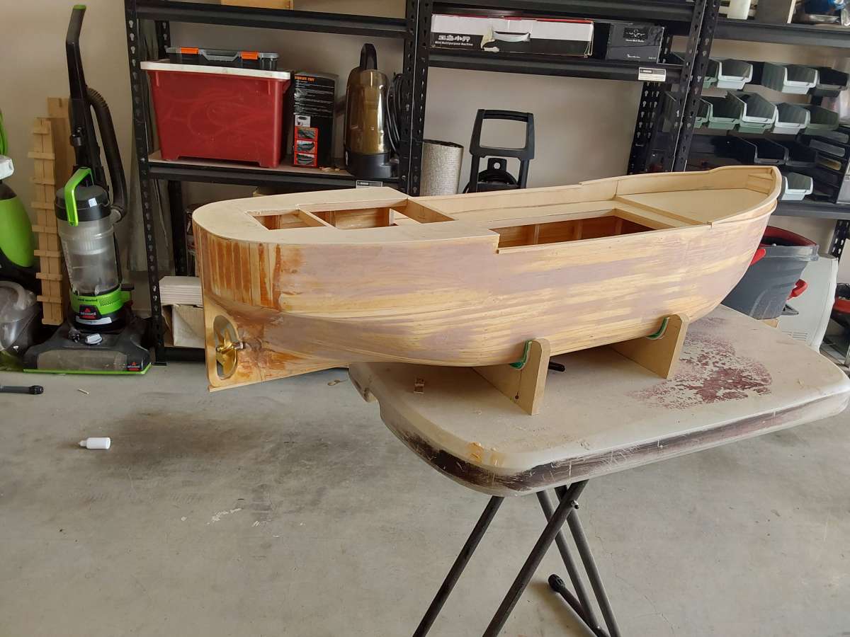

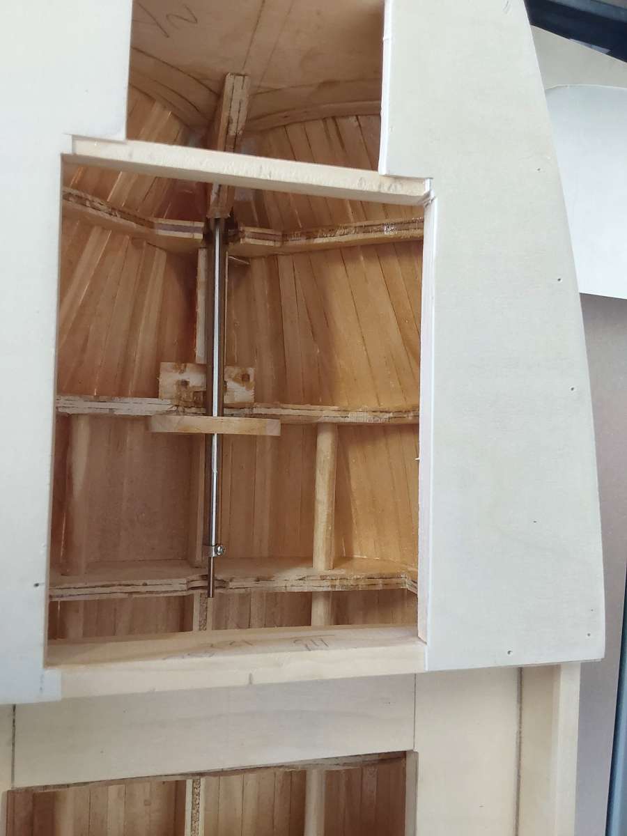

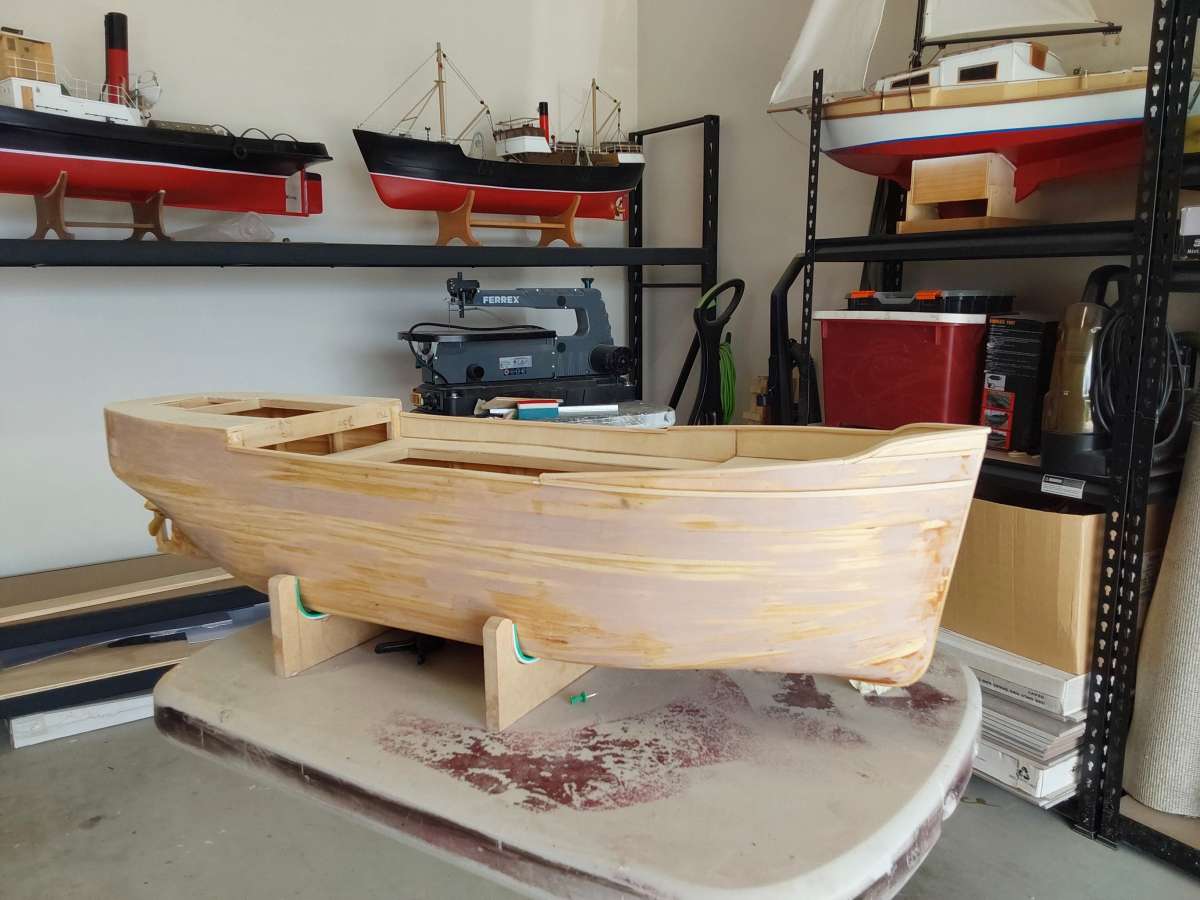

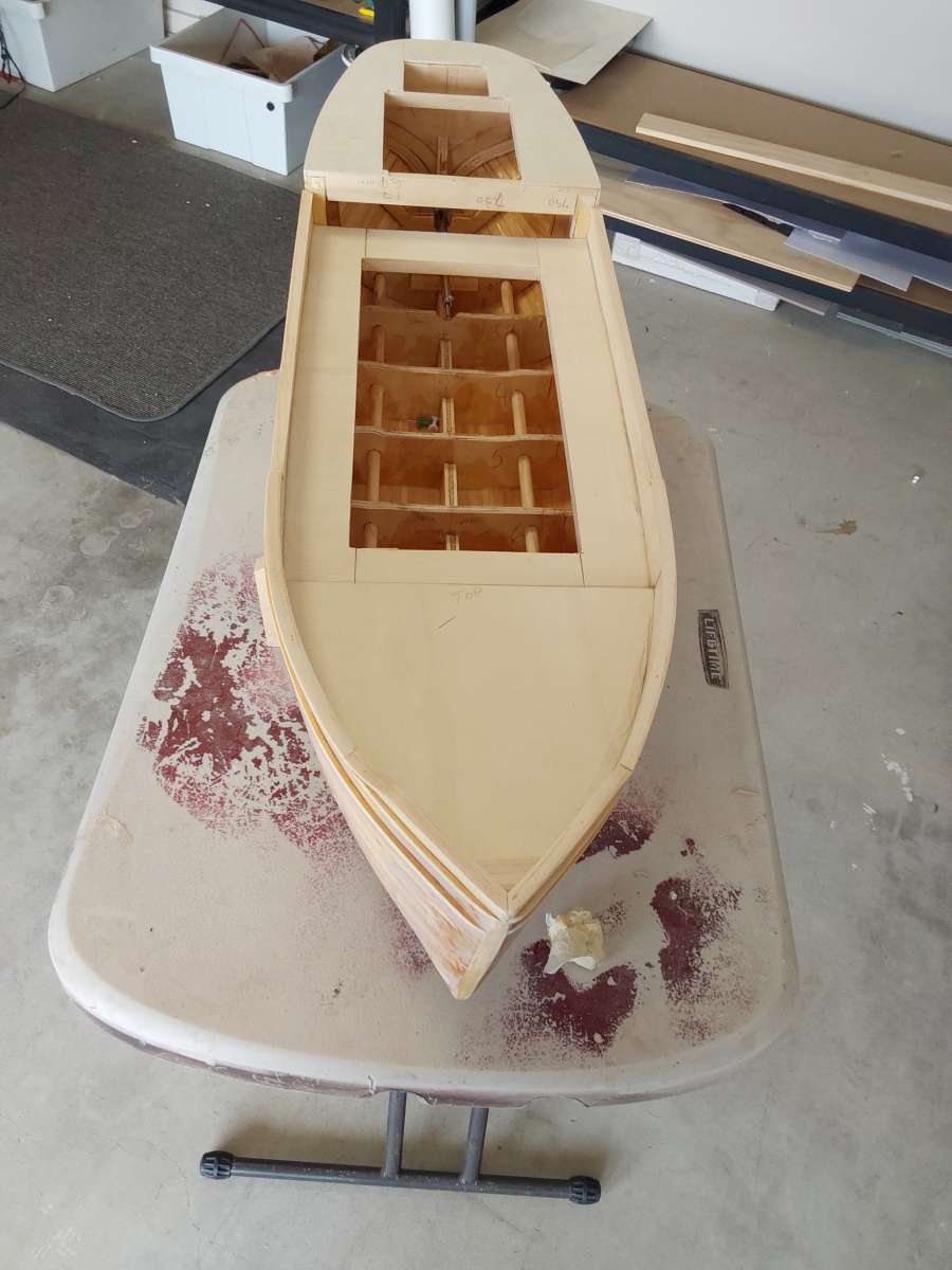

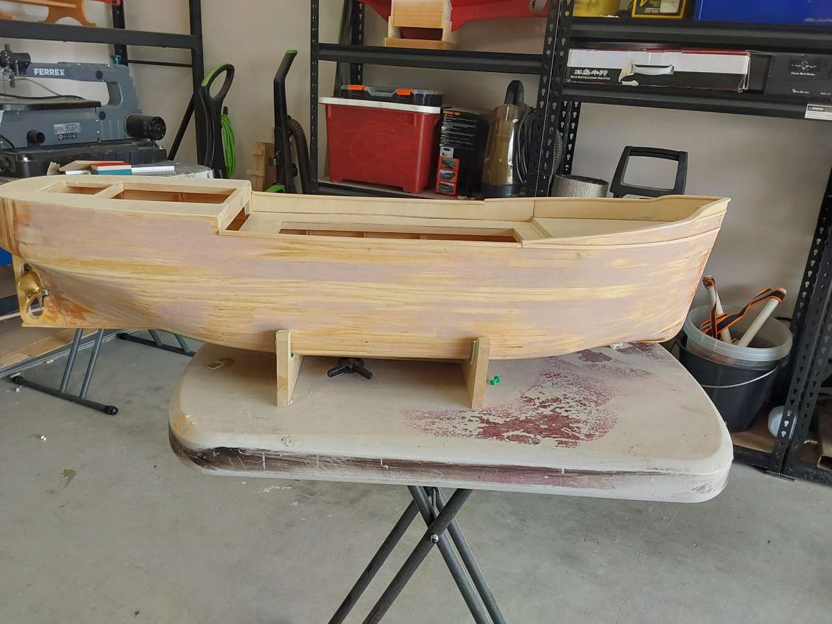

                    Update on progress so far. I’ve finished the hull sanding ,fitted the coatings on the sides and front .I’ve also fitted and fibreglassed the propeller shaft in place. The trouble is that after about 10 am it gets too bloody hot in the workshop (35deg C) to do any work so it’s in the air-conditioned  house and doing some research,  namely watching utube clips of clyde puffers.
                    20250219_124952

                          We’re experiencing the opposite at the moment!
                          It’s really taking shape now and looks great.

                            Hi Mick,
                            As someone who also planked the Puffer hull, that’s a very nice piece of work. Are you going to give the hull some sort of plating? On mine I’ve used card and a pounce wheel to represent the rivets.
                            Enjoying watching your progress. ( could do with some of your weather here, but we have to wait a while yet )

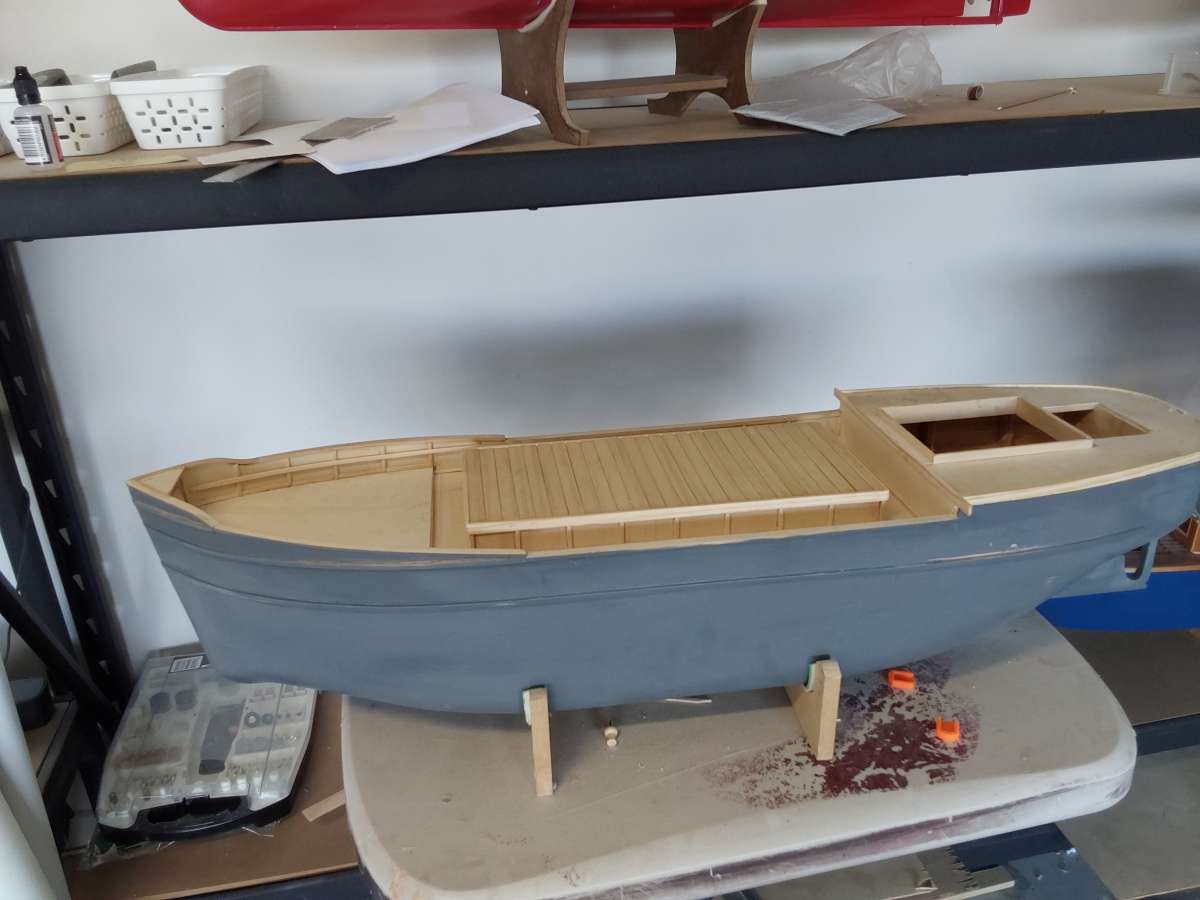

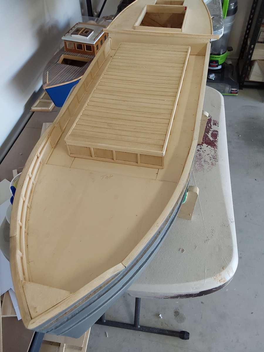

                                    Update . Three coats of grey primer and a light sand back between each coat and I’m happy with the hull. The basic  cargo hatch and sides have been been made ( lots of refining to do). The staunchings have been made and fitted although there not an exact replica of the real staunchings it’s a looks ok and is probably less prone to damage on the lake.
                                    20250224_105133

                                        Hi Mick,
                                        Spot on job as usual 🙂  You are going to need more shelves, If you keep building at this rate 🙂

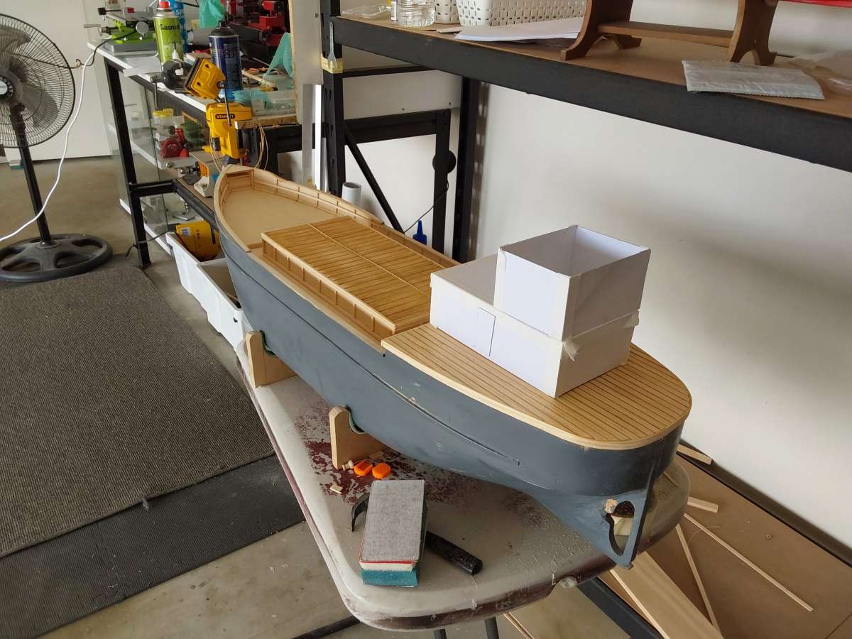

                                            Hi James the reason I am moving in this direction is that I’m building from a ship’s plan with no modeling detail included and to complicate matters further I’m upscaling everything by 20% ie;1/5th. My habit is to Make cardboard templates before before committing to plywood.  To illustrate the benefits of this process, yesterday I made up a cardboard box (mock up of wheelhouse structure) to see how it fitted on the hull . I must have been in zombie mode because instead of upscaling 20% I upscaled 15% it was obviously looking wrong.  So it saved me hours of work and subsequent expletives and waste of materials.  But getting back to your post I am looking forward to the more exciting part of the build namely all the more detailed bits ie: windows /door frames and fittings that take a inordinate amount of time to make but give the model authenticity and character.
                                            20250225_115833
                                            #125036
                                            mick east
                                              @mickeast46851
                                              Another aid I use in the build is I make up a rough model of a man in the scale of the ship and use that to judge if the item I’m building is right . I suppose that building to a model plan would save all that effort but it wouldn’t be half as much fun as doing it my way ( my better half always said “if there was a easy way or hard way I would always pick the hard way” and she’s probably right .)

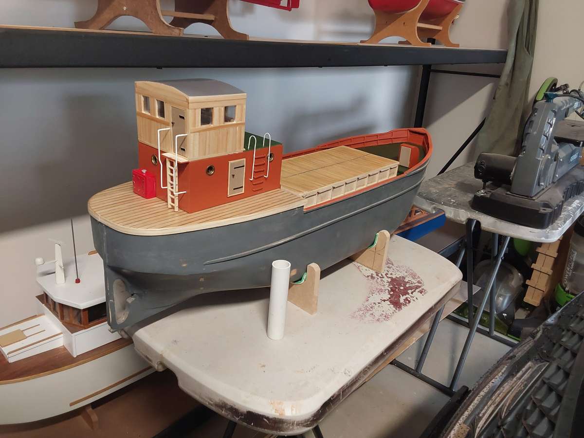

                                                Getting back to more modeling subjects the puffer project is progressing on and I’m pretty happy with the build so far.  As most of you that have shown interest in my previous builds would know I’m not a fine scale modeler , I’m more into getting the feel of the full size subject rather than the exact copy, abit better than stand off scale but none  of them will win any show awards. My best friend (wife) once poetically put it the models capture the romantic picture of the subject rather than a photographic copy. That’s why she’s my best friend she says the nicest things

                                                  That’s the great beauty of this hobby, we can all build what we enjoy and have no-one to answer to.  I also think you do yourself a disservice, you models are very commendable scale models.  What I think is important is that we all look at something we have built and think about how we could have done it that bit better so we are continually learning.
