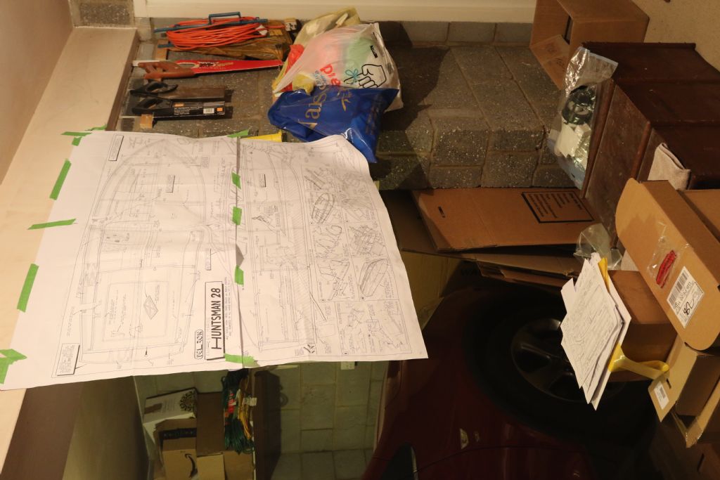

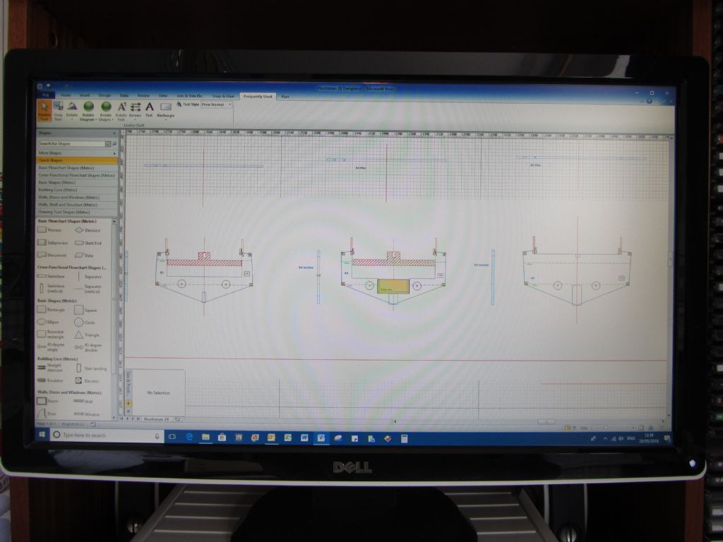

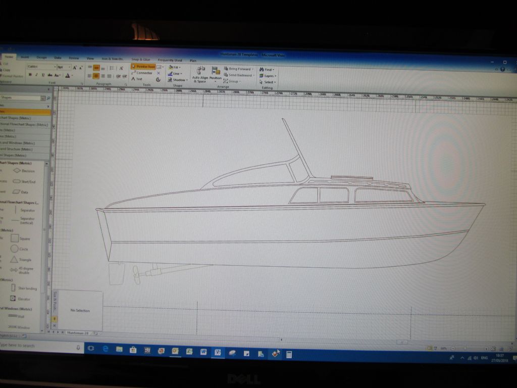

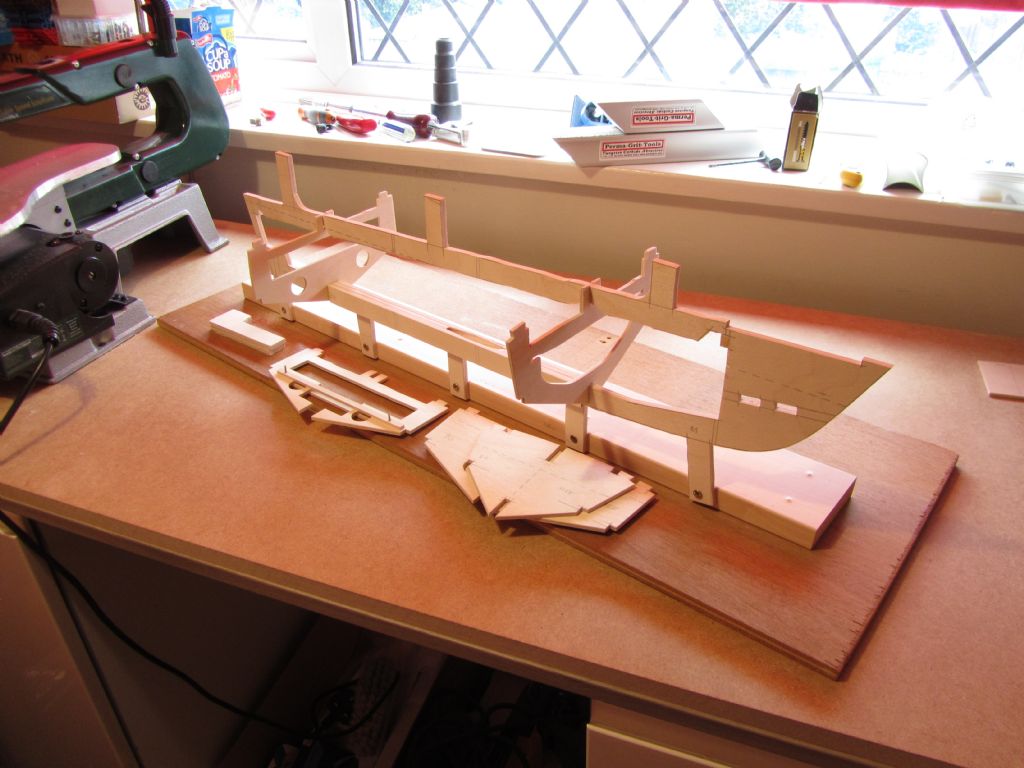

      side view.jpgframes 1.jpgI've returned to the drawings for the Huntsman 28 I started awhile ago (before the River Cruiser got my attention) and have now done enough to begin building the hull.
      I need to order some more 6mm ply for the keel though as stocks are low! I have plenty of 3mm for the frames etc.
      I've decided to get all three hulls (including the River Cruiser & Swordsman) to the skinning stage so that I can learn that process and tackle them all at the same time.
      I've already got the prop shaft that was intended for the Swordsman before I decided to go up to 5mm and the Overlander brushless motor has arrived.

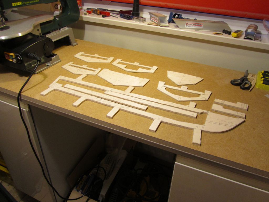

          Frames and keel cut out ready for sanding to lines.
          Must admit I kept looking at the keel etc. and thinking it looks very shallow and long. But I've checked against my drawings and that the frames and keel were printed at the same enlargement and also against the Veron drawings that I have and it all checks out.
          Since this photo sanding has been done, cut-outs for stringers done and doublers hollowed out for prop shaft so all ready to start assembly.
          Ready for sanding

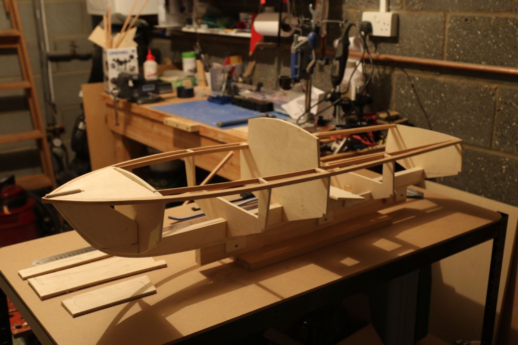

                  Construction has now started with the doublers to the prop shaft area fitted and a couple of the frames. Progress is slow because I'm only using A/Resin and only have so many squares and clamps, though I did make a trip to Homebase yesterday to get a few more clamps.
                  And for you guys a photo of part of the work room that isn't as tidy!

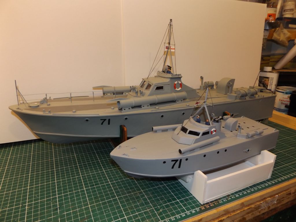

                      Glad to hear your building MTB 71, it really goes well, here is the prototype with it's big brother

                        Thanks Ray, Big brother looks great. I hope my little brother looks as good as yours when finished. yes Regards Brian

                          Good to hear that you are going to build a Huntsman 28. Going by the various forums it seems that very few, if any, have been built in recent years, the Huntsman 31 and Swordsman 33 being more popular choices.

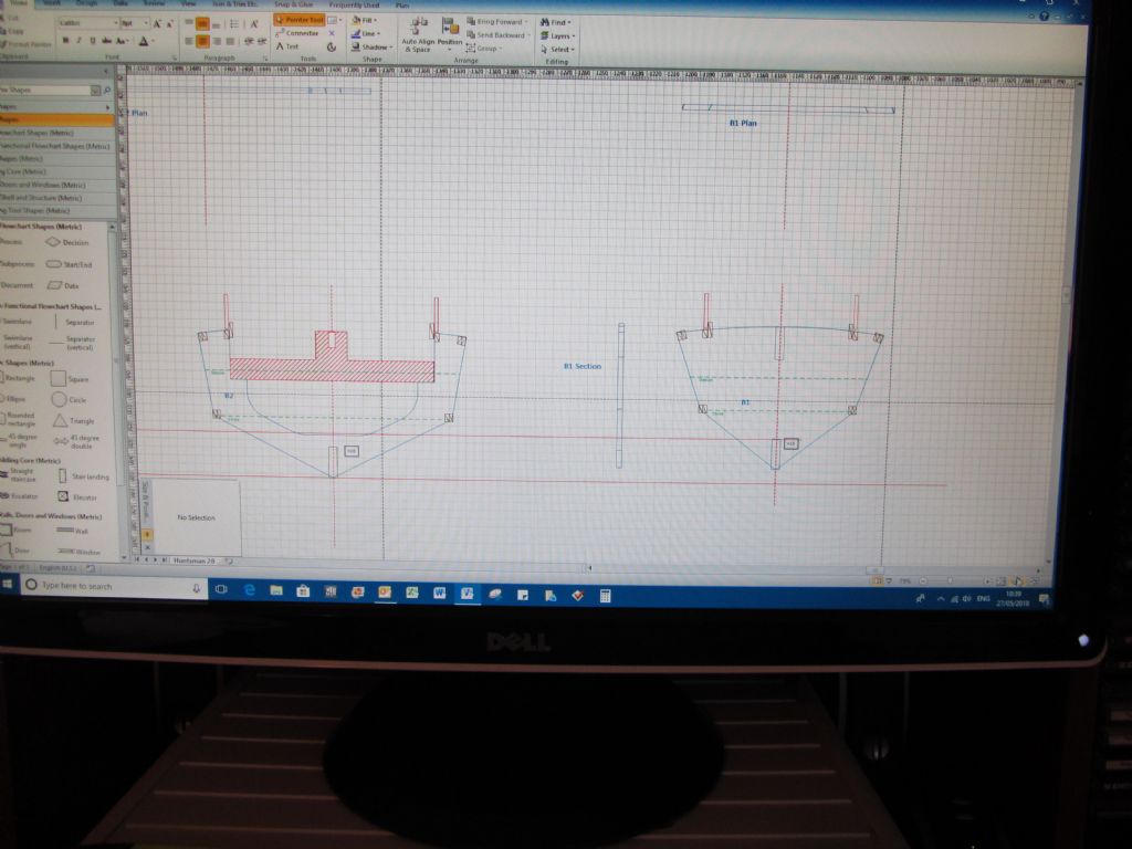

                          I also got the drawings off Ebay and am redrawing as the templates were very poorly drawn and would make it very difficult to build. Also I wanted to make some modifications to the construction and reduce the size to a scale of 1:12.

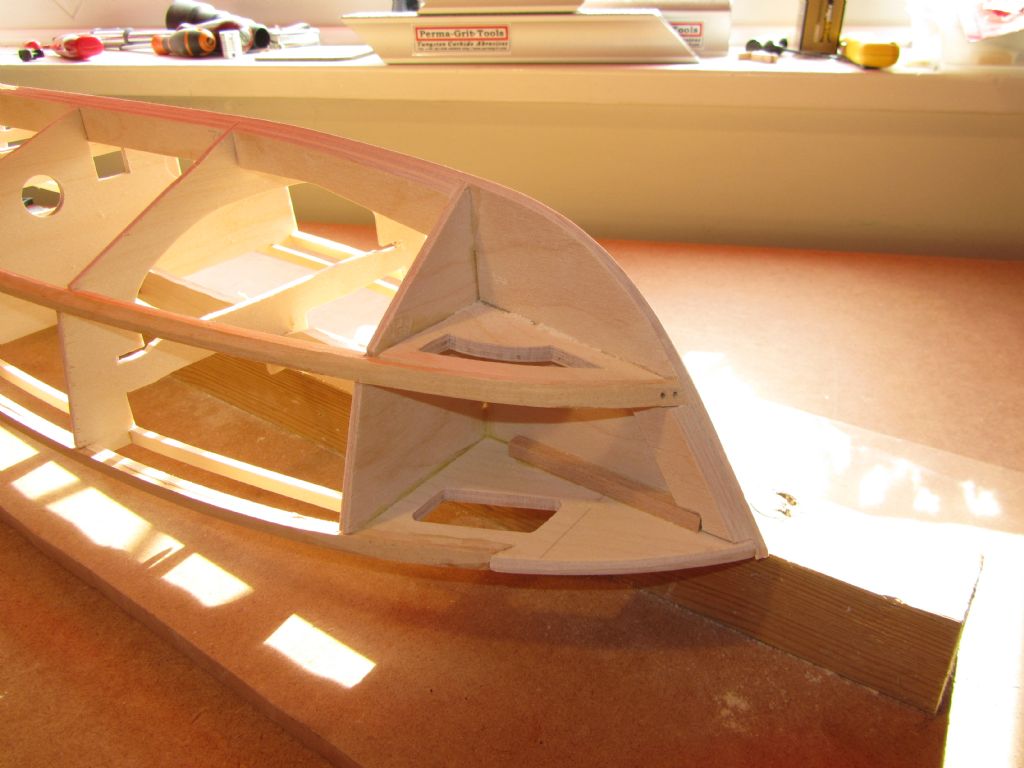

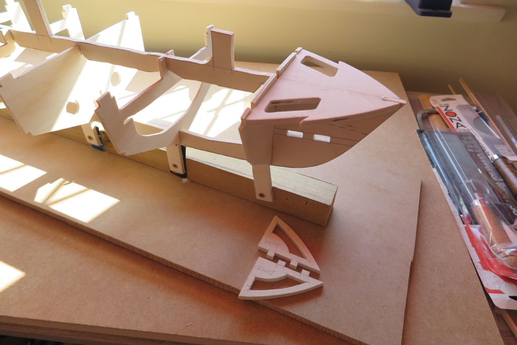

                          I have been making some progress lately when not distracted by doing things outside! Slowly, slowly, but I've added the chine formers today and so will start adding the stringers tomorrow. Won't be long now before it's at the same stage as the other hulls and ready for skinning.
                          One mistake I did notice when fitting the chine formers is that the breast hook is a tad short at the pointy bit! So I shall remedy this by adding some timber to each side and sanding to shape.

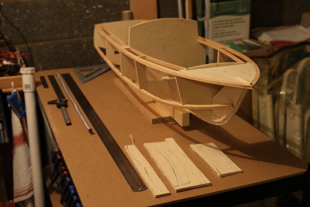

                                  #78627

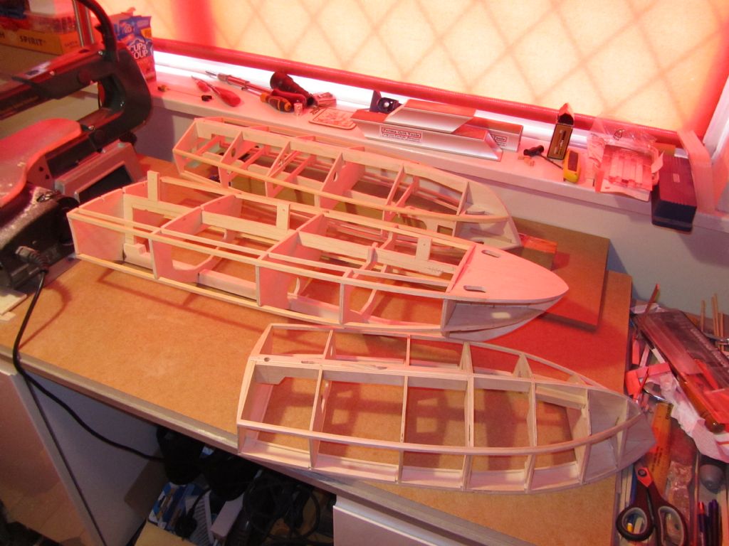

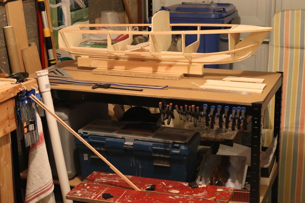

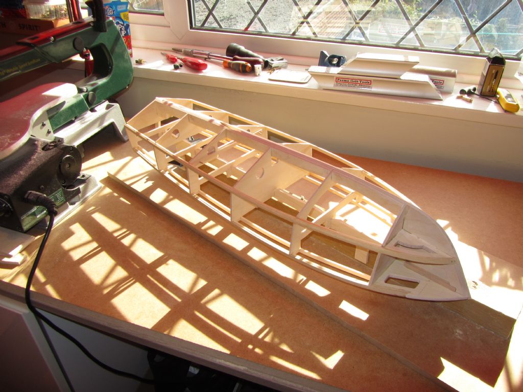

                                    3 Faireysimg_3106Picture showing stringers in place and sanding to those and the keel carried out. Also one of the pointy bit which was fine in the end and didn't need any additional timbers gluing to it.
                                    Picture of all three hulls; Huntsman 28, Swordsman 33 and River Cruiser! All almost ready for skinning now. But I'm seriously thinking about starting another! A Huntsman 31 to one of DM's designs.
                                    That's in addition to the Fisherman for which drawings are progressing well. Oh and there's also the Spearfish kit I picked up!
                                    Chrisimg_3105

                                      Blimey! He's got more Faireys in his workshop than I have! I'm buying shares in Halfords for when he gets to the painting stage.

                                        A pretty impressive selection in the build stage with plans for more! Do you ever come out of the workroom. I can only imagine the shed is an annex to move into when there's no more room in there. Thanks for sharing the pictures, they look well finished and just begging for a skin.
                                        Did you redrawn templates work out OK? I took note of your drawing skill set and downloaded a free version of Draftsight, as I was having difficulty in the cockpit for my MTB71. Their website had a good tutorial, so I've added another skill, albeit I'm still a bit clunky, but managed to put together a design which worked out OK. Scaling to print was a bit of a pain and was more trial and error than fix settings. Any Suggestions?

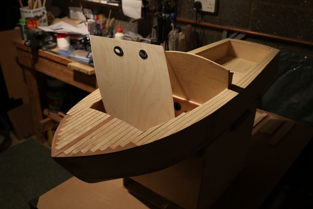

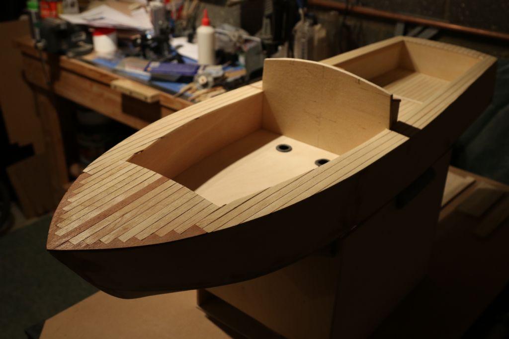

                                        What are the two holes in the Huntsman's foredeck? These are not on my plans.Are they something you have added or an update to the original Fairey design?

                                            Brian – those are the results of quite a few months work. I haven't been able to spend as much time as I'd like building and I'm still working part-time for a few more months.
                                            I'm getting quicker with each build which is why I fancy starting another!
                                            Yes, those holes were a modification to clamp the stringers whilst gluing. I only used the top and side views from the kit drawing and drew up the bulkheads/frames from them as the templates were so badly drawn.
                                            For printing I did the same as you. Printed out and measured and altered as necessary to get the right size.

                                                Discrepancy is being polite Brian. The templates were absolute crap and as you say drawn (and I use that term loosely!) I assume around the kit templates.
                                                As well as wavy lines they are not symmetrical so would be a nightmare to build from.
                                                The plan and side view, being the kit drawings, were fine and using the deck/gunwhale and chine stringers as reference it's fairly straightforward to produce the frames/bulkheads.

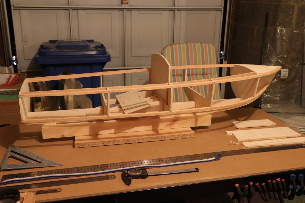

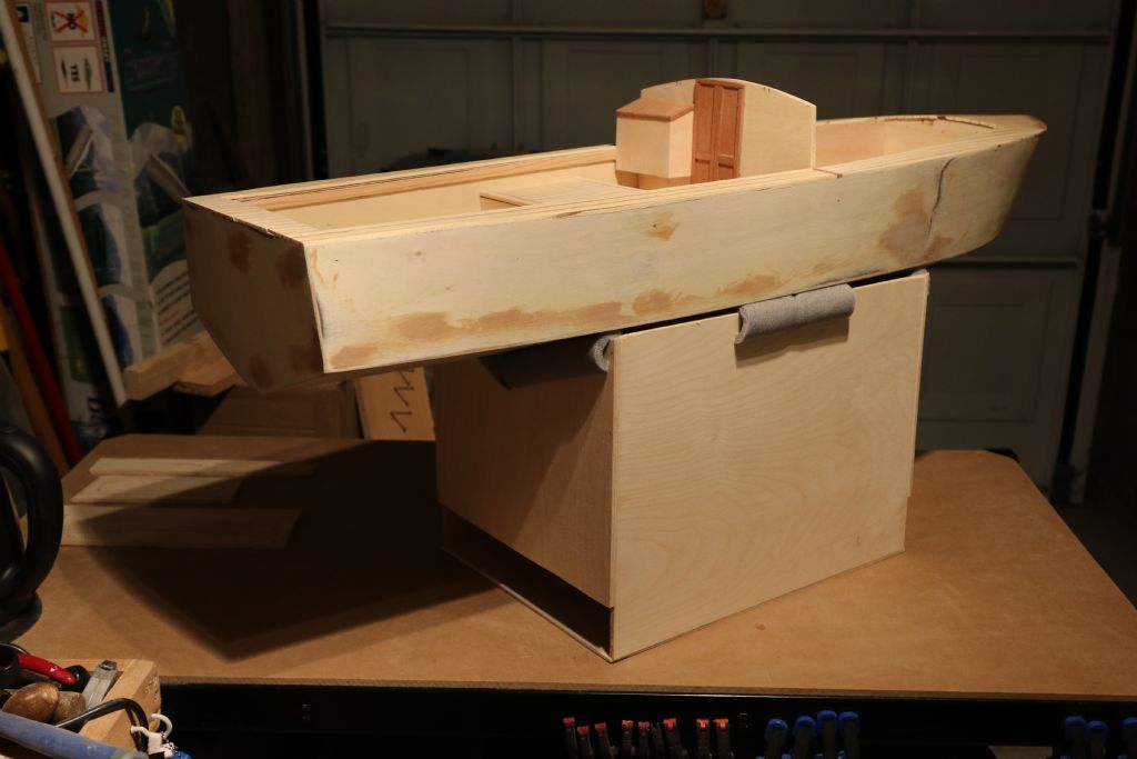

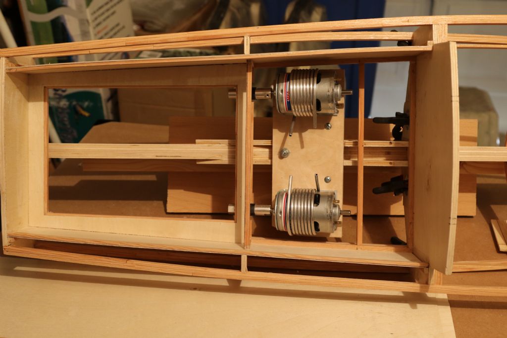

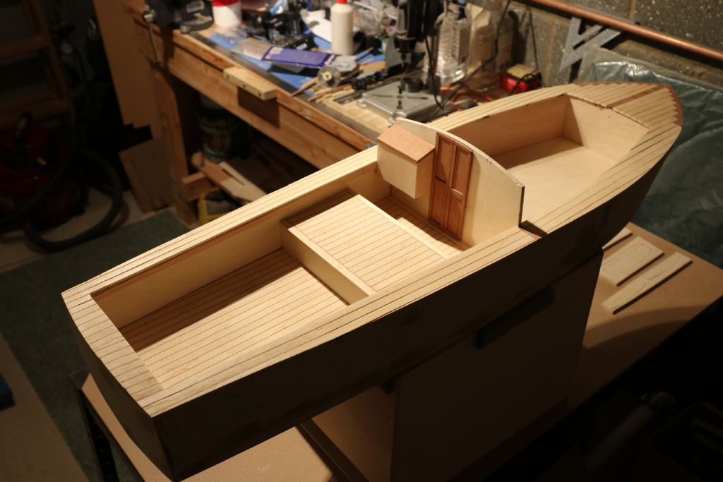

                                                  Hi Chris, Here are a few pictures of my H28 during stage 4 of its build.
                                                  I decided on sticking with the plan and templates from e-bay, although I've had to do considerable adjustments to correct them.
                                                  I firmed up on the twin motor arrangement and purchased two 850 torpedo motors and water cooling coils. I have had to reposition the motors by shortening the prop shafts as the motors encroached on the cockpit well. This should improve the overall COG as these motors are quite heavy, but at the cost of replacement prop shafts. I'm awaiting delivery of the flexible couplings before firming up on the final length of the replacement shafts.
                                                  Have you any progress to report on you H28?
                                                  Best regards, Brian

                                                    Surprised that you've gone for Torpedo 850s given their size and weight. I'd forgotten how big and heavy they were until I looked at the one in my big, 46", Huntsman 31.

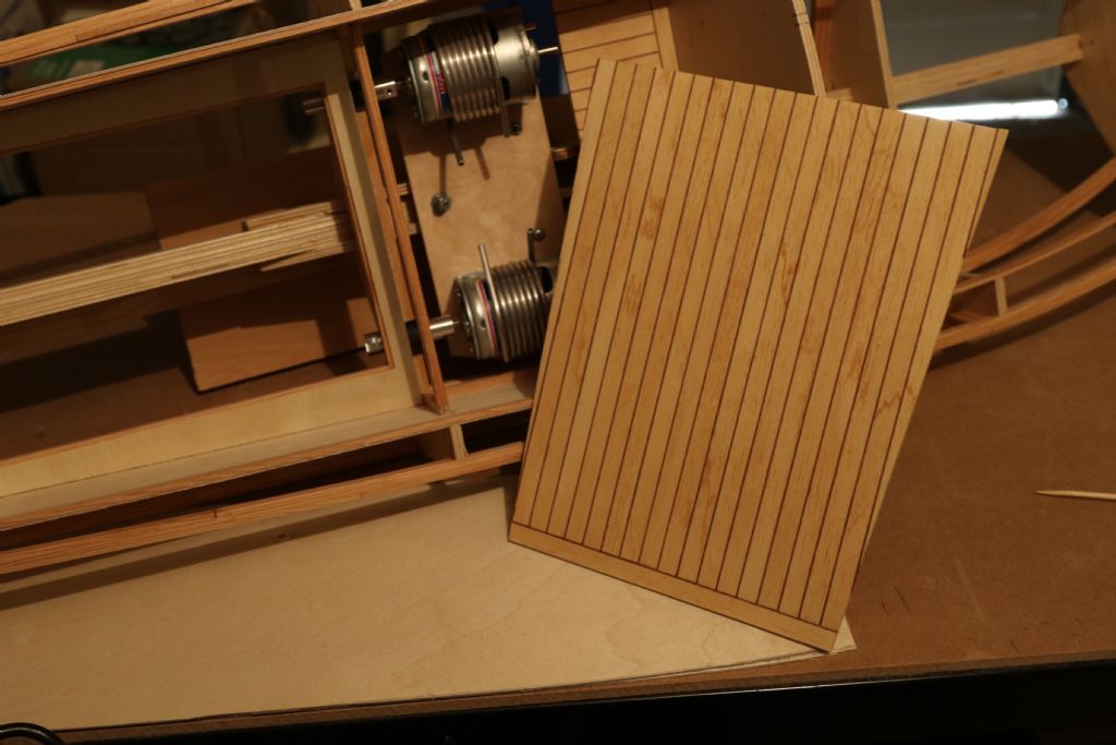

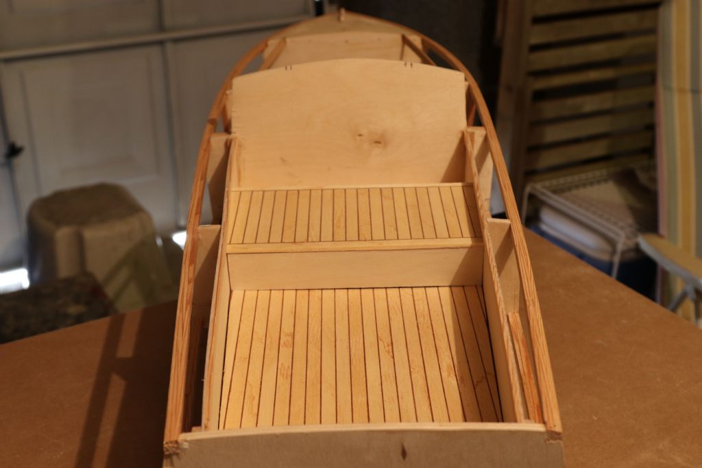

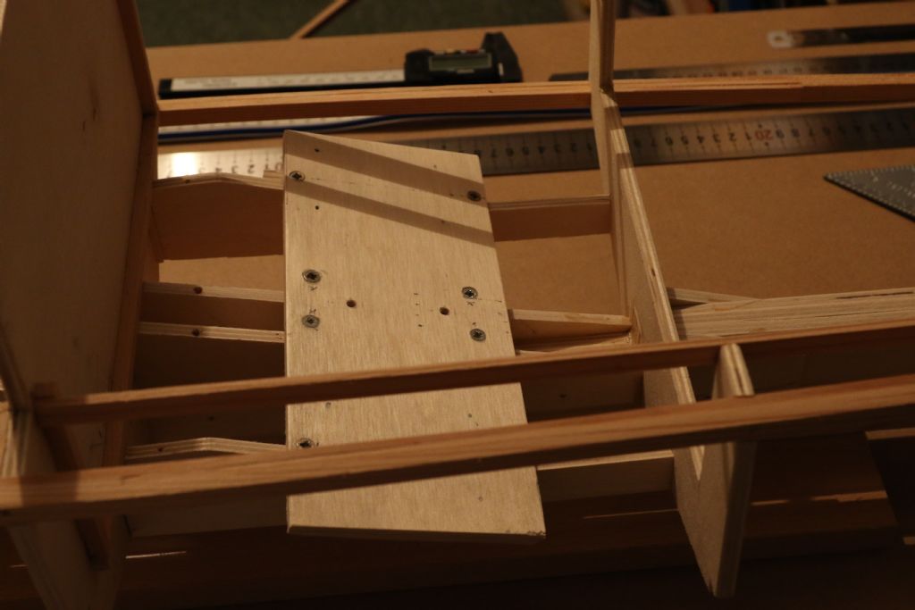

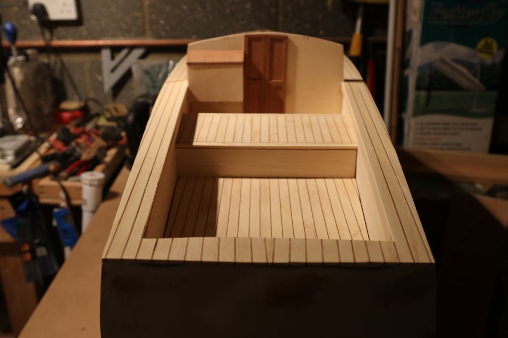

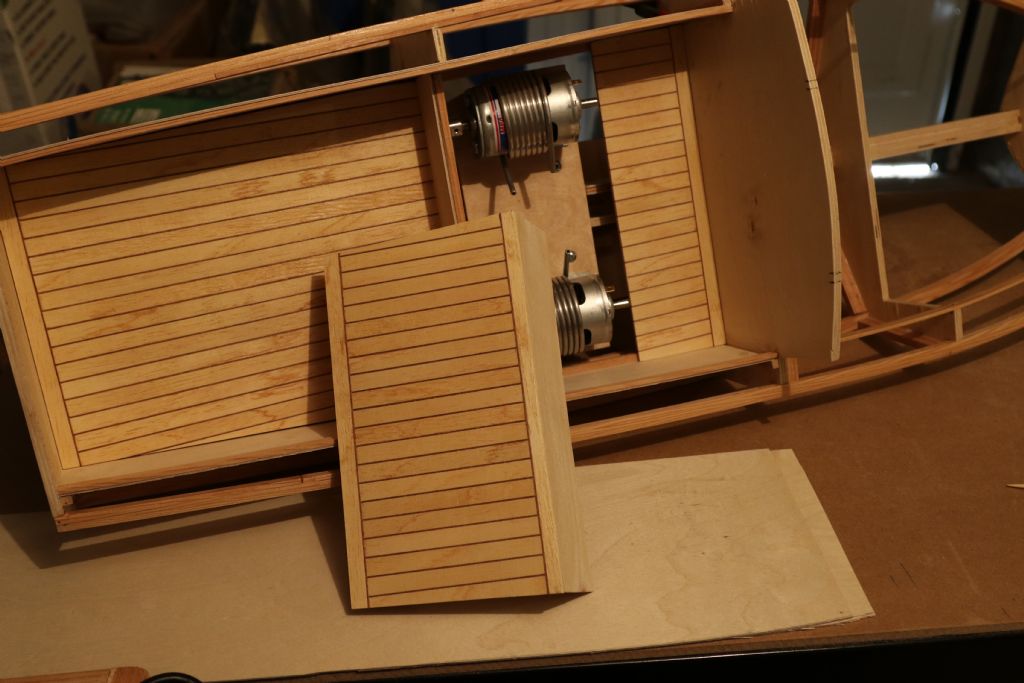

                                                      Hi Chris, A few photos of my progress on the H28. As the motors were too high to fit the seat/cover, I had to reconfigure the motor mount and shorten the prop shafts. This need to be done before I could start sheeting the hull. This went smoother than I thought it would be, although the prow was a bit tricky. Today I completed the decking and gave it an initial sanding.  While waiting for glue to set, I made a dummy door and console (held in place with blue tack for the pictures. I'm quite pleased with the way its turning out. With a few coats of varnish (when the weather gets warmer) it should look fine.   Best regards, Brian

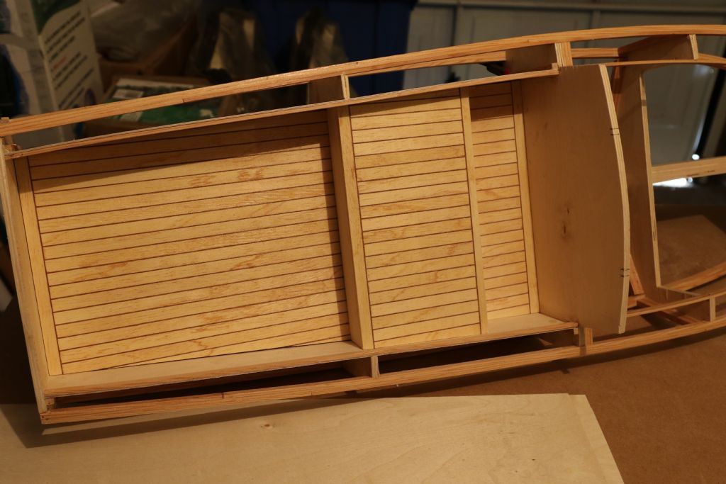

                                                      Hi Chris, Added a few photos of my H28 build following on from the last ones. I've completed sheeting the hull and laying the decking, and just need to sand it downHh
