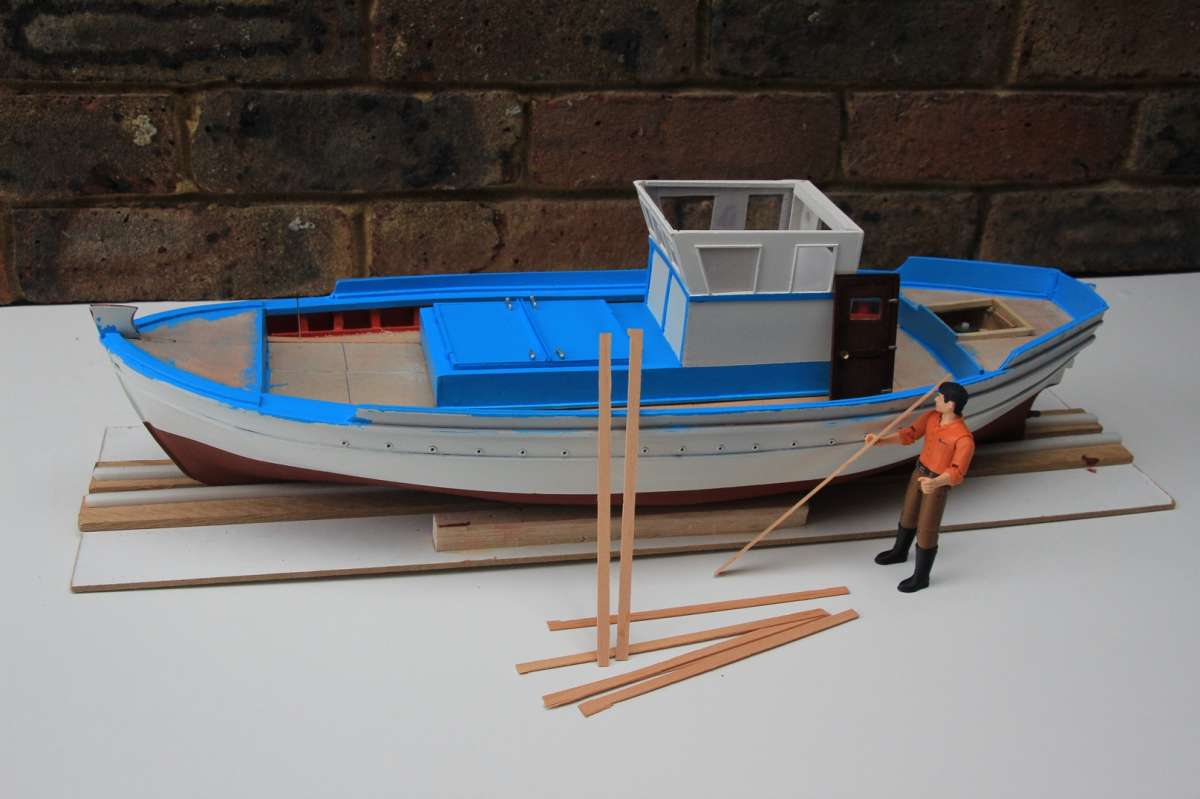

            I find working in wood very rewarding. It is such a versatile material. I made a point of constructing my Greek Fishing Boat almost exclusively from wood as per the original and really enjoyed it. That was basically plank on frame but my other models are wood based with a combination of sheet, plank on frame and block construction.

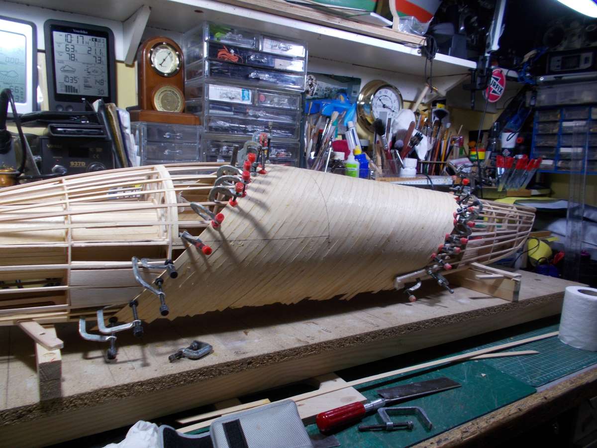

                  Definitely, building a plank on frame hull can be very rewarding.   Building any hull with any form of materials from scratch is an achievement in itself.   There are several ways to plank a hull.  Some hulls you can make the bow and stern from solid materials and plank between them longitudinally.  Sometimes though you can diagonally plank the hull which can be even more rewarding because, on a displacement round chined hull, you have to taper the planks to take into account of the radius of the hull.   One long side, one short side.  Couple of pics – one is the Crusader under construction and the other one is the Fairmile B.

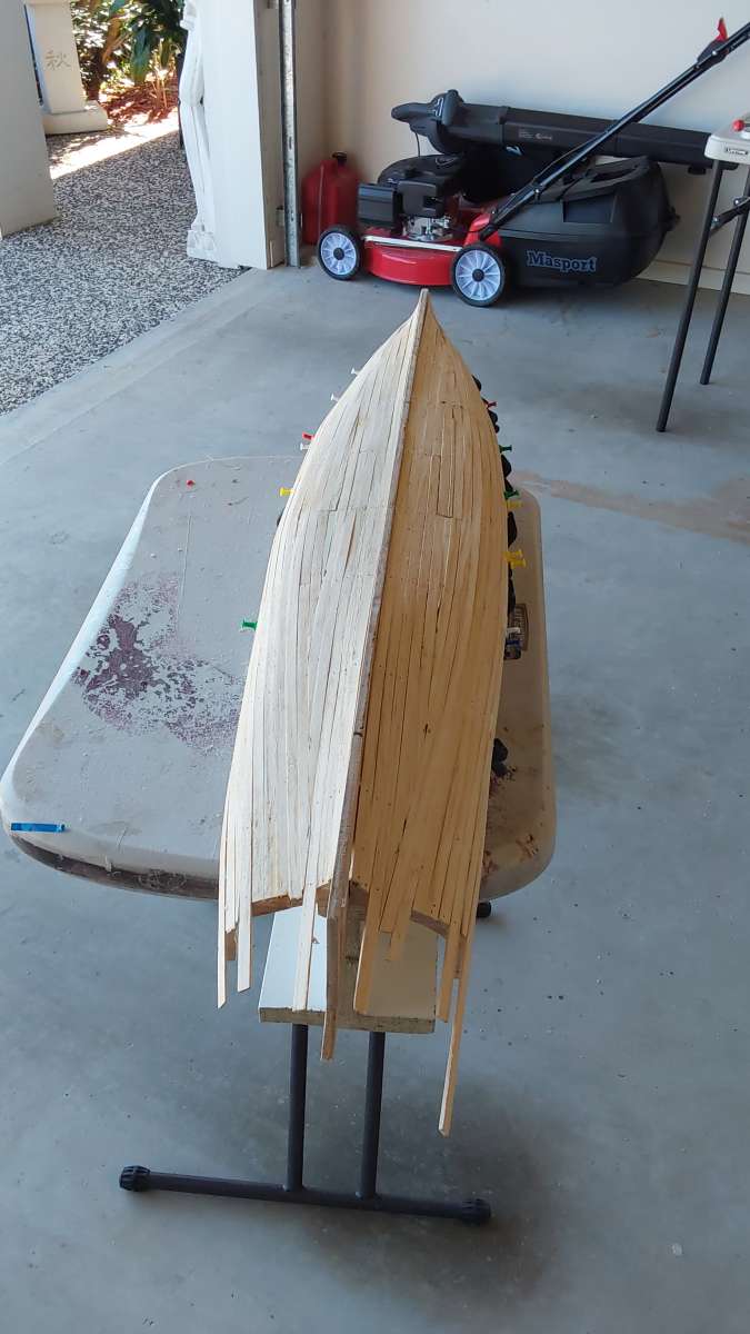

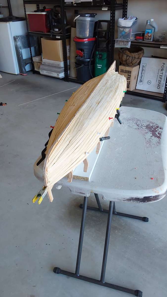

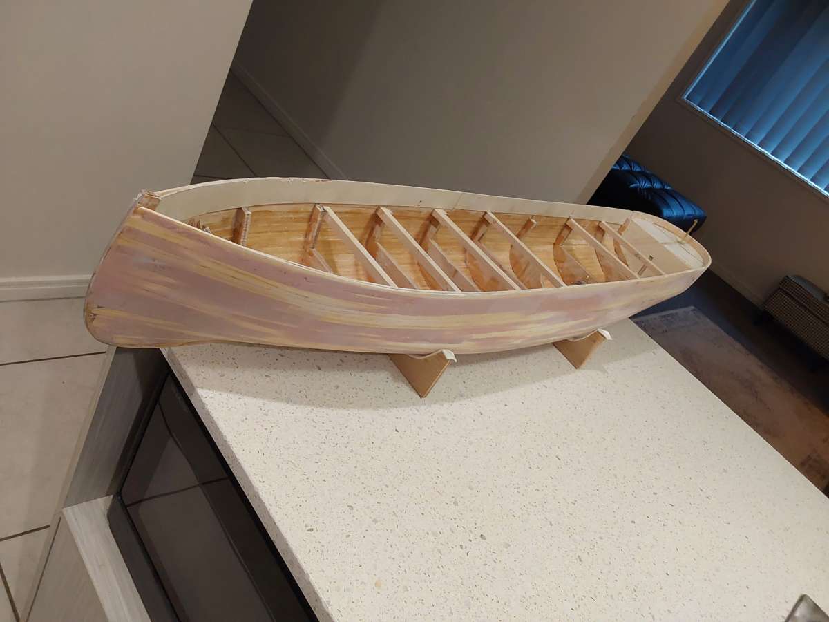

                      The hull of the prefederation 1890s Queensland mine layer is fully planked and off the strong back. You can now see the hull shape with its distinctive bow , I’m really getting into this build as its so different to another ship I’ve built but plenty of challenges ahead to look forward to . This one is going to put my intermediate modeling skills to the test and hopefully along the way it teach me new techniques 20250620_11594620250620_115935
                      20250620_115928Regards mick east aka eastie20250620_115955

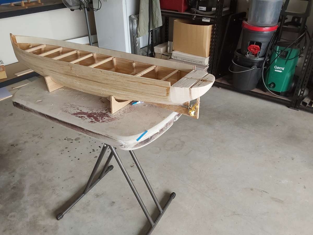

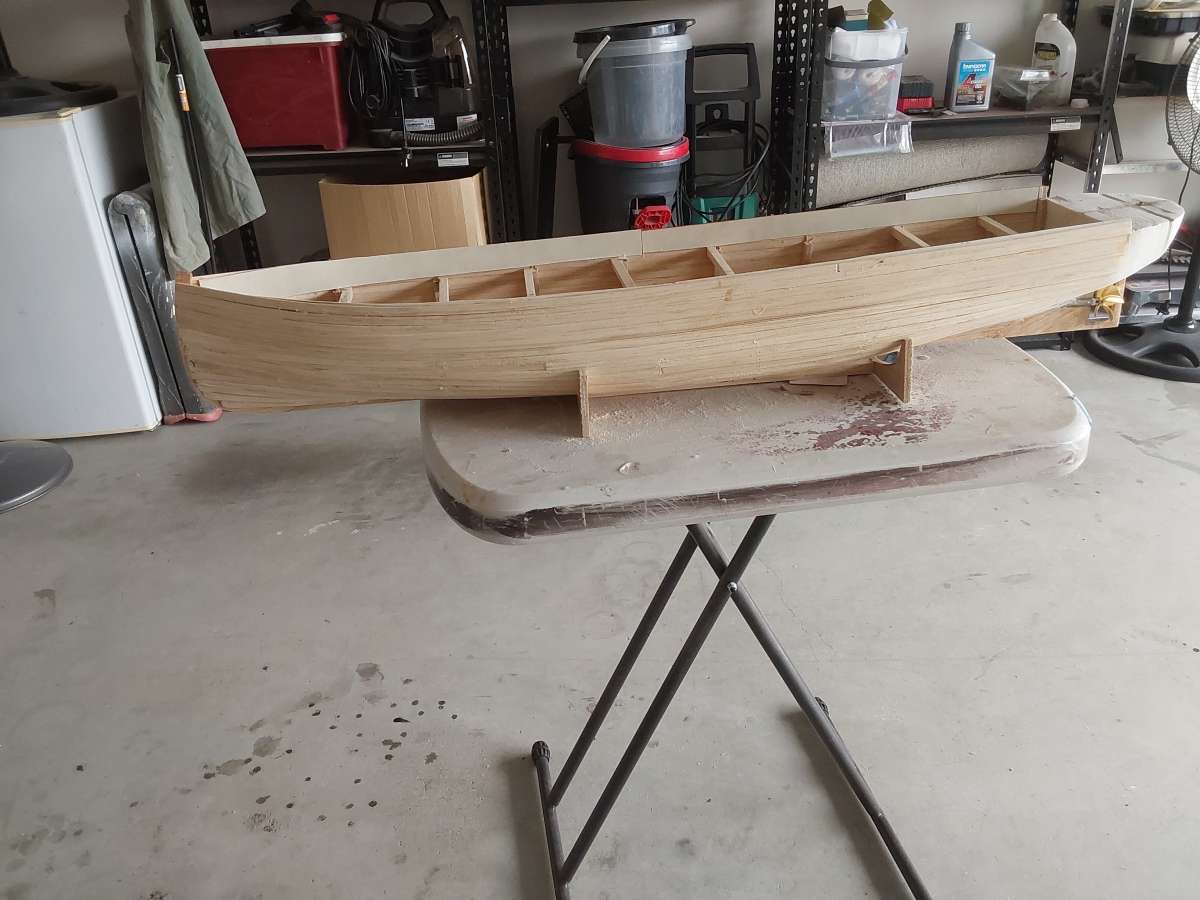

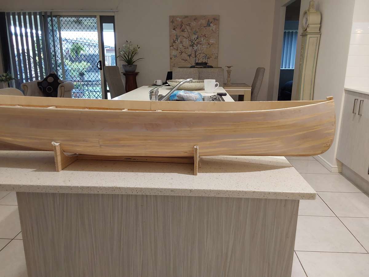

                          The model hull of the Miner has been sanded fibreglassed resin coated ,sanded again ,imperfections filled sanded again and a final coat of resin applied ready for first coat of primer . It a dusty job but surprisingly satisfying one . I think the more time spent on this part of the build pays dividends in the long running. On a different topic after some of you suggested I might write a article for the magazine on one of my builds I contacted Lindsey to see if he would be interested and got a very positive response.  So I’m working on two articles one on the trawler and another on the tug Wattle and which ever one comes out best I will submit to Lindsey in the hope it might be good enough for publication.
                          A few photos of the hull
                          20250630_10253520250630_10254620250630_102527

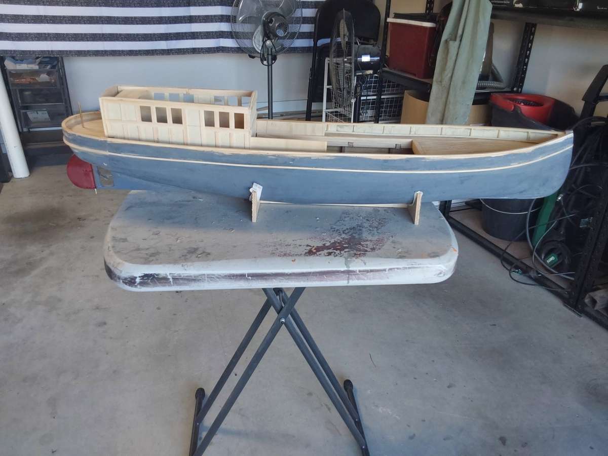

                                      @mickeast46851
                                      She’s beginning to take shape and starting to get a character of her own20250812_09000620250812_090016
