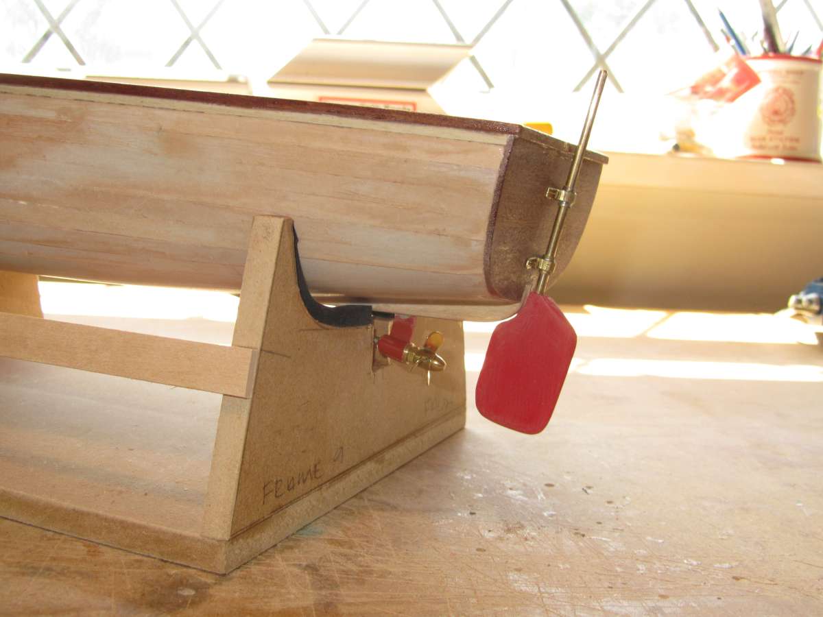

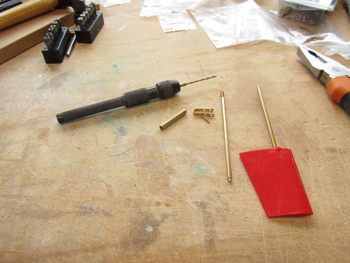

          Being having problems logging into my build blogs again so haven’t been updating. Not that I’ve done that much, especially as we’ve had such a good spell of nice weather.
          The strut for the prop shaft has been glued in place and the rudder is progressing, just waiting for some more materials and parts to finish that off.

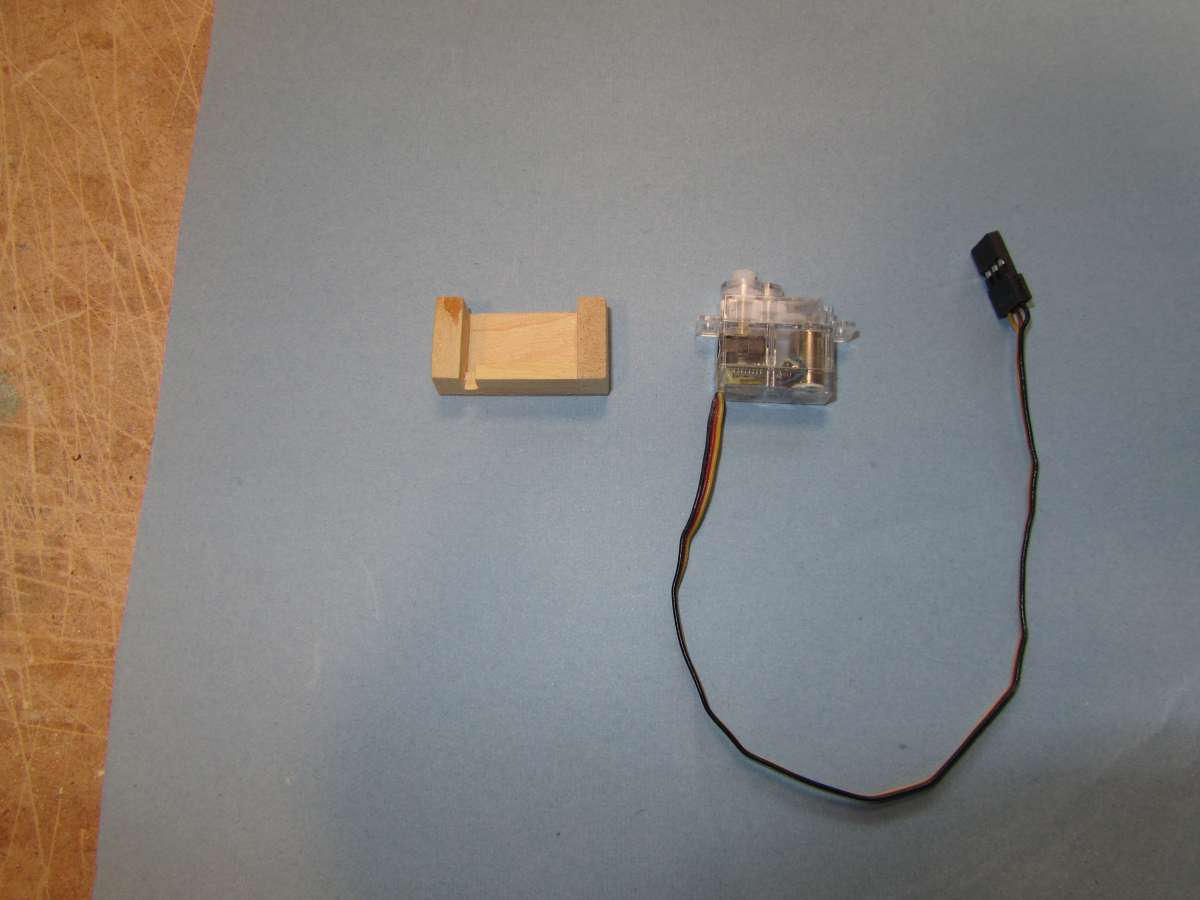

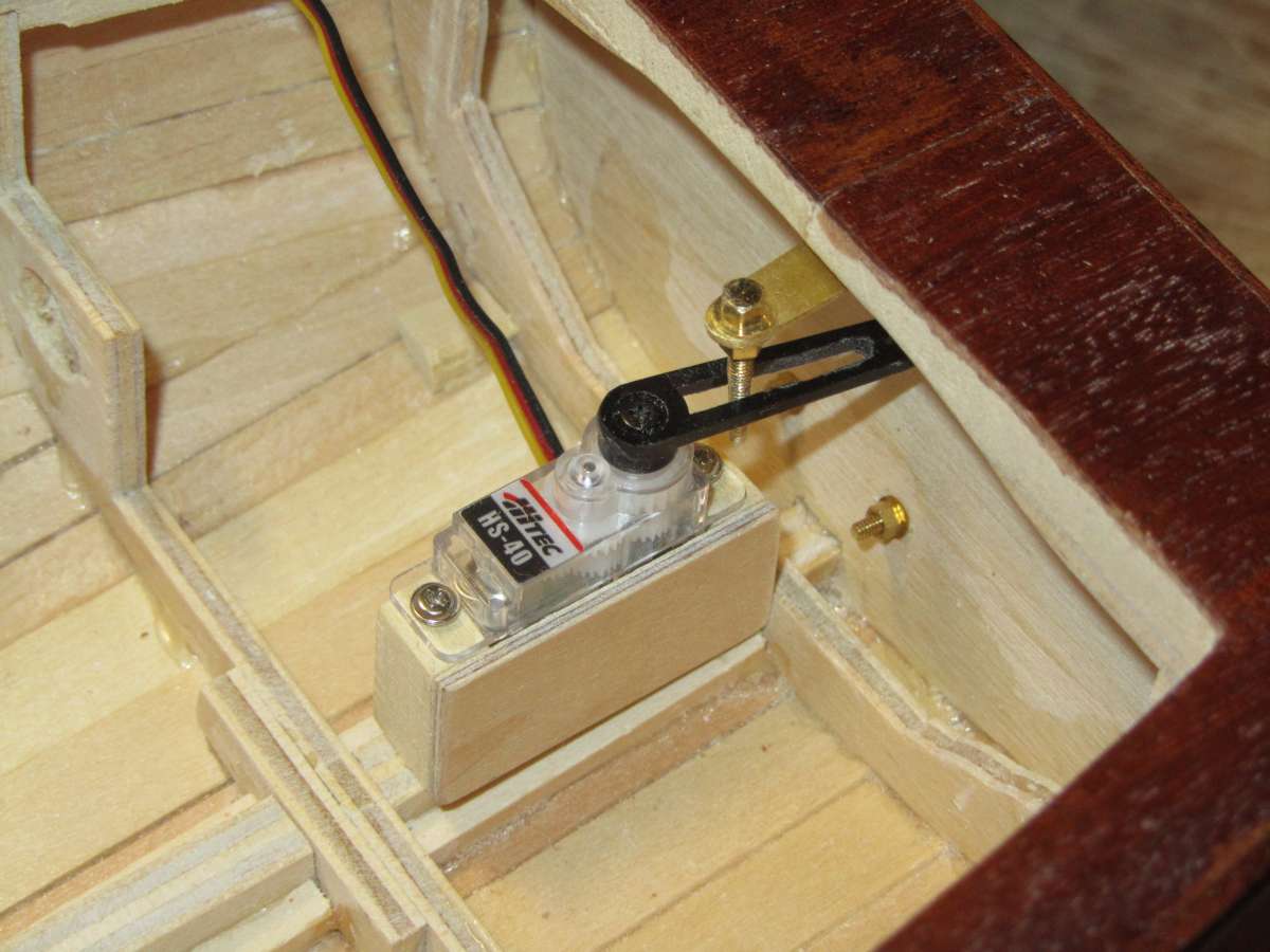

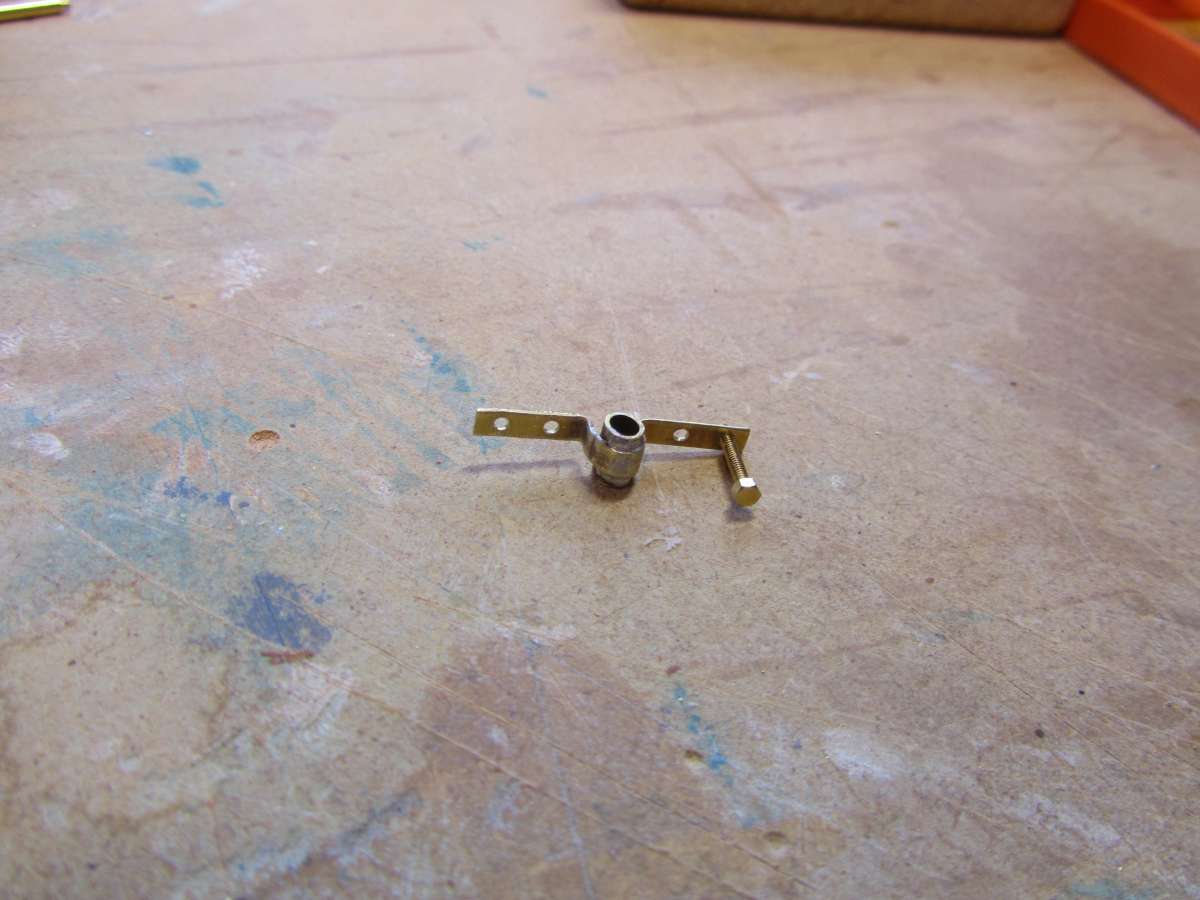

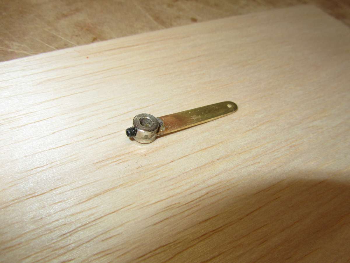

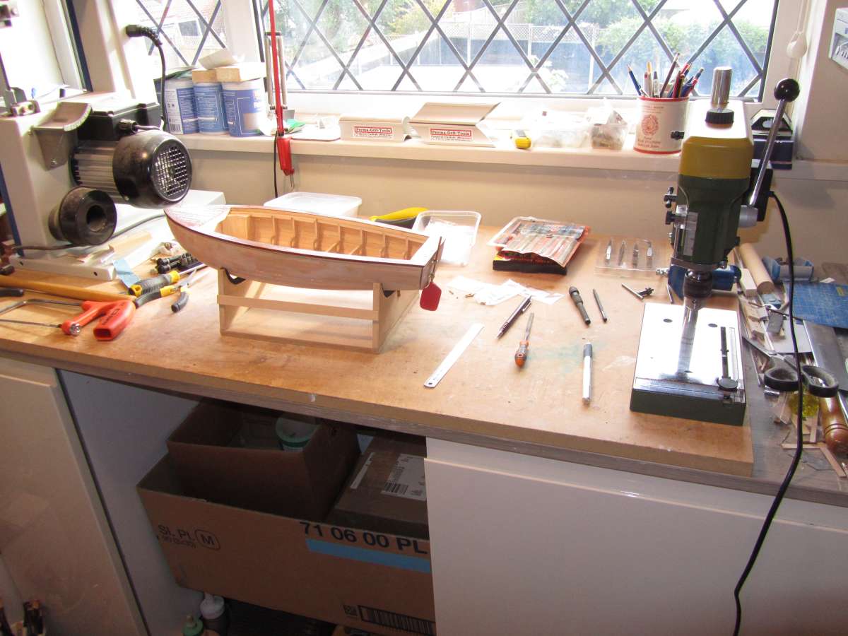

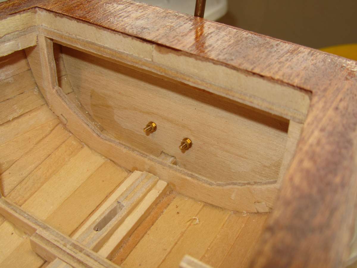

            Still been having log in to post updates problems but Ok at the moment.
            Work has continued with the rudder by making a servo arm and installing a micro servo. It’s position has stopped me fitting the battery as far back as I wanted and I’m having to extend the seating area forwards accordingly. I always knew it was going to be a challenge fitting everything in such a small boat which was confirmed when temporarily fitting the RC gear so that I could see how it affects the superstructure.

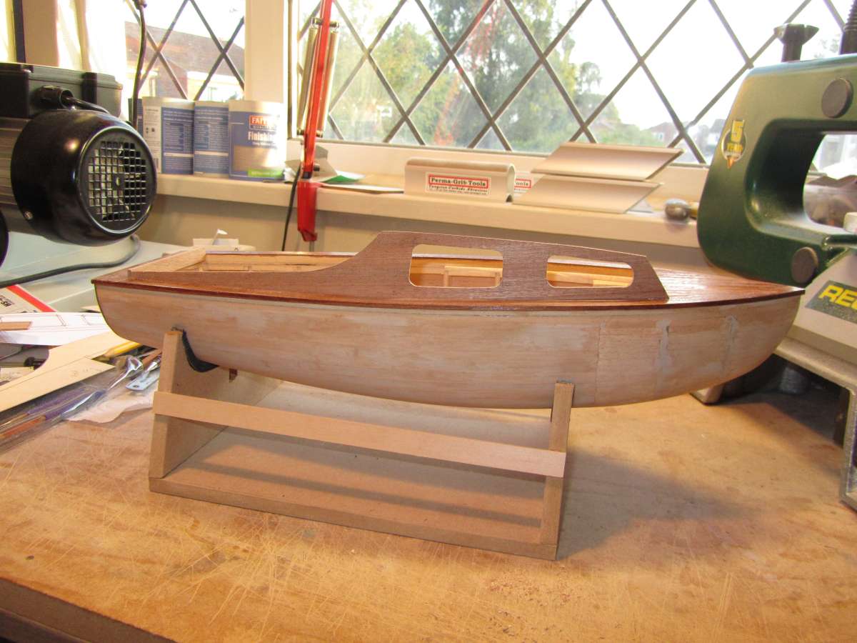

            I really like this hull and am enjoying the build. Have started on the superstructure now and dry fitted one of the sides.

                  In some ways yes Ray, but the build is being modified as I go along including the hull which had to have additional balsa to the bow. If I did produce plans I’d have to do another test build really, which I’m not really keen to do. Also there is also a similar, simpler model with a hard-chine hull available as a kit, the Sea Urchin.

                  Meant to say tiller/rudder arm and not servo arm in my previous post.
