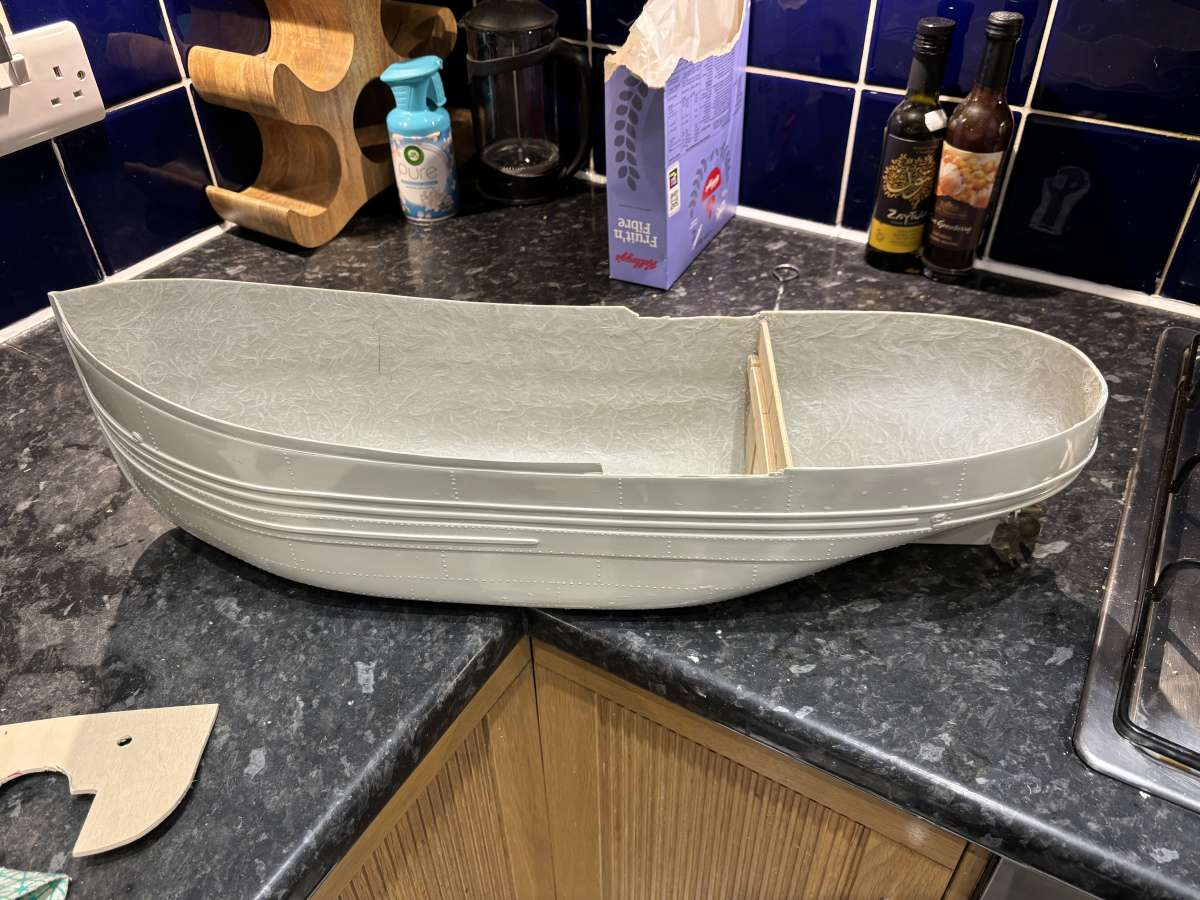

      Well, after much delay, that is me started on my new build. Not much to show in the first photo, other than a GRP hull, one bulkead and a prop shaft, but I have been working on other bits too! This is the Caldercraft Northlight 1/32 kit and I am adapting as I go to more or less resemble the Clyde puffer “Glenaray”. Originally built as a “VIC” for the Admiralty in 1942, she was a carbon copy of the latter Clyde puffers and she soon found herself in that role at the end of hostilities. I have a feeling this will be a long drawn out business, but I will try to update you as I go!

                  Hi folks – yes I have chosen an easier path than building a hull from either wood or tin! All respect to Jim and Len. Puffers are definitely an interesting subject – my favourite mode of transport after paddle steamer!

                    Your hull kooks great with lots of detail.  Nothing wrong with the path you’ve chosen and it gets you off to a flying start.  I’ll follow your build with interest.

                          thanks everyone – i am going to shift some rubbing strakes, but yes am pleased with hull detail. Unfortunately the beginning of build coincided with a new job of work, so is probably going to be a slow one!

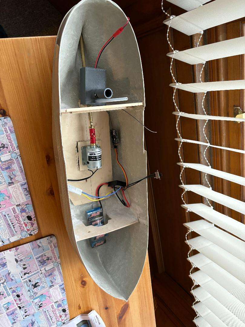

                              bulkheads and lower deck in. most of electronics taking shape.  Now need to align the motor and get it fixed down, as well as get the prop shaft plstered in.

                                  That’s the prop shaft, motor and electronics fitted – goes at more than scale speed in the bath! now to start building properly.

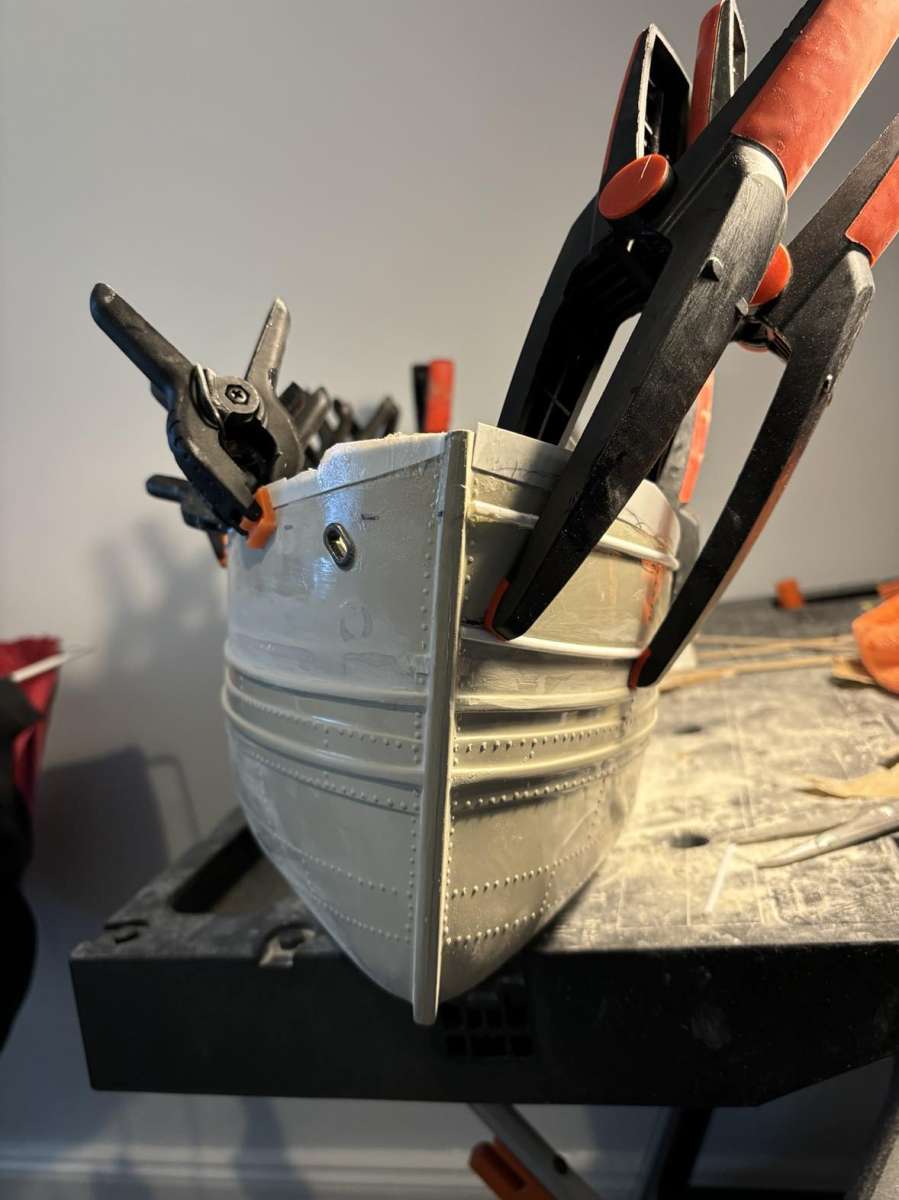

                                          The Caldercraft Northlight has good detail on the hull, but not quite accurate around bow and stern, for the puffer I am modeling this on. Have reached a compromise. The port bow is now the look I am after for rubbing strakes!

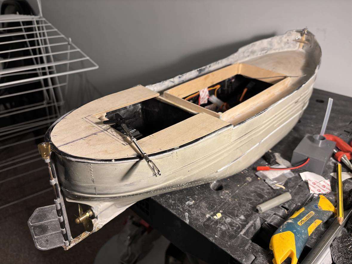

                                              After a bit of lapse, my puffer now has main deck and coamings fitted, a working rudder and quarter deck ready to go on. Now to give some thought to the bulwarks!

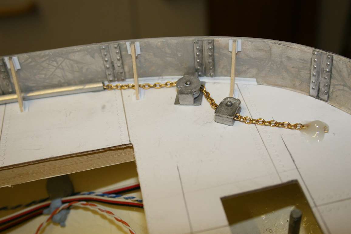

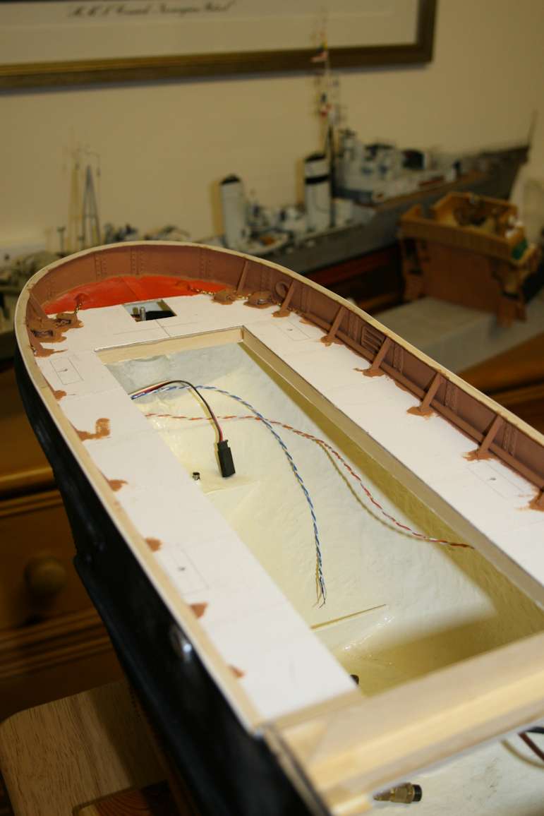

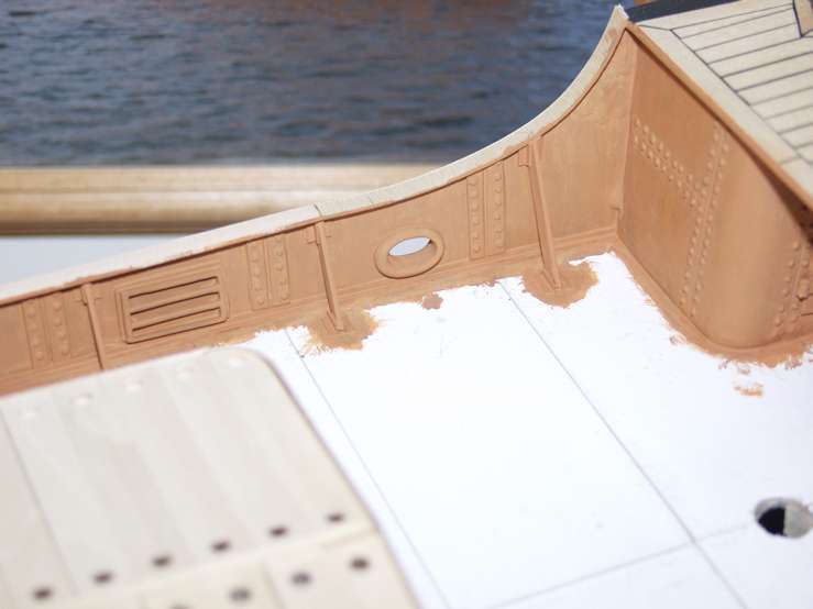

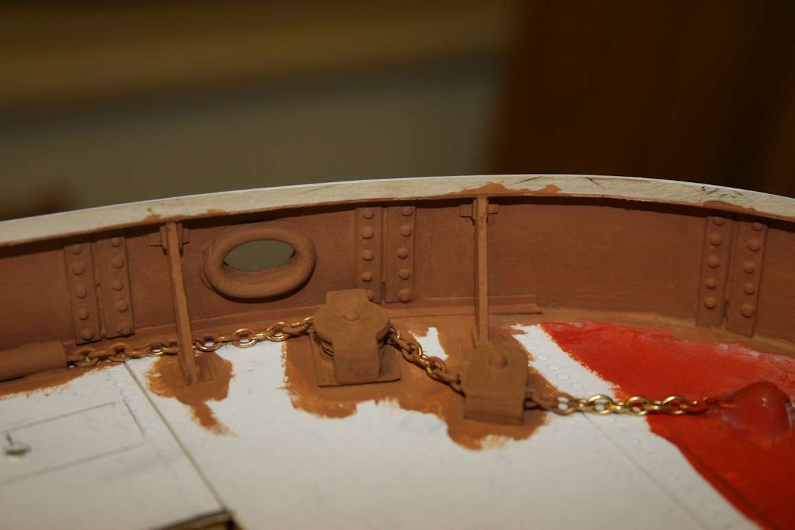

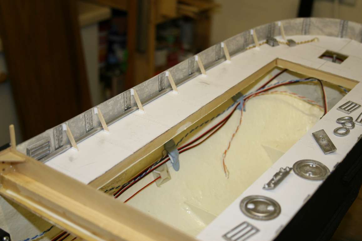

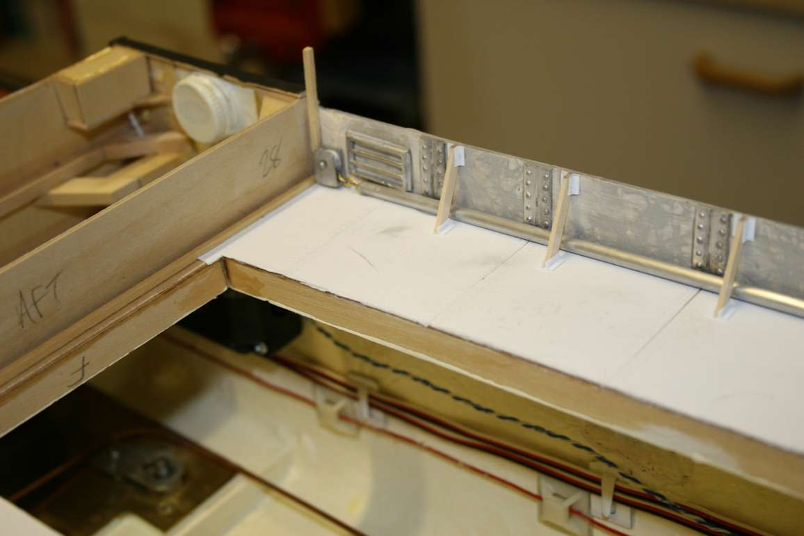

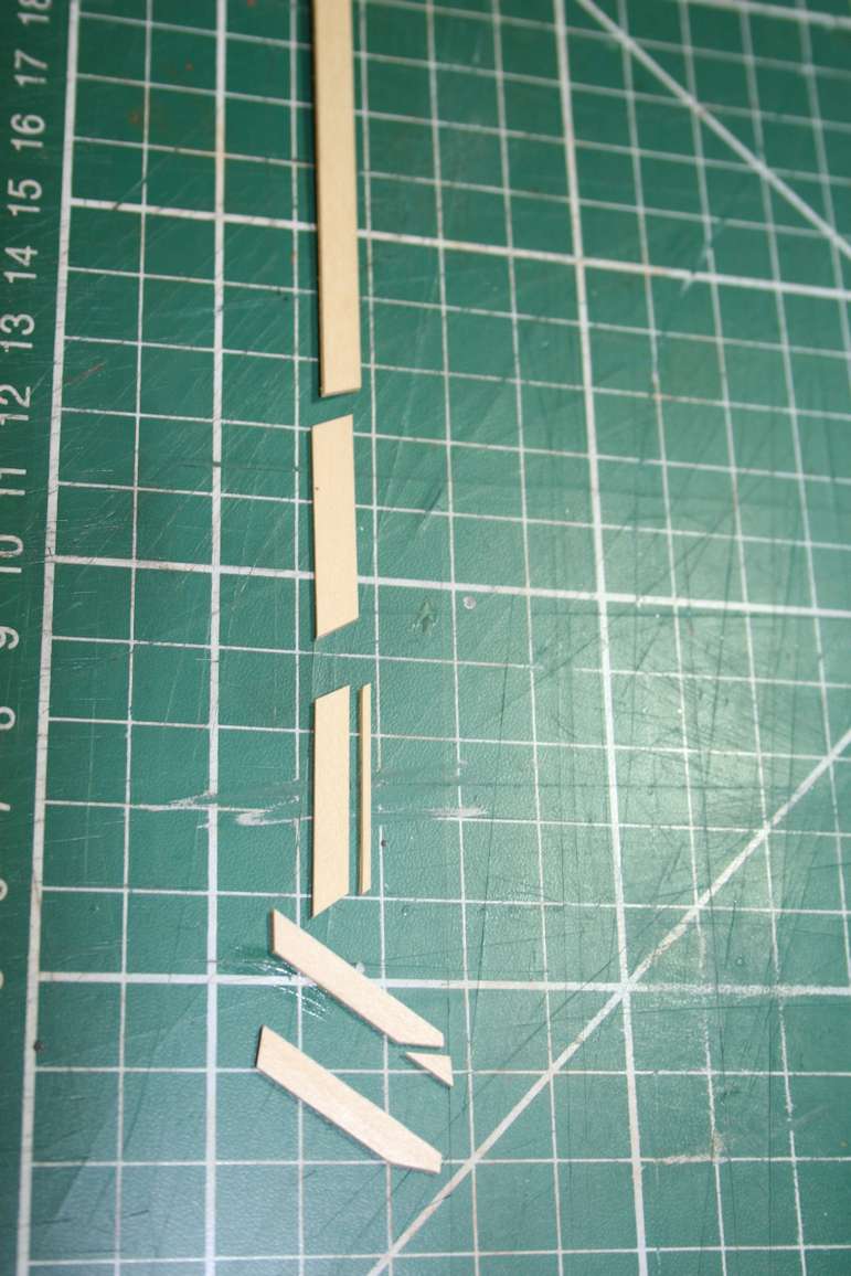

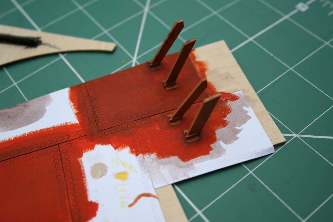

                                                The way I did mine was to cut up stripwood, first to width, then to the appropriate angle either end and finally a flat across the top.  These were glued in place with metal blocks to hold them perpendicular to the deck.  Then I added small pieces of Evergreen angle to the top and bottom as a supporting bracket.  I found a diagram in one of the CV Waine books and basically followed that.  I should have put a dot of glue on each of the Evergreen brackets as a rivet but didn’t think of it at the time.

                                                I did a test shot first.

                                                  Thanks for the photos of bulwarks, Richard – I will definitely use these as my prototype. I am just getting set about the task now, and may see if decal rivets work for this. If not, I will just use drops of glue.

                                                      Hi Richard – after some experimenting, I got some success out of the “zinge” lines of flexible rubber riveting (designed for warhammer games, I believe). They are reasonably convincing. The other lines of rivets that come as water-float decals are – to use a good Scots word- just too footery. They just come to bits when applied, as far as i can see.  The Zinge ones are not cheap and I will reserve them for use on superstructure. I will in the main be happy enough with drops of cyano gel to represent rivets on the side of hull. Hope that is of help!
