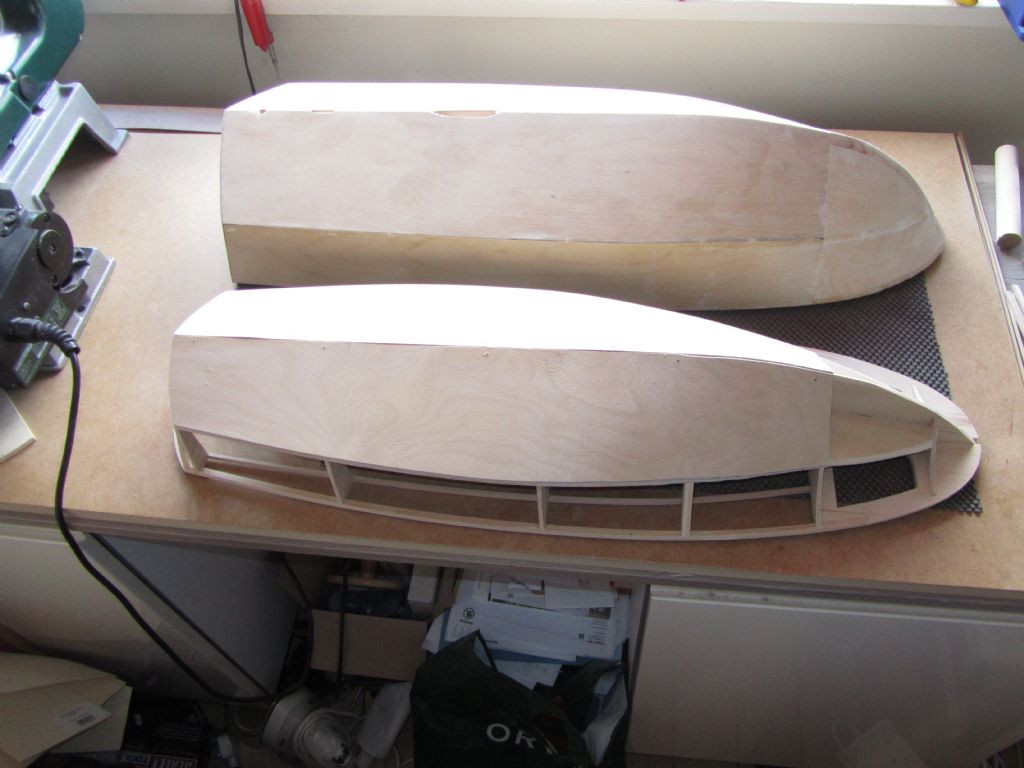

      Talking of the attractiveness of the hull here is a comparison of it alongside the Swordsman at the same scale. The Swordsman is only 2" longer but much beamier and dwarfs the svelte Huntsman.
      As Dave once related, the Swordsman is like a floating cottage!

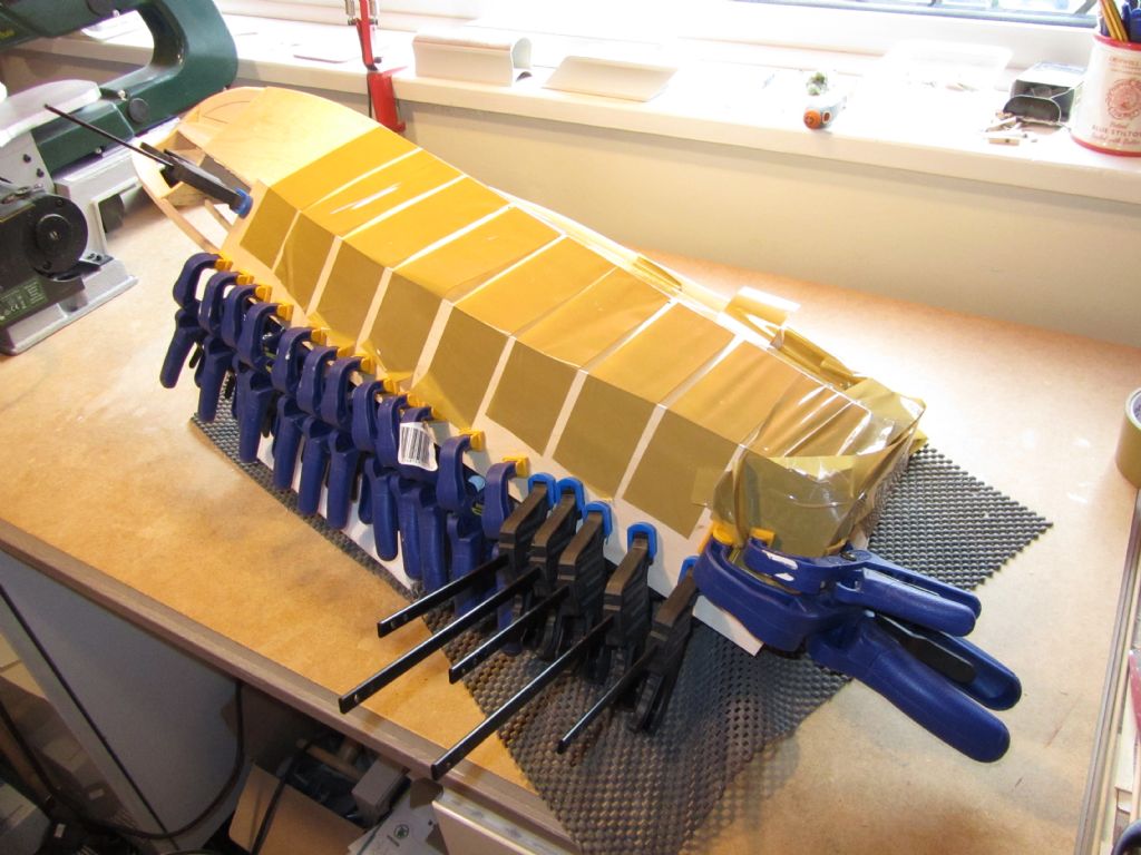

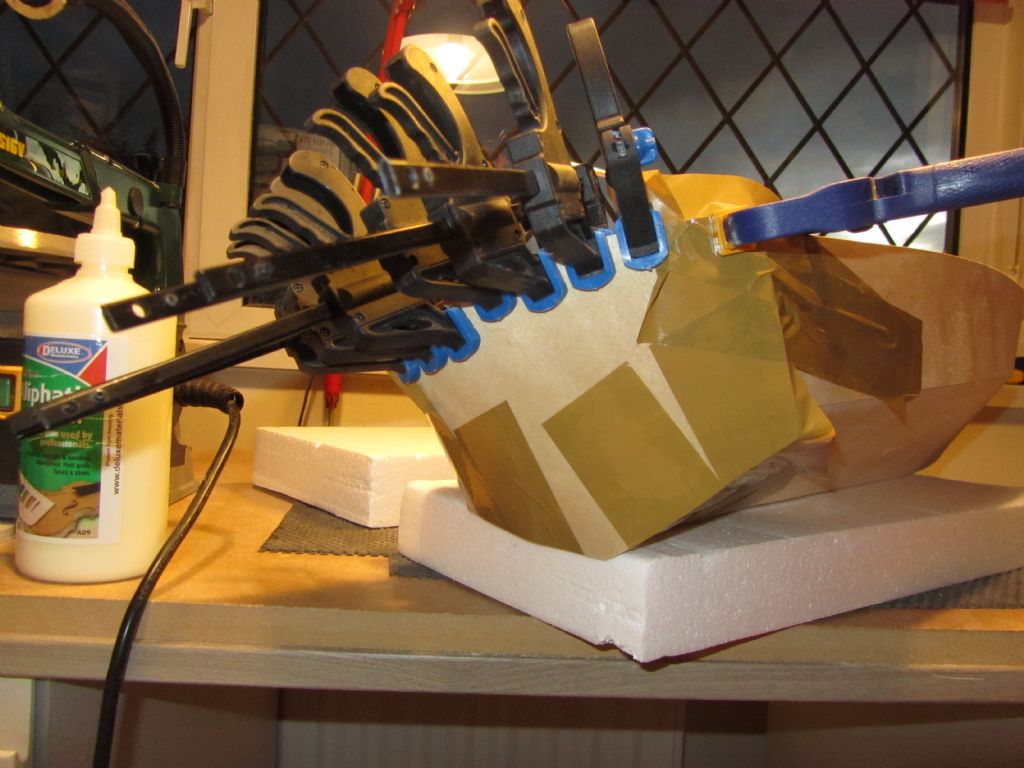

            Both side skins now fitted and held in place with copious clamps and parcel tape. It's a good job I do resin and cloth the hull as the tape does tend to pull the surface of the ply off slightly.
            2nd side fitted
            Four skins in place now. smiley And sanded at deck, transom and abutment of side and bottom skins.

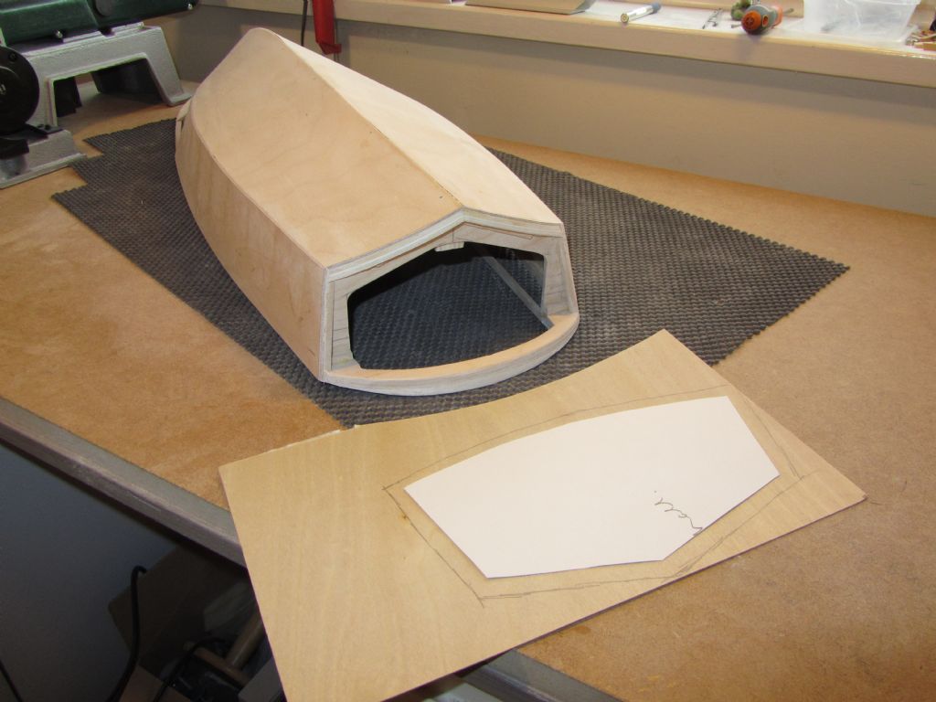

            Cardboard template drawn out and ply cut to size a little larger all round. Due to the quite tight curvature of the transom I've used thinner 1mm ply. The curve will give it strength anyway, added to by the cloth and resin.
            And glued into place.

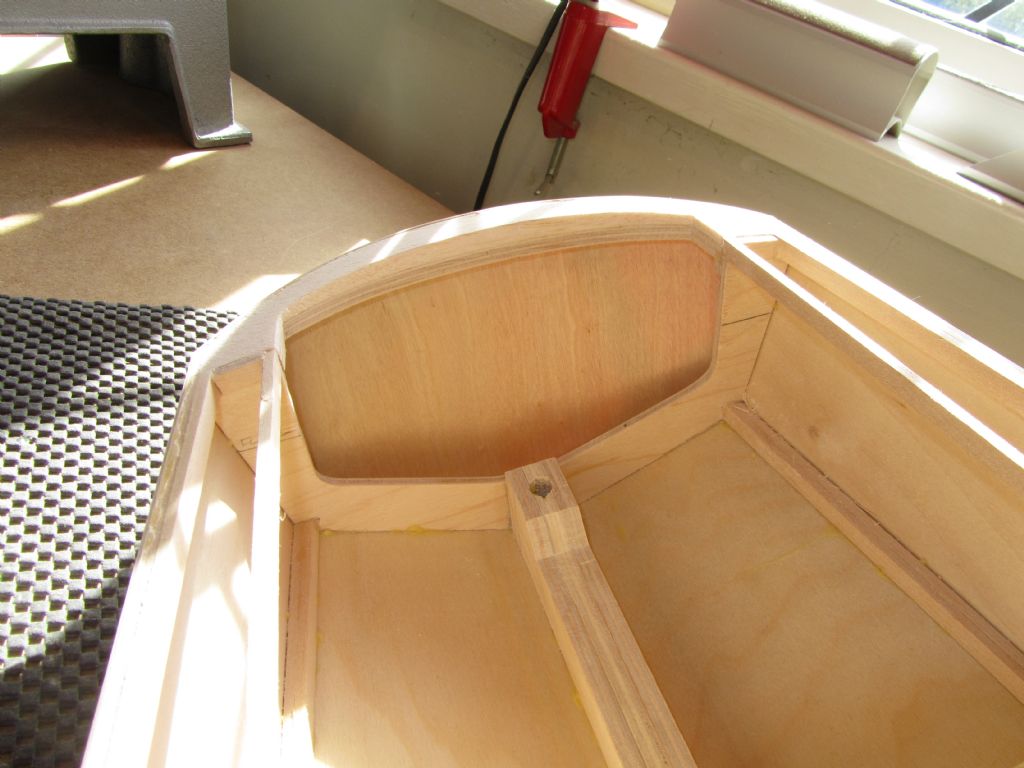

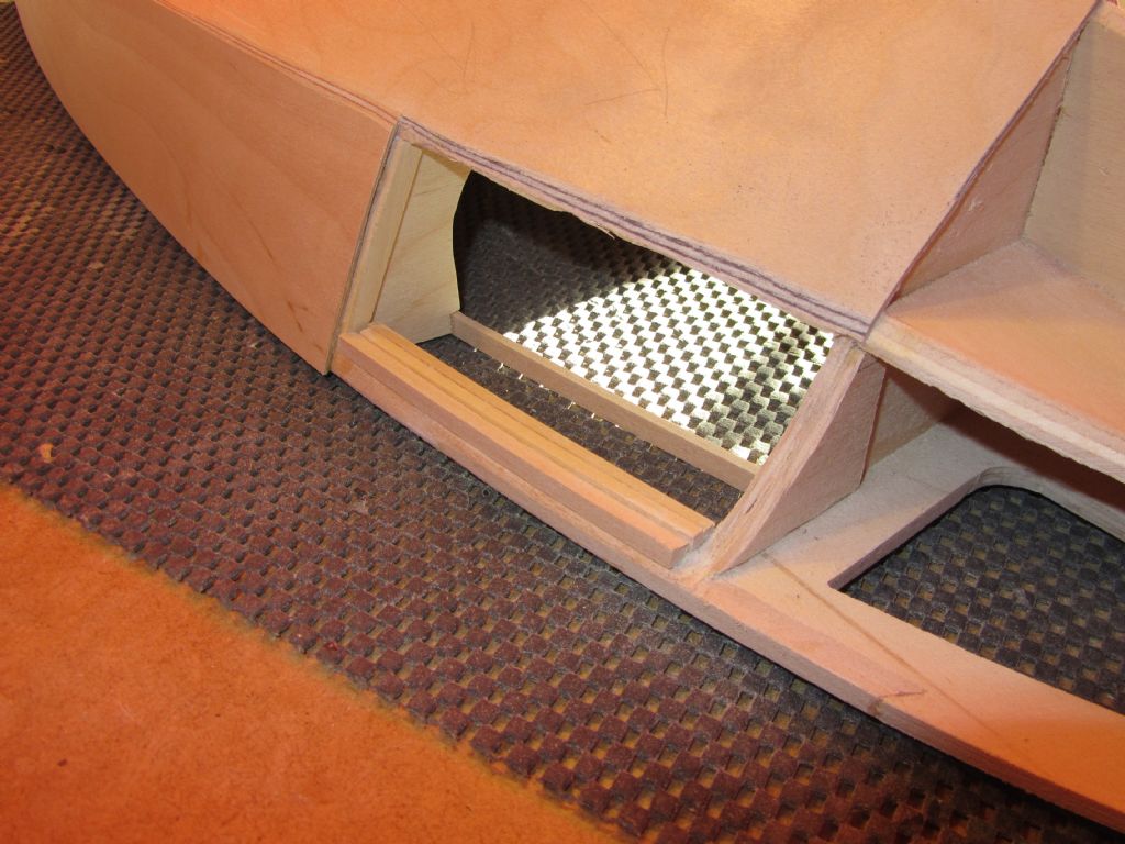

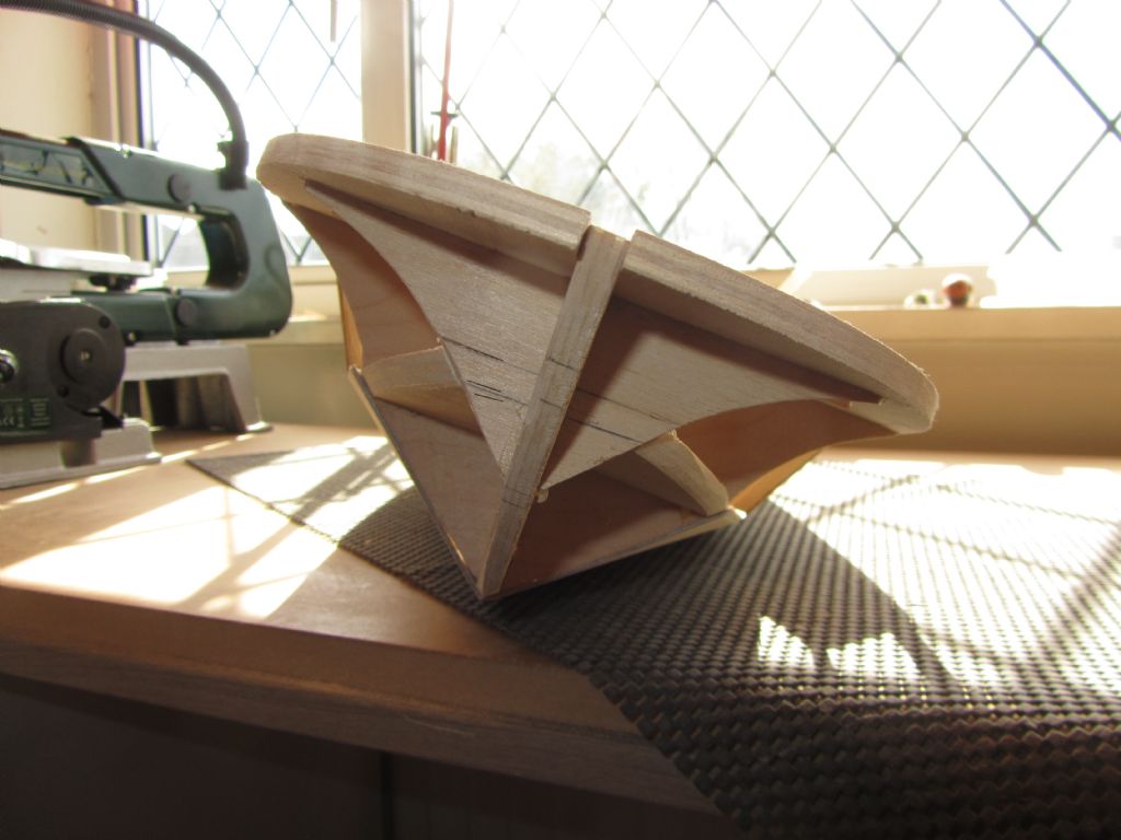

                    Clamps and tape have produced nice tight joints and once removed the edges of the transom have been sanded to shape. I didn't include any central supports due to the pretty tight curve which results in a nice clear transom inside. Before starting the skins I did manage to knock the top of the transom off due to clumsiness! Soon glued back on though.
                    Next job the bow area. I usually do the hull skins as far forward as I can in one piece but with the Huntsman 31 having such a pronounced flare I've decided to do the side skins in two pieces. As well as bending the ply to the required shape the angle it makes with the deck is pretty sharp and so I think dealing with that and gluing the rest of the skin in place successfully will be pretty nigh impossible. Doing it in two pieces, if I cock it up, I will be able to remedy it more easily.
                    On smaller models the flare is sanded out of the balsa blocks but with larger models i.e. the Precedent kits at 1:11 and 1:8 some of the flare is taken care of by the ply skins with balsa blocks at the bow and it's that route I'm going to follow. Looking at the curve for the flare in Frame 2 I think I've overdone it, the radius is too small, and so I need to glue in some timber and reprofile them. The joy of scratch building!
                    Whilst the deck is cambered I've made the sheer straight. Reason being is that I'm going to get the deck planking laser etched on one sheet of ply and if there is a compound curve the ply won't sit down properly. Today I bought and downloaded TurboCAD Deluxe so that I can produce the file for etching and in the future get some 3D printing done. Just got to learn how to use it now!

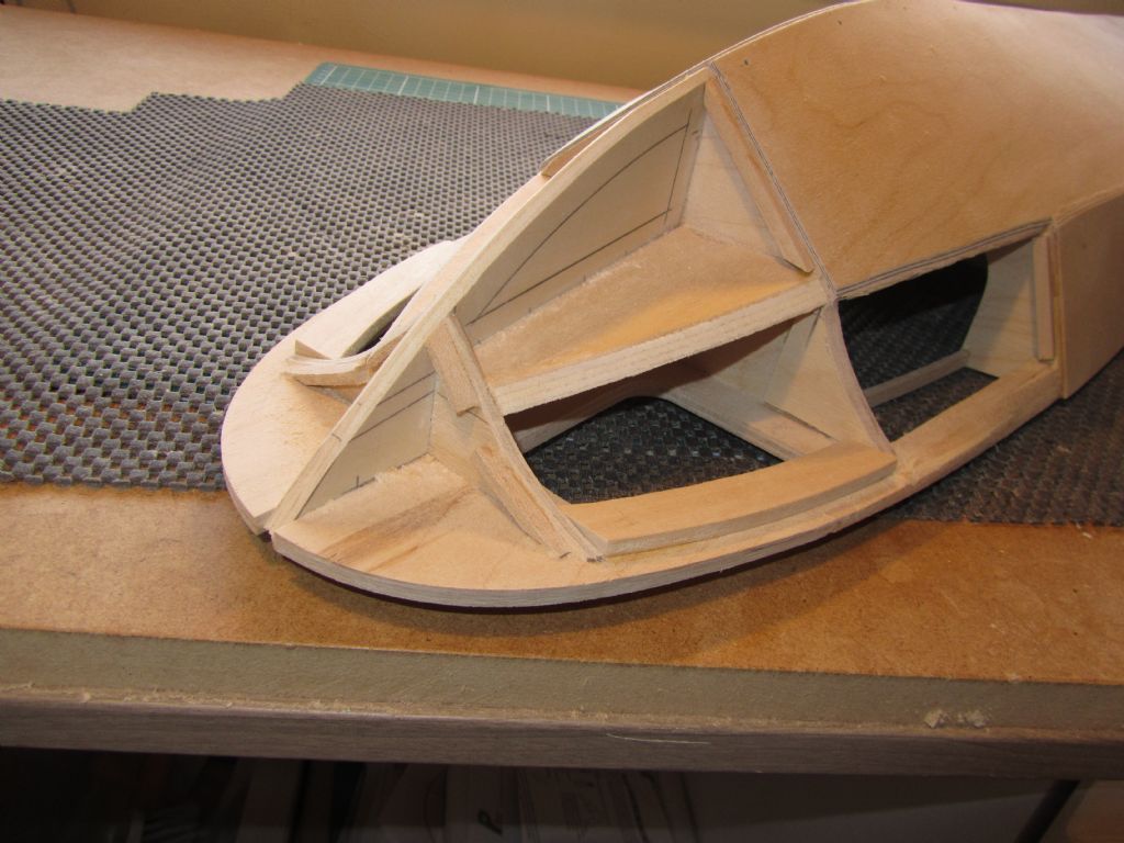

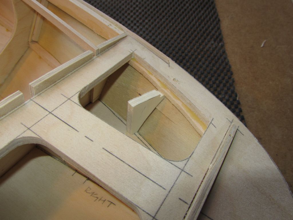

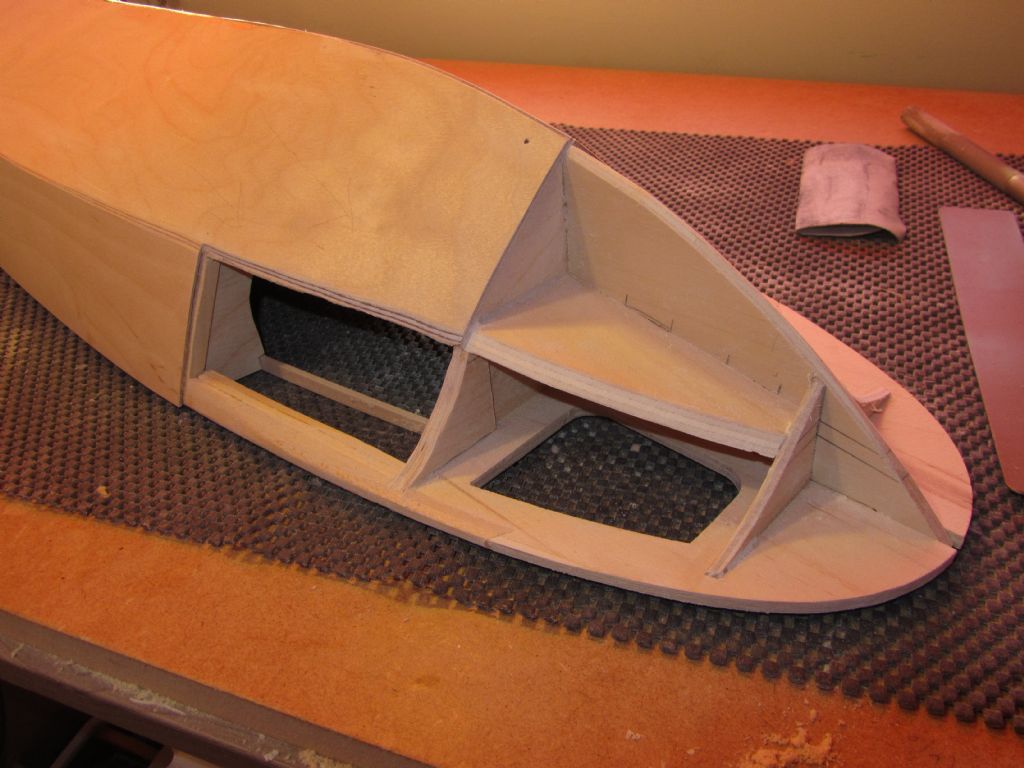

                      At Frame 2 the ply skin will meet the deck almost horizontally (I've filed the frame some more since the last photo) and given that the skin has to go from a flat plane at Frame 3 to concave at frame 2 and from the rubbing strip area to the underside of the deck in the process I've introduced some additional timbers glued to the deck stringer so that I can sand them away to the shape required and provide support for the ply skin.
                      I've also added a ply doubler at Frame 2 so that I can temporarily screw into it whilst gluing the skin in place. The following photo shows the additional timbers shaped with my Dremel and Perma-Grit file. After tea I shall see if this is going to work, fingers crossed!

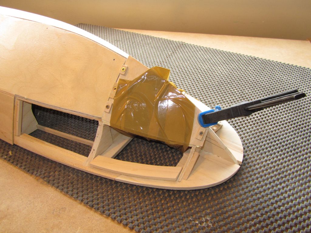

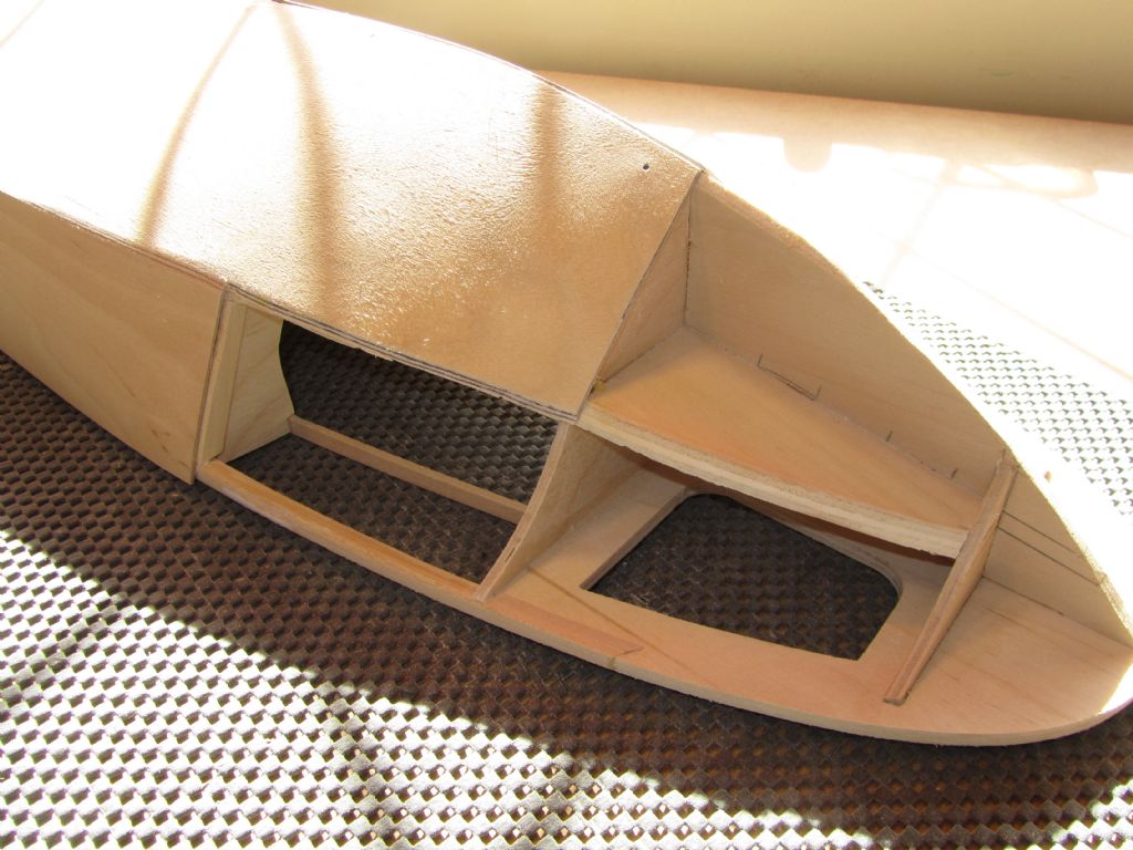

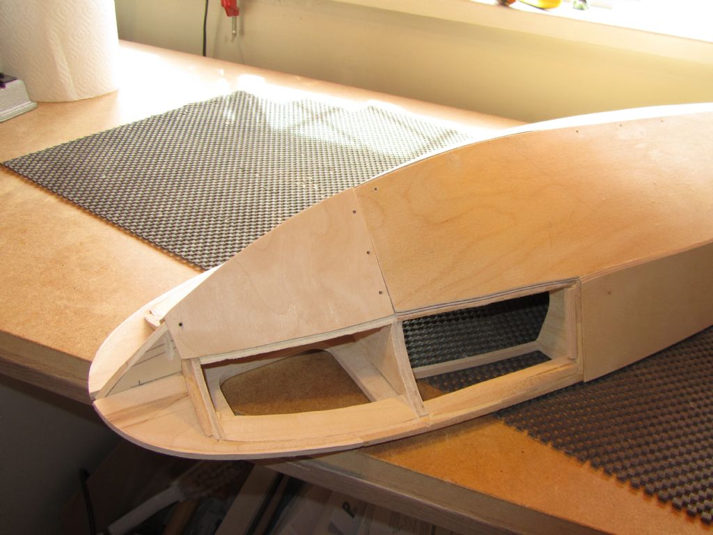

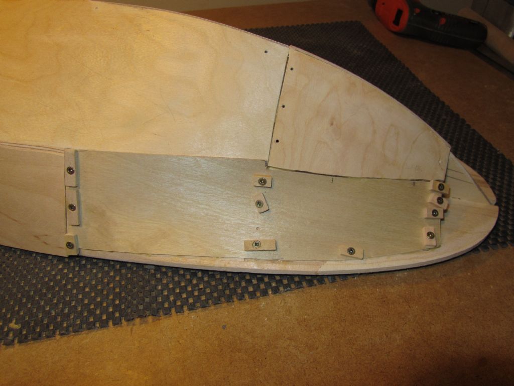

                        For the side skins trial fits between frames 2 and 3 have been successful and I think I might be able to do between 1 and 2 as well as that will mean just a small piece of balsa at the bow which will be good.
                        However I've switched attention to finishing off the bottom skins first and have added some additional pieces of timber for that and for the side skins to provide bigger gluing areas and for temporarily screwing into. The timbers to the underside of the breast hook are yet to be shaped and are to facilitate the change of angle between the flare and where the rubbing strip will sit.
                        This hull build has been a good learning project, especially as regards the bow area. I shall be building this hull again for the aft cabin version and the additional timbers etc. will be incorporated more neatly into the design drawings rather than just introduced on the fly.

                          Hi Chris,
                          It maybe less of a struggle if you used 2 lamination of 1/32" ply for the concave sections ? Bending 1 /16" ply on that radius won't be easy 😀
                          or balsa planking ? As your going glass cloth & resin anyway, just a thought, as I have the T shirt.
                          #86730
                            Hi Ray
                            Yes, I had a couple of attempts with 2mm ply which I scored on the back but couldn't get a nice smooth curve, ended up with a polygon!
                            Tried it with 1mm and no problem. I might just use that as the curve gives it strength and as you say I'm going to cloth and resin it anyway. Will either fill the difference in thickness at the joint or shim it out level or as you say use 2 laminations.
                            I did find some 2mm birch ply which is more flexible so I'll give that a go but as well as the difficulty with the curve it's more of a handful so will probably go with the thinner stuff.
                            Despite me not building light the hull is surprisingly light. The 6mm with doublers I used for the keel felt light when I was working it and of course there's not much to the bulkheads being a full open cockpit. Should go well!

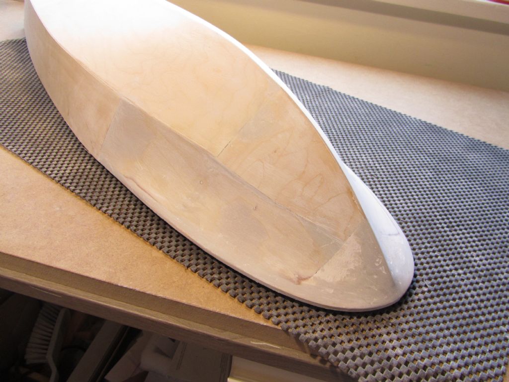

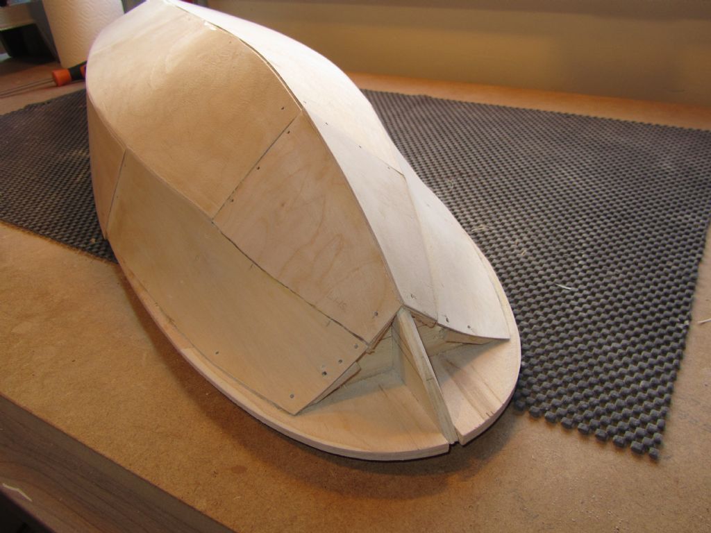

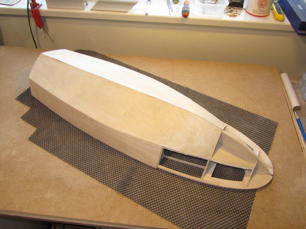

                              Fitted the other panel to finish off the bottom skin. Doing these panels I realised I could have done each bottom skin in one piece. Hey, ho. Also sanded the additional timbers fitted between Frames 1 and 2 to take the ply edges.
                              I decided to stick with the 1mm ply for finishing off the side skins. Have managed to do both sections in one piece which is great. Couldn't have done it with anything thicker as it's a compound curve and was tricky enough as it was making the template and getting it to fit.
                              It's not perfect but with some filler to fair in where the ply meets the breast hook and at the joints it shouldn't look too bad. Got a decent amount of flare anyway. That just leaves a small amount of balsa to fit at the bow.
                              I nearly chickened out and went for balsa blocks between Frames 1 and 2. I might do that next time and see how it comes out.

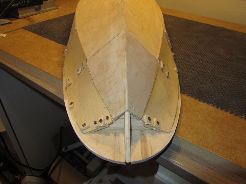

                                Took the screws out this morning and sanded off the ply overlap. There's a slight bulge each side due to the compound curvature but not too bad. I could fix some balsa on the back and sand it out, we'll see.
                                Unfortunately back to decorating today so the filling will have to wait.
                                Edited By Chris Fellows on 13/04/2020 10:30:53

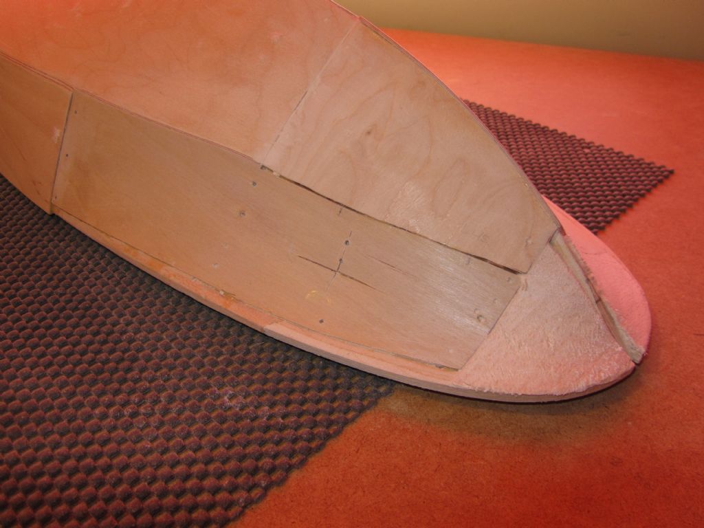

                                    #87026

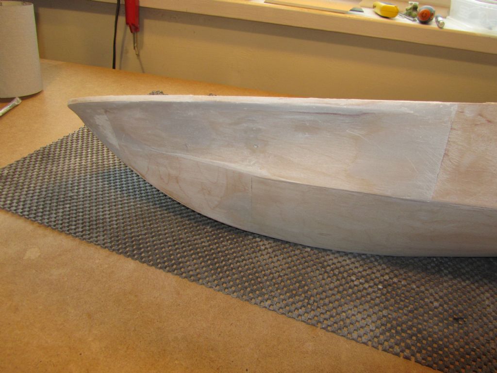

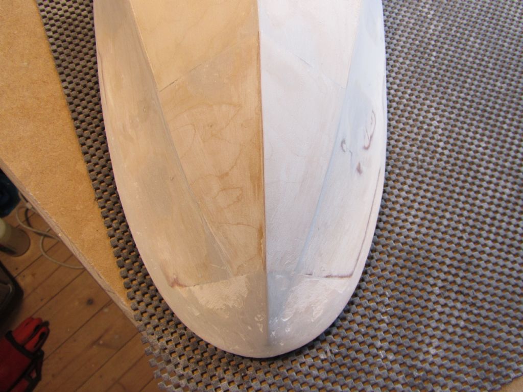

                                      As mentioned earlier there is a slight bulge in the concave curve/flare due to the compound curve and whilst it's not too bad I couldn't be having that! So out came the Stanley knife to see if a couple of slits would remedy the situation, which it did.
                                      I then made and glued in a small ply former to each side to which I could glue and pull in with screws – photo is before gluing. This worked pretty well and additional formers will be part of the design for the next build.
                                      Then fitted the balsa blocks to the bow and once the glue had set cut and sanded them to shape. Now ready for some P38.
                                      Edited By Chris Fellows on 20/04/2020 19:01:26

                                        Hi Chris,
                                        I think solving the awkward shapes are all part of the fun of model building, so boring if it all goes well 😃
                                        But P38 will solve all your bow issues !!

                                          Hi Ray
                                          Yes, part of the fun even if it doesn't feel like it sometimes! I've learnt not to tackle things like this in the evening when you're starting to feel tired and want a quick fix – not that kind of fix! Best to leave it to the morning and have all day to think about it and have the time to make the necessary parts and remake if required.
                                          At last I've finished the flippin' bedroom! Not going to do the landing for a couple of weeks so that I can do other things with No. 1 being model boat building!
                                          So yesterday it was out with the P38, which I didn't need too much of, and with the weather still being nice did the preliminary sanding outside. Today I finished off that sanding and applied a bit more P38 where required and after leaving for the requisite time sanded it again and it's pretty much there now. Just needs some minor surface filling where the balsa is showing and looks like it's got chicken pox and after a final fine sanding all over the hull it will be ready for cloth and Eze-Kote. It looks better in the "flesh"!
