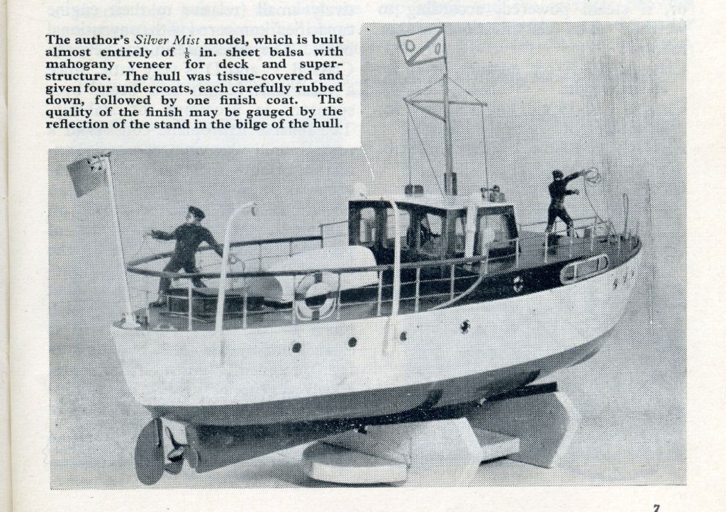

          A photograph of Vic's original from the 1966 edition of Vic's book, Power Model Boats.

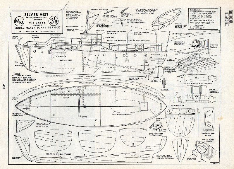

              Quickly moving on, we have a nice view of the actual plan, showing the original model of 21 inches in length
              Note the original price!………..3/6d…………That's 17 and a half new pence to the young readers……..Today, it's about £12,50
              Such is life, eh?
              I intend to enlarge the plan for a model about 42" in length and powered by a complex belt driven motor drive, which should be interesting
              The model looks a very nice bulbous shape, which gives it, it's old world charm?
              A very nice plan indeed………Vic Smeed certainly put his heart and soul into his designs

                  The Silver Mist plan is quite small……..
                  How about My Hobby Store offering an enlargement service?
                  Any chance?
                  Bob wth fingers crossed
