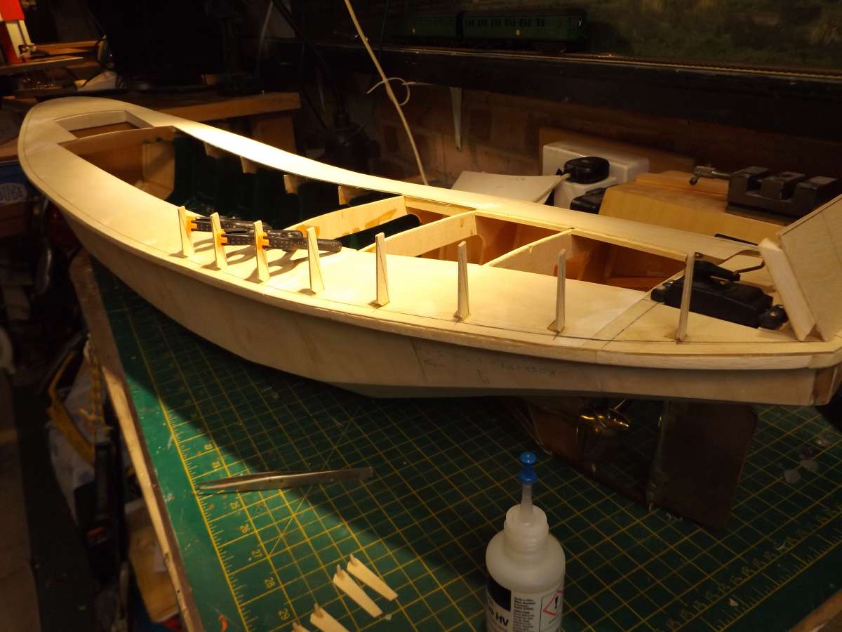

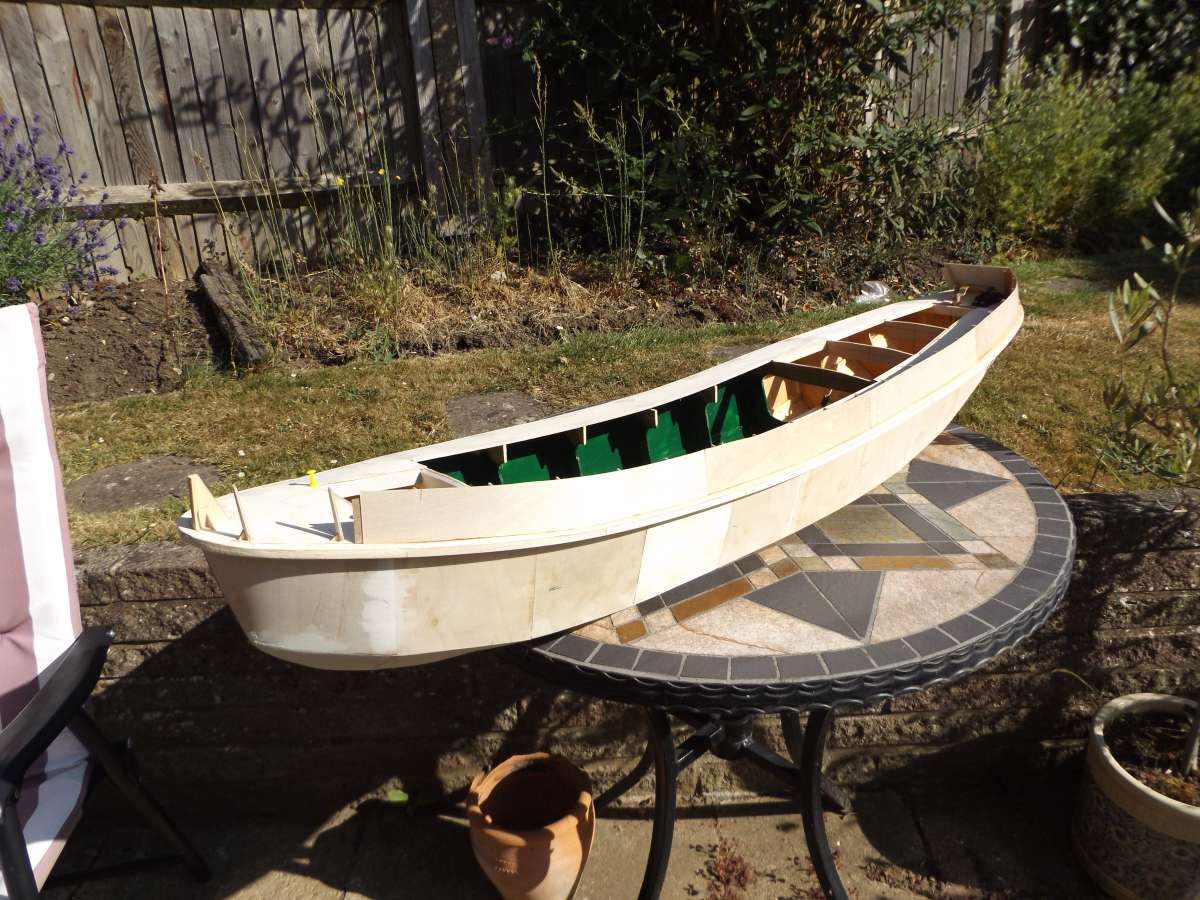

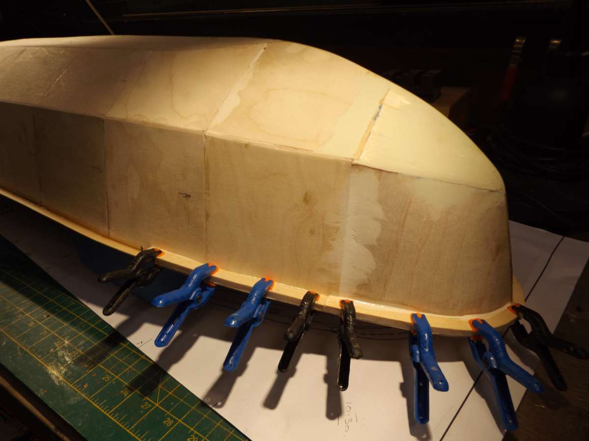

          Progress before my week away brought the TID to the side decks and knuckle complete stage which is quite a feature of the design, the deck projects past the sides by 5/16″ and the knuckle/rubbing strip is fitted under is with 1/4″ balsa scribed to the hull shape, next part is the daunting part the bulwarks and capping on top !!

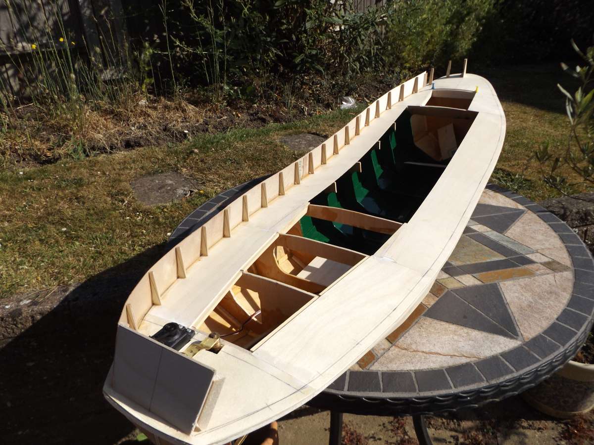

                  The worst part of the build are the bulwarks and capping rail as that’s the part everyone will see quite a laborious process supergluing the uprights to the deck and templating the 1/64″ ply before cutting seems to be going ok so far but a slow process !! racing DF65 yesterday, at my daughters for a BBQ today , It’s all go 🙂
                  Regards RayDSCF2906DSCF2910DSCF2909
                  #125978
                    You nailed that Ray, not a gap in sight!
