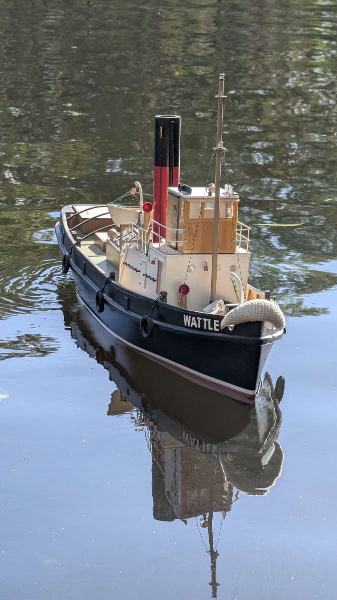

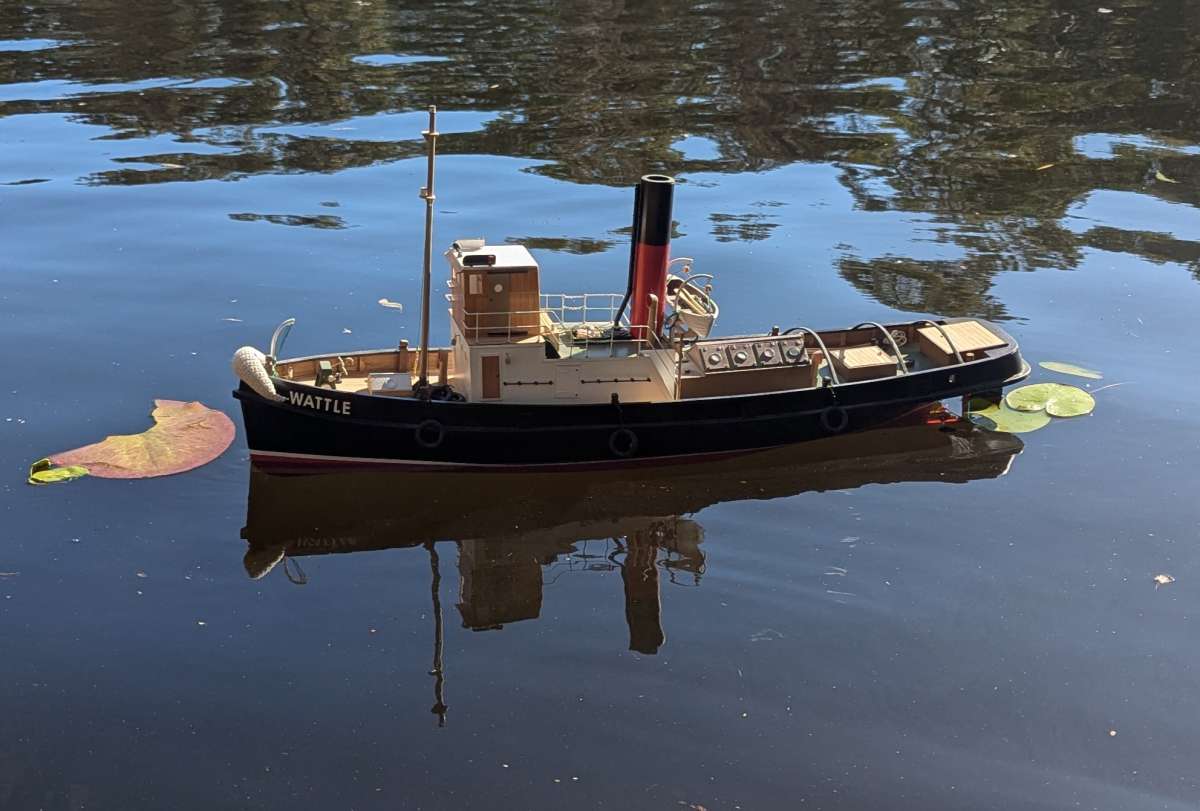

                Couple of pictures of the wattle on the club lake
                PXL_20250606_233859437PXL_20250606_233931738
                #125881
                  Lovely looking job, beautiful on the water.  Sits just right and has just the right presence.
                  #125882
                  mick east
                    @mickeast46851
                    Thanks Richard . I was amazed at the amount of ballast it took to get her down to the right water level.  There is 5 kg of lead in the hull plus a 6500 sized nic cad battery  it test this old fellows back out getting her down into the water
                    #125883
                      She should handle nicely as well then and look more realistic than ‘bobbing’ about on the slightest ripple.
                      #125884
                      mick east
                        @mickeast46851
                        That she doesn’t do , she seems to plow through the wakes of the faster boats on the lake . I must admit I looked at her with some pride when a fellow club member remarked ” she behaves just like the real thing on the water “, More by fortuitous accident than design i think, but I will take a win which ever way it comes.
