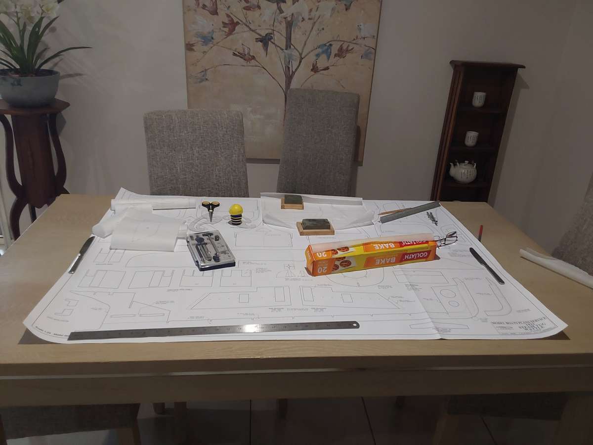

      The start of a new build blog of the mighty tug Wattle (maybe not in size but in significance to history of the Royal Australian Navy and Garden Island dock yard in general.) As always you start with a flat sheet of paper and over the months you turn it into a living 3D model (that’s the plan anyway)
      So let’s start at the beginning with photos of me concentrating on the plan and tracing out the keel and frames.20240910_08275620240910_08305720240910_082820

          Looking forward to it Mick.  Nice to see someone include a shot of themselves in the blog so we can see who we’re talking to!  Good to see the dining table being put to far better use than simply eating dinner off!

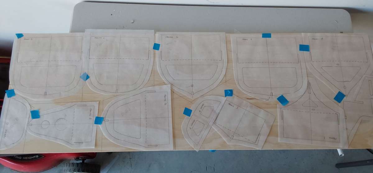

                  Frames traced out and positioned on ply sheet the most economical way ,as a young lad said to me at my local hardware supplier when questioned about the rapid rise of price of plywood (“it doesn’t  grow on trees you know”)I suppose he’s right technically  but still put a smile on my face
                  20240913_081418

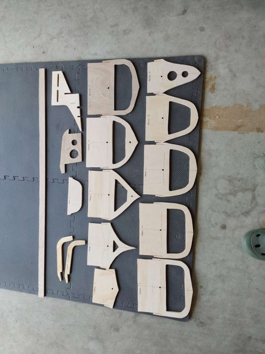

                    Like pieces of a jig saw puzzle.  All cut out ready to be fixed onto the jig 20240915_112153

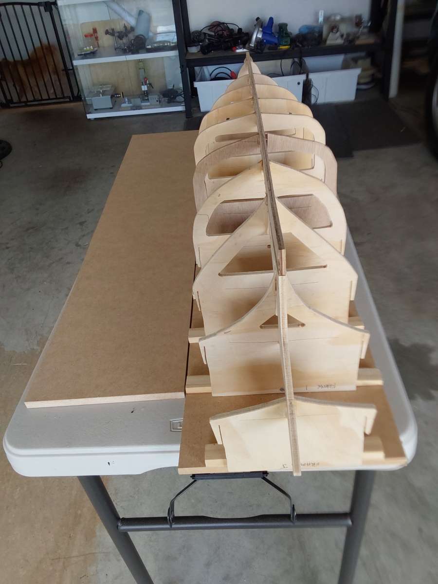

                    mick east
                      @mickeast46851

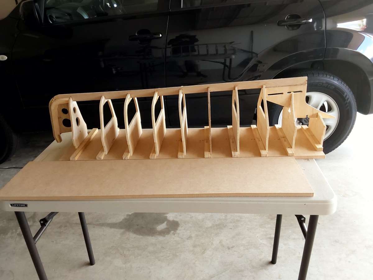

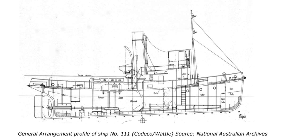

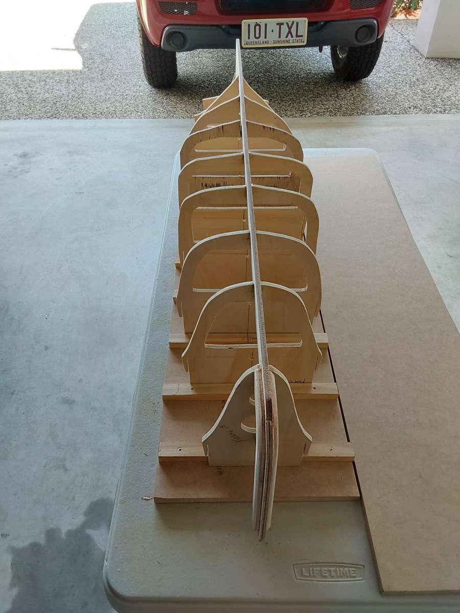

                      The building jig is made, the rib/frame spacing calculated and frames mounted . A good lesson was learnt from my previous build and instead of sticking the mounts to the building board I screwed them from underneath to make it easier to remove the hull after framing. The keel angle looks odd but looking at the builders blue print it’s exactly as it should be
                      Wattle-History-to-2010_240824_165639_2
                      20240917_110629_02
                      20240917_110517
                      20240917_110502

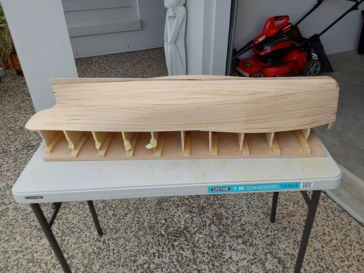

                      mick east
                        @mickeast46851

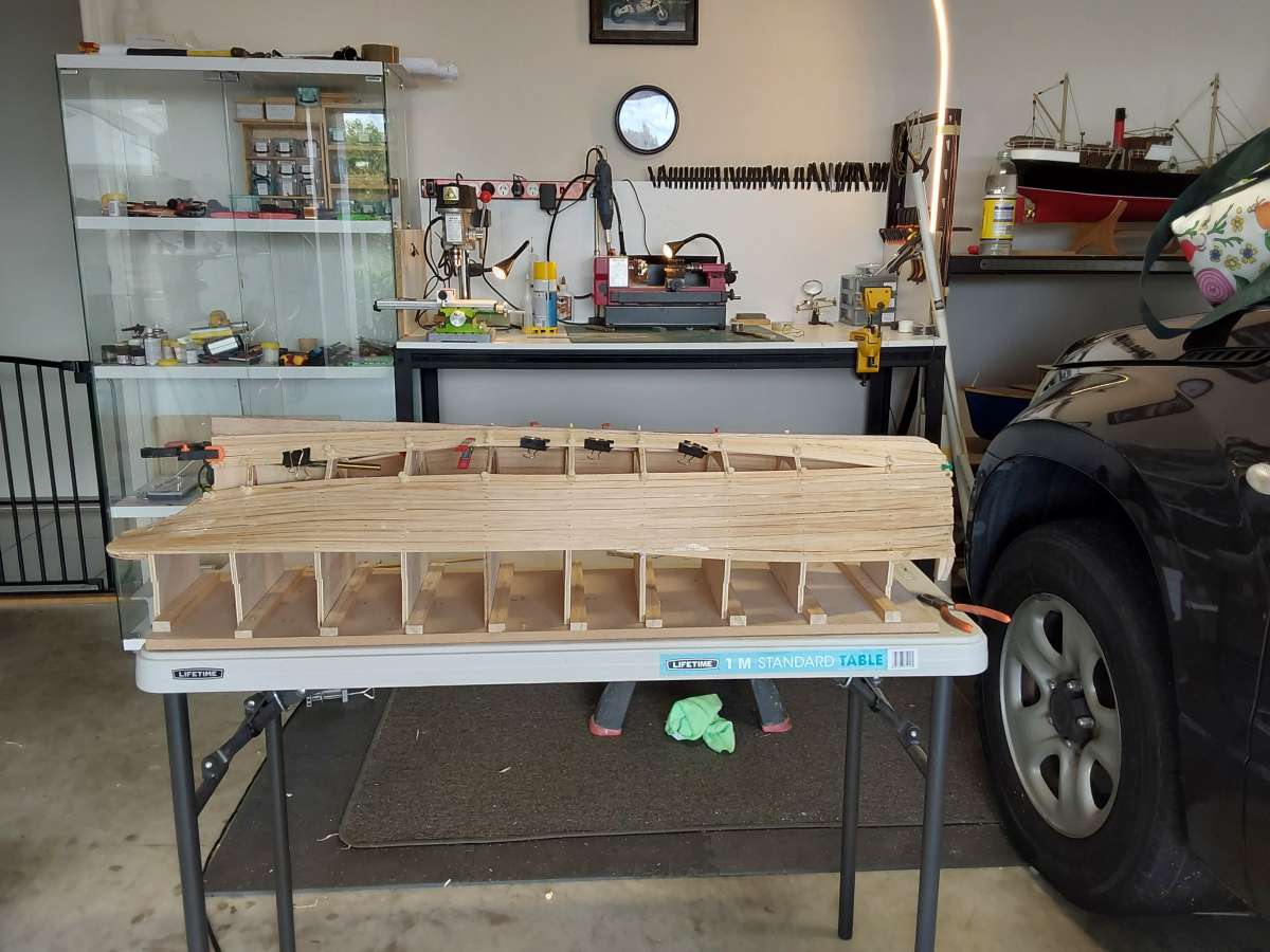

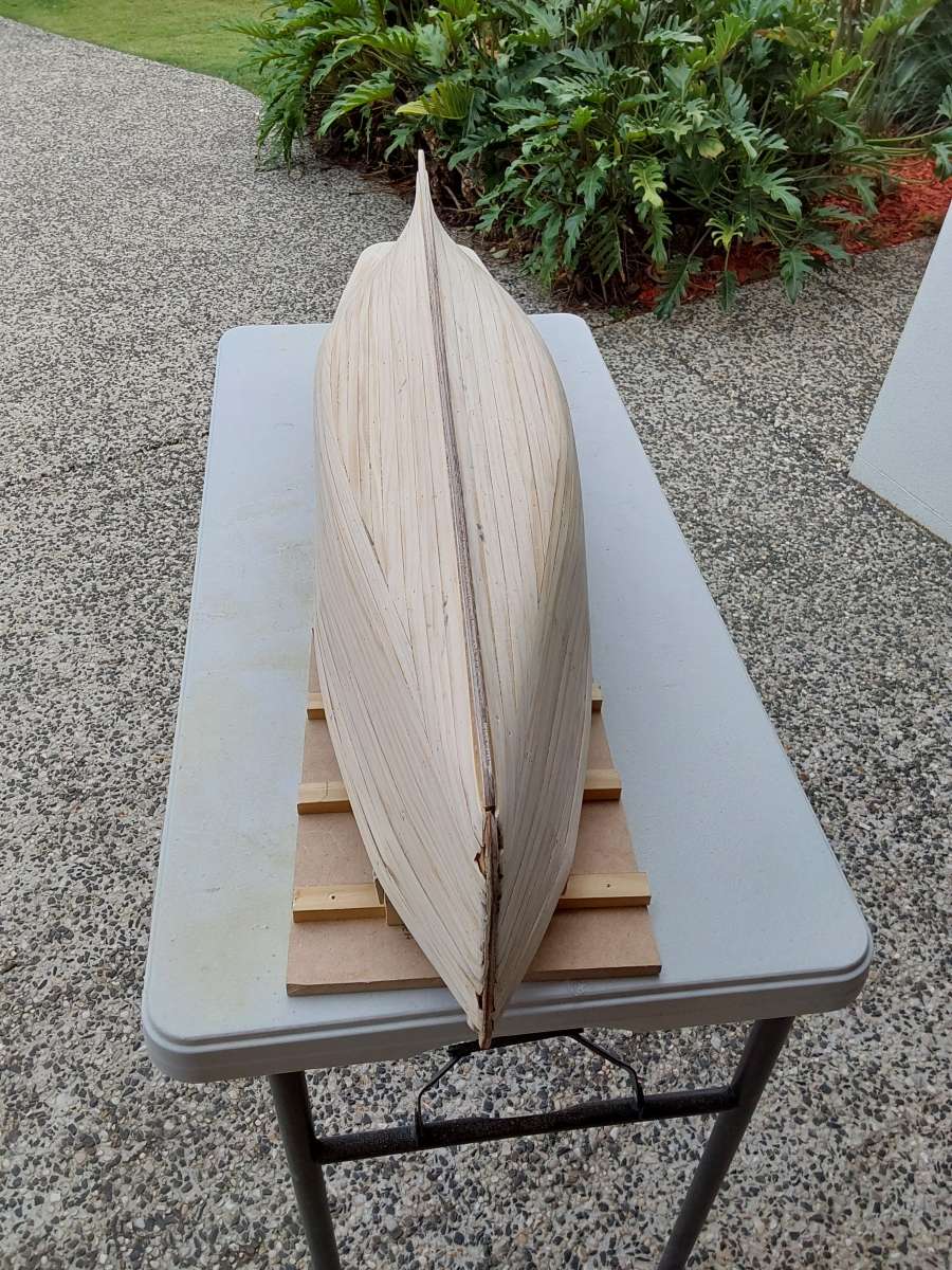

                        I think I’m one of the  odd modellers that like planking hulls, I find it exciting that each plank you put on reveals more of the hidden  beauty of the curves of a well designed boat  ,even in the beginning phase of the roughly planked hull before sanding you can get get the idea of the finished shape. 20240929_091745

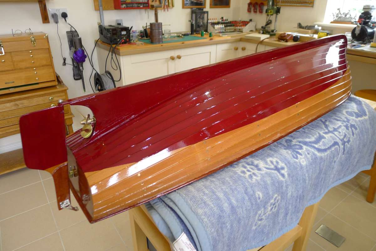

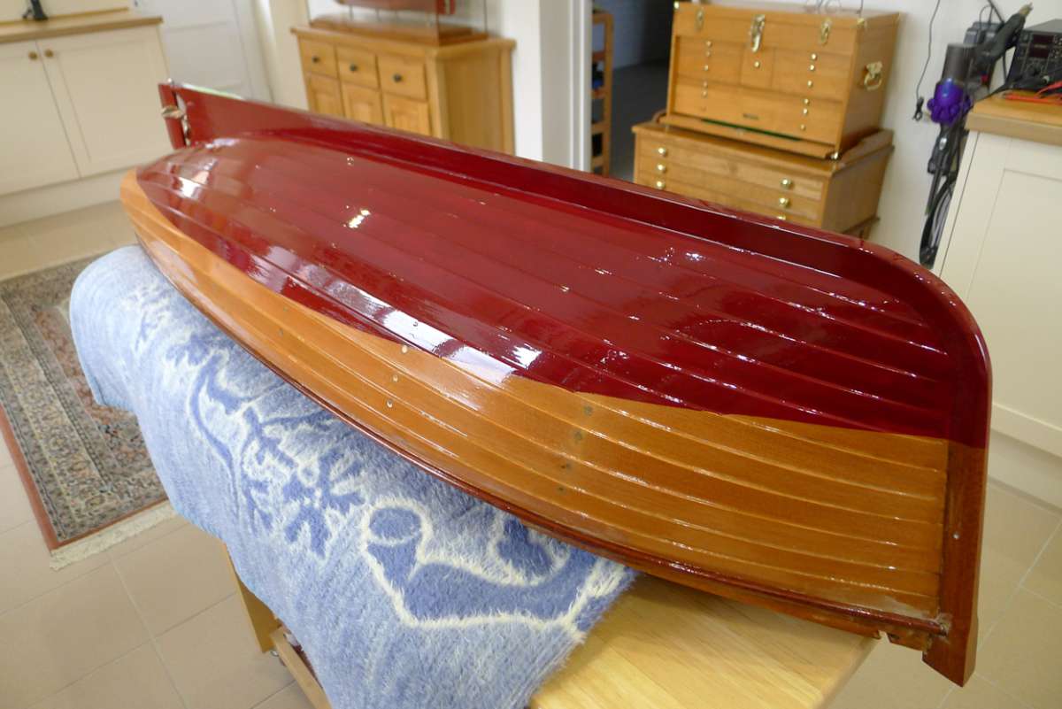

                          I know exactly what you mean Mick.  I once had a retired boat builder build me a hull from some plans I had and it still fascinates me to see the beautiful complex curves you can get by bending and shaping straight planks of wood.
                          01-08-21-01Wide-A-WakeBuild17
                          01-08-21-02Wide-A-WakeBuild18

                          mick east
                            @mickeast46851

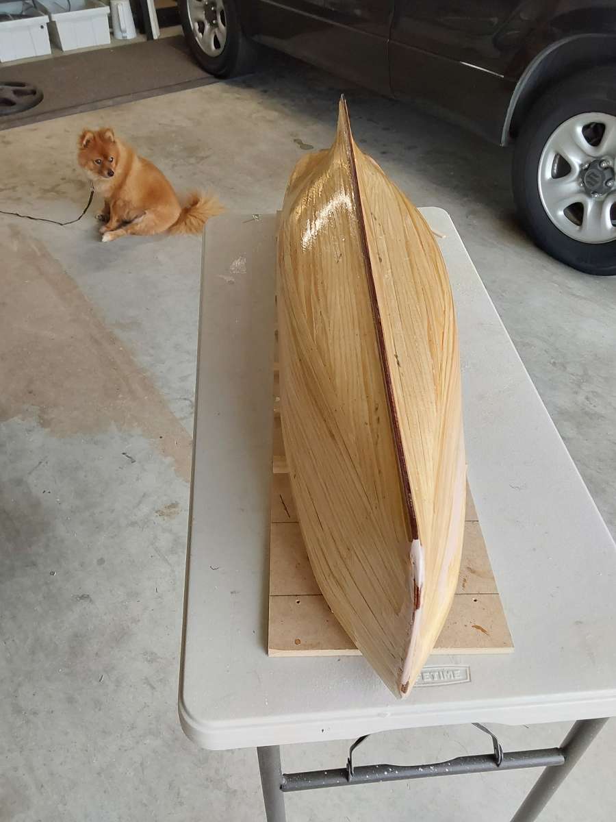

                            Bottom of hull planking completed and first sanding done next is FB resin inside and out ,more sanding, a covering of light weight FG cloth and and then some body filler to sort any minor imperfections that are left . Then fitting the bulwarks and sorting the deck out .
                            20241002_09175420241002_091718

                              Hi Mick,
                              Wattle is looking good.
                              Yes I agree about planking 🙂 watching the shape develop is one of the most satifiying parts of the build, I’m selling my big tug Cullamix 39″ 35lbs !!
                              So I have to build another one soon, but slightly smaller .

                              James Hill 5
                                @jameshill5
                                Hi Mick,
                                I have to agree with others regarding the satisfaction of planking the hull. I’ve covered three hulls now in sheet, diagonal and straight planking and I found the planking method more satisfying as you went along. you’ve certainly made a very nice job on yours and it should be an attractive model when complete.

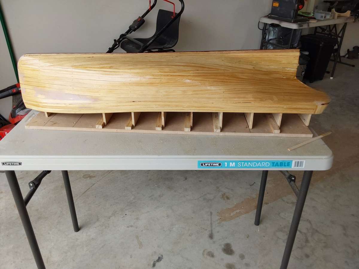

                                  20241009_09101320241009_091024The first coat of resin on after sanding , now more sanding and another coat of resin, and sand some more with layer of body filler sand again, repeat  until all the imperfections are gone . Tedious work but essential if your looking for a good finish to the hull I reckon. I don’t normally glass mat the out side of the hull instead I put a layer of very light layer of mat/tissue on the inside to seal everything. You will notice my constant companion Mr milo dog, he’s a dear little fellow who unfortunately is blind due to being diabetic (strict diet control and insulin injections morning and night ) . Amazingly he gets around with out bumping into things , vet says it’s inbuilt canine radar. We can all learn a lot from animals they adapt and just get on with life.

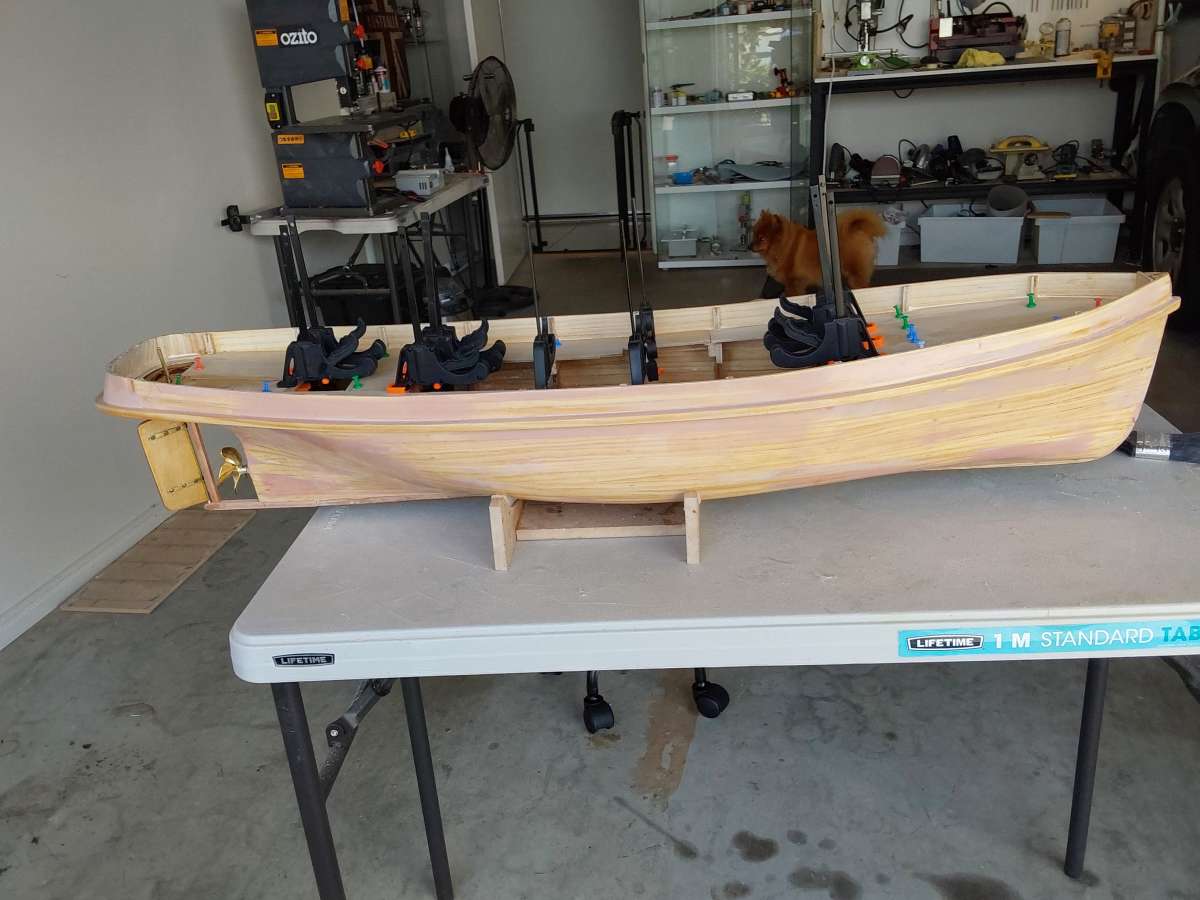

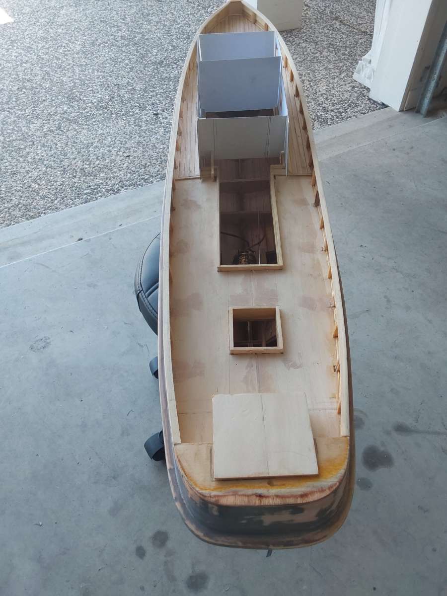

                                        A quick update on progress so far,  the inside of the hull has been fiber glassed., the deck has been cut out glued in the steering gear and rudder have been fitted. The next job is to wet and dry the outside of the hull and give it a coat of primer and lightly sand back to find the high and low points . Happy with the progress so far with not too many problems showing up .
                                        Mick East aka eastie
                                        20241023_110307

                                          That’s a very attractive looking hull which definitely lends itself to being planked, as you have done. Will be watching how the rest of the build comes together.

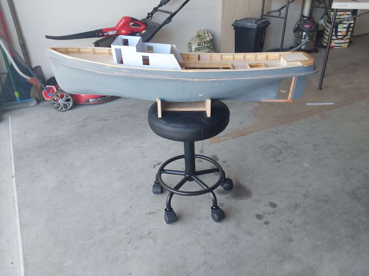

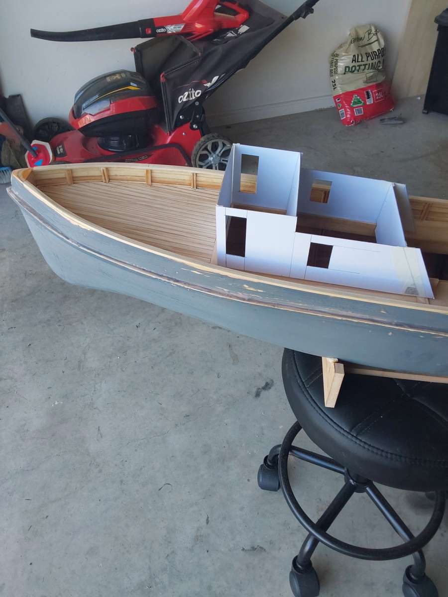

                                                  A update on progress so far . The hull has numerous coats of primer and sanding back after each one , I’m happy with the hull finish so it’s now ready for final coats of satin black and anti foul red. The fore deck has been planked and I’m now in the process of cutting out card templates of the superstructure . I habitual do that as it’s cheaper to see mistakes in card before committing to plywood ( it’s the limited income  pensioner coming out in me lol). I’m going to have a enforced break for a couple of weeks as we are flying to Canberra to attend my beautiful granddaughters wedding to Sam a really nice man ( they are both members of the Royal Australian navy. He’s a PI instructor and she’s in logistics .) So we’re pretty excited to be going there20241104_09151420241104_09143920241104_091457
                                                  #123166
                                                    Great work so far. Hull looks really good..pity you had to paint it!.
                                                    It’s a shame Mick that you have not considered this as article for the magazine
                                                    Lindsey always wants copy, and you are taking good pictures, all it needs is a bit of writing and you would end up with a subsidised build seen by thousands of people all over the world.
