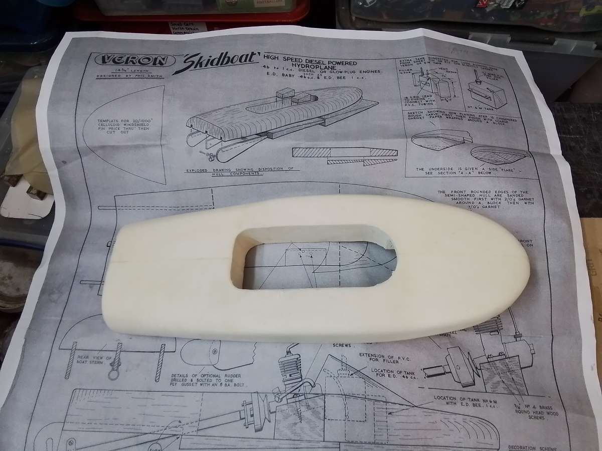

        Working on the skidboat. Making the hull has been very easy now I have the plans and don’t have to think about the shape.
        Builders insulation covered in epoxy/glass cloth. I now have to sort out what voids need to be carved out of the shell to accommodate battery, esc and Rx. Also, will the battery need to go fore, or aft for correct trim where running? Once the bottom is on, it will be difficult to carve out extra space at the stern. Perhaps I will hollow this out as an option, but not breach the well walls.
        Would be nice to have a vintage style brass ball/ socket coupling in 3.17mm by m4 but not found anything. Have ordered a plated steel one as more vintage than the plastic types. Waiting on this before ordering the propshaft.
        just ordered epoxy glue, in 250ml bottles (duribond) and disposable brushed AND hobby bandsaw blades from Tilear, a great supplier.

          Stuff has arrived. More fibreglassing this afternoon. Hull is ridiculously light.
          #122438
            …and even lighter now I have carved out spaces for batt esc and rx! Servo mount has been made and in a minute I will be trying the git of the rudder wire guide tubes, wire and servo to see if any adjustment is needed.

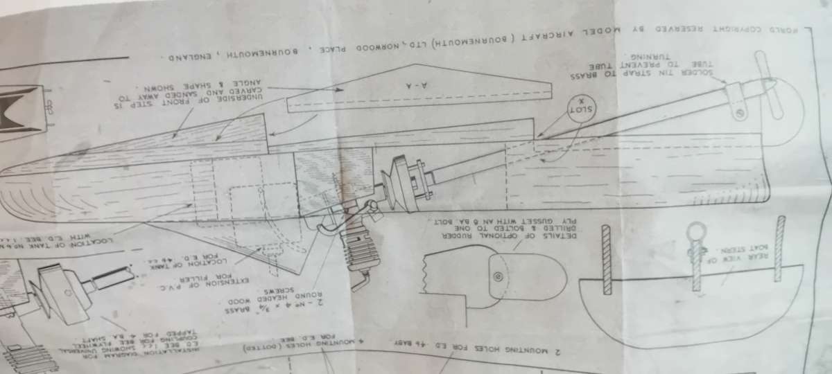

                                        Hi Richard. The design has the end of the propshaft flush with the transom. What we don’t like is the second step being 2/3 the way down the boat length…it seems a bit near to the back and what with the front step, May be allowing air in.
                                        Cavitation starts at very modest throttle openings. And is not over revving on a 1400Kv motor/ 8v lipo at these throttle openings.
                                        See snap. I am going to try a transom flap to cover the prop, an extension to the front step to move it back a bit (mostly to increase bouyancy), and simply moving the battery to the rear to sink the rear end more. I actually put the prop 6mm deeper than plan to counter this very thing….
                                        The rear step has been reduced already to about 10mm. I have a couple of hydro props to try ?

                                              Ok. The issue with the Skidboat cavitation is lift at the rear end. As soon as any meaningful throttle is applied, you can see the stern lift by probably 10mm, and it starts gurgling. I cut away the centre of the rear shelf but to no avail.
                                              It is a combination of the propshaft having a fairly down angle, and the balance of the boat. There is no weight at the stern even with the battery taped on top over the rear deck, combined with the very large step 1/3 the way back from the bow giving a sort of pivoting action????
                                              I plan to remove the rear step and skin the bottom with 10mm foam, from the rear of the front step to overhanging the stern. This can be taped in place for experimental purposes.
                                              More drastic action will have to mean repositioning the shaft at a shallower angle, or before that, reprofiling the front step.
