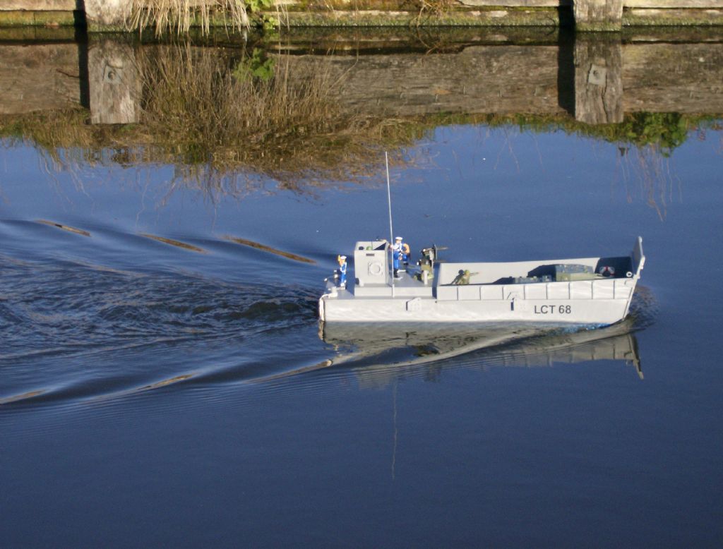

          What were your final thoughts on the best drive system (motor/voltage/prop type & size) for your 20in Landing Craft?
          Do you have a picture of one at full speed with this combination?
          #90862

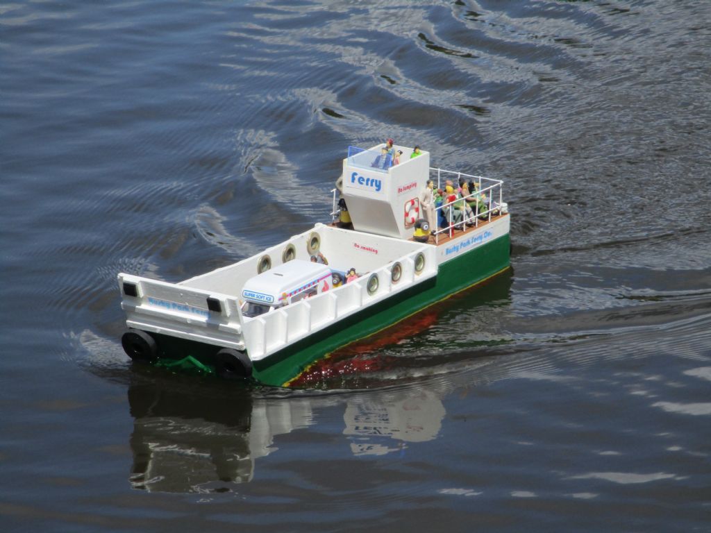

            Chris.  snap at speed  of my original lander, the first one I made, and I don`t think its going quite flat out, and the ferry.
            They have all been fitted with 385 motors and S35mm two blade plastic props. A 7.2Nimh fits nicely and depending on how far back the motor is, an 8.4 will fit as well for extra oomph.
            A 380 or 400 would of course fit to make it a bit quicker and you get a nice bow wave, but I have kept to a 385 as I often let kiddies drive the landers and generally they just go flat out forwards of back, so the slightly lesser speed is handy. It means they run forever as well!

              Thank you Ashley. I think it looks a good spec/speed for my great nephews. I hadn't thought about full speed astern! thinking

                Yes the poxy auto wotsit wrote of instead of ‘or’… forwards or backwards should have been.
                Paul Thomason did some nice CAD drawn plans for the lander, available on pdf for a small donation to a charity wot escapes me at the moment. Very simple construction, no more than about 12 flat bits and a few strips , all 4m ply.
                It’s a wonder more people don’t build them. Excellent sea boat, great recovery boat, bullet proof, can be accessorised no end and is amenable to being built a bit larger (sized for 1/32 scale to suit Airfix etc soldiers) Although not strictly accurate, it is almost there and with a bit of tweaking could make a Really decent model.
