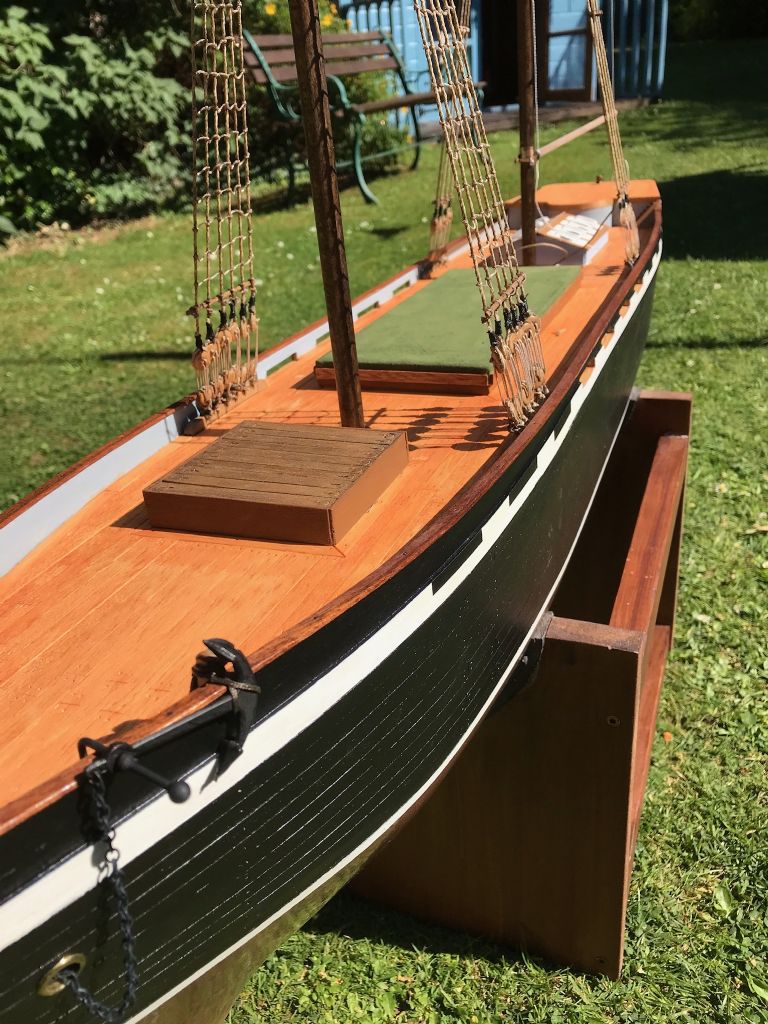

                                    Hi all, just a few pics of my new Brigantine, should be ready to sail when all this marlarky is over….. hopefully!
                                    Ricky ye pirate 🏴‍☠️

                                      Lovely decking. Is she based on any particular vessel or just a minds eye?

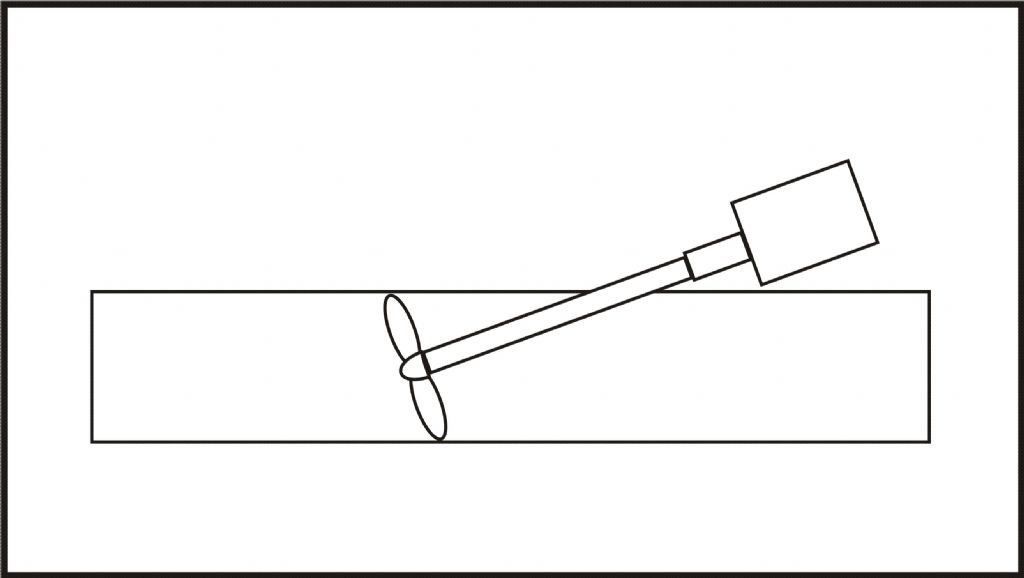

                                        I'm pretty sure I've seen something like this done. It uses a standard 3-blade prop running in a plastic tube and powered by a cheapo brushed motor via a shaft set at an angle. Elegant it's not; 100% efficient it's probably not, but it's cheap, easy to make and would work OK.

                                          Not really Noel, like most of my stuff a bit off the cuff with cues from the clipper ships of the late 1800s. Going to be using two sail winches, one for the square sails and one for the big gaff + the fore sails. Should be really controllable and interesting to sail.

                                            Hi.Richard, I also like your deck detail, I have a schooner at home waiting for me to get back to, the first job will be the deck planking, I hope I can make as good a job of it as you, what size is your boat? and the width of your planks?
                                            Regads.
                                            Eddie.

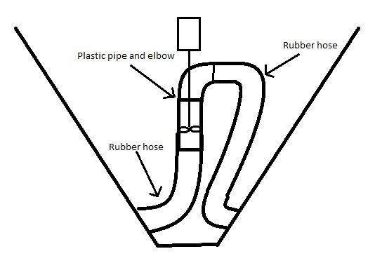

                                              Dave, on same subject I was thinking similar,like this:
                                              Which might be easier to install.
                                              #88903
                                                Could be easier to install but I think you woud find the the sharp bends would severely affect the waterflow.

                                                  DM like your sketch, but not sure Neol has the width available at the bow?
                                                  Noel. I think that two bilge pumps in the centre section leading to outlets at the front would be effective. You only need to bash some 50mm holes n the base and sit the pumps above them. The pumps are rated for about 4m of lift so a few feet to th3 bow would be nothing. 24 quid for a pair…
