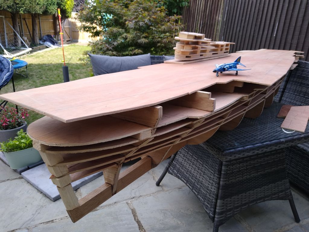

                                                  Bandsaw marvellous. I now have a bundle of 4mm ply strips 12mm wide by 8 feet long.
                                                  Keen to make a start on planking the Ark, but one question.
                                                  If I plank horizontally for most of it, when at the bow, itwill need a bit more curve, and diagonal planking might help. Is that right? If so should I bring the horizontal planks up to the first frame or the second one (see below).
                                                  There needs to be a break in the planks anyway because the hull is more than 8 ft long so only at the keel will an 8 ft strip make it all the way between stem and stern!
                                                  Or, do I use balsa block for the bow area and lots of carving and sanding?
                                                  All suggestions appreciated as I've never planked anything like this before.
                                                  #88713
                                                    Hi Noel,
                                                    I would use styrofoam infill for the bow & flared section between the stem & bulkhead 2 & Glass cloth & resin, easy to carve and sand to shape 😄👍
                                                    #88719
                                                    Richard Barnett
                                                      @richardbarnett67129
                                                      Like Ray posted, a combination of different materials won’t matter as your going to fibreglass the whole hull anyway. It’s getting the shape right first before you put the hard stuff over it, altering it after needs a lot of filler and a lot of rubbing down, good work out though !👍
                                                      Need to get the hull as smooth as possible before the fibreglass so you only need a thin coat of filler to finish. I use a fine weave fibreglass cloth as you don’t get lumps like the standard hairy stuff. Brentford fibreglass shop (when it’s open) is the place to get your stuff when ready, very helpful guy who runs it and cheaper than online.
