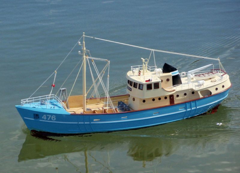

        I plan to use Pacer Z-epoxy finishing resin to seal the outside of a Billings Nordkap hull (plank on wood frame).  Some people advise thinning with denatured alcohol (methylated spirits in the UK?) but I have heard that, as meths contains water, this adversely affects the sealing and waterproofing properties of the resin.  Is this a real issue and is there a water-free solvent available which might work better?  Any advice would be much appreciated.

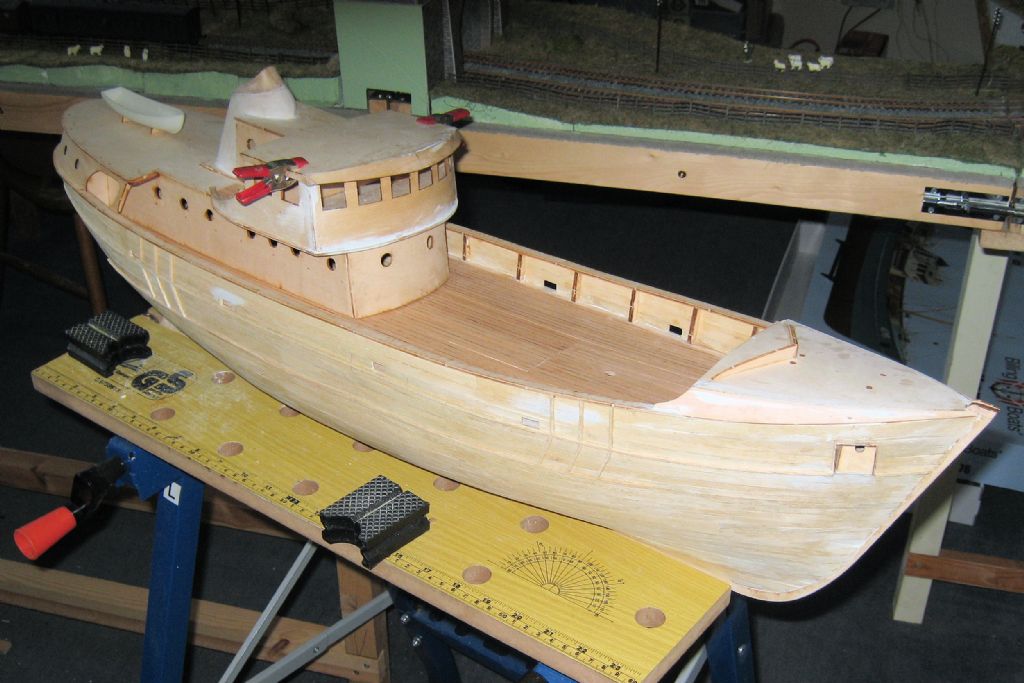

                    Thanks to all for their valuable advice.  The quality of my planking particularly at the stern leaves a lot to be desired – maybe too much of a challenge for sanding sealer and paint alone.  I will try the resin warmed and unthinned but I have found a supply of 99.9% methanol to thin down a bit, if required.  The technical notes for Pacer suggest that limited thinning should be OK.  I will try Dave Milburn’s idea with a small sample to see if it sets.

                      I am attaching some pics of my RTTL model which I am currently building and used the method below to cover the hull.
                      I would advise strongly against thinning epoxy as there is no need to.  The trick of using Z-epoxy is to purchase the cheap artist brushes (you know the ones – the ones from the Pound shop) to stapple the resin into the grain and into the gaps of the planking.
                      Once this epoxy has dried, rub it back with a wet n dry paper, until you expose the grain of the planking again, but leaving the epoxy in the gaps.
                      Then recoat with a 2nd coating of z-epoxy, and when this epoxy has dried, rub it back but not so as you expose the planks.   Then, put your finished coat of epoxy on – rub this back with finer grades of wet n dry – and a sanding block to achieve this desired finish.

                            Everybody has their favourite method of finishing hulls, and mine is to use unthinned fibreglass resin over the filled and sanded planks. I also  use some fibreglass cloth on the inside of some boats to strengthen the timber, which I did on my Nordkap- below.

                              Thanks for the advice.  On this occasion I think I will stick to unthinned resin resin without fibreglass.     I am on to the fitting out stage now and will submit further photos.  I am temped to leave the brass portholes unpainted – would this be totally wrong?
