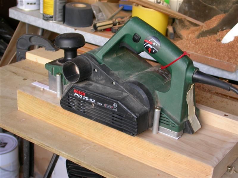

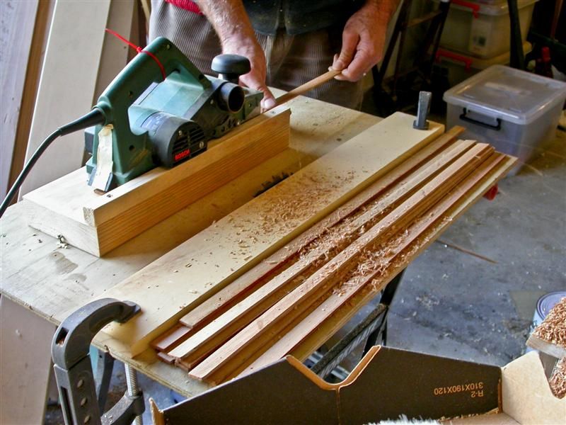

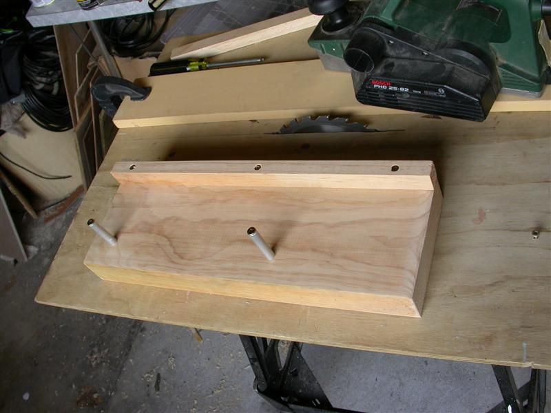

                                      Hi Ian. Thanks for making your original post. You got me thinking and I have now made up a thicknesser using my electric hand plane.
                                      It works better than I dared to expect and I am rapt to now have such a useful tool. The trial pieces that I thicknessed were 3,5mm rough sawn strips cut from a piece of 18mm thick dressed rimu. They came out to 2mm +0.06 – 0.00
                                      Cheers.
                                      David.
                                      The pictures below show how I made it.

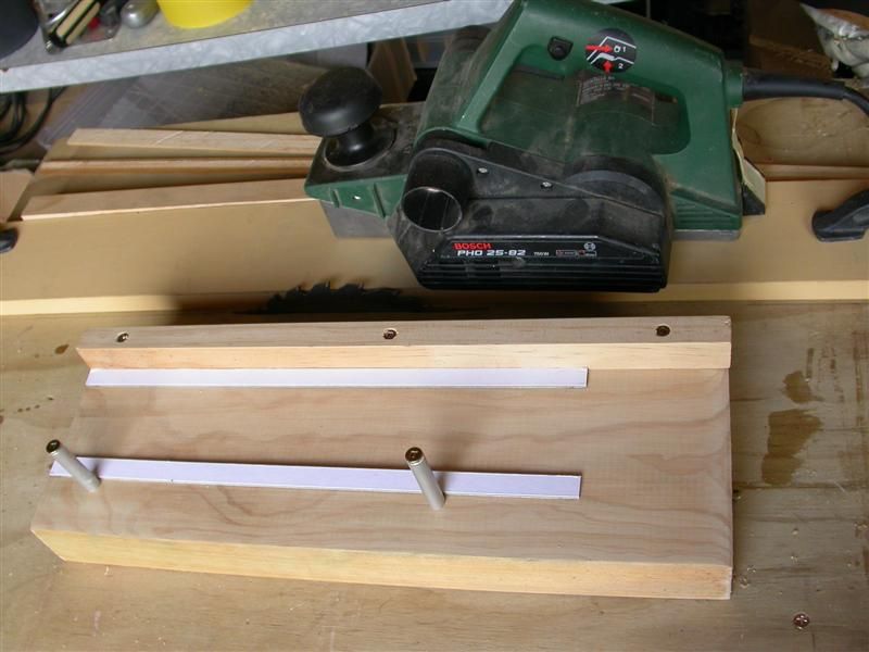

                                      I used a 150mm x 50mm piece of dressed pine cut to 100mm longer than the
                                      electric plane. I then fitted a 25mm high wooden fence on one side. (
                                      it must be lower than the protruding planer motor cowl) next I placed
                                      two screws with a piece of 10mm dia aluminium tube around them to the
                                      front and back of the protruding planer belt drive cover. The posts
                                      constrain the plain and stop it being pushed back when you feed the
                                      wood through.

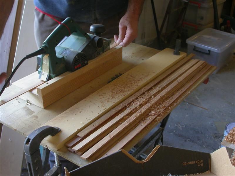

                                      The two white strips are 2mm thick cardboard. These are what determine the final thickness that the wood will come out to.

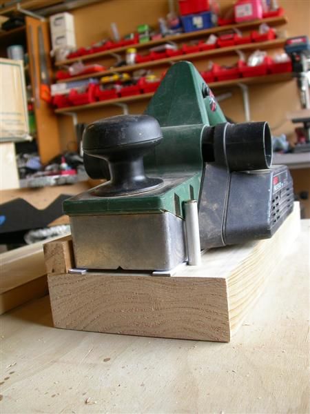

                                      This is the timber input end. The planer has been set to take a 0.5mm
                                      cut. I later moved the posts back 50mm to give a platform to rest the
                                      wood to be thicknessed on. It is necessary to momentarily lift the
                                      front of the plane to feed the wood in.

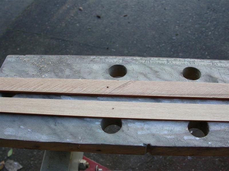

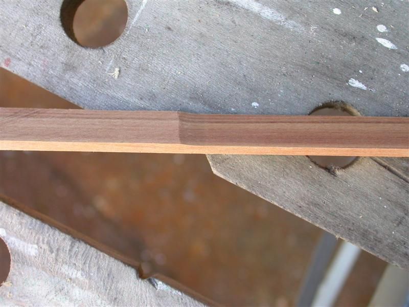

                                      A 3.5mm thick rough sawn strip and a similar strip after one pass through the thicknesser.
                                      Showing the depth of cut

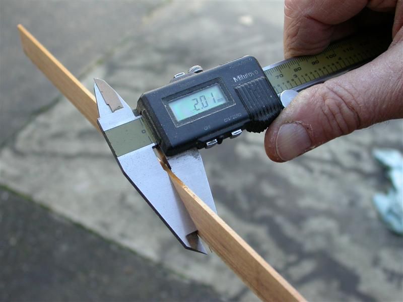

                                      The rimu strips were consistantly thicknessed to between 2.00mm to 2.06mm over 10 strips thicknessed.
                                      You can just see the timber coming out the back of the plane.
                                      The timber is nearly through.
                                      The thicknesser must be constrained loosley because it is gravity that holds the plane down on the timber.

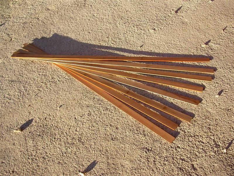

                                      The end product. Each strip took three passes through the thicknesser.
