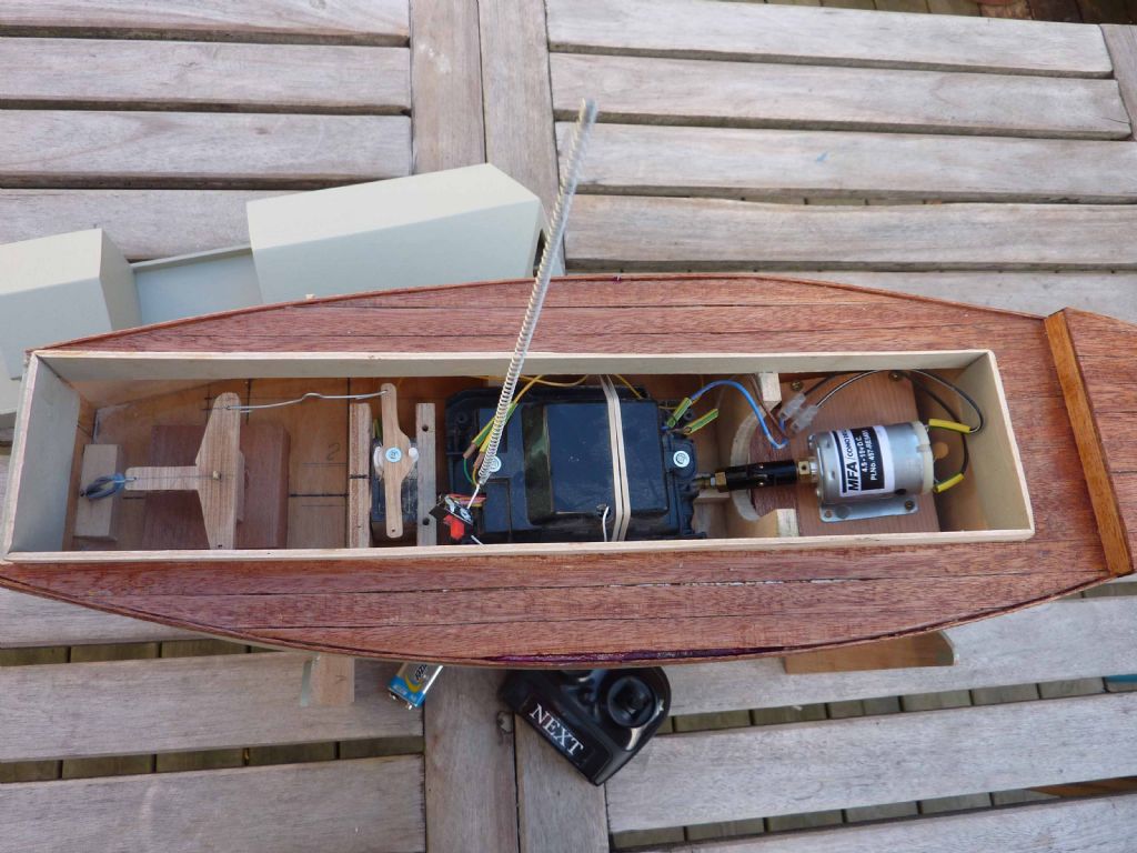

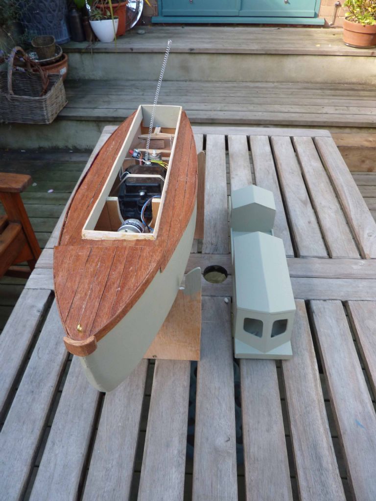

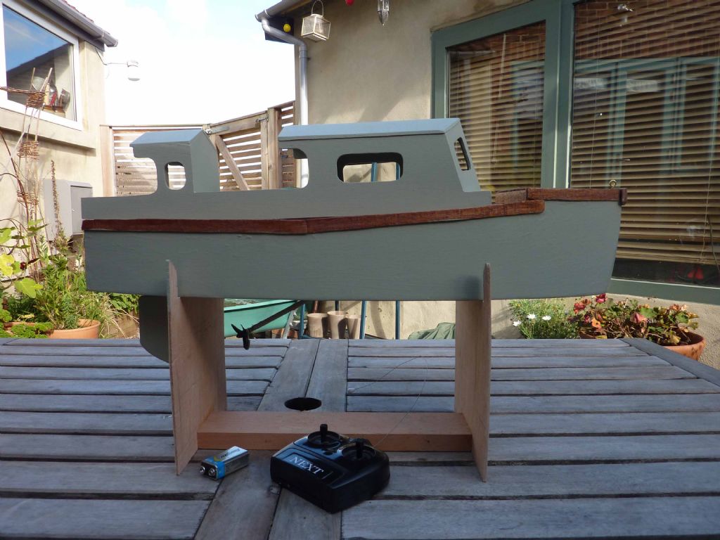

      Plywood hull and superstructure, scaled to take LEGO or Playmobile figures, ports / windows open to allow figures to be placed inside easily. Finished, so far, in matt green, ready for 9 year old grandson to apply the camouflage paint final touches.
      Simple lift off cabin
      Recycled toy car innards, remote control, battery container and steering server, the motor had a fixed cog that couldn't be adapted so I had to buy a new one! Also invested in shaft and propellor.
      I used hard wood to make the tiller arm, server arm and the rudder itself, on a brass rod.
      Sea ( pond ) trials proved it well powered, a bit slow on steering response, but tough enough to take a knock or two. The final coat is an exterior primer with a matt finish.
      I will also give him a few "taster" paint pots of suitable "camouflage colours" for him to apply the final finish.
      I was thinking of gluing some LEGO base plates onto the decks, so that his figures will be secured when they go to sea.

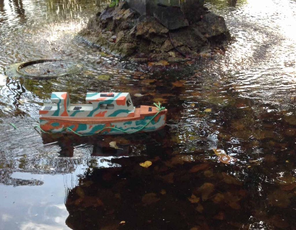

                          Neat but not gordey paint job,, well done , but beware of the skipping rope at the rear ,
                          nothing worse than prop tangle , by the way where is your sailing venue ..?….
