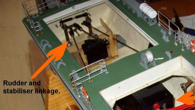

                I made the stabilisers functional on my Model Slipway Sentinel, and I have to say that she does not roll excessively in tight turns although a slight outward lean in a turn is prototypical. I have attached a photo of the linkage set up.
                Peter.

                        The difference in having either bilge keels or fixed stabilisers can easily be seen by holding a boat over until the sides are almost touching the water and then letting go. Note the number of side to sides before it almost stops rolling. Try with bilge/stabilisers and then see the difference. This is the difference between a model bobbing and rolling on the lake, or looking much more solid (perhaps not the bobbing, but rolling certainly).
                        Always worth having dampening. The Sentinel "active" stabilisers are too small, from what i have observed and would need to be enlarged to be effective..especially as this model appears to be very tender.

                          The stabilizers on Sentinel are true scale and in my experience are not necessary. My original plank-on-frame Nellie had 6mm less draught than the kit GRP hull yet was as solid as a rock on the water. I believe that the reason some kit-built models are "tender" is that the owners fit far too powerful motors and try to take turns at full (aka unrealistic) speed. Sentinel spends most of her time trolling on the waterjet, tailing yachts just over the horizon. She only uses main engines for transit from one operational area to another, and the hull is not a planing type. Vospers' design staff call the Island Class a "short, fat warship".

                            Dave. I did not mean my post to mean "they are under scale" but simply I think they are a bit small to be effective on a working model.
                            I personally have not sailed a sentinal to get the feel of it, so can only say what I have observed.
                            Ah, the difference between one persons boat and an outwardly identical other !

                              I have not found my Sentinel to be tender, Ashley. As I said previously, she does lean slightly in turns, but I believe that would be quite prototypical. As Dave pointed out, hurtling around the lake at warp speed is definitely not prototypical for the class, so working stabilisers are not necessary. I just made mine functional because I wanted tosmiley
