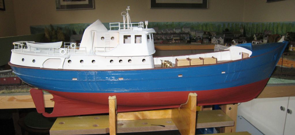

          Hi Phil Parker
          I also found your article helpful but I do have an additional question.  I waterproofed my wooden hulled Nordkap with epoxy resin and painted it using Halford’s sprays – red oxide primer overall and then Ford Fjord blue above the water line.  The red oxide is matt, the blue is gloss.  I would like the whole thing to be semi-matt.  I have a spray can of Humbrol Hobby satin acrylic varnish – would this do or can you suggest something better?  The superstructure is primed with Halford’s white primer and I thought of using the Ford diamond white for the main coat but it will also need to be dulled down.  My other option is to use the Humbrol Hobby matt white acrylic spray followed by the satin acrylic varnish.  Which of these would you recommend or again is there a better solution?  Your advice would be much appreciated.

                Thanks for passing my enquiry on.  The hull concerned is shown below:

                    Posted by Jeremy Beloff on 31/01/2010 18:45:10:
                    Hi Phil Parker
                     Jeremy Beloff
                    Jeremy – I don’t think there would be a problem but would recomend testing on some spare plastic with the same paints as used on the hull and then the Humbrol varnish. Let them dry thoroughly first to get accurate results.
                    Aside from this, the Humbrol spray can is ideal for your purposes. From the photo, your boat is quite large and will need a lot of paint – much easier to apply from an aerosol than an airbrush. Work in as warm and dust-free an enviroment as you can. Ensure the spray can is warm by sitting it in some luke warm (not boiling) water and give it a very good shake. That should ensure the paint is well mixed and flows properly. Get a spare can too as you don’t want to run out half way through a boat !
                    I’d also tend to work with a hairdryer handy and apply lots of thin coats, drying each one as you go. It takes a reasonable amount to varnish to get a consistant semi-matt finish.
                    For the superstructure I’d go for the Humbrol white – it will give you a thinner coat which can then be varnished in the same way. Car paints are thicker than model paints as your average motor doesn’t have the same problem with small detail !
                    Personally I wouldn’t spray the oxide – it should be matt and the contrast with the semi-matt hull colour looks really nice and empasises the effect. It’s your boat however so at the end of the day, do what you want and if anyone moans, tell them to go away !
                    Hope this helps.
